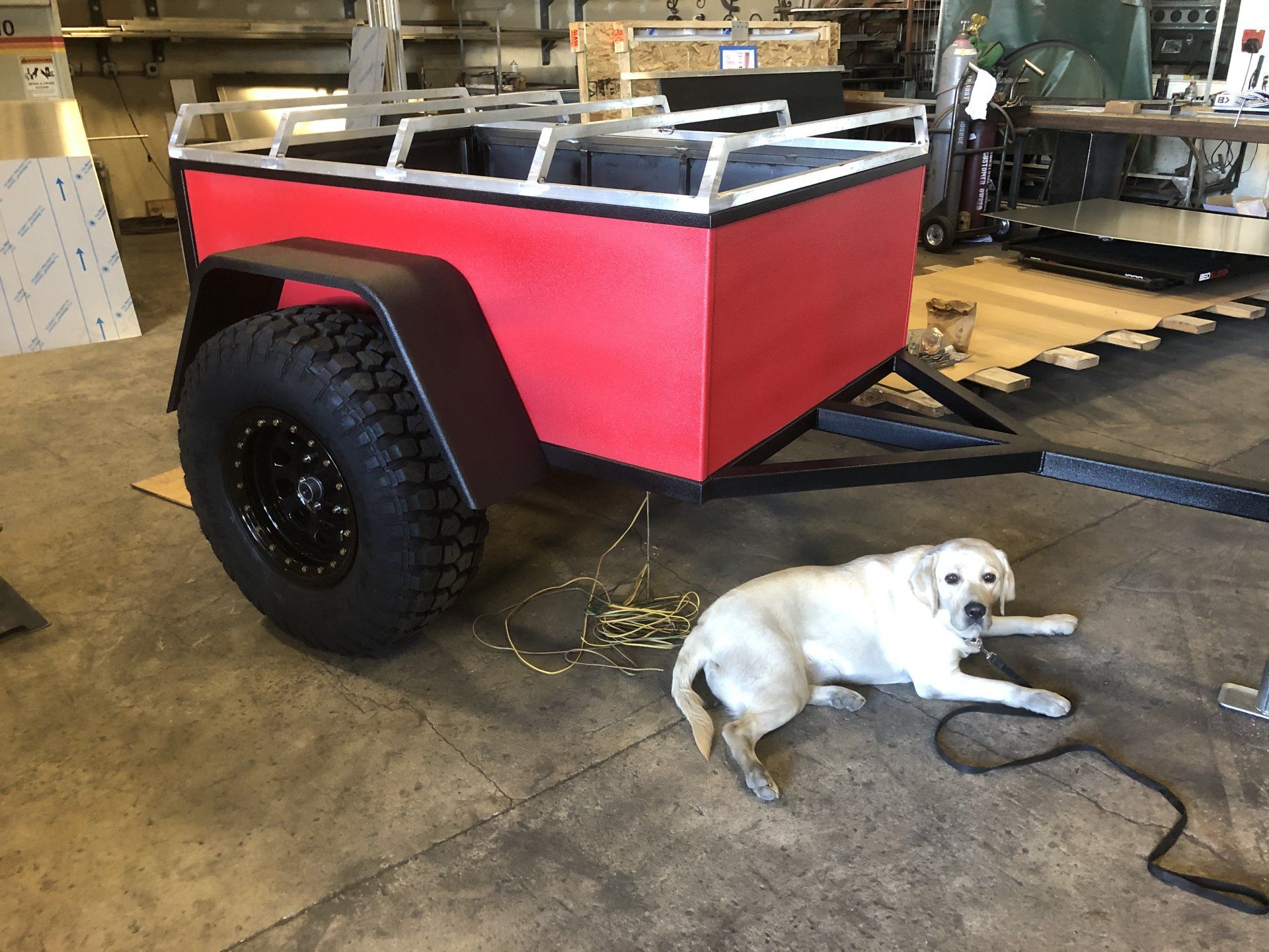

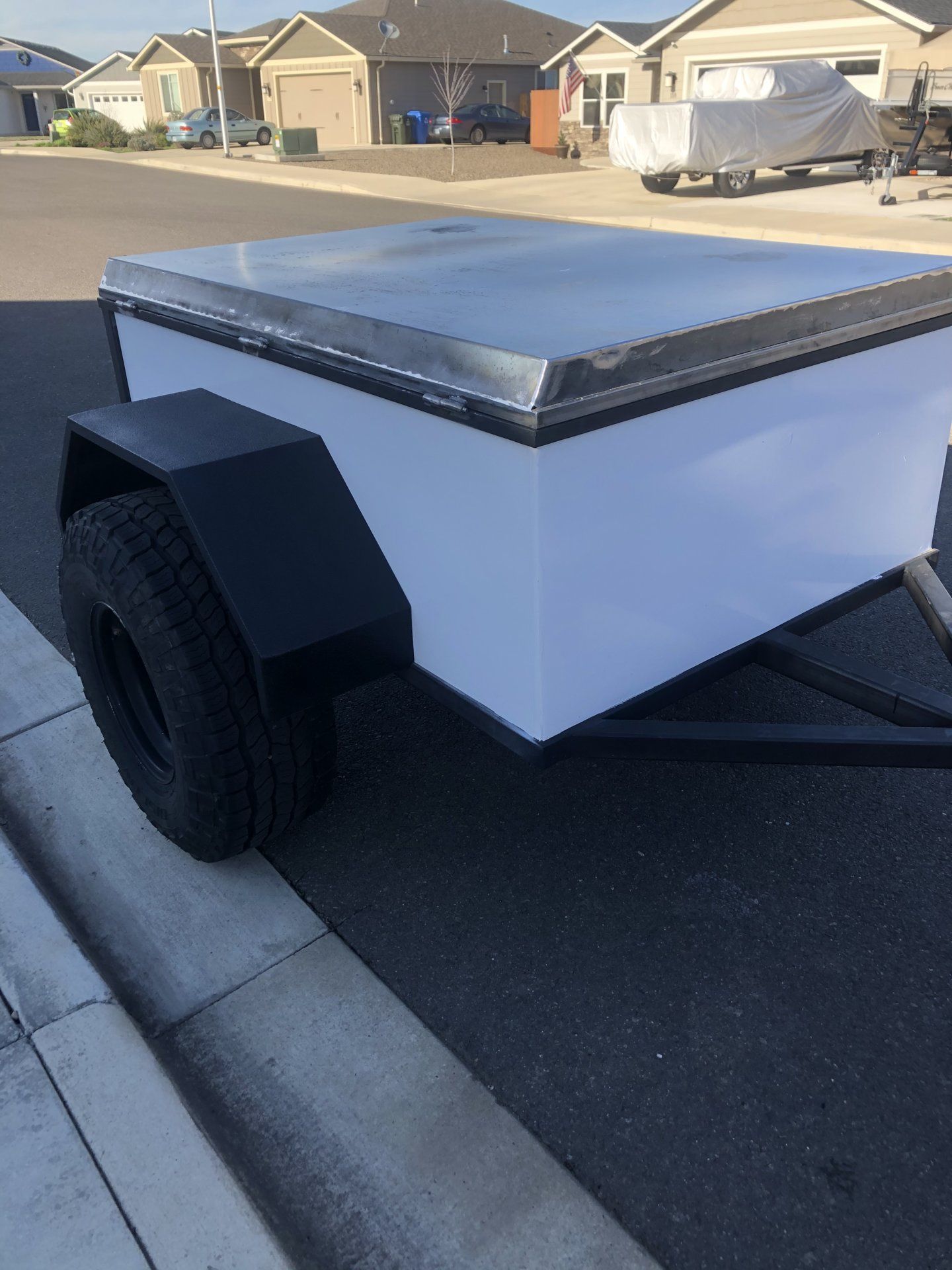

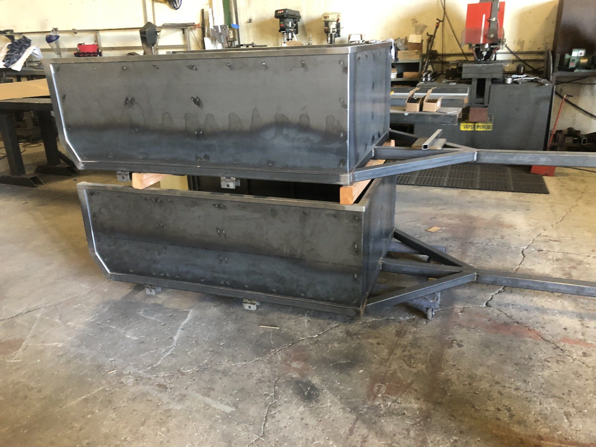

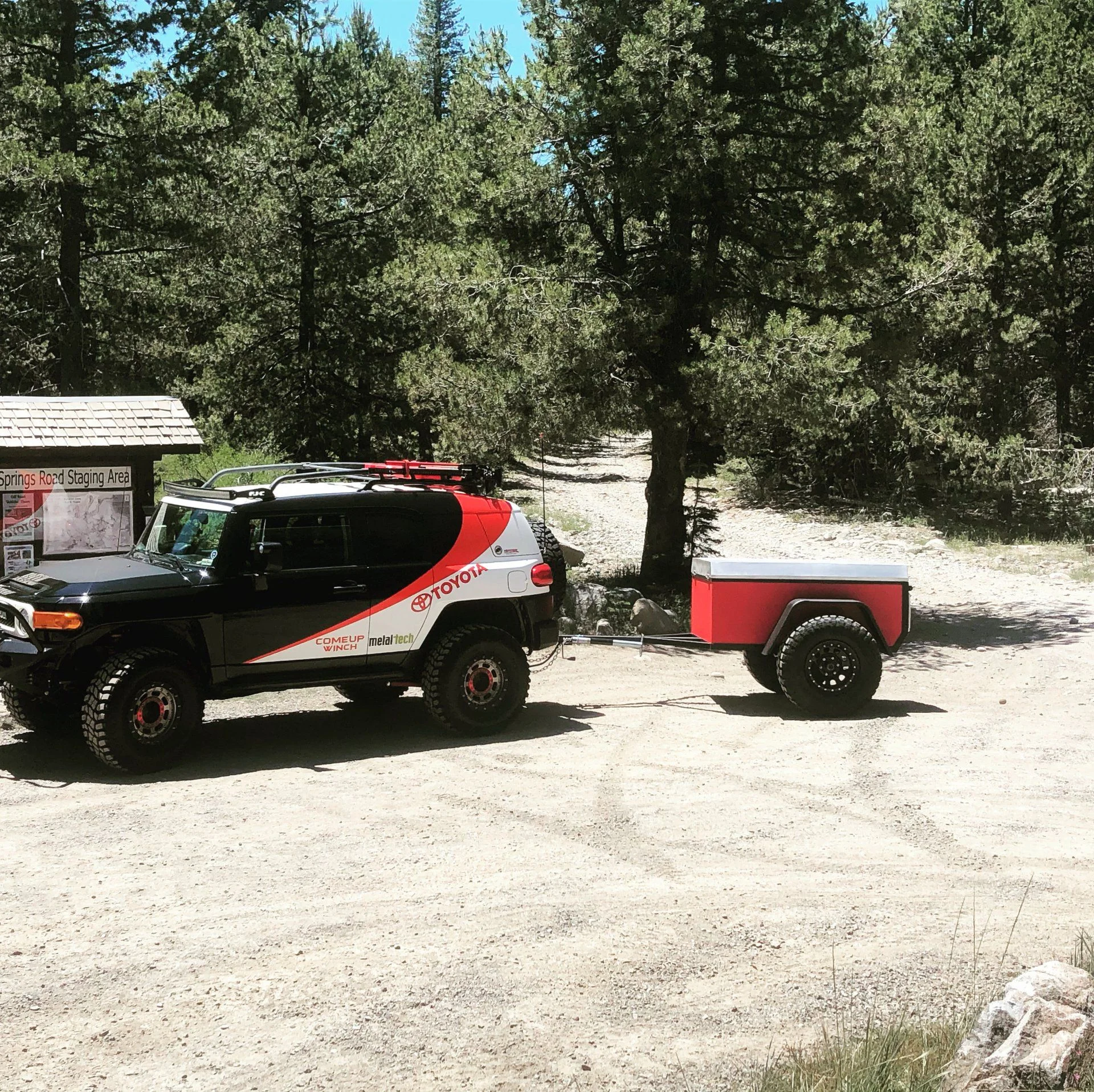

My attempt at a trailer

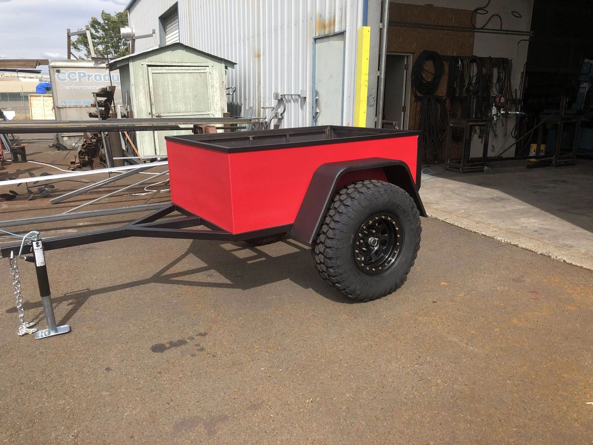

Home stretch

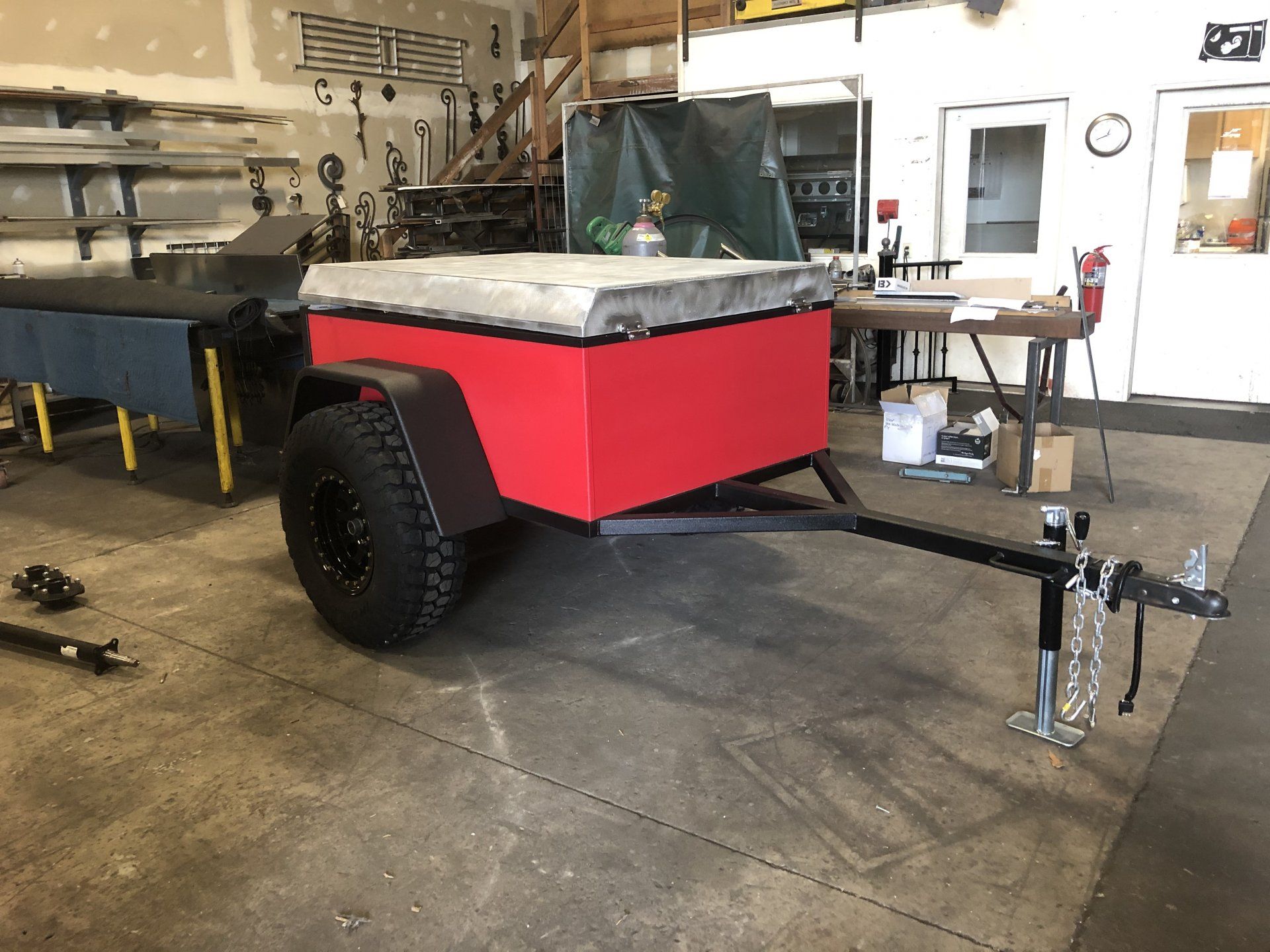

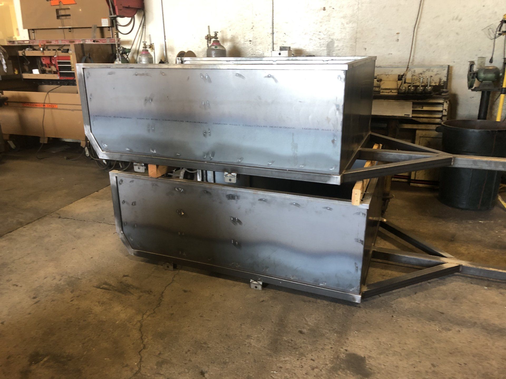

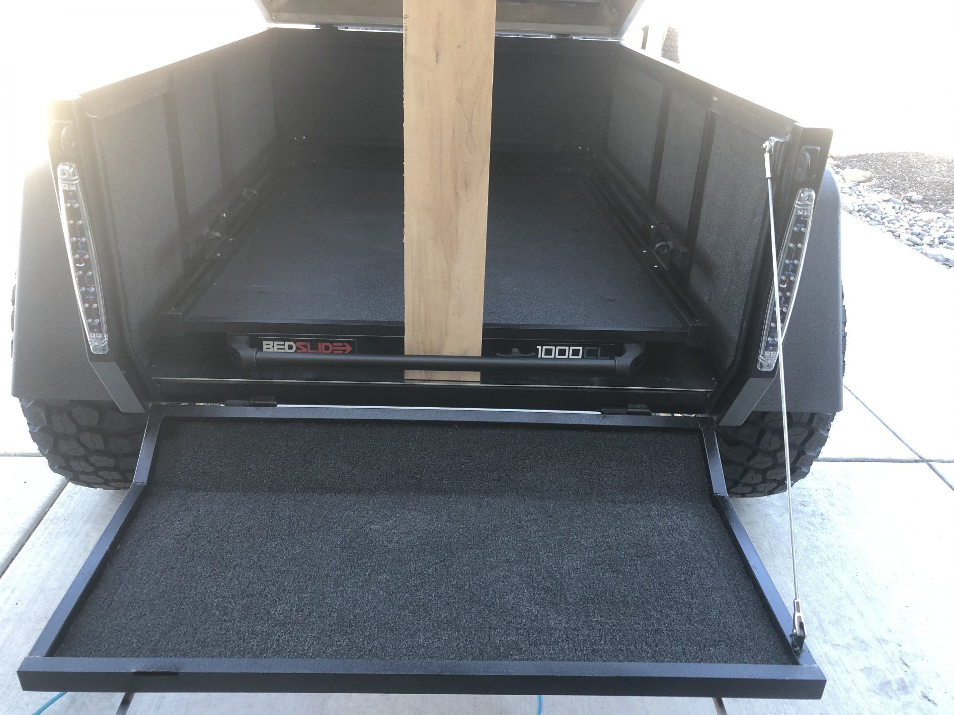

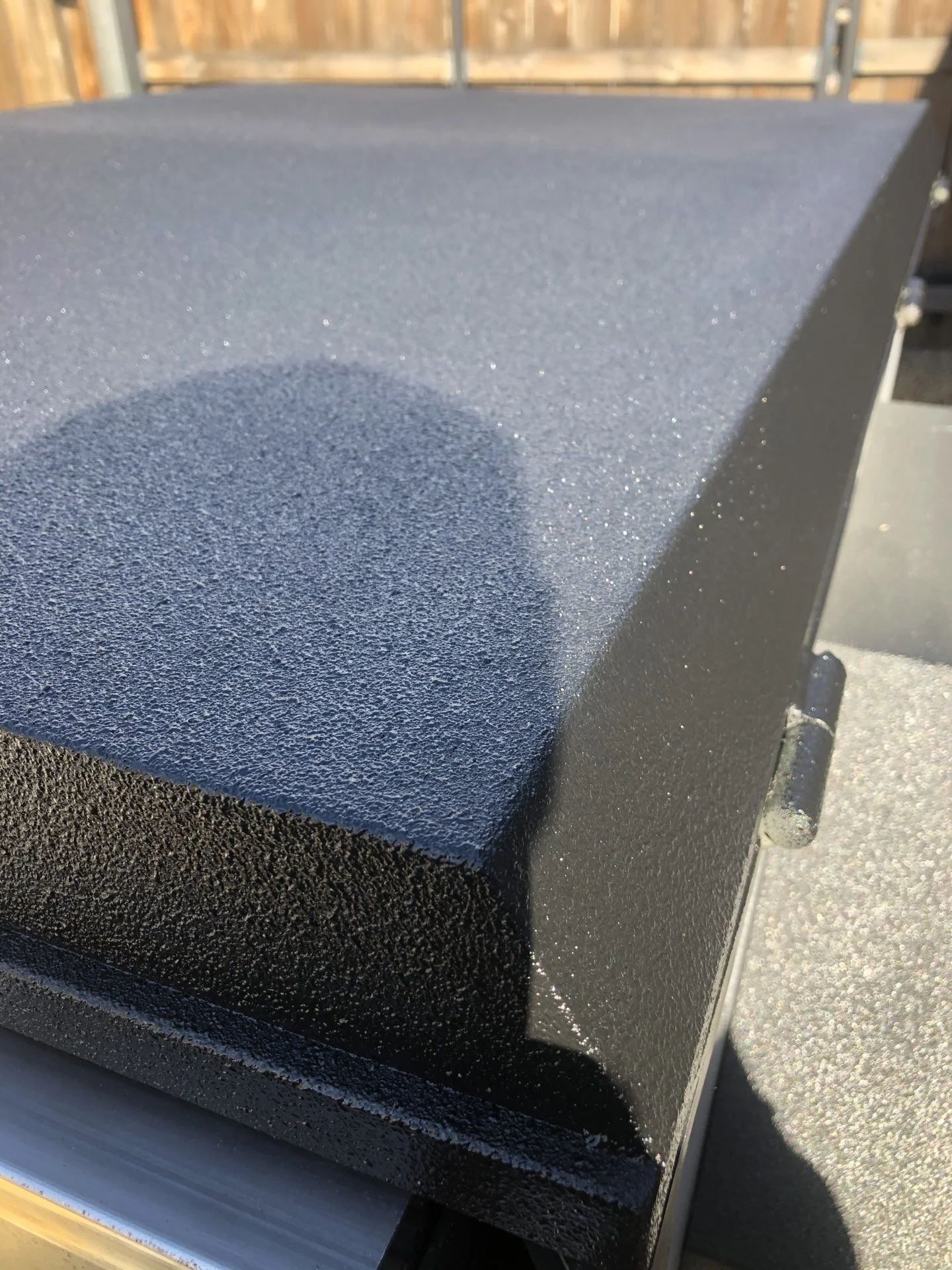

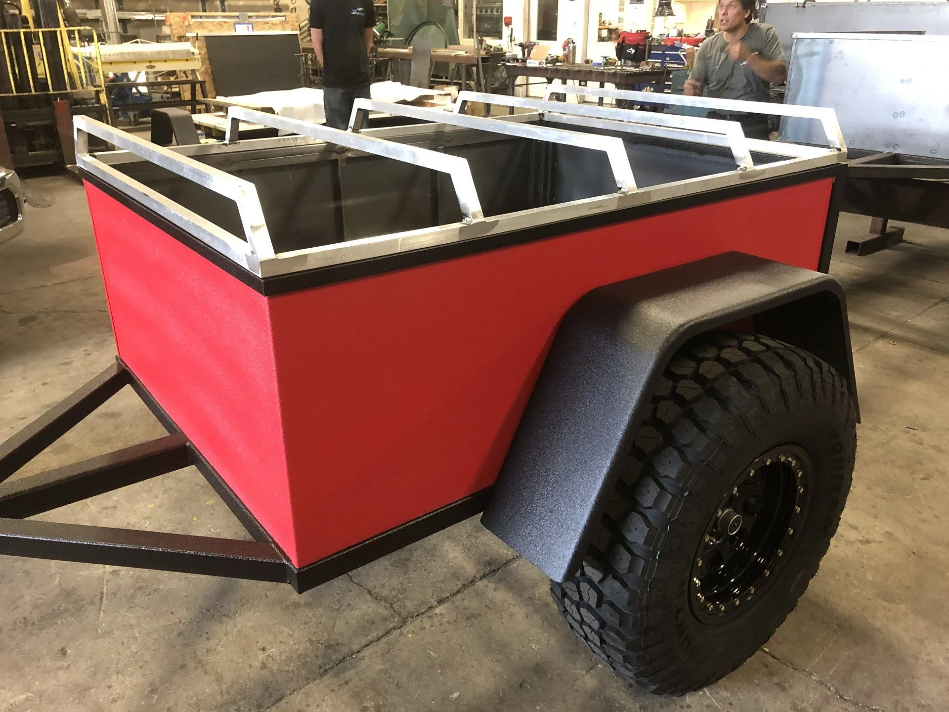

Fabrication is done 👍. Now just get it all painted. And some little details .

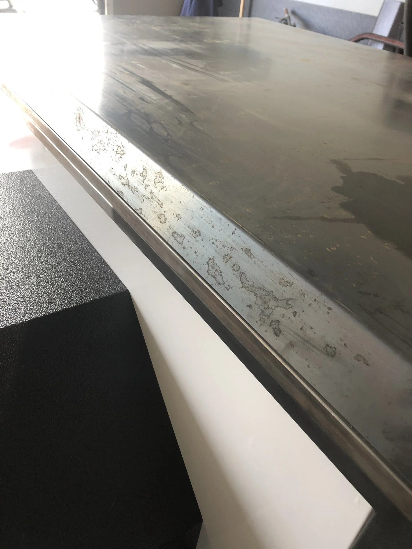

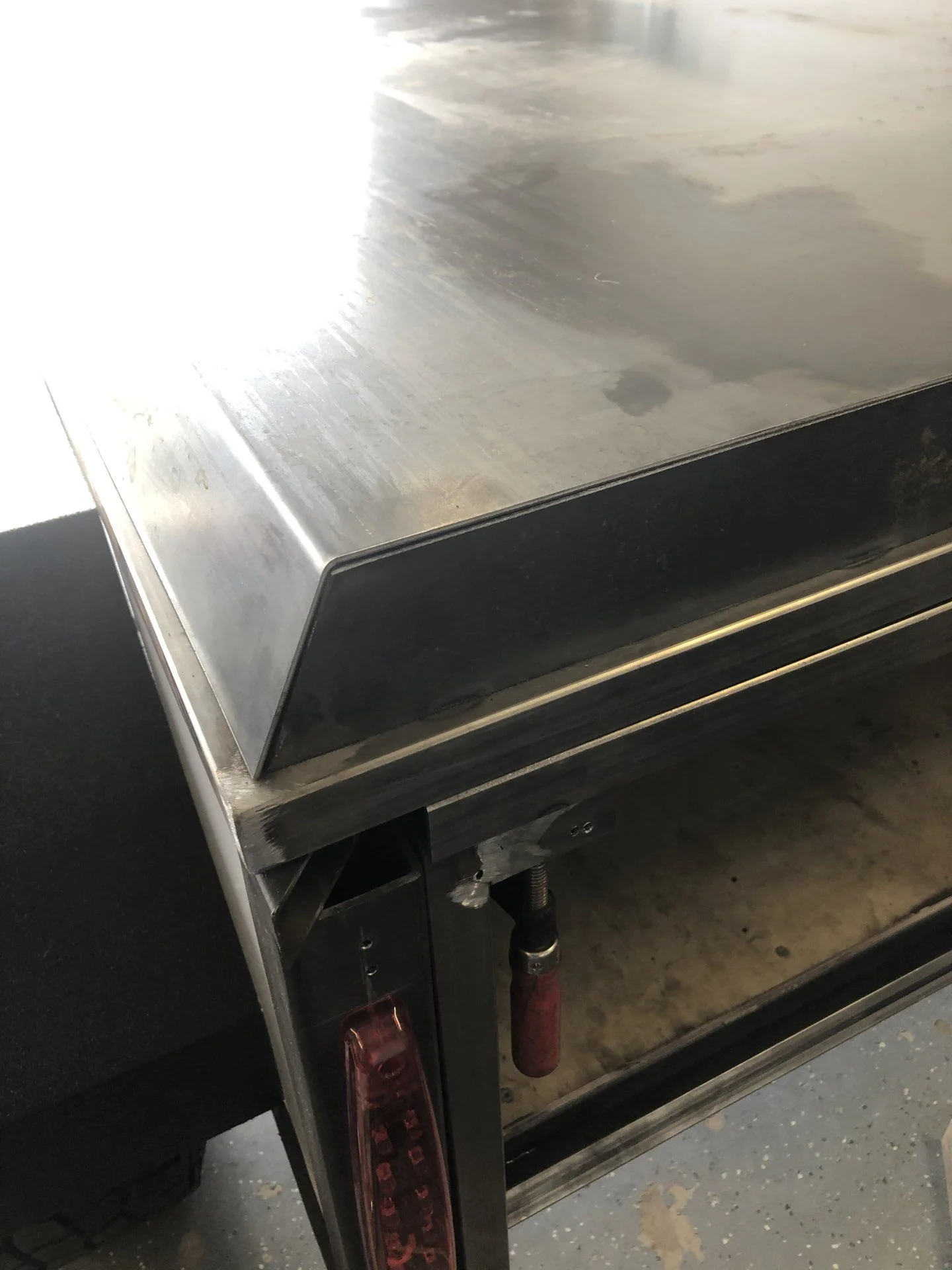

yes . lol . you did not think i was going to leave that did you

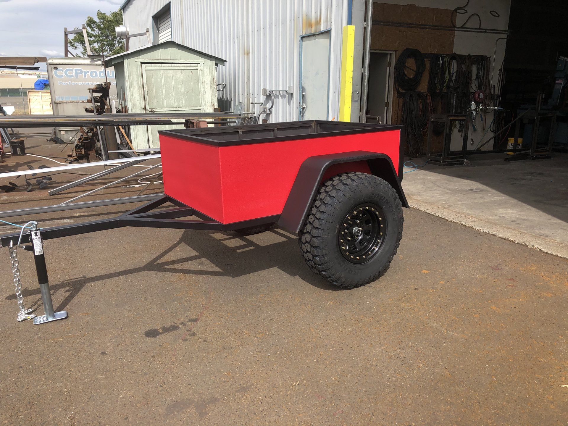

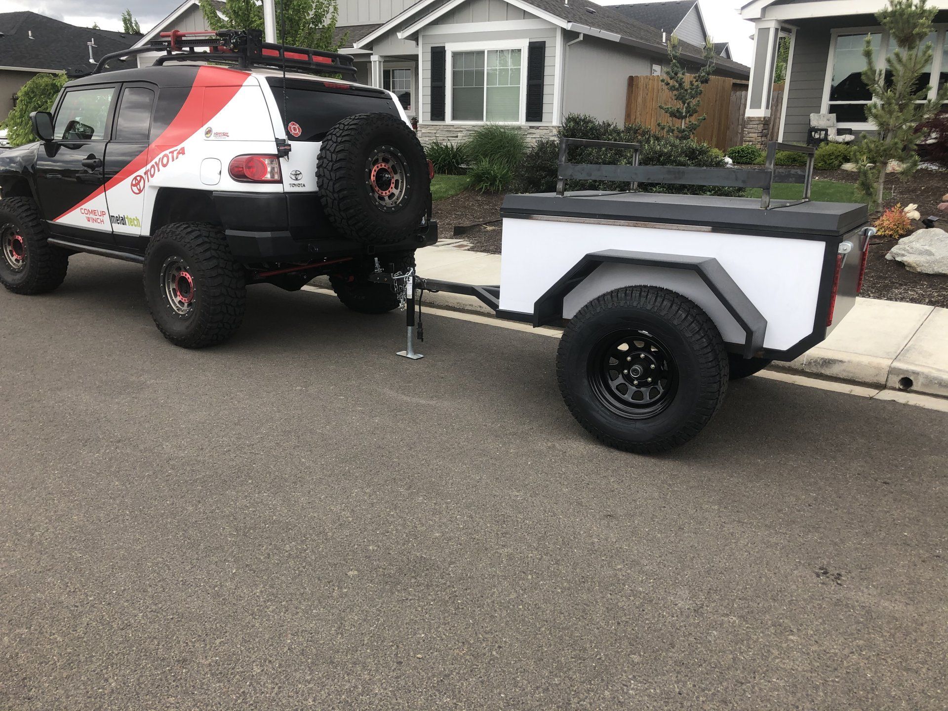

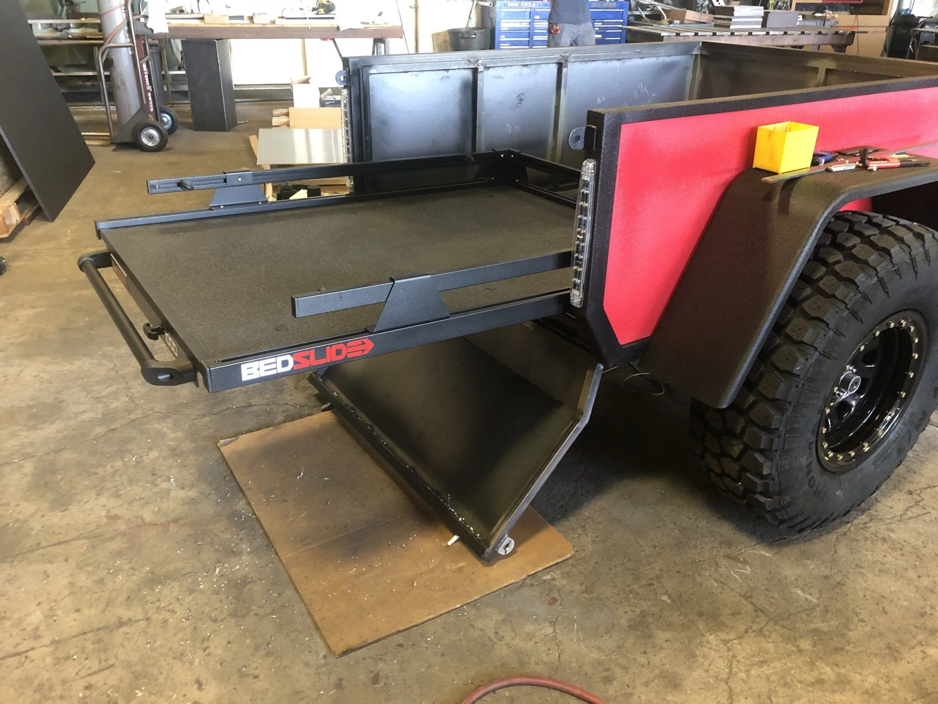

yes . but i had the wheels and tires

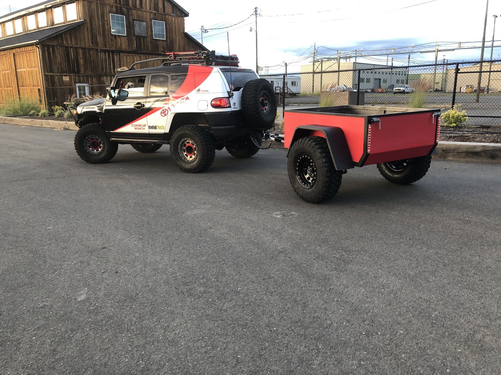

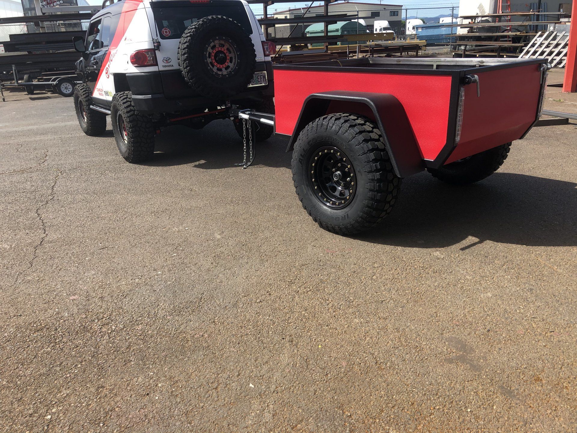

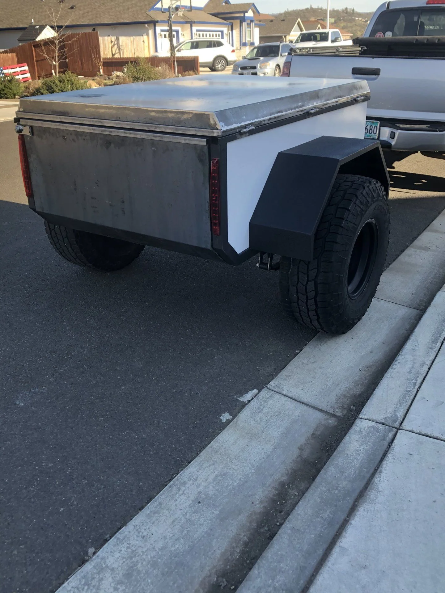

Got it almost all done and some people were driving by and seen it and asked if I would sell it . Time to start a new one . Lol

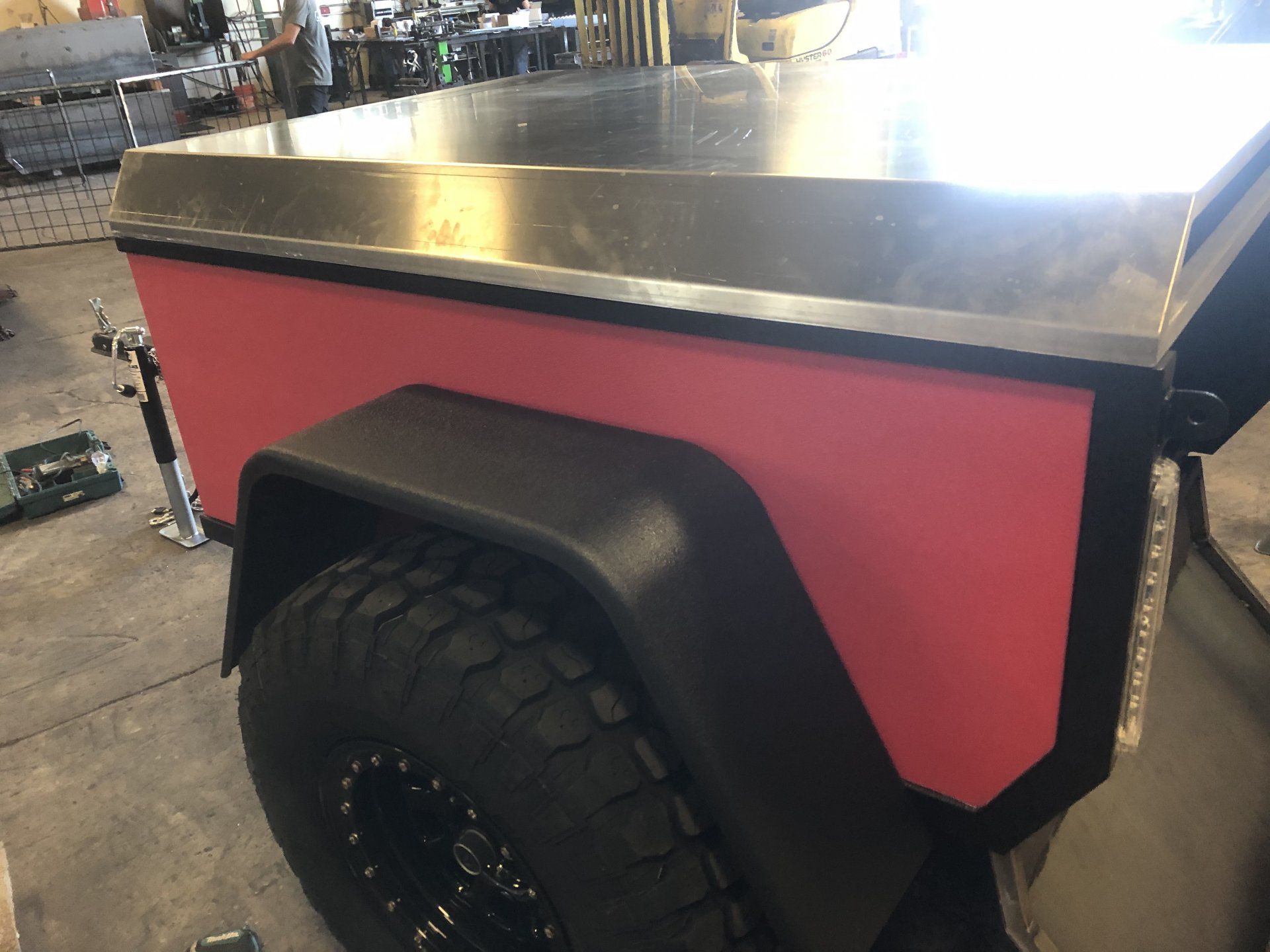

So I made some improvements and made a few more 😃.
6. so far.

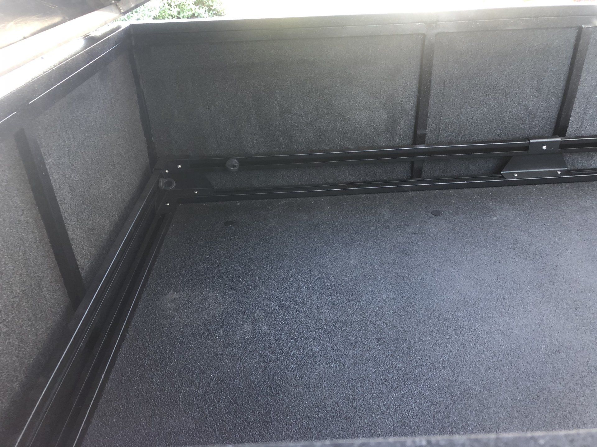

Finishing this one up
Well I never really planned this but

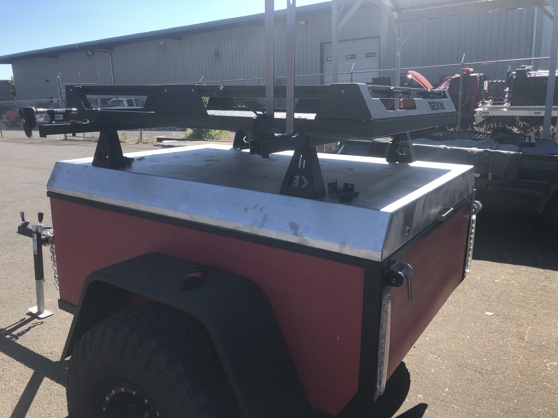

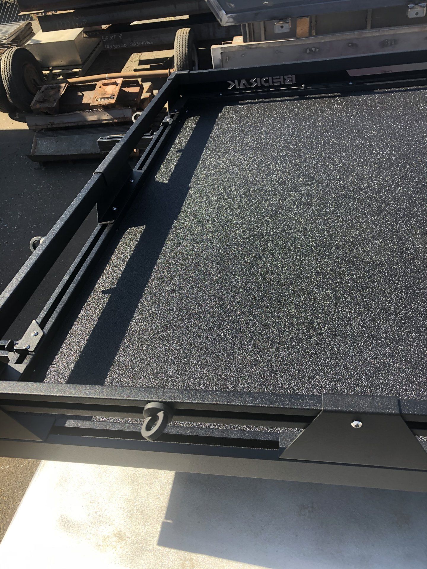

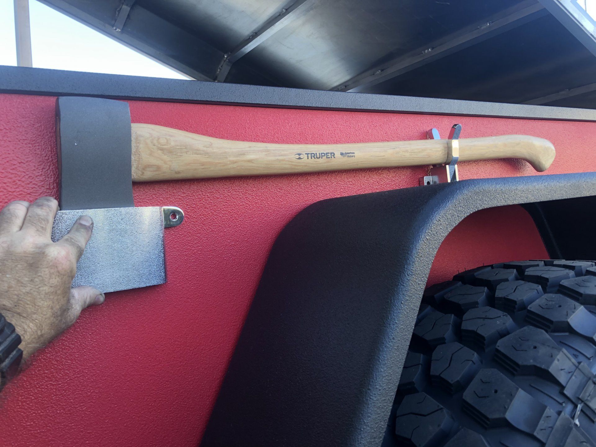

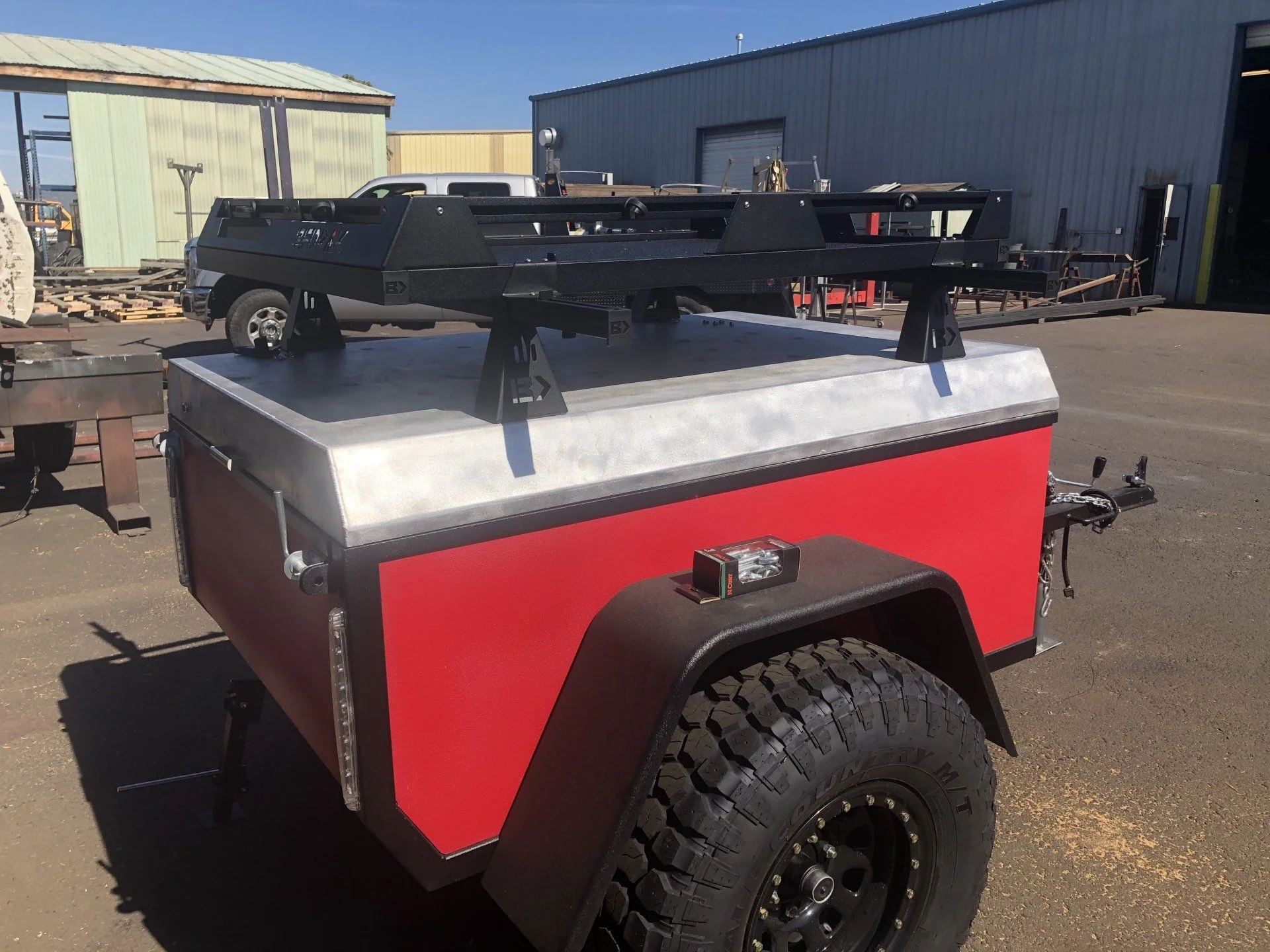

It has just kind of happened . We have been selling these pretty well now 😃. I have a new RTT rack system that has turned out really well . You can mount a RTT or a basket you can mount Bikes or Kayaks. Just a really cool addition.

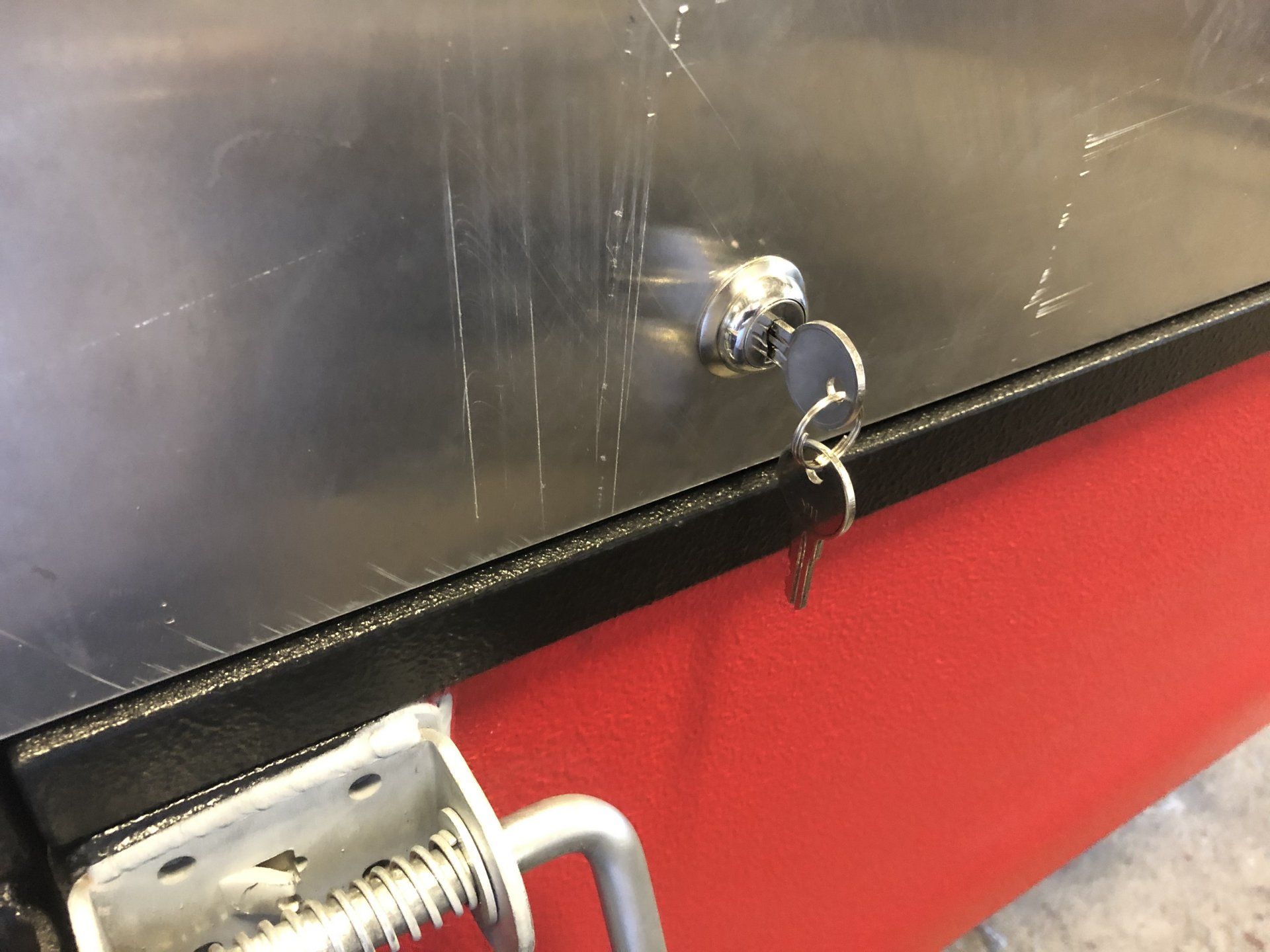

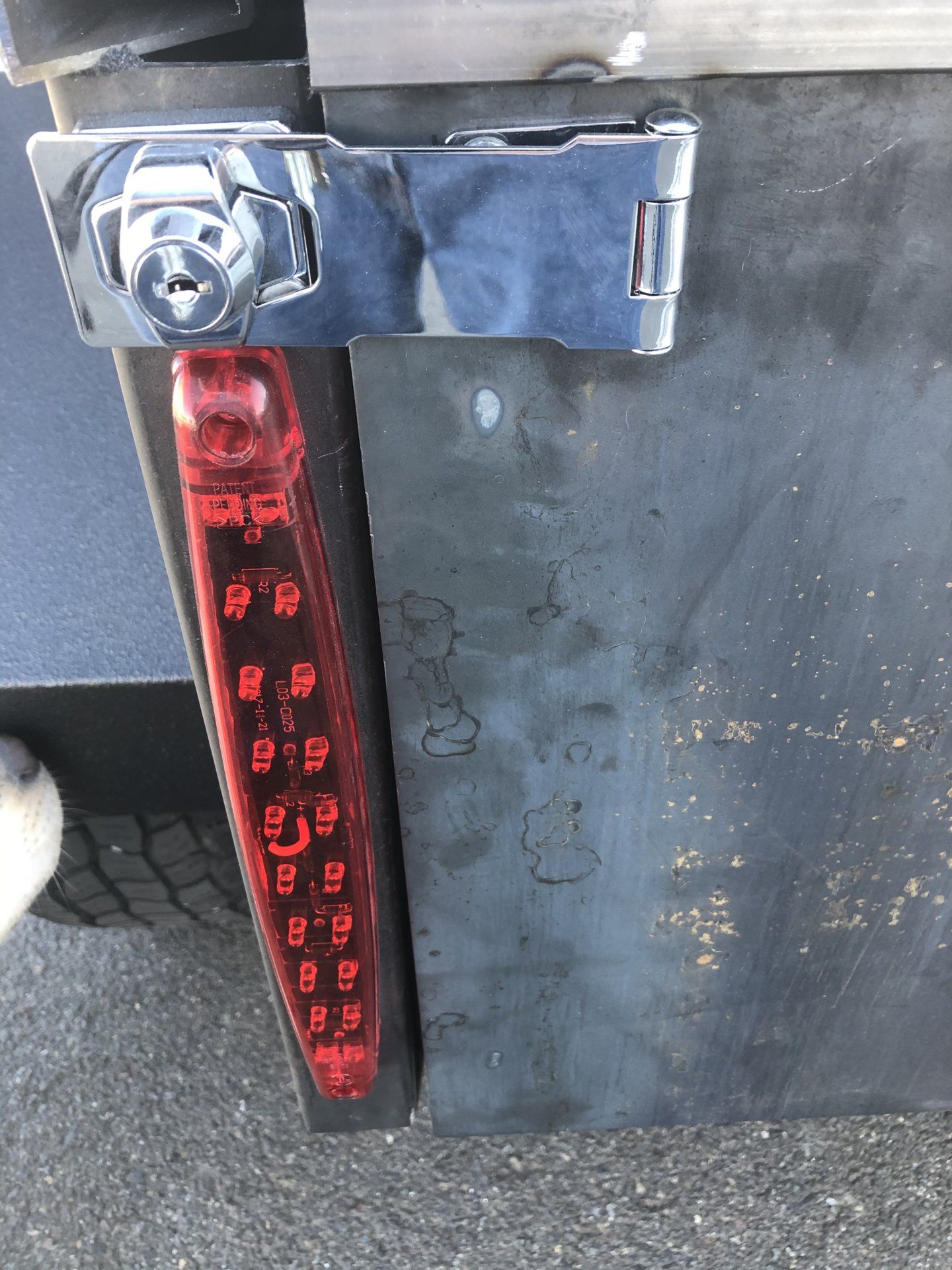

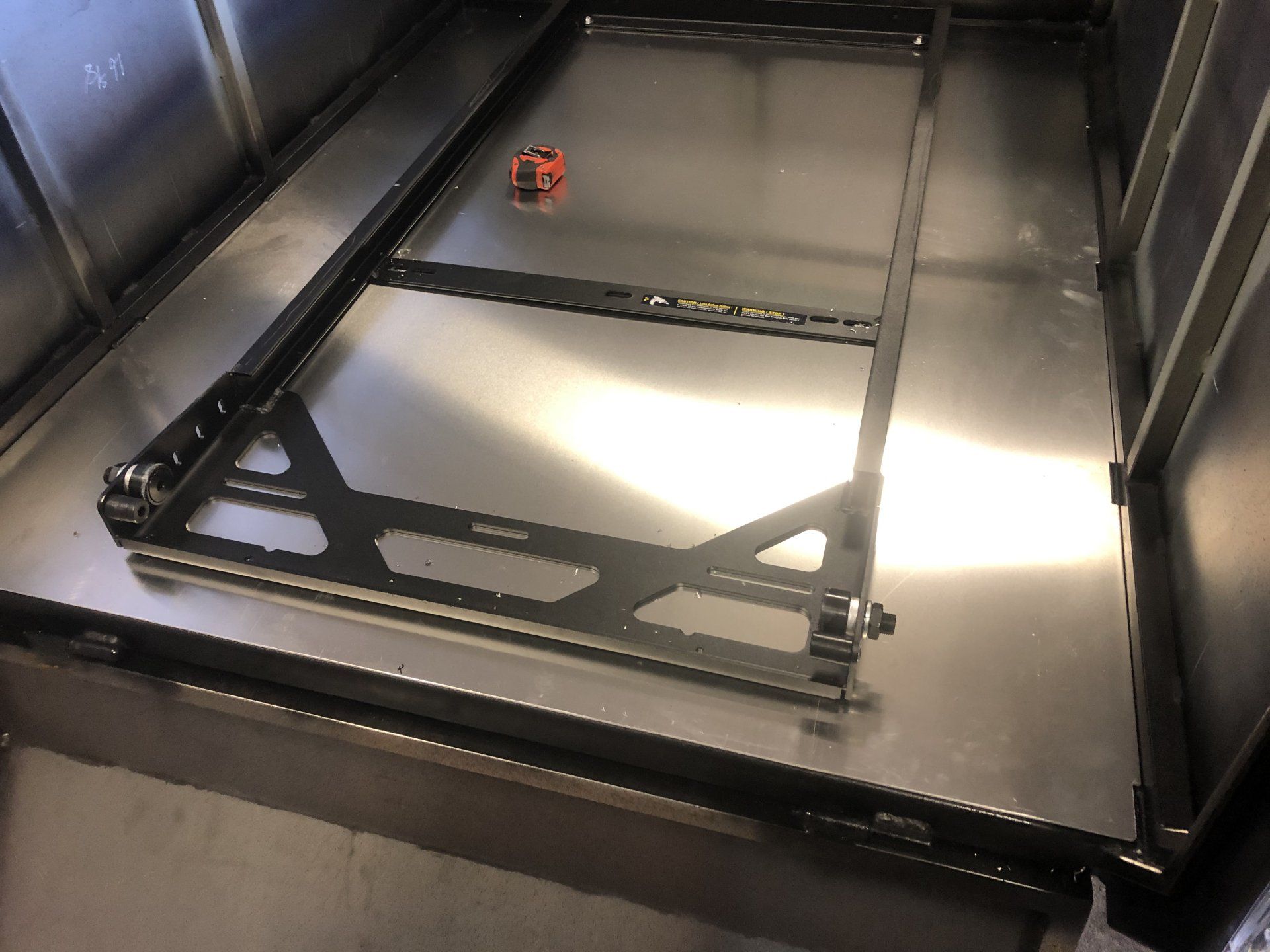

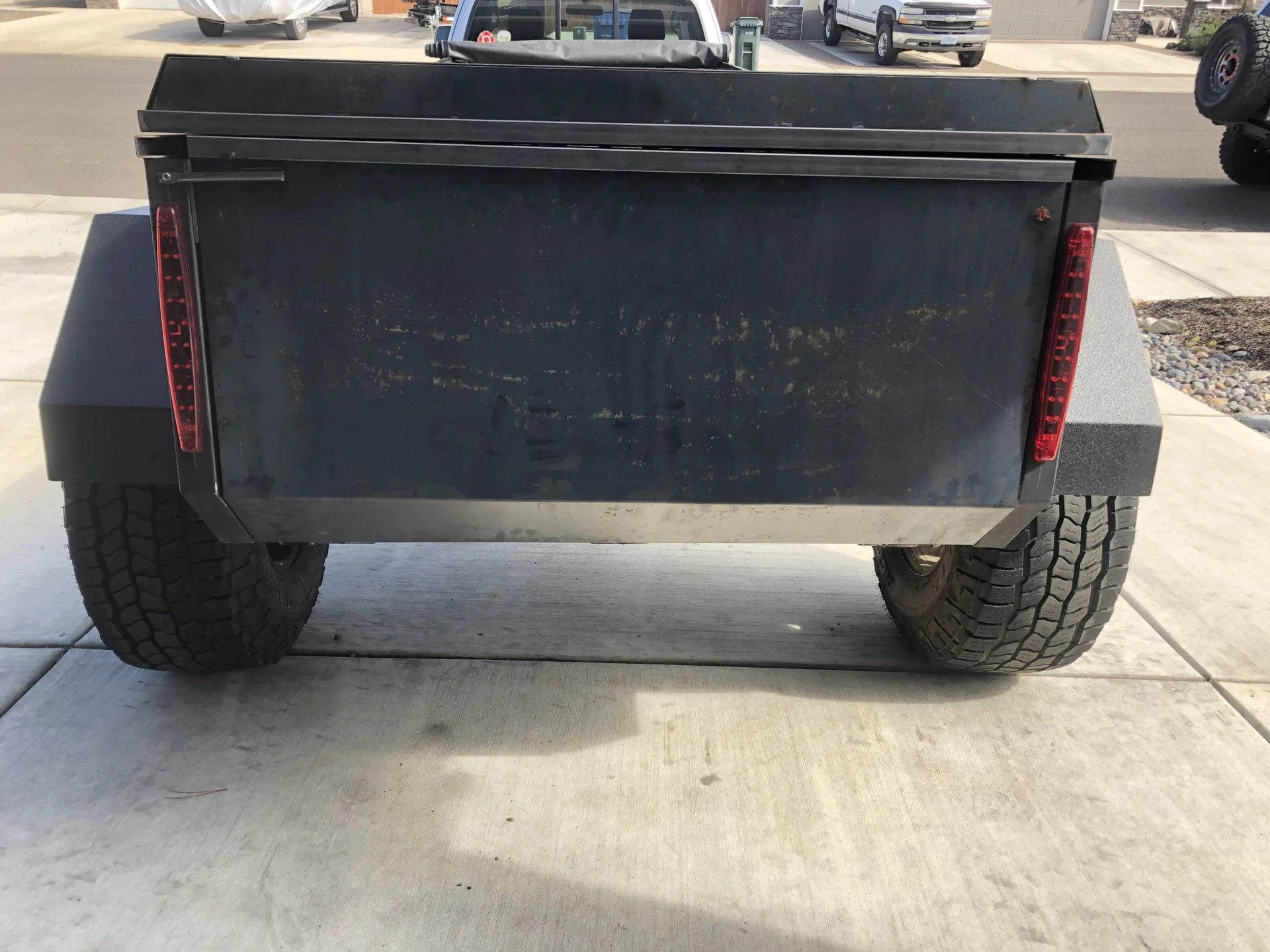

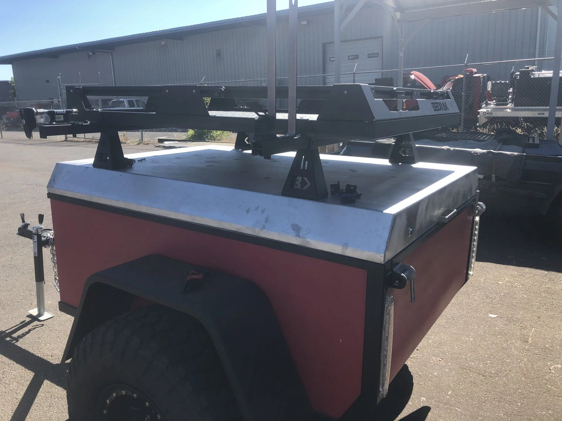

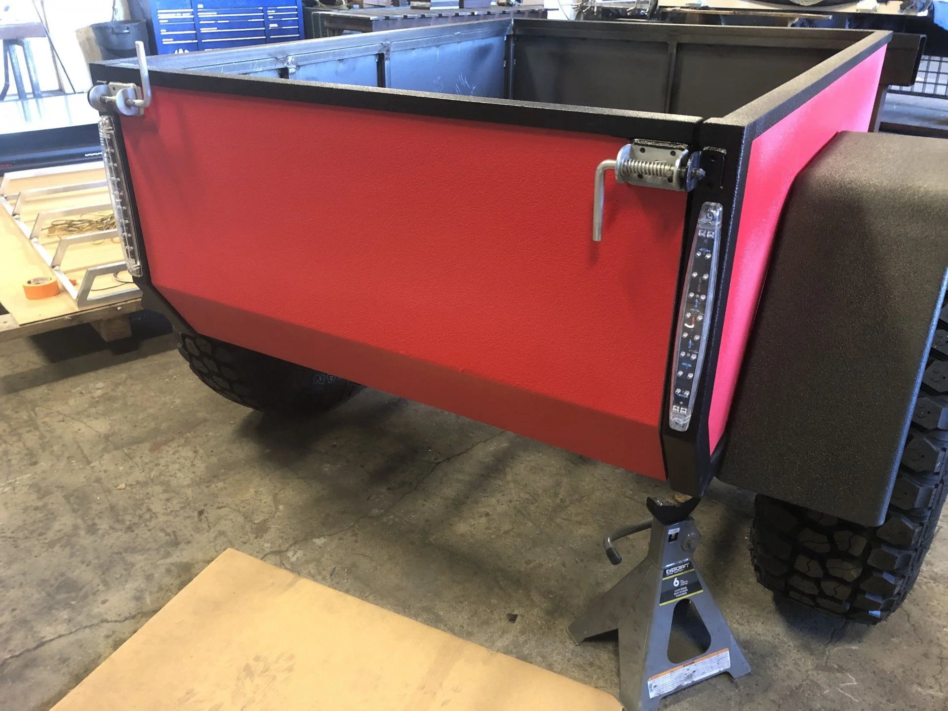

Open To ideas I am not really thrilled with the Tail Gate latches . They work well but just look bla. . Maybe try a paddle style latch ? or something like a center latch like a tail gate ? looking for ideas
I've long liked some sort of over-center draw latch on tail-gates. Orient them to pull all of the slop/play out of the system so that the tail-gate doesn't bang & clang. Very first trailer that I built (for a garden tractor) used some latches from a Chevy LUV.
