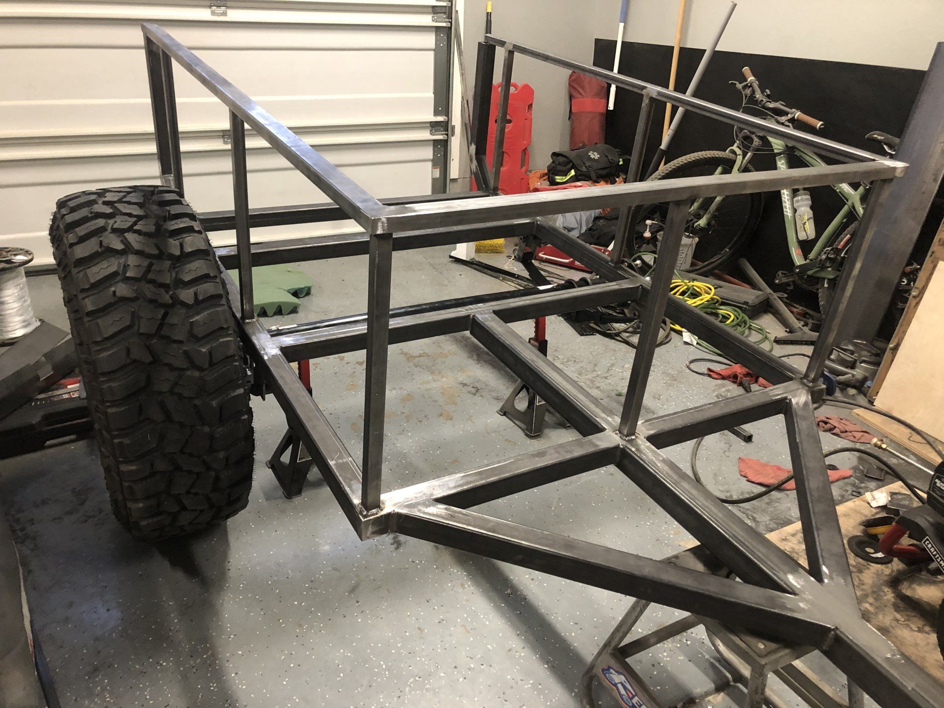

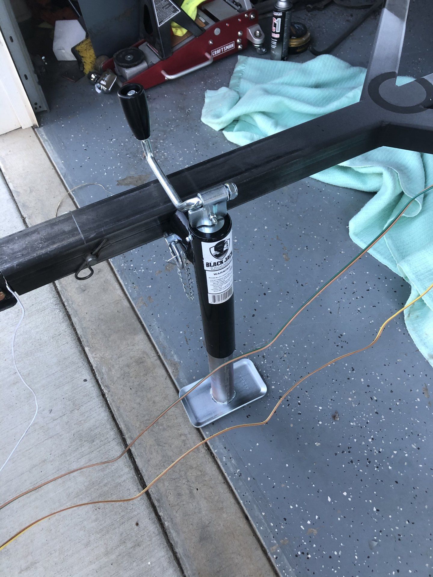

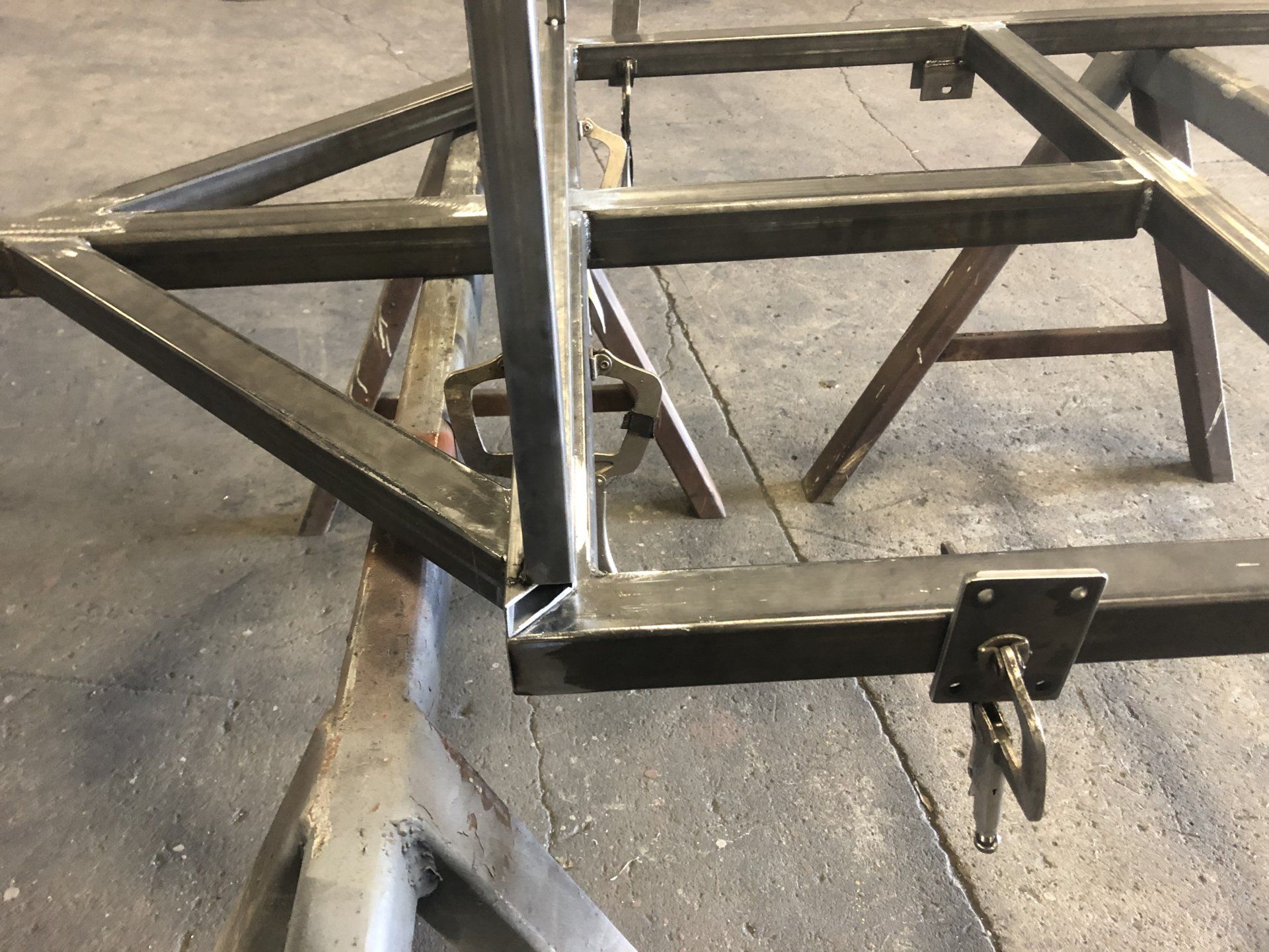

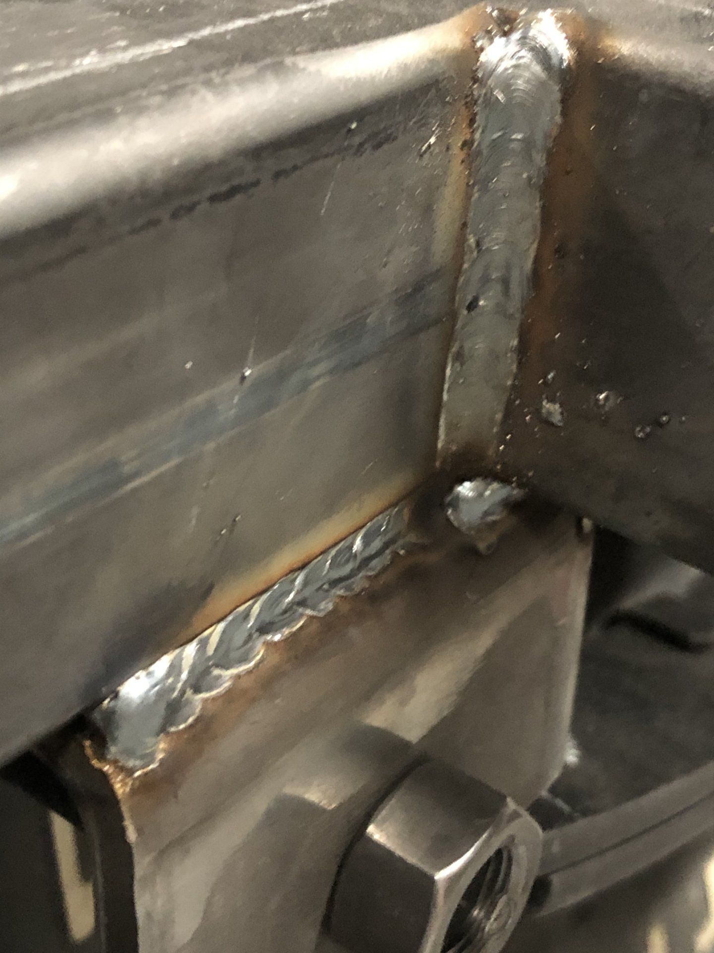

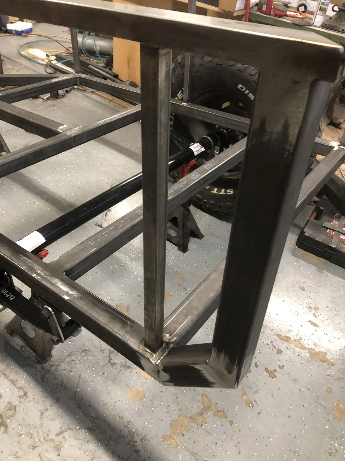

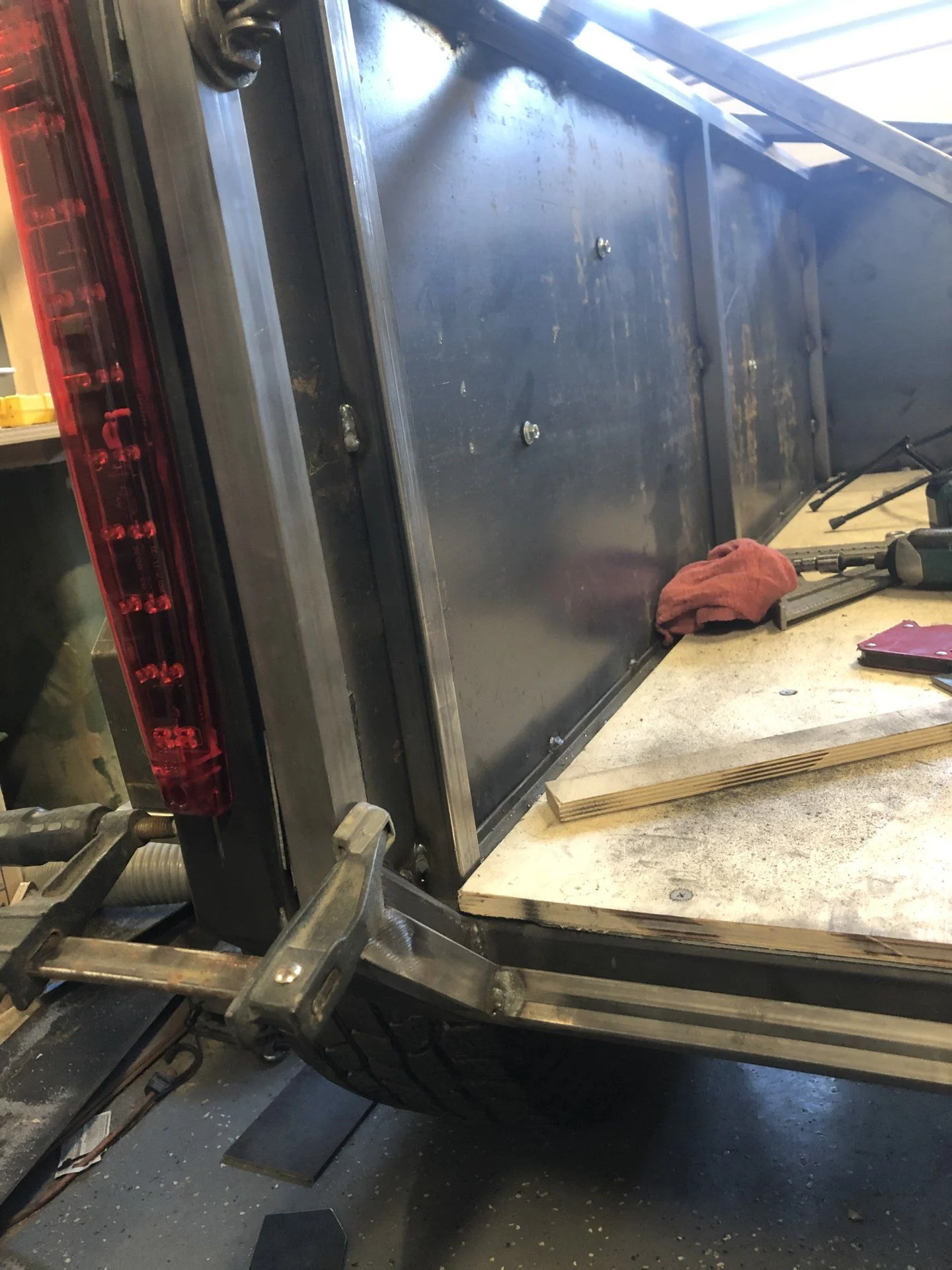

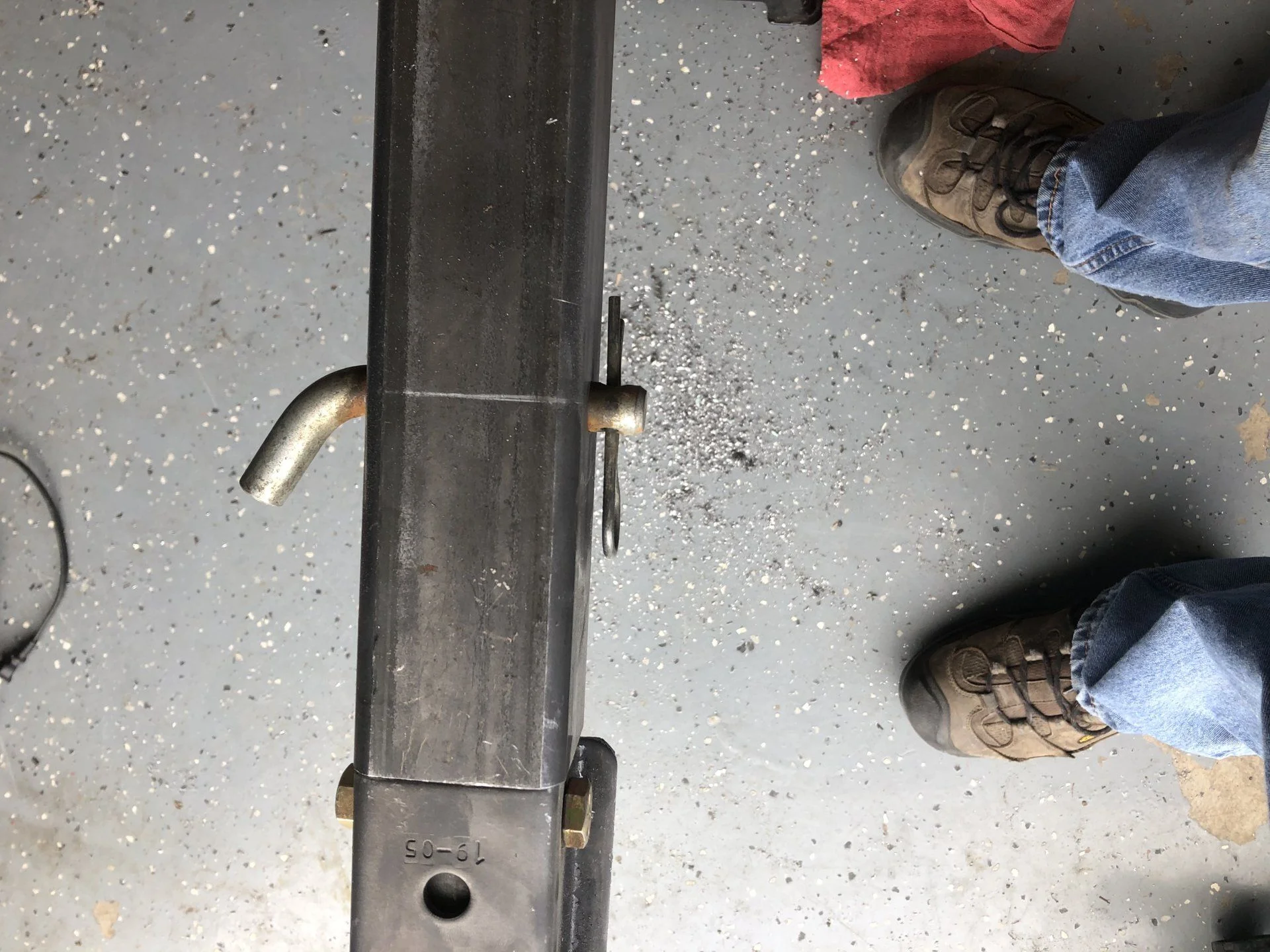

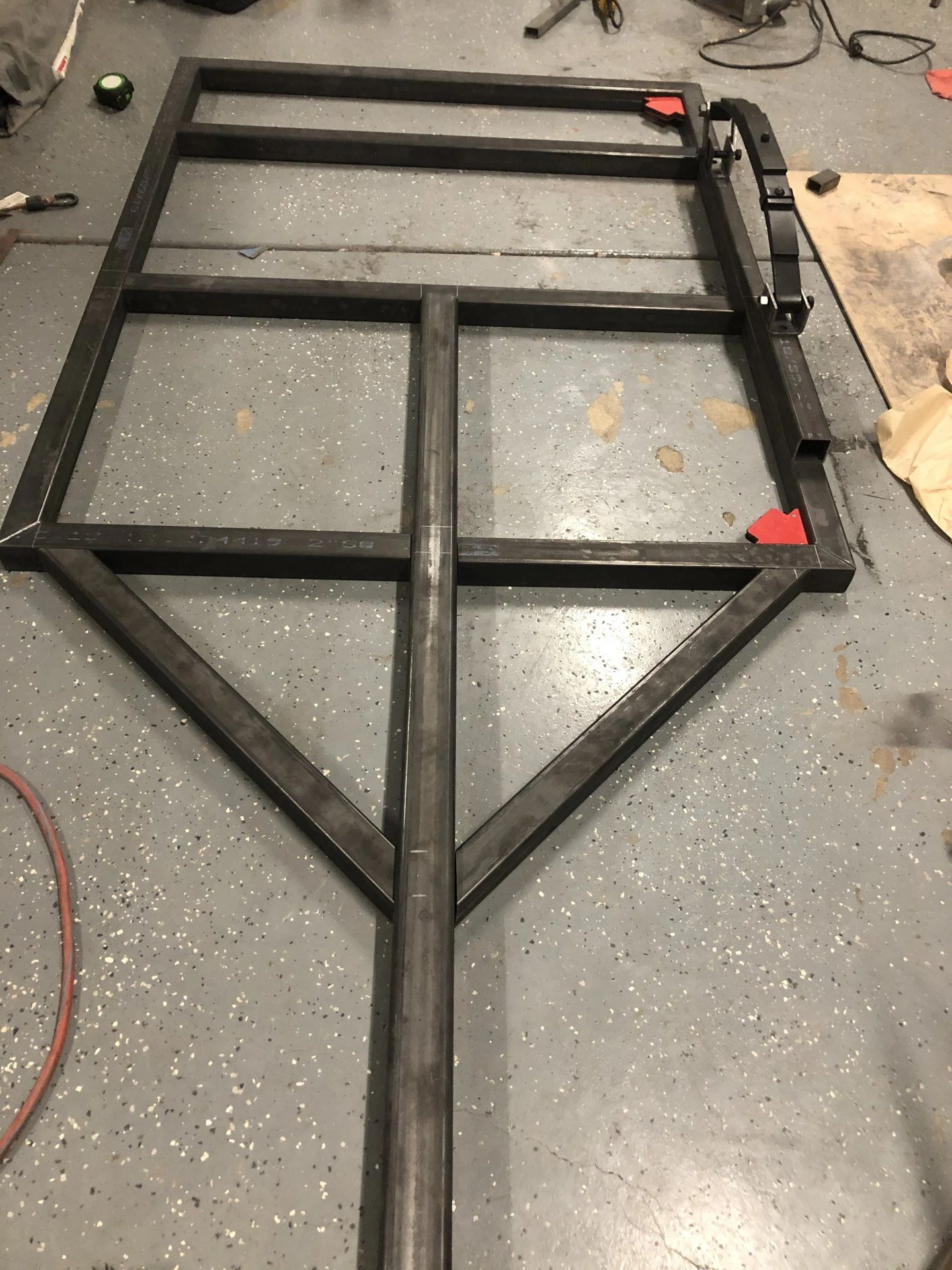

I started this project a couple days ago. I have never done anything like this so learning as I go but so far it’s turning out good I think. Hope to get it pretty close to being done this weekend

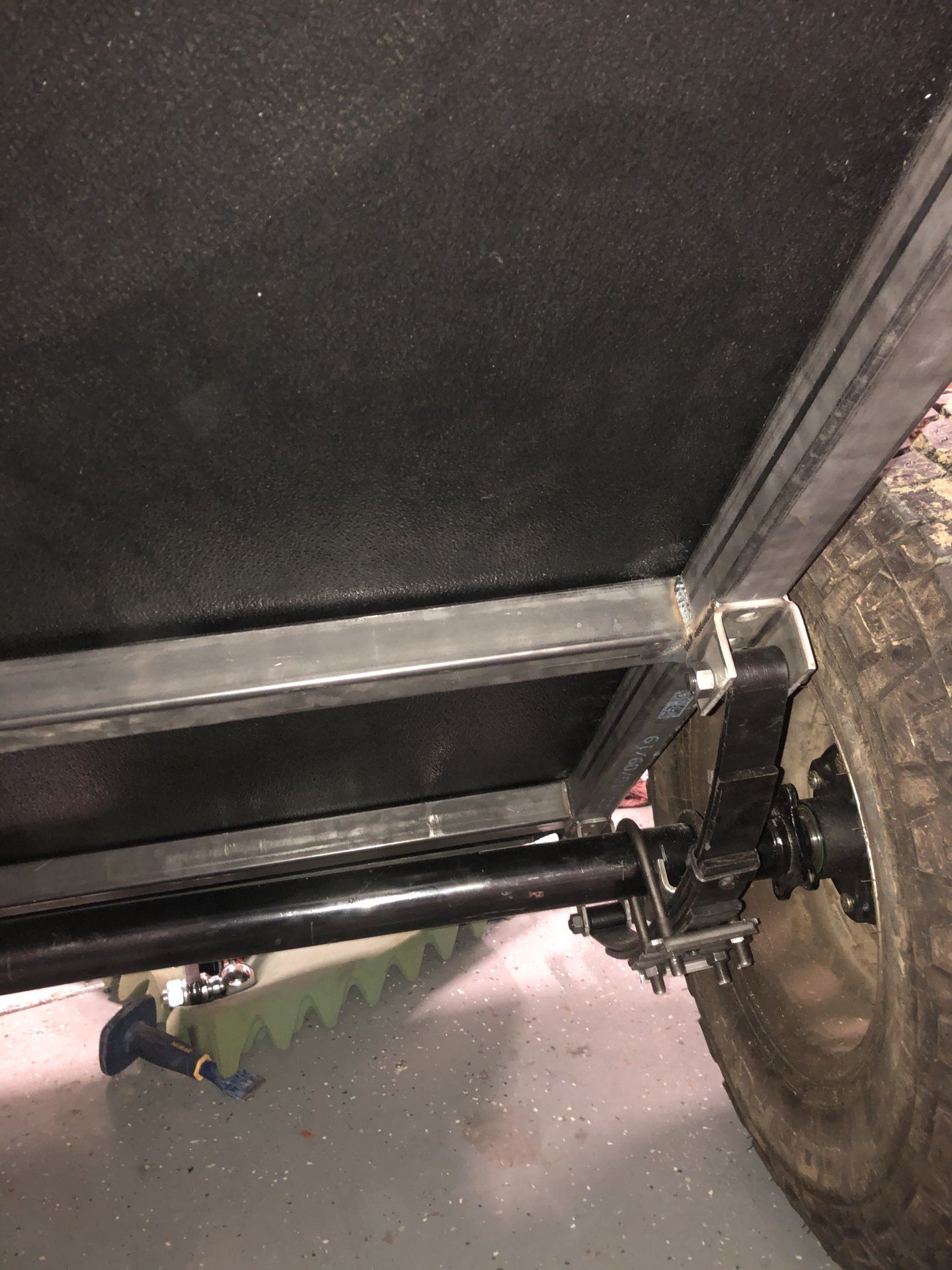

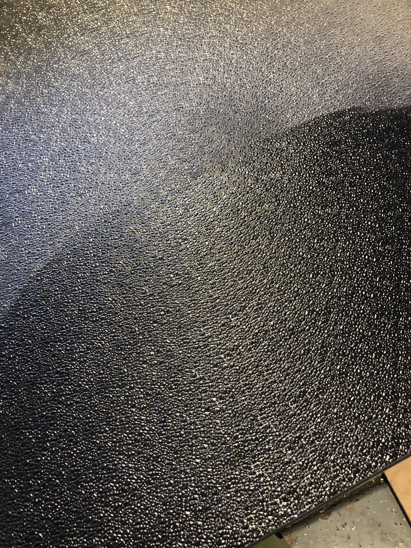

I laminated the FRP to the bottom of the Ply . Now it is 100percent water proof from the bottom
Here is a pic of the underside

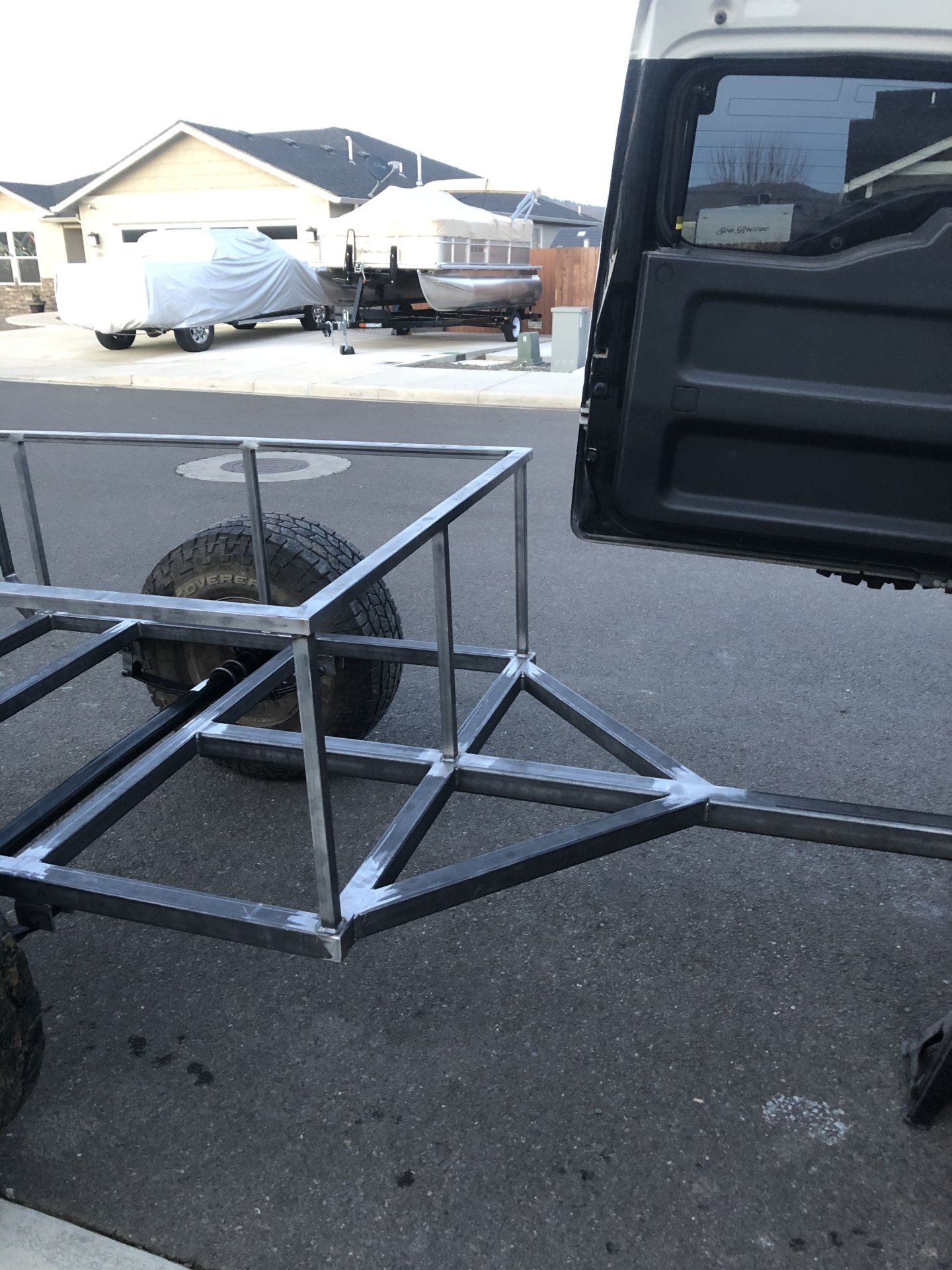

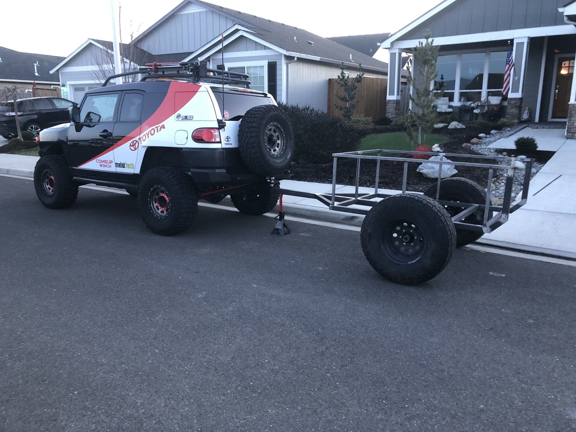

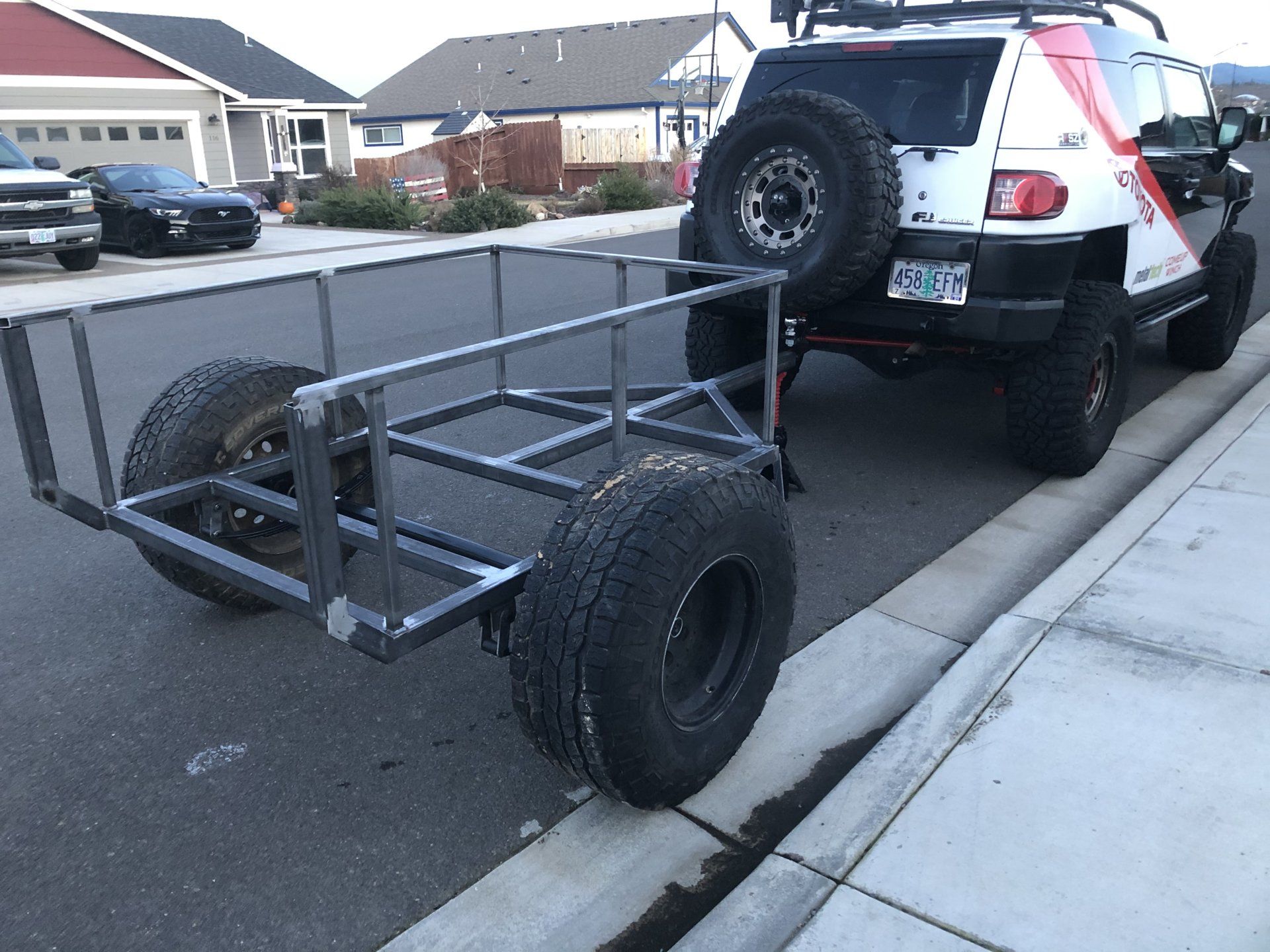

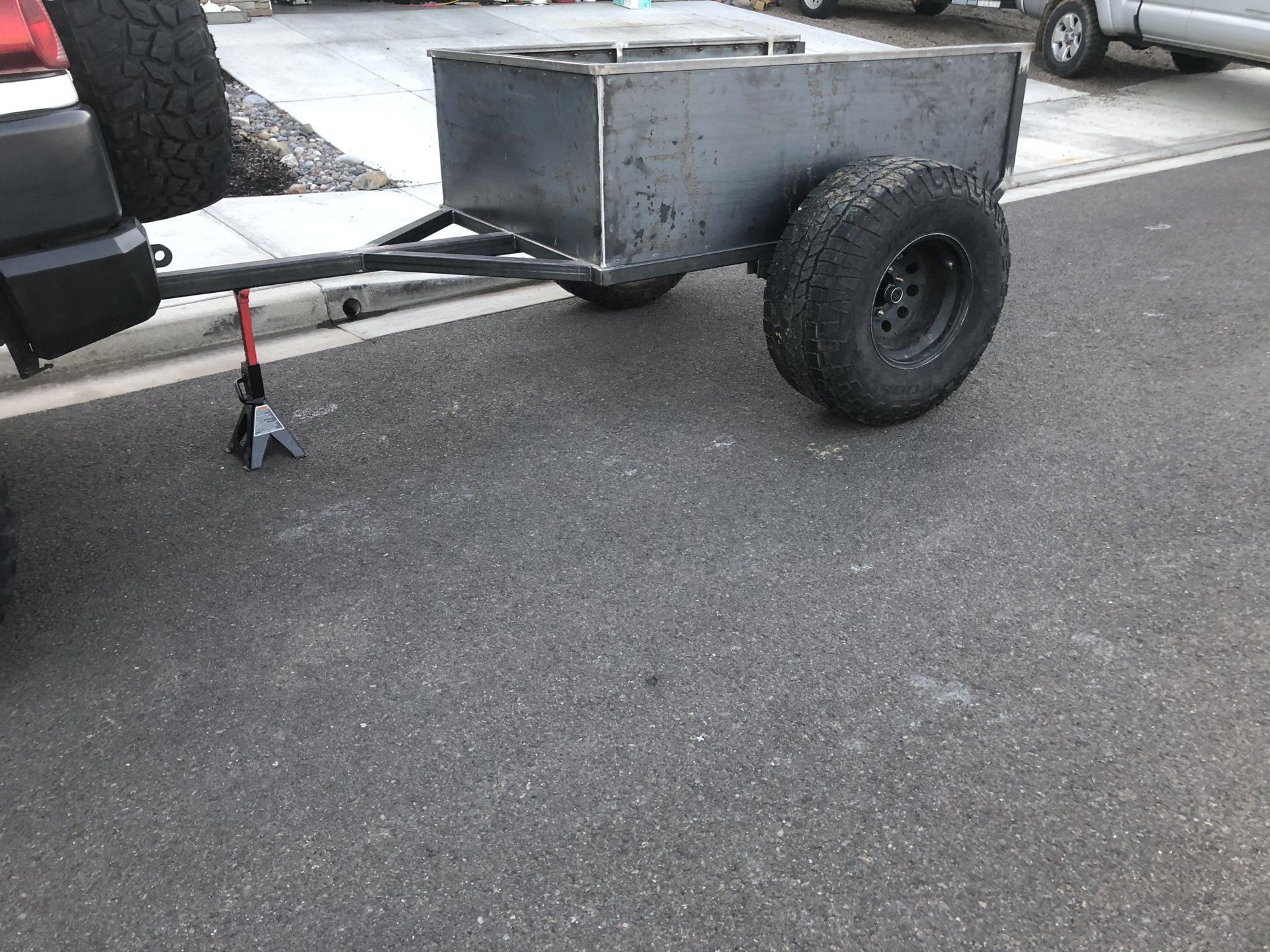

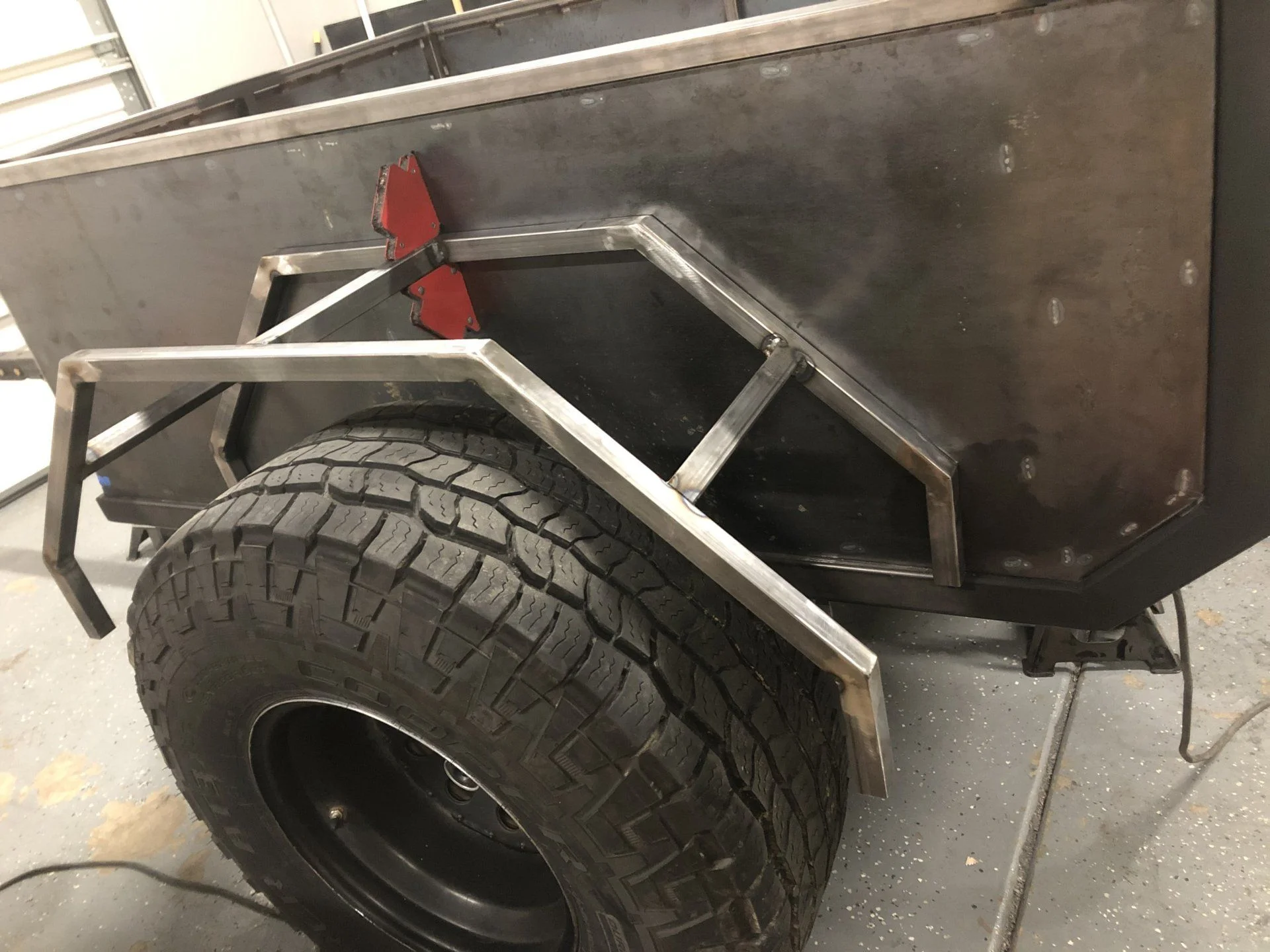

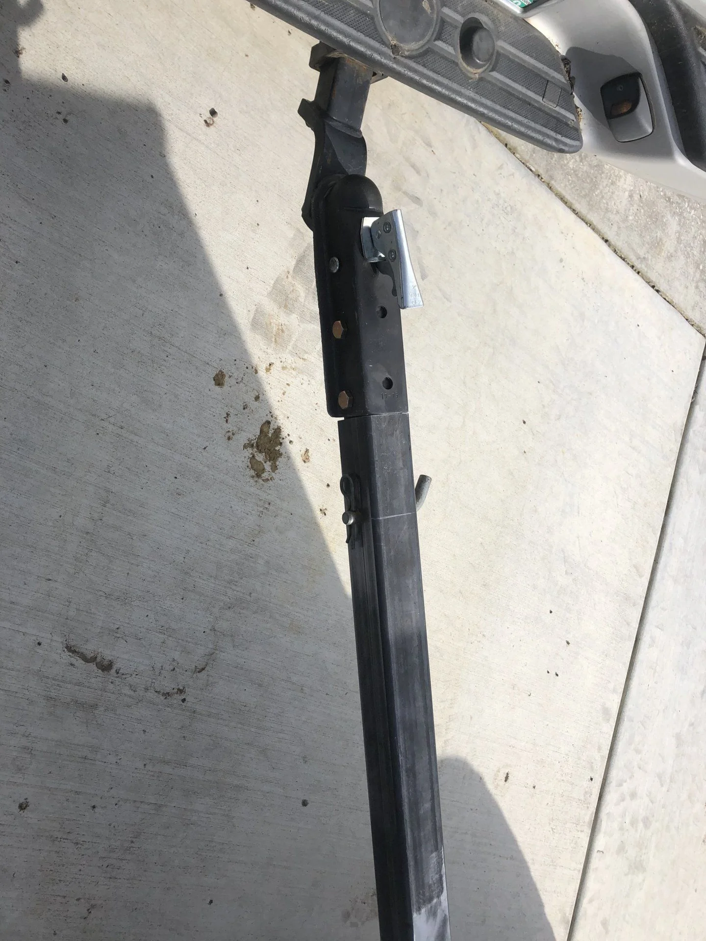

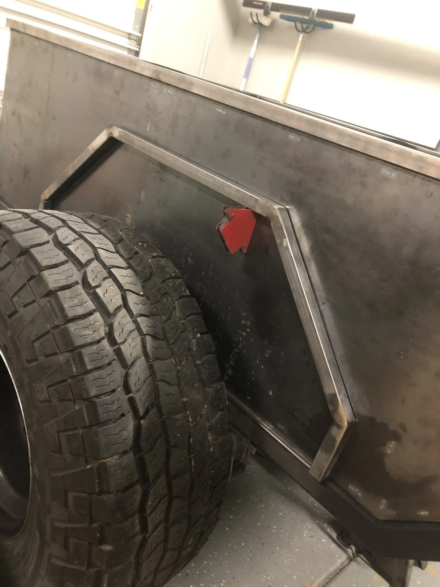

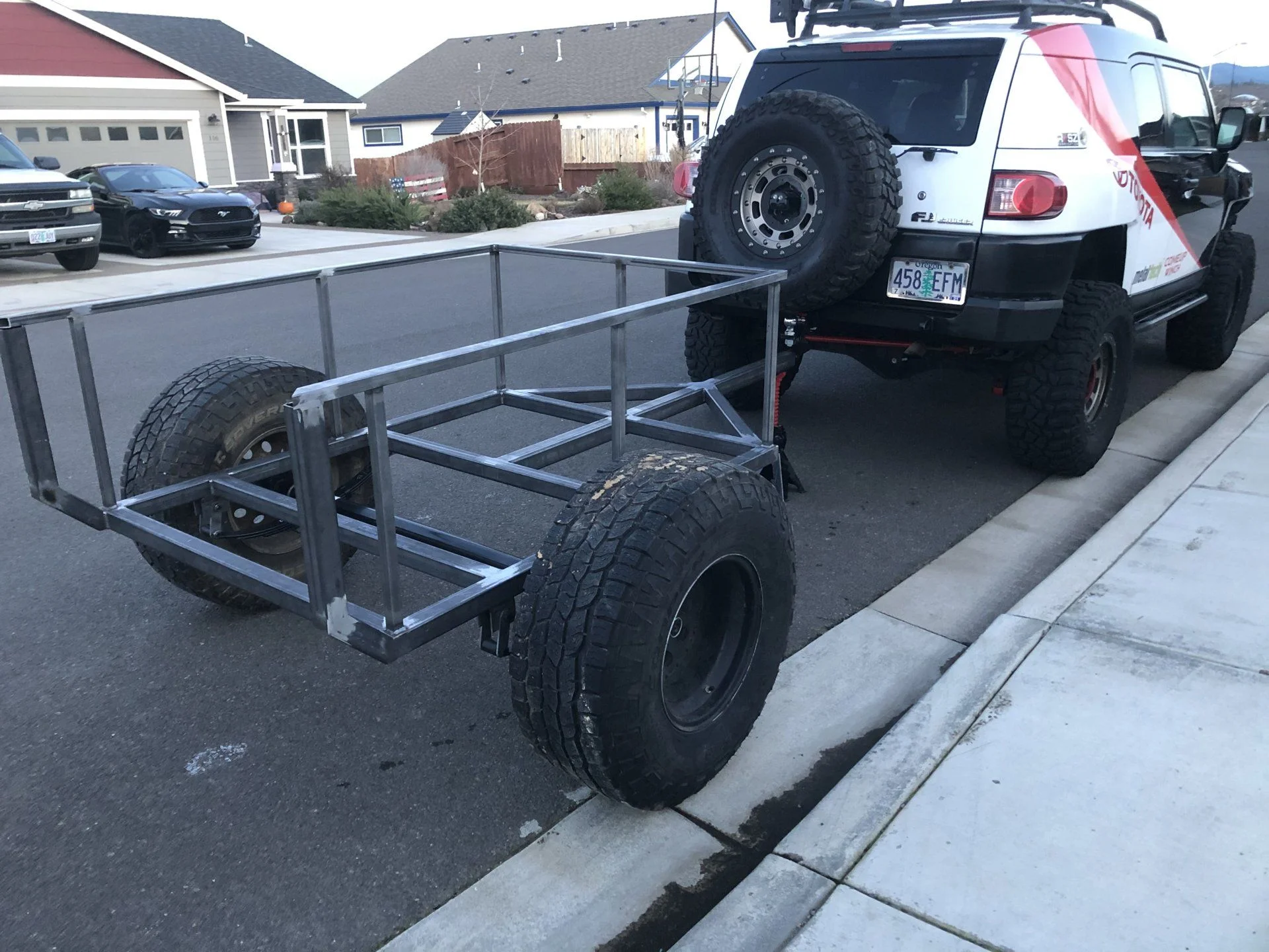

Took her for her first drive around the block. Pulls great. Can’t even feel it behind my truck. And easy to back up also . Now I can work on the fenders and lights

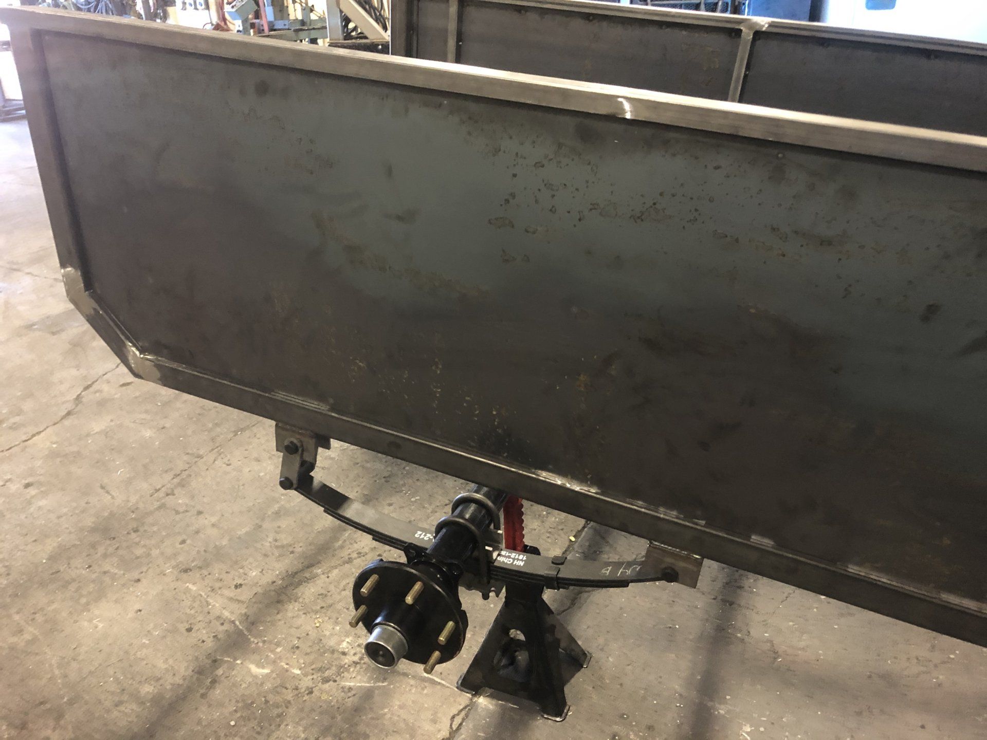

It’s a start

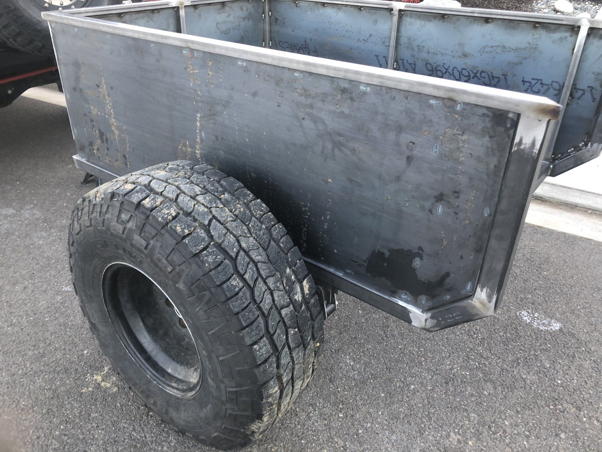

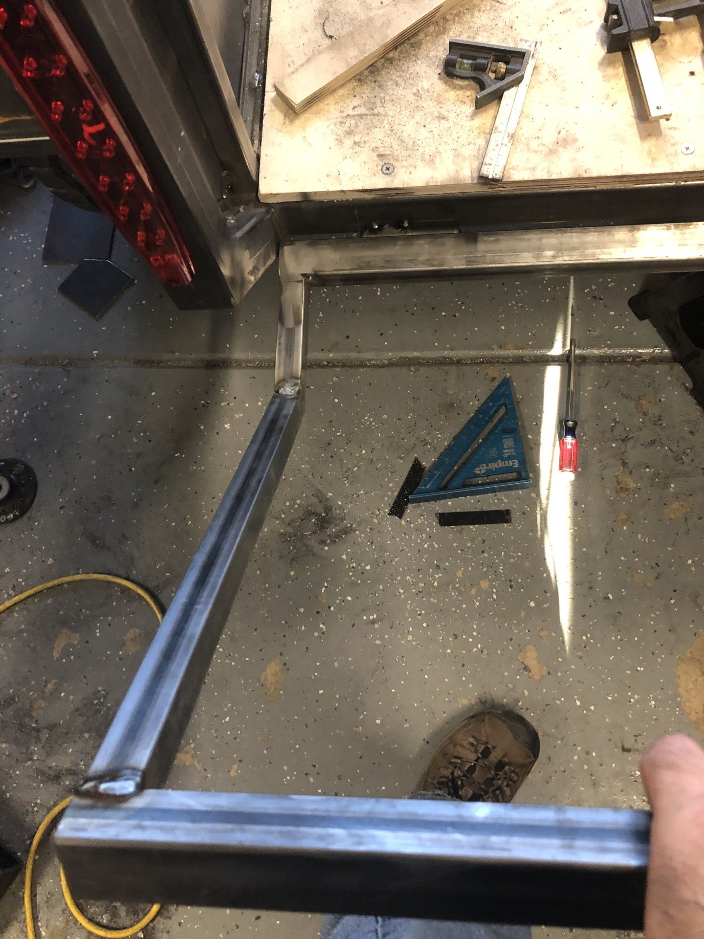

A little more
Looking good. I have been looking for trailers this week. Did you design your own frame or find a plan? How much in materials do you figure it would be? Do you have a strong welding background?

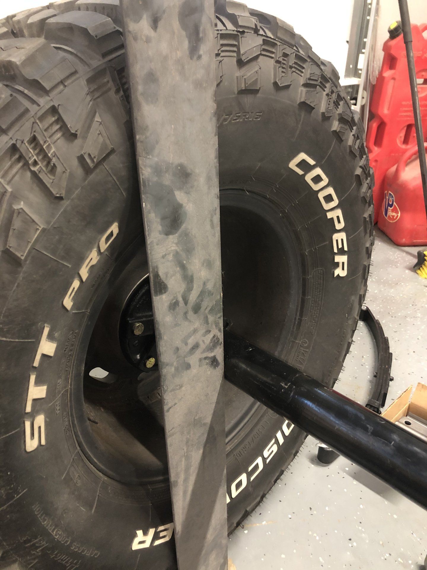

I just kinda built it . I knew I wanted it to be 4x5. .i bought the Axle and mounted the wheels and tires . I was able to determine the frame dimensions then . I will be about 1500 when it’s done . But then I am getting matching wheels and tires to my FJ so I would say 2500 all in .

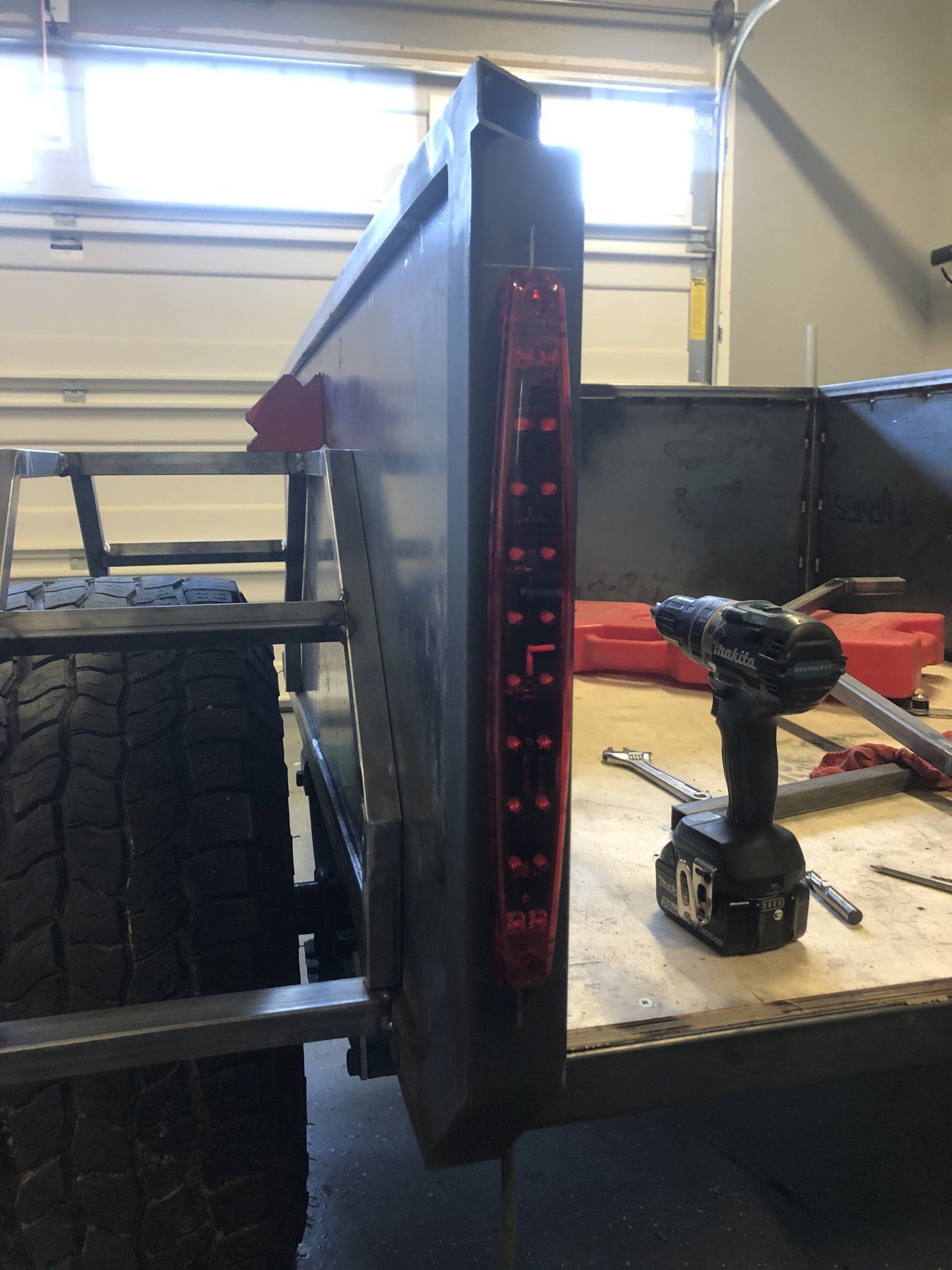

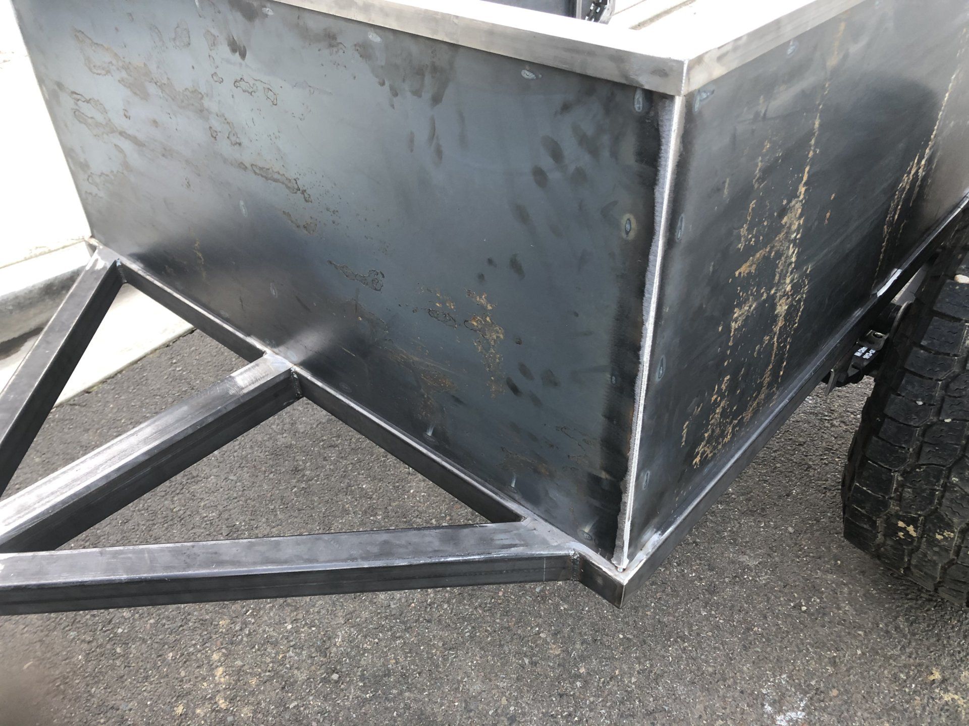

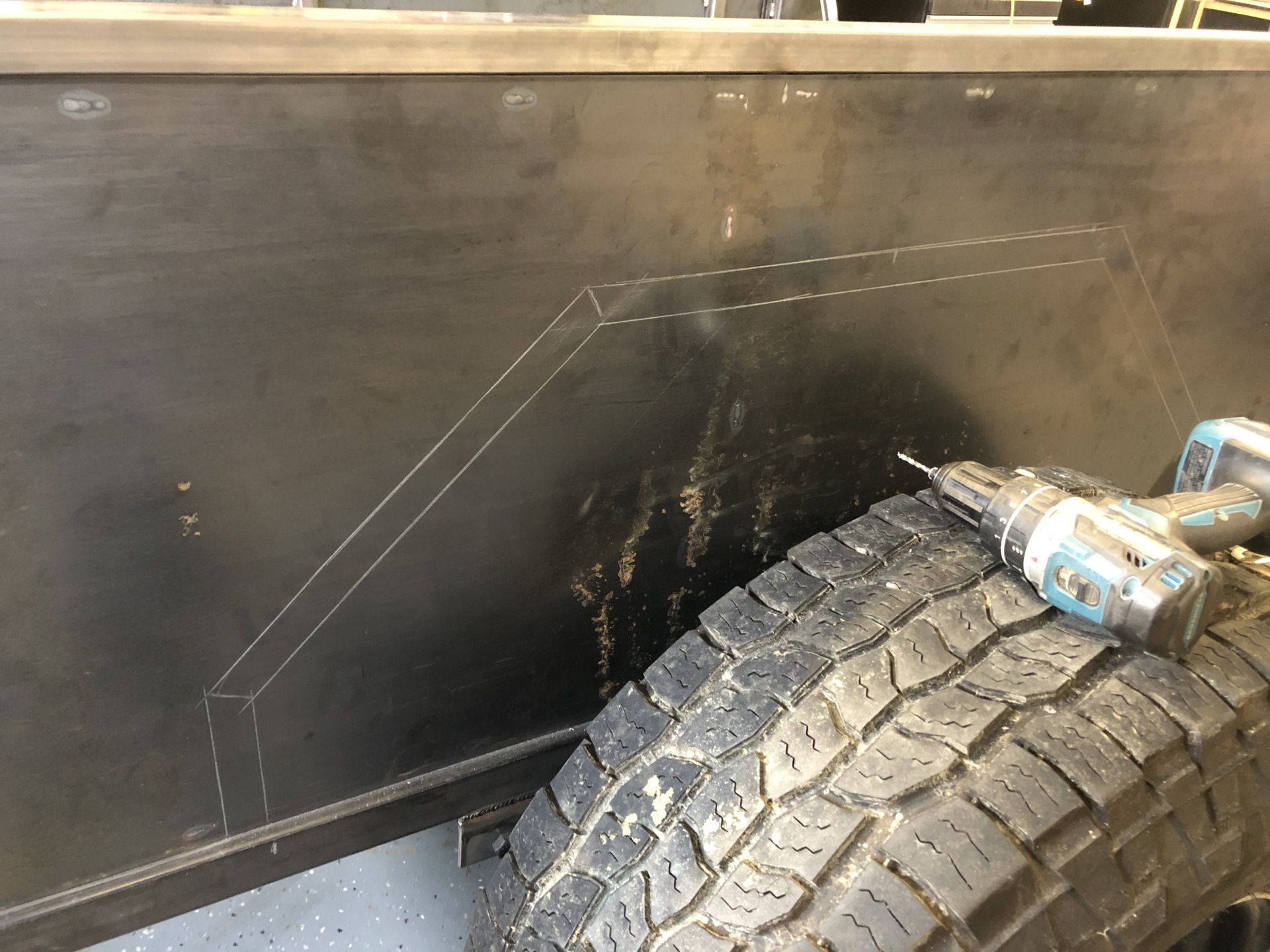

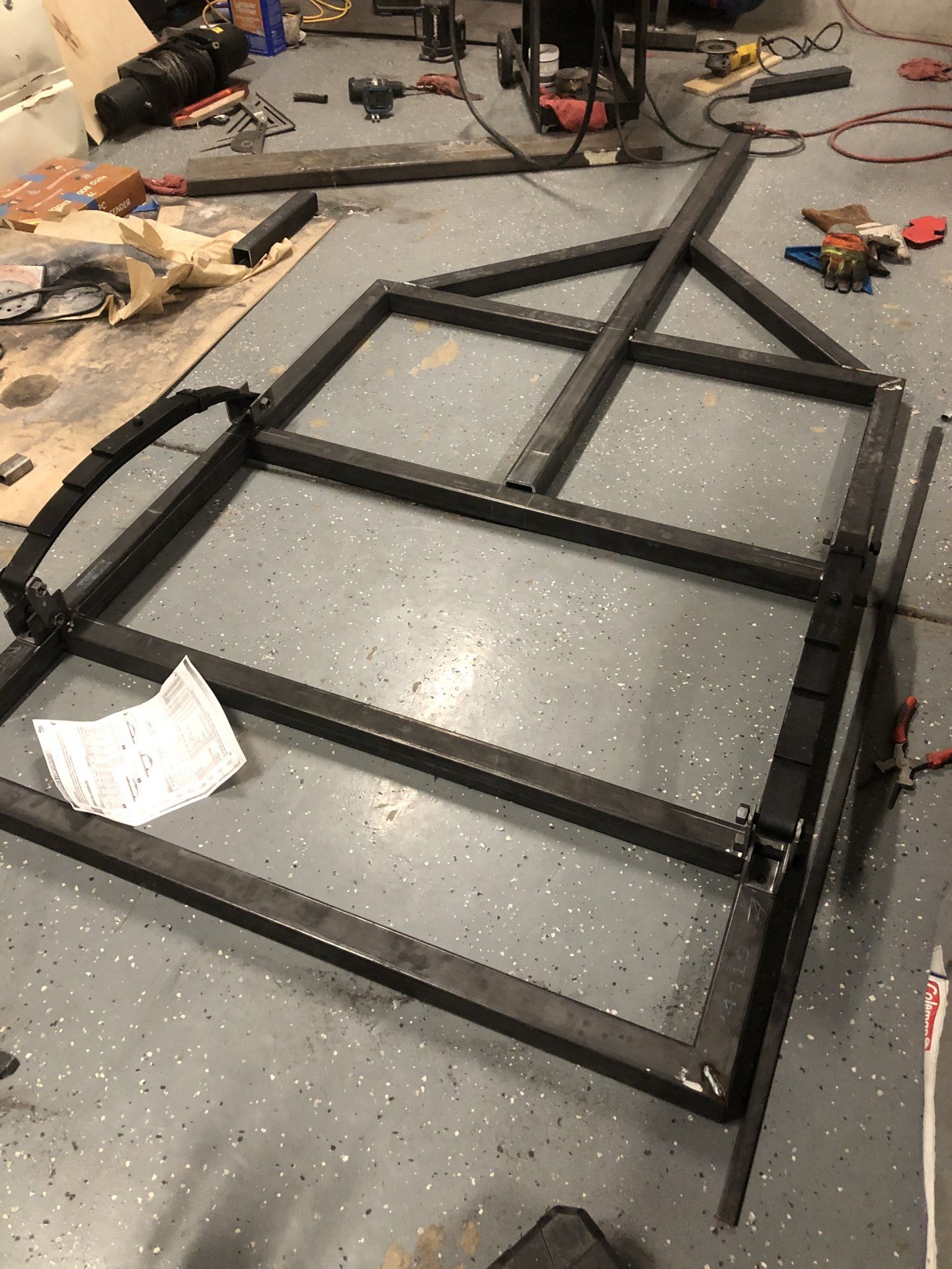

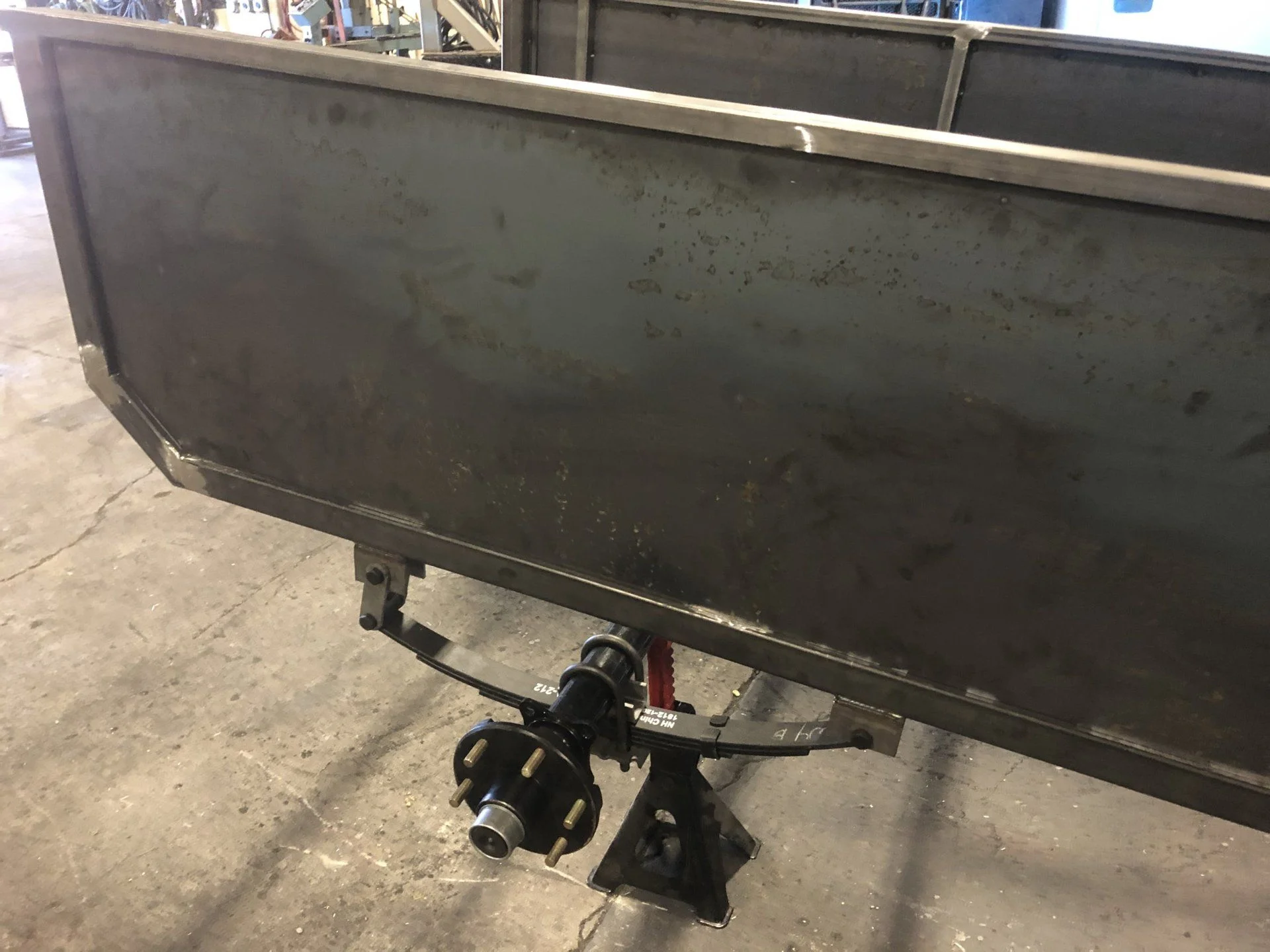

a little more done

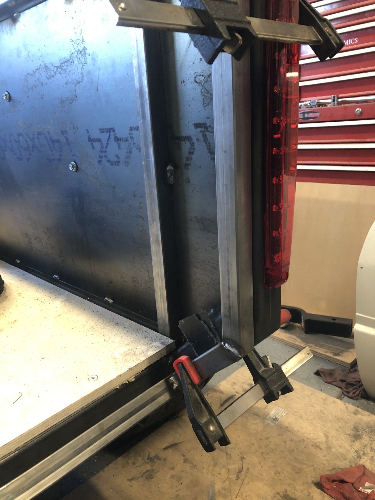

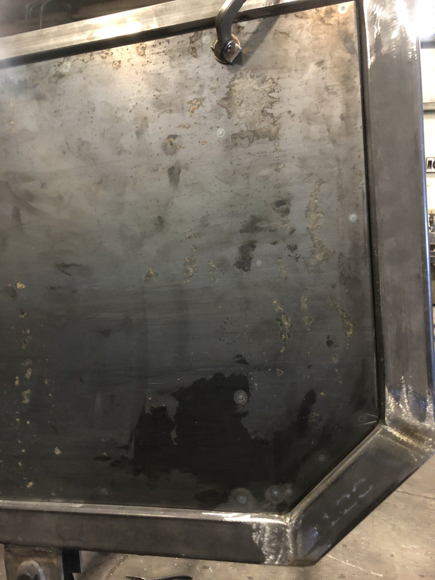

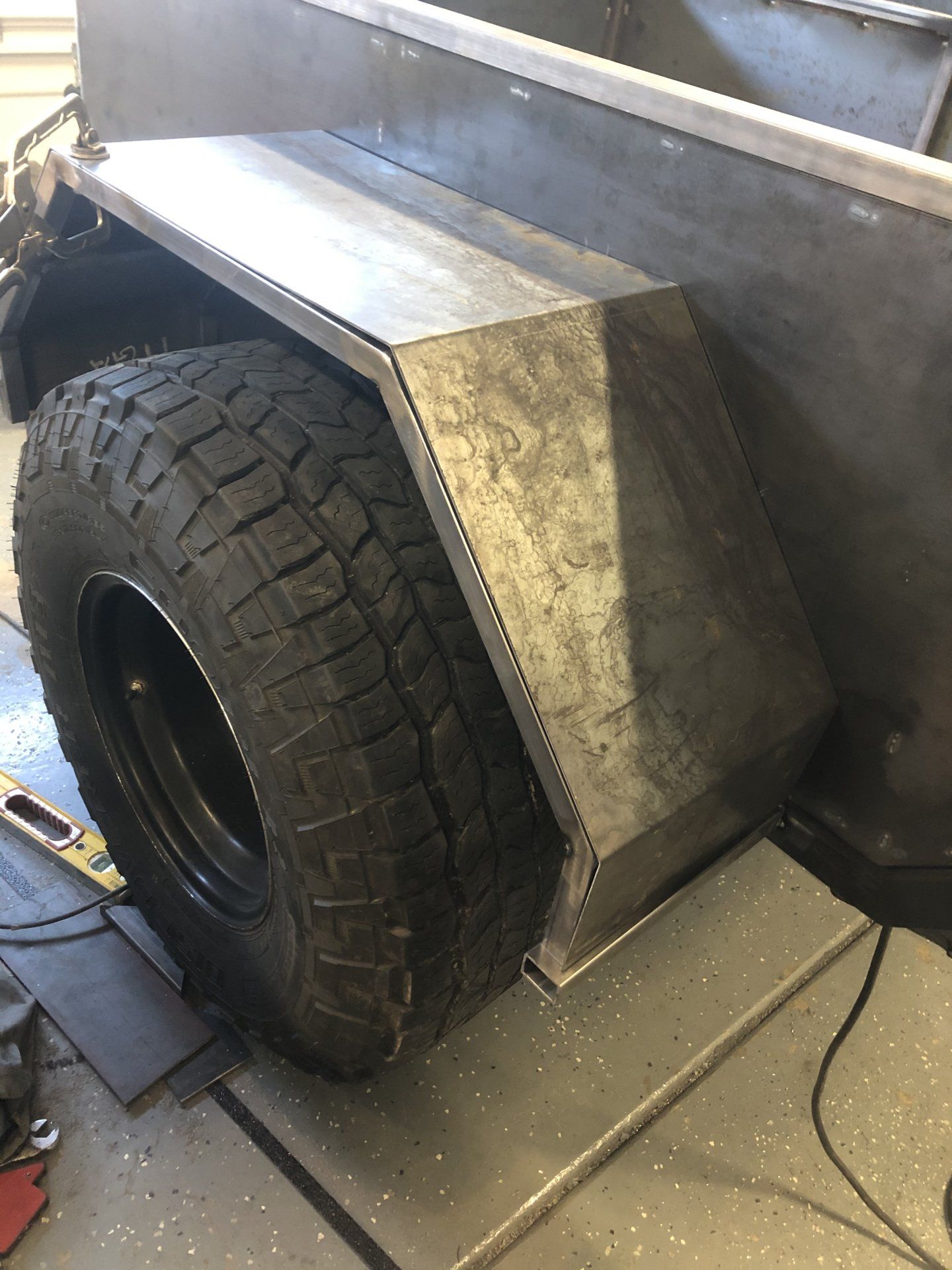

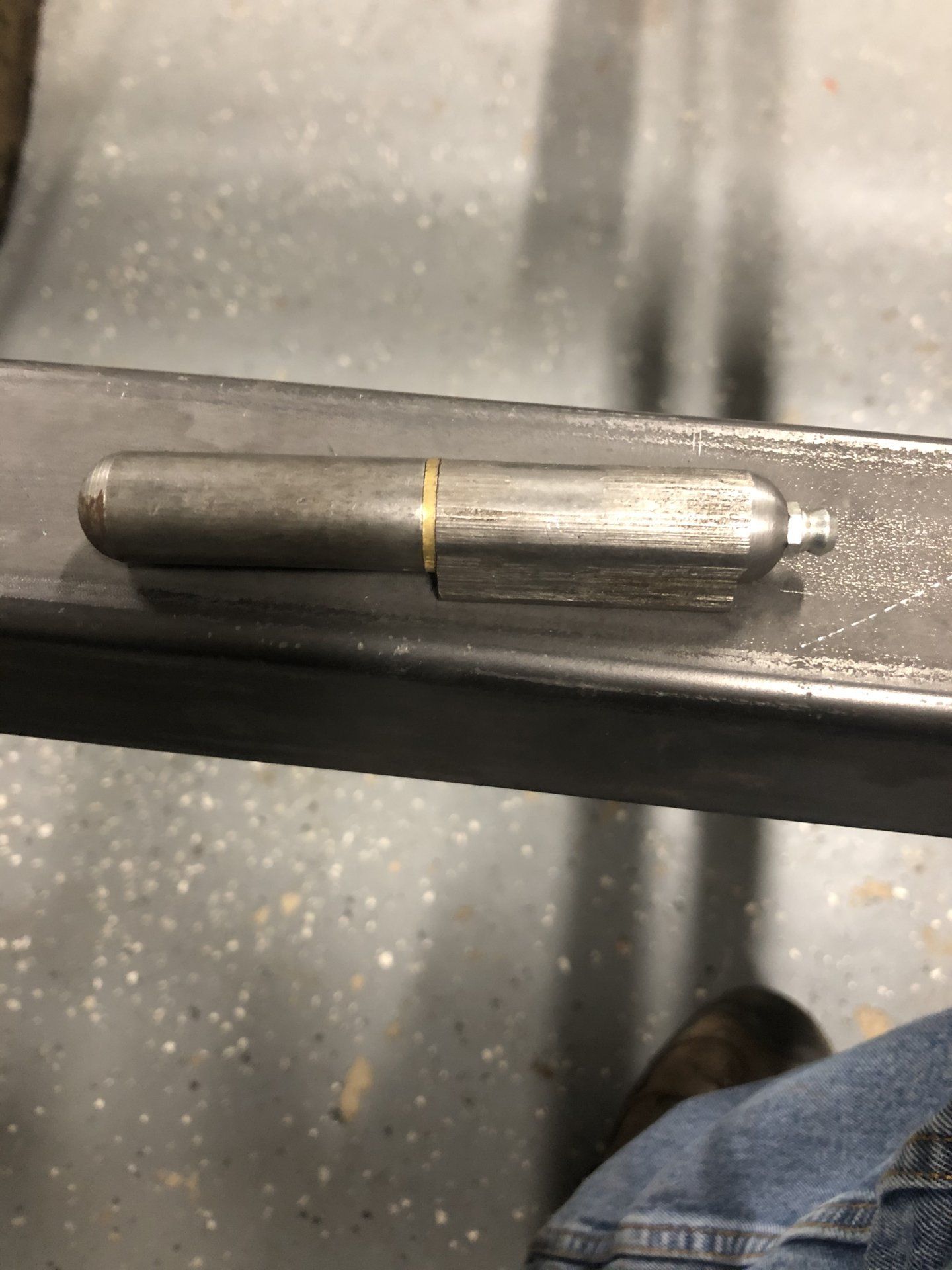

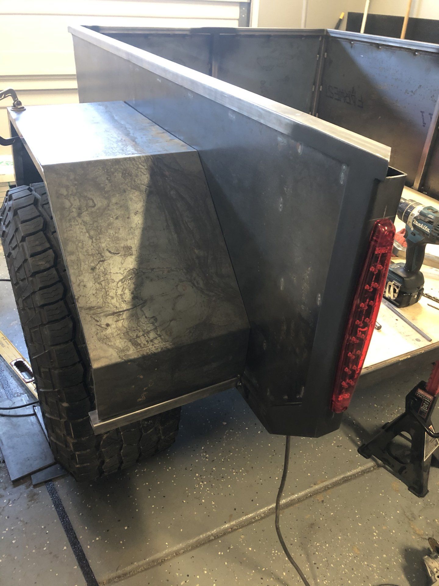

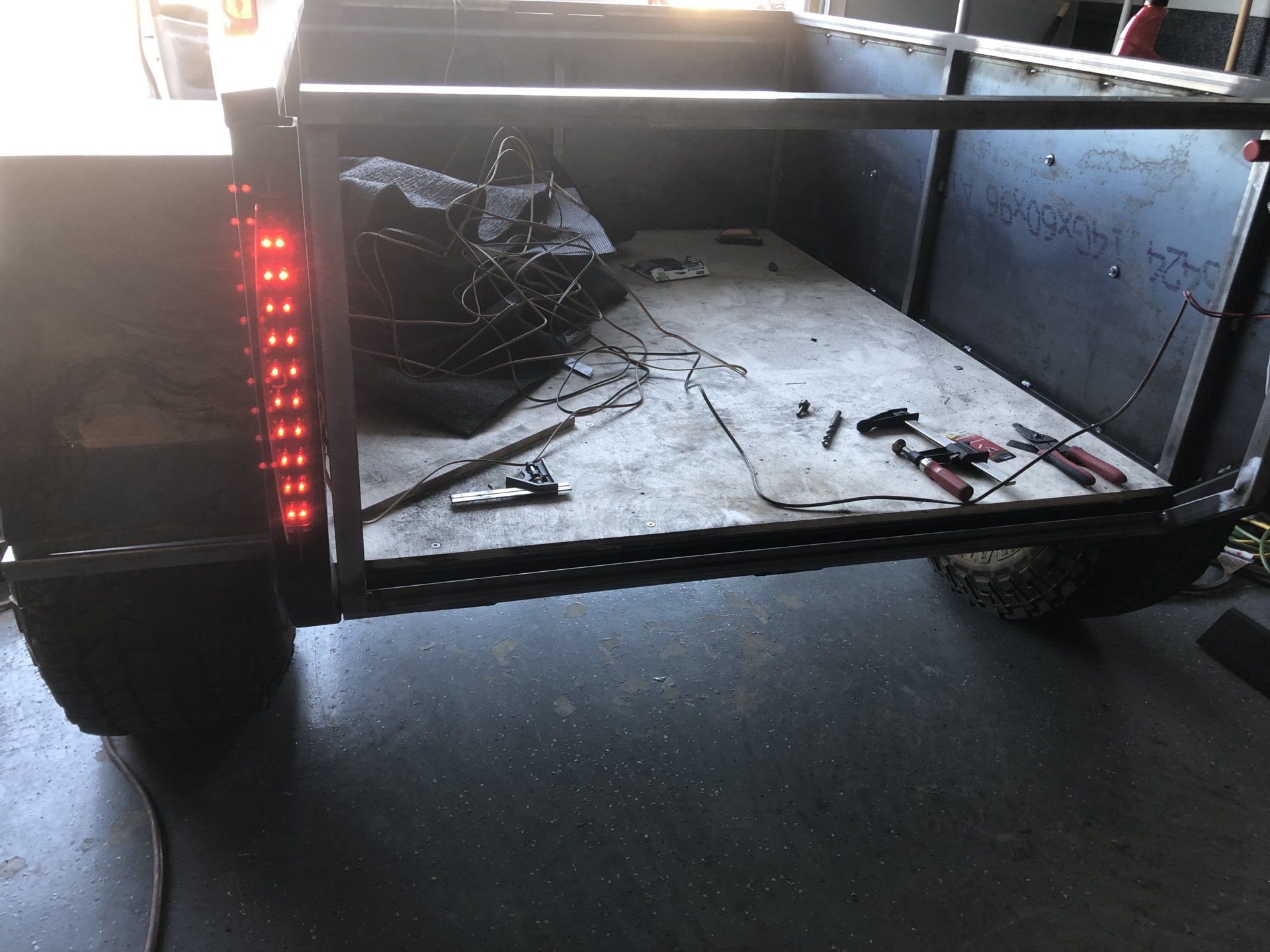

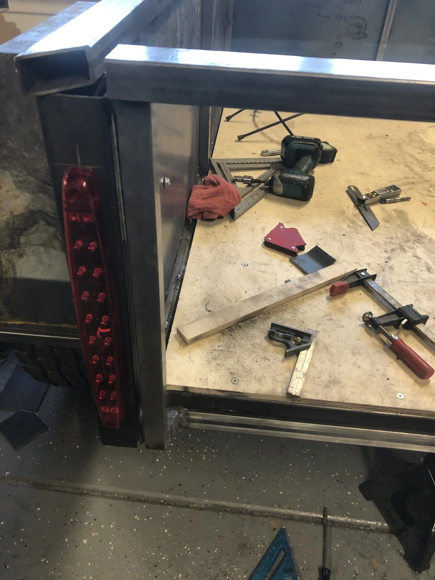

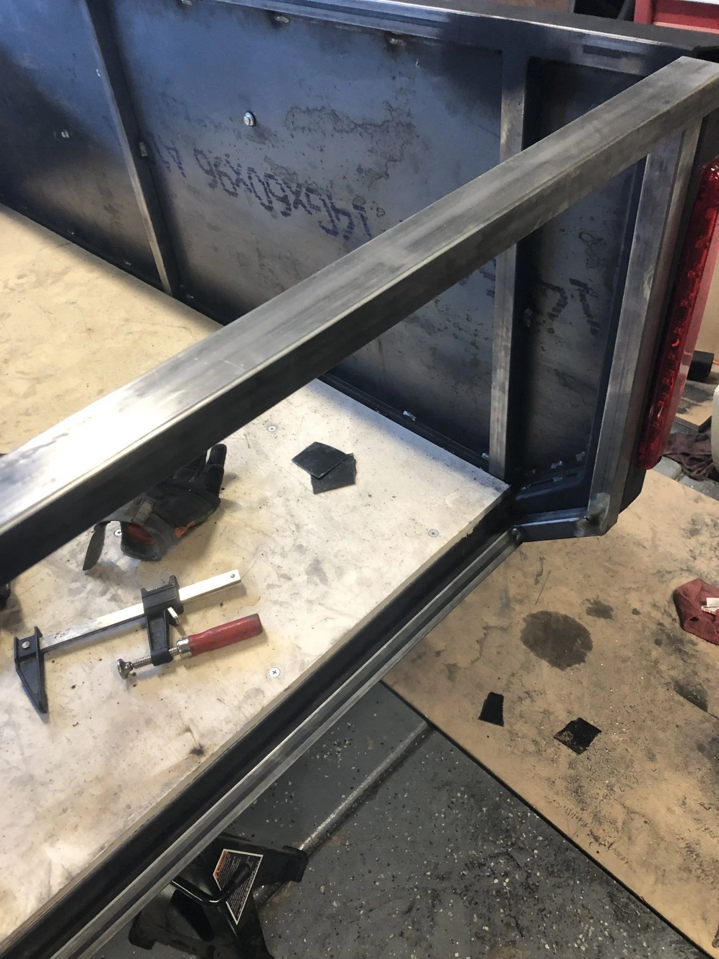

Started the tail gate. And it works now😀

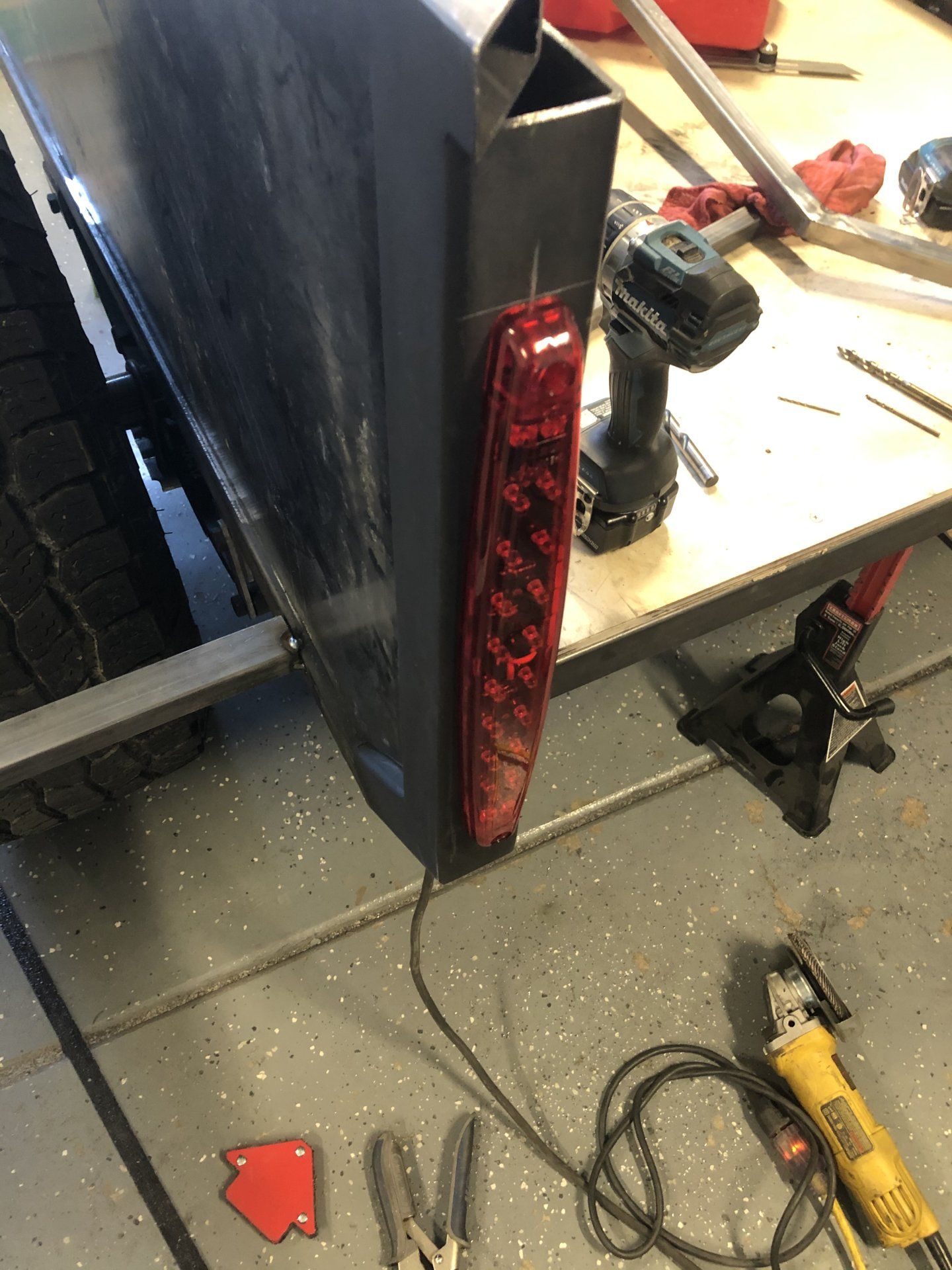

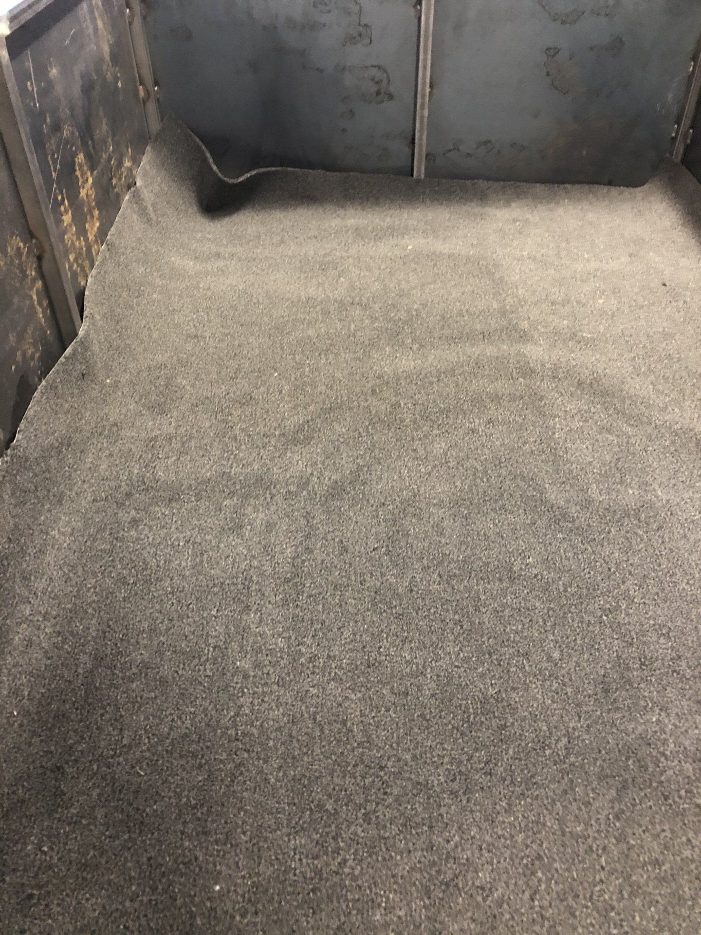

Took a break for a few days but got I little more done tonite
I took it down to the truck scale and it is #520lbs. Not bad considering the wheels and tires are at least 200 . When I put my new wheels and tires I should be about 500 .
