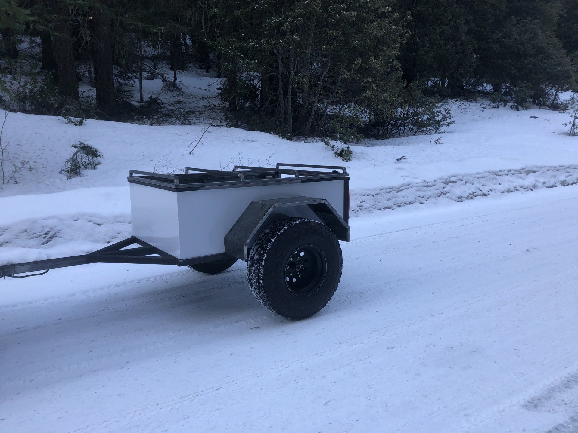

My attempt at a trailer
A little closer

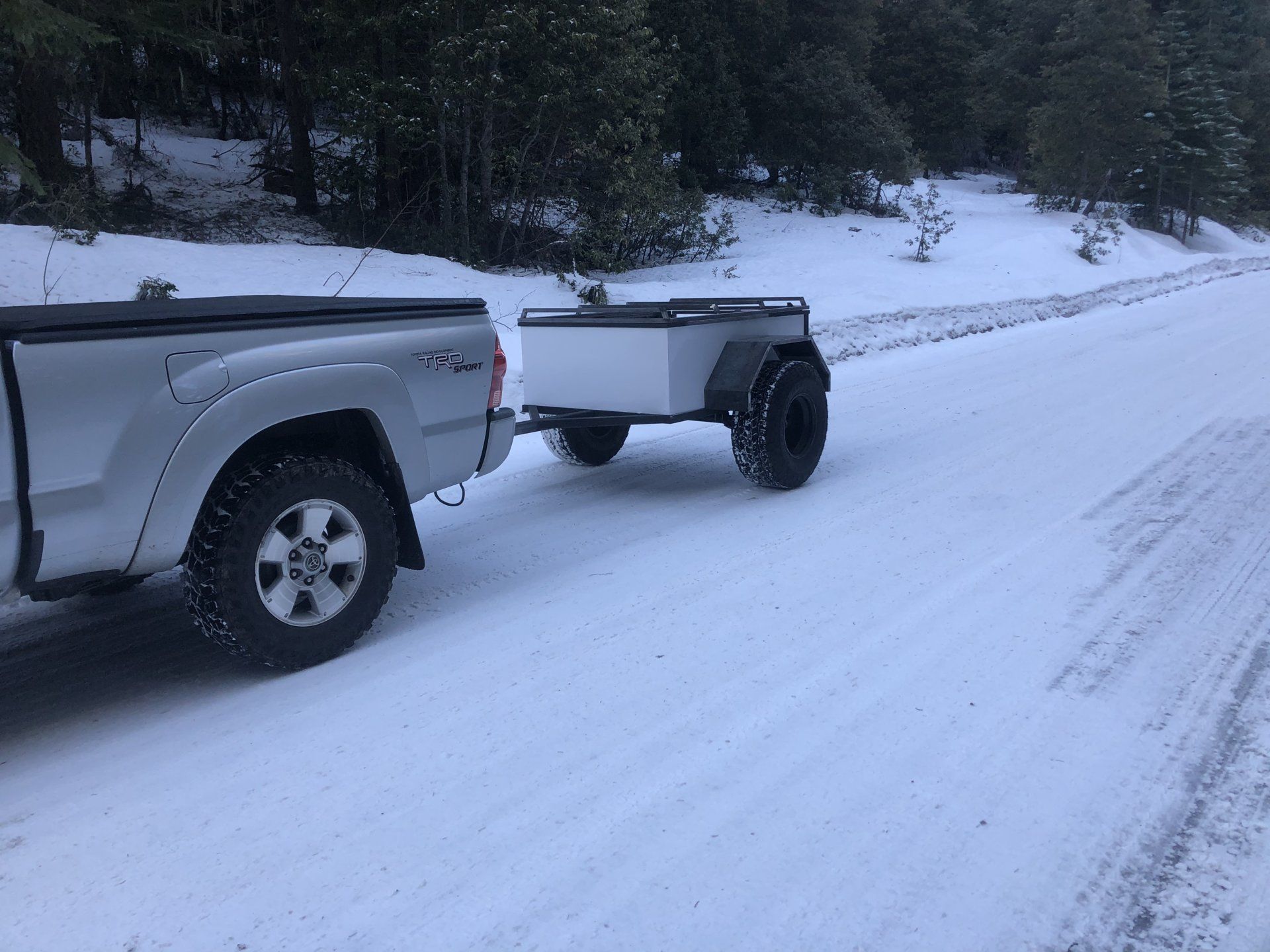

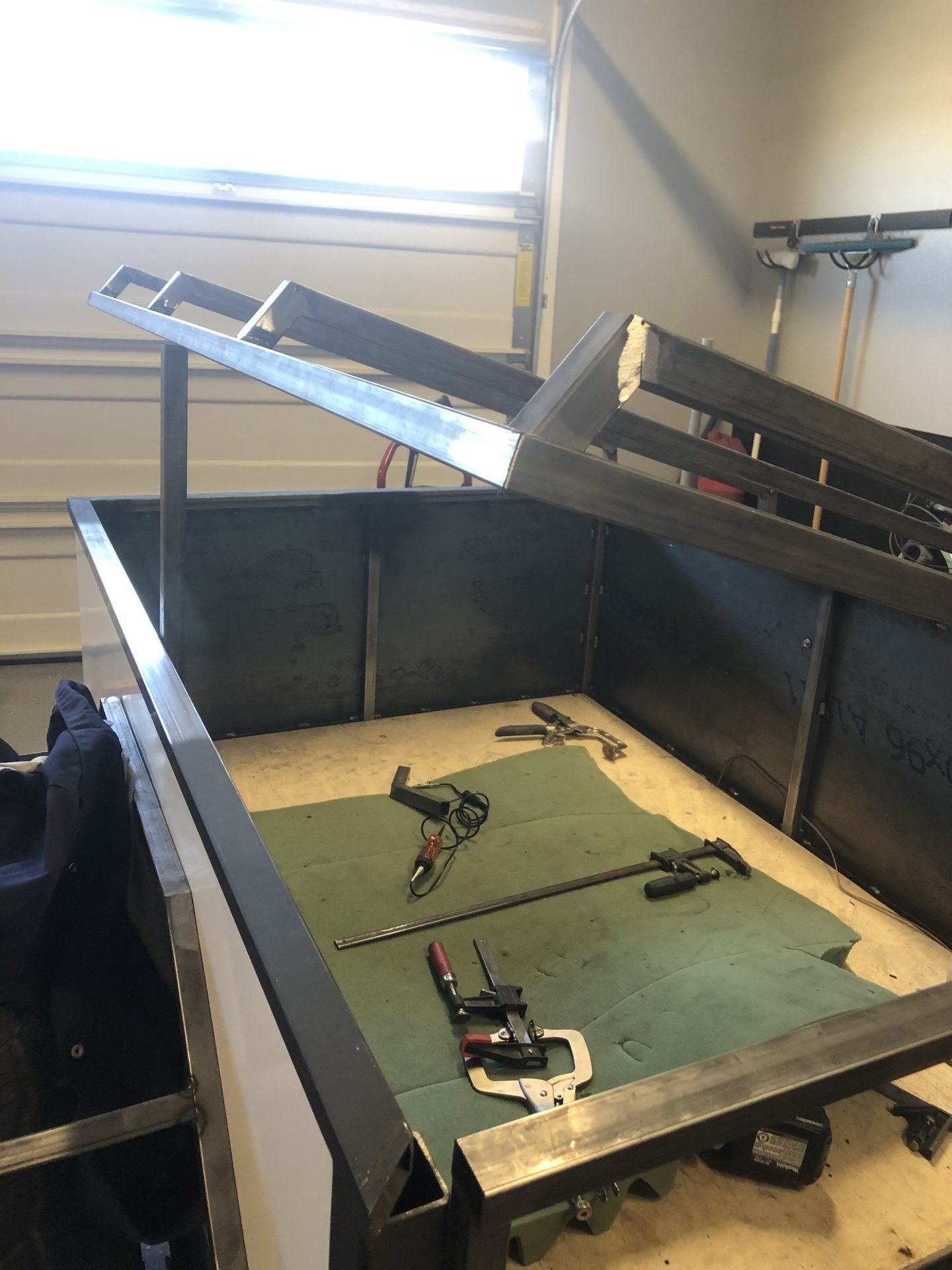

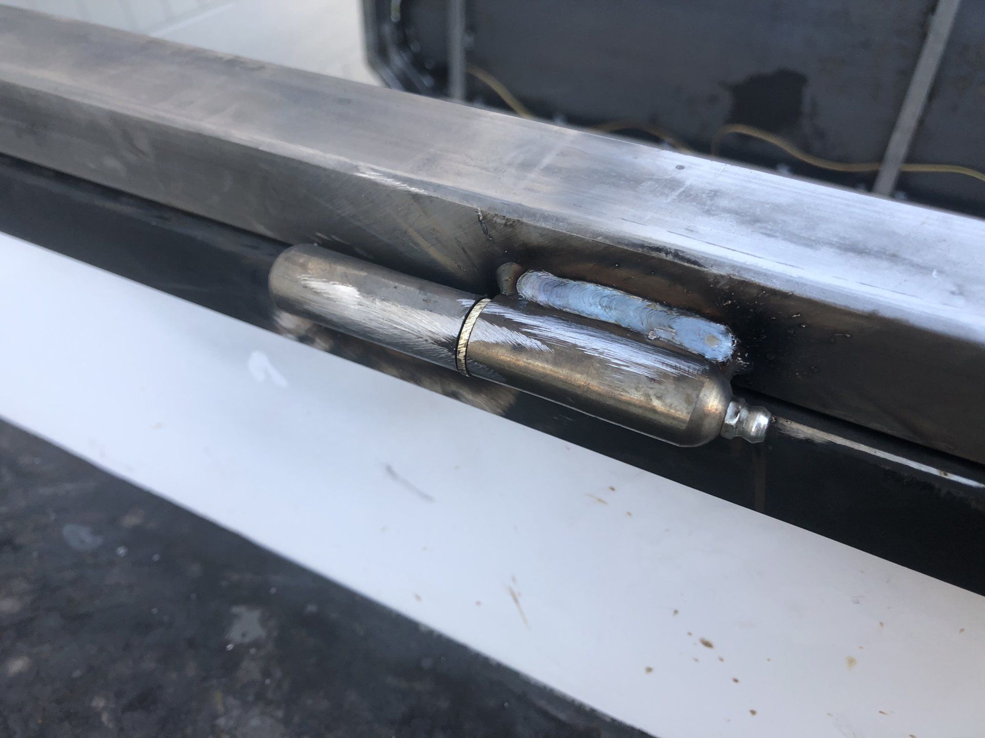

Got the lid frame made and working. . Took it for a drive today and everything worked great. Time to button this project up

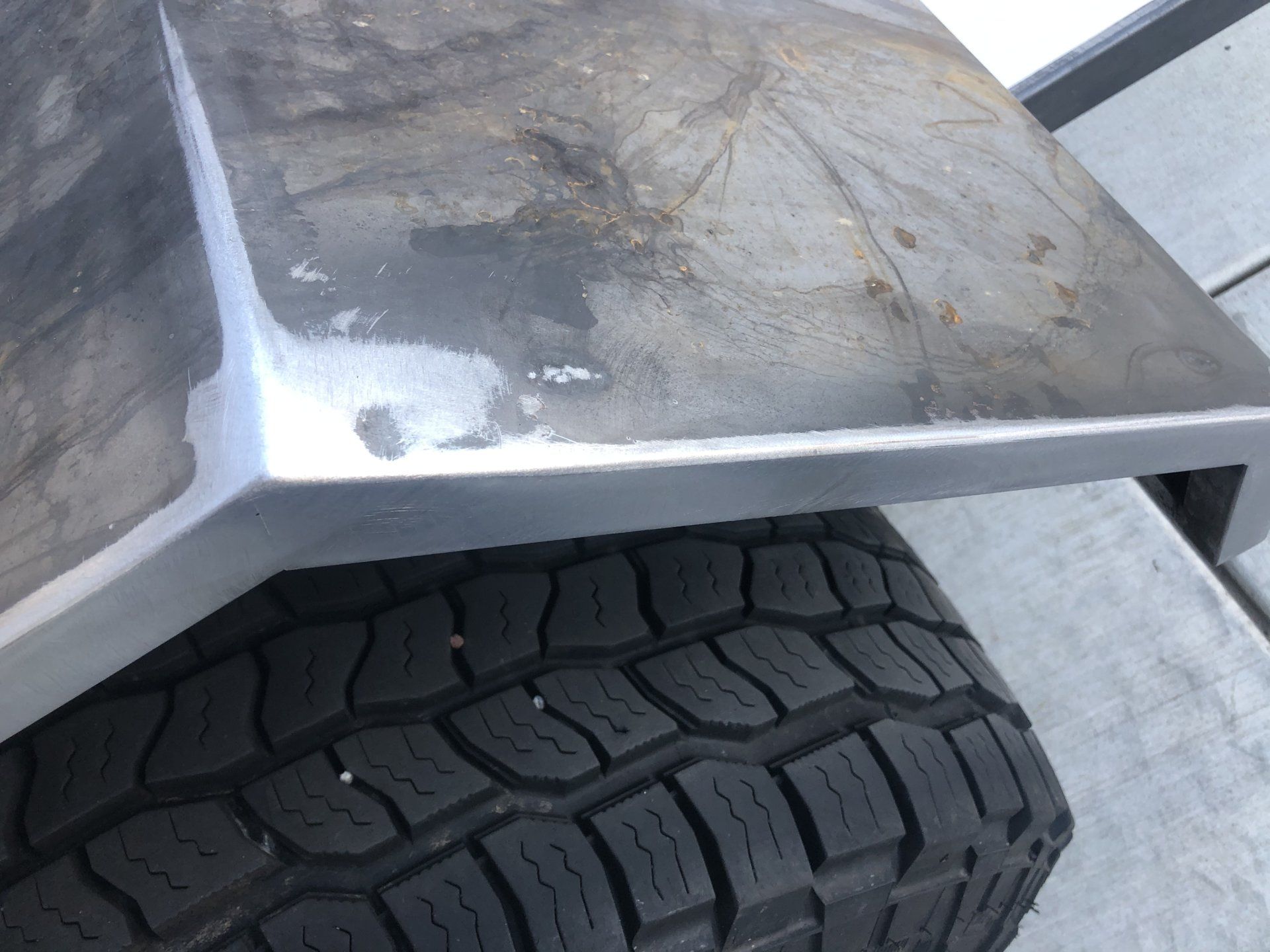

14 gauge steel .

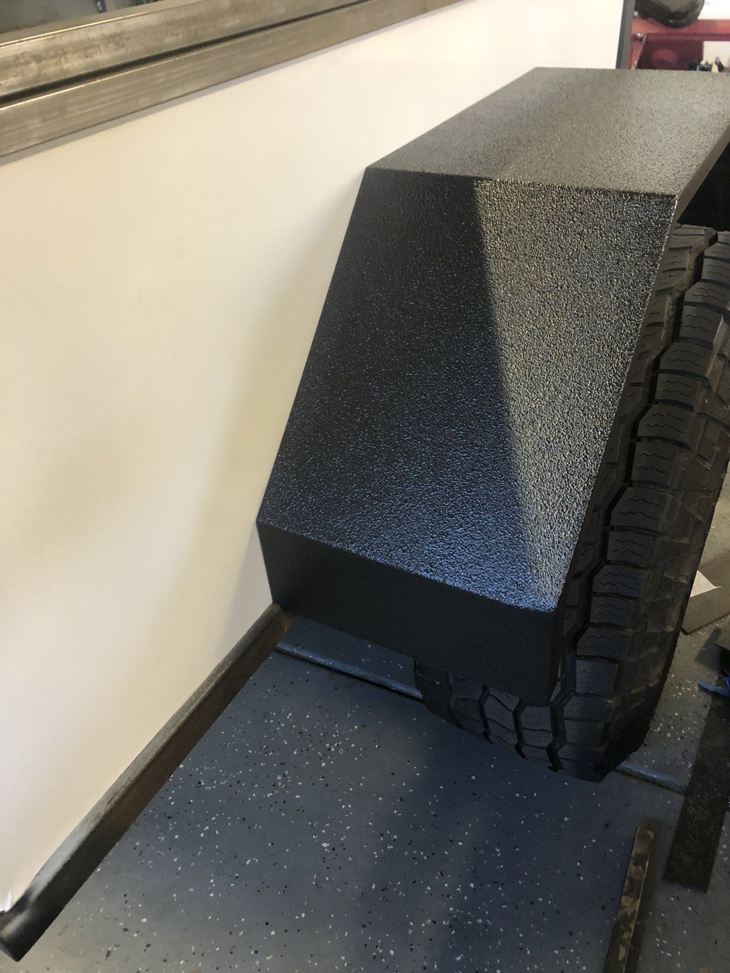

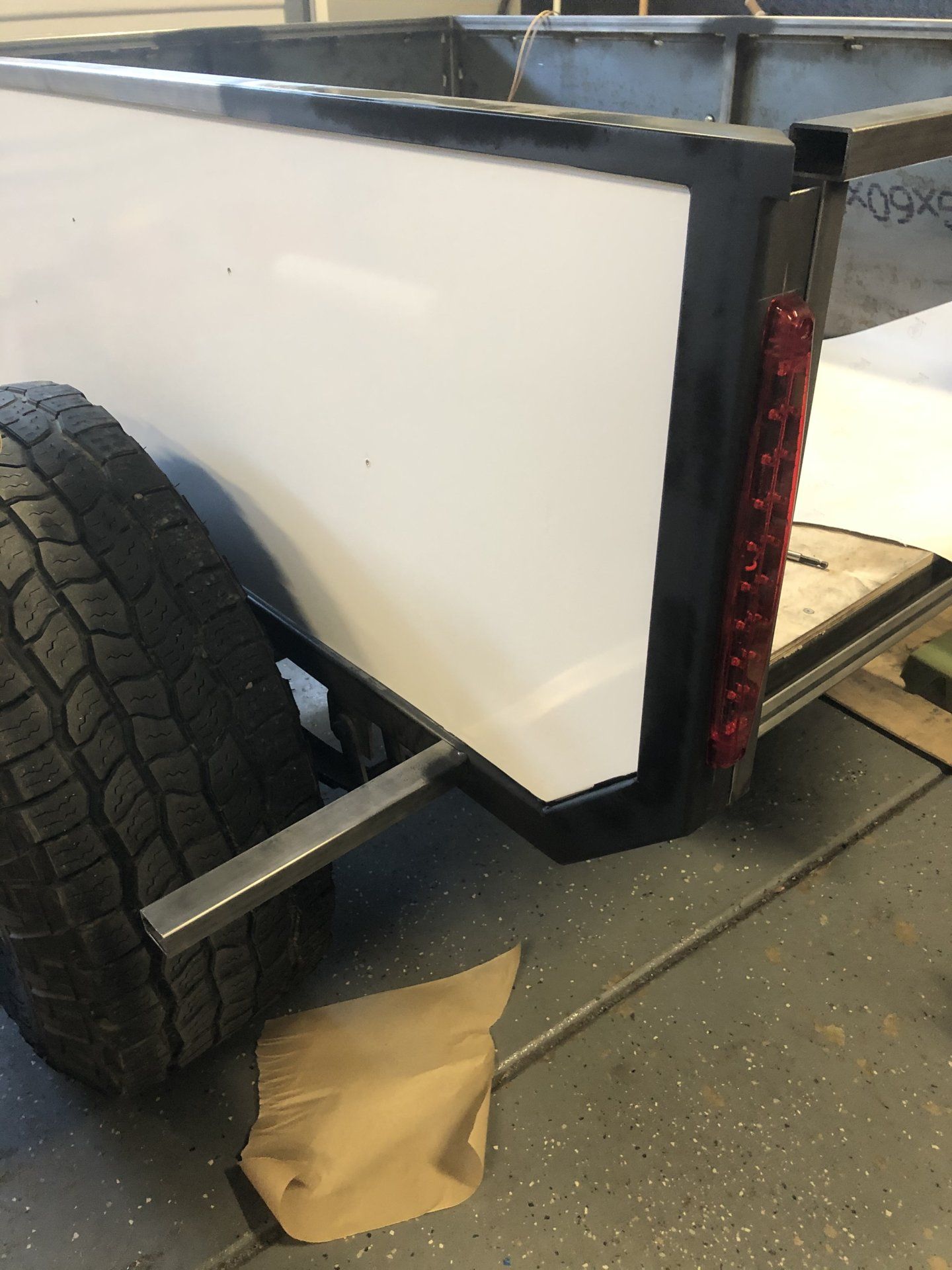

Chipping away at it
Started skinning the lid

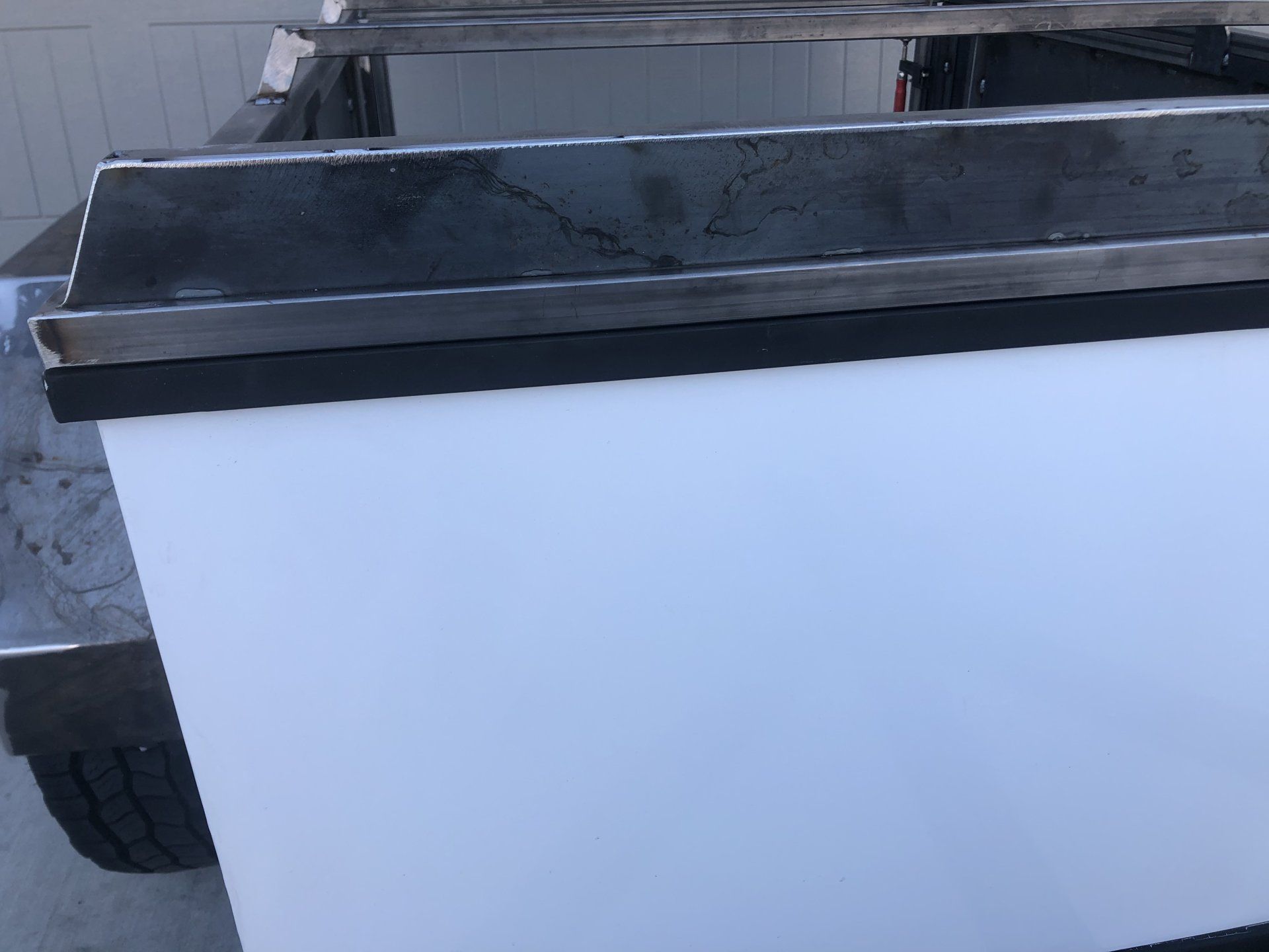

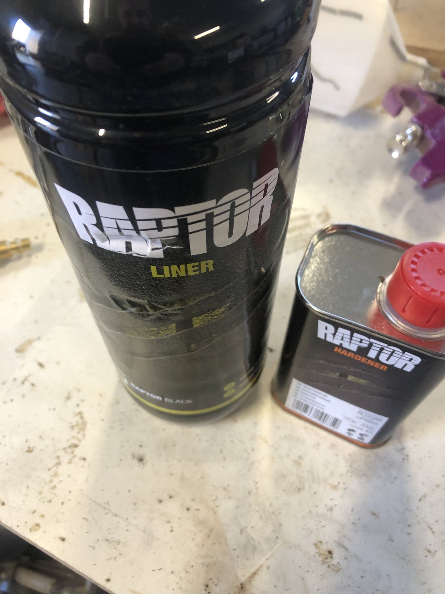

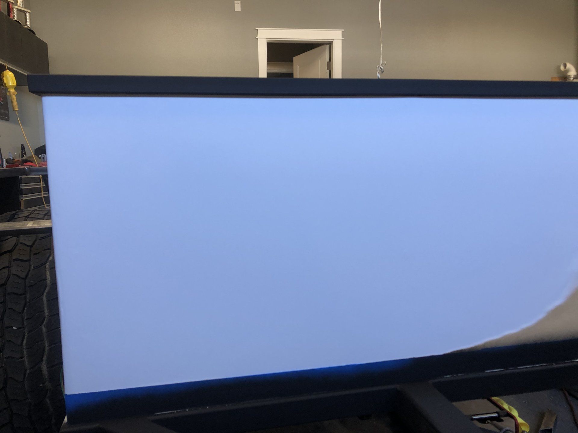

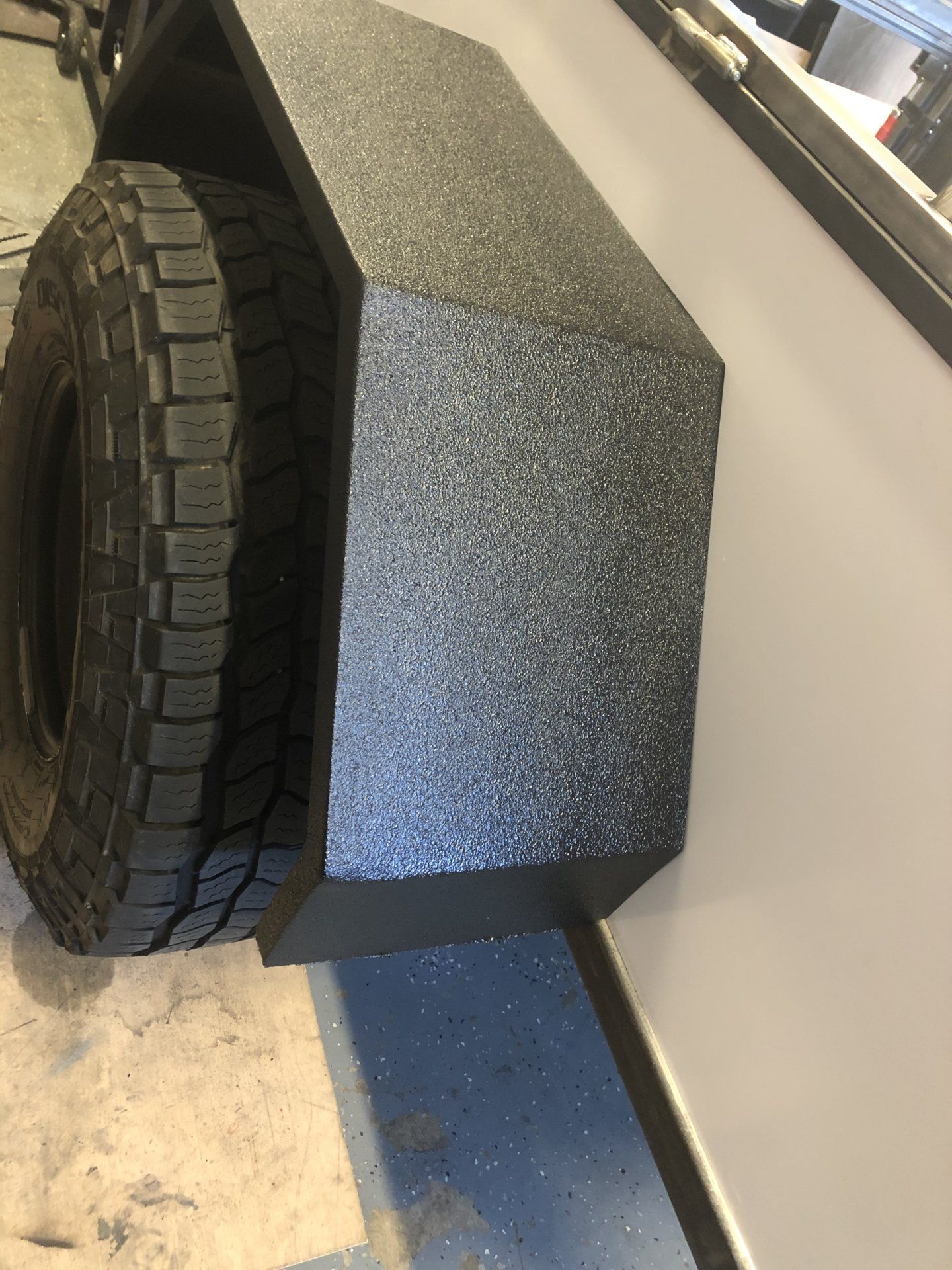

After taking it to Line-x to see what they would charge ( stupid amount ) I decided to do it myself so I picked up some Raptor liner . Very happy with how they turned out . I think I am going to go ahead and spray the white also now
I like it
What is left to complete?
I need to finish the Lid . and tail gate . I am having those bent so hopefully tomorrow i will have them
