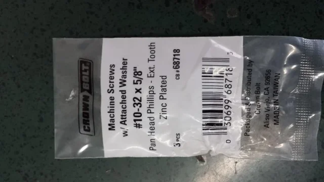

Finished installing the lights today and they look great. I can take pics of the screws Thursday since they're at work...
Here is the pic of the screws I used.
And installed...
