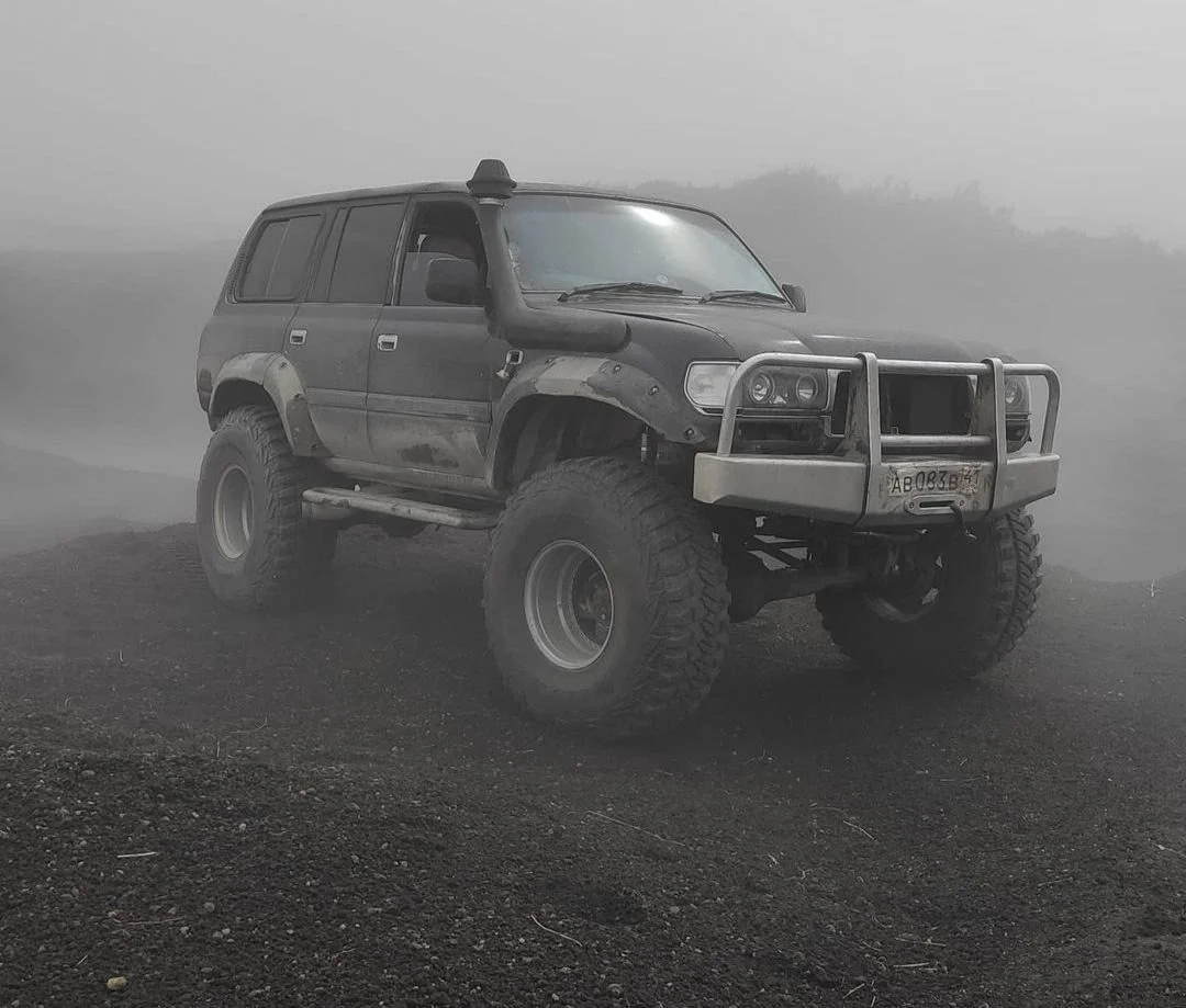

My answer to the 80 series weak link - all toyota HD front axle

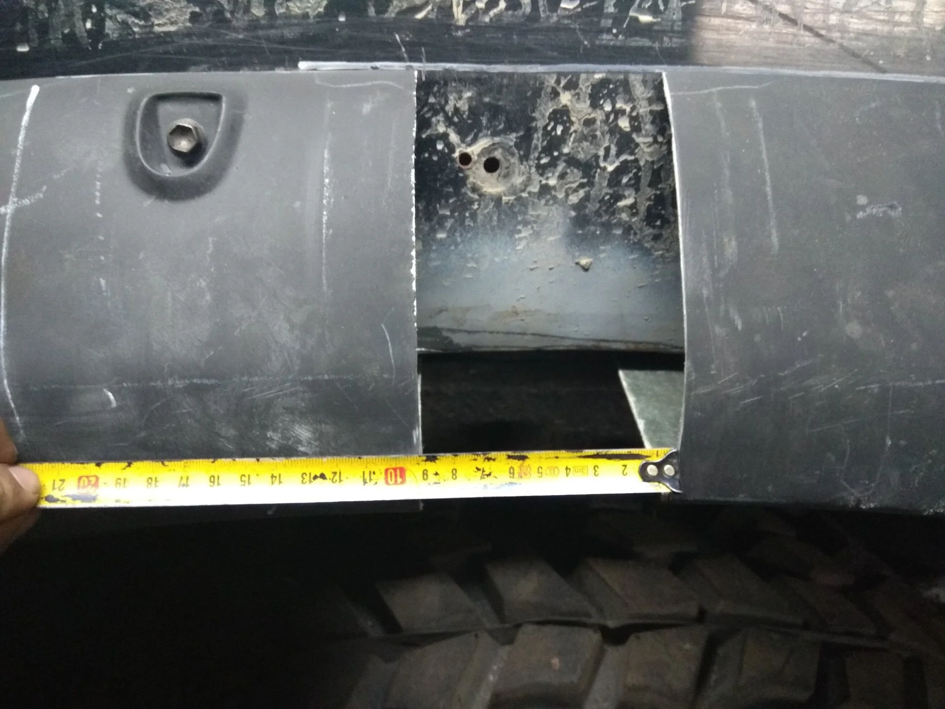

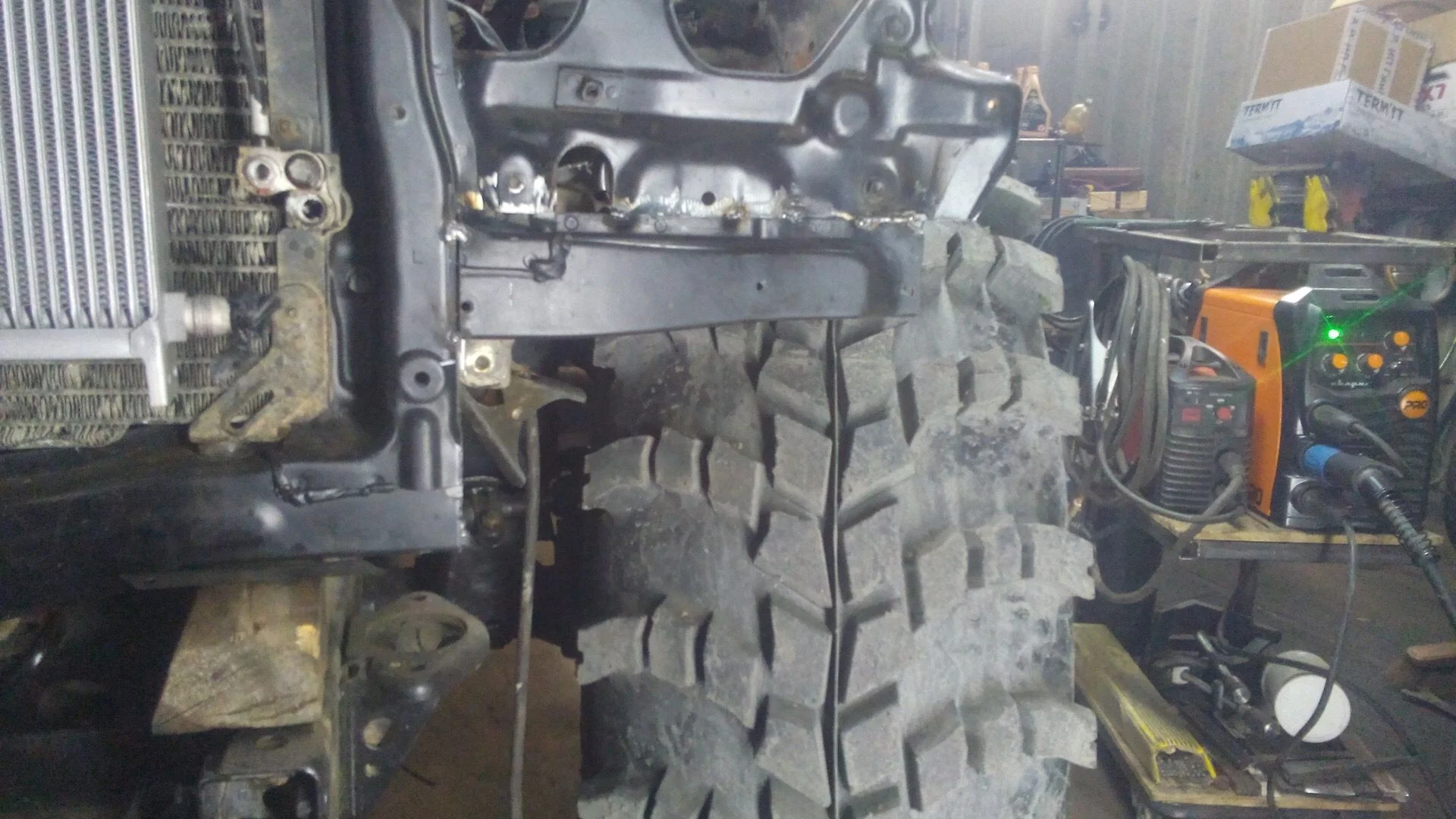

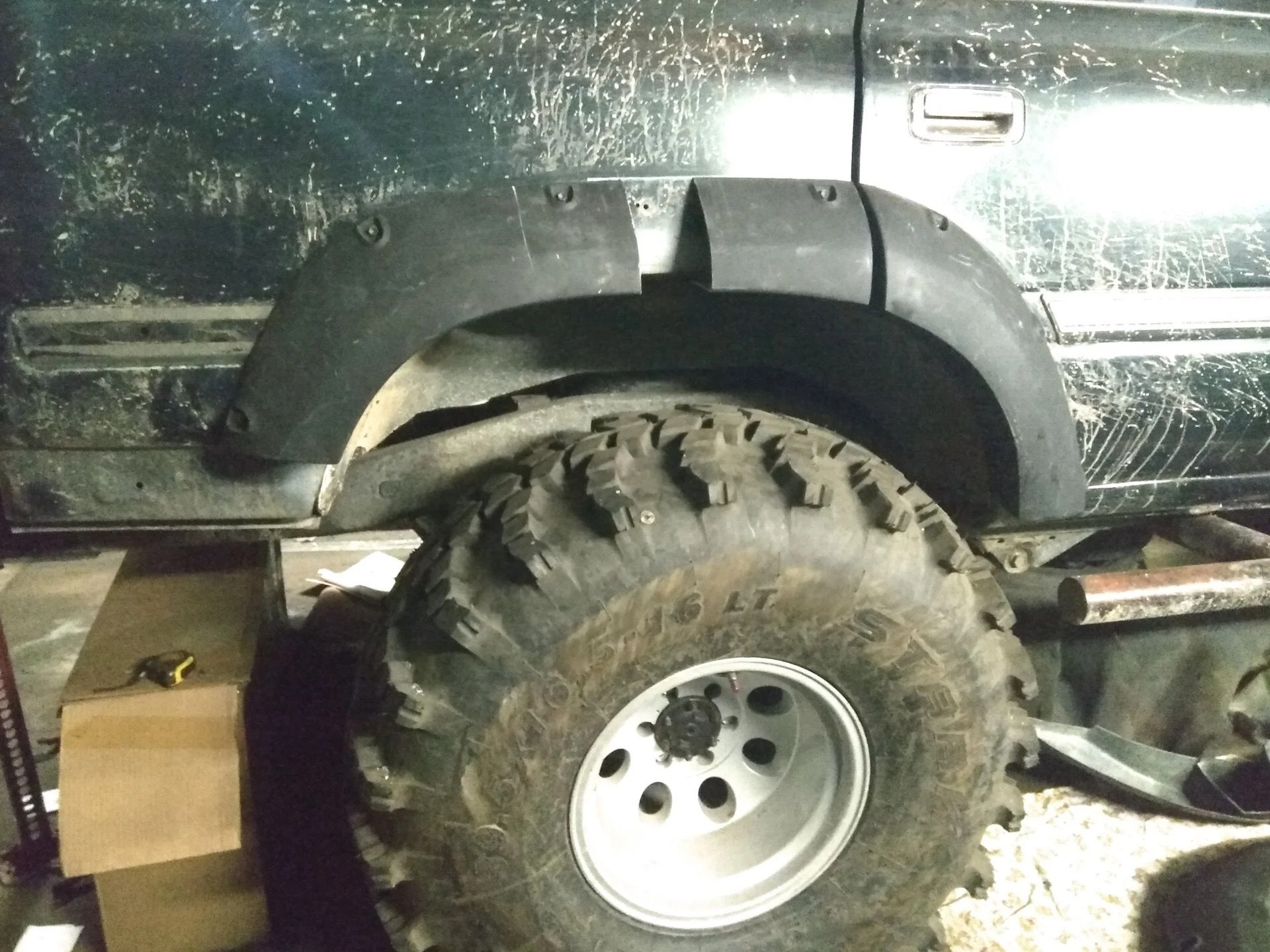

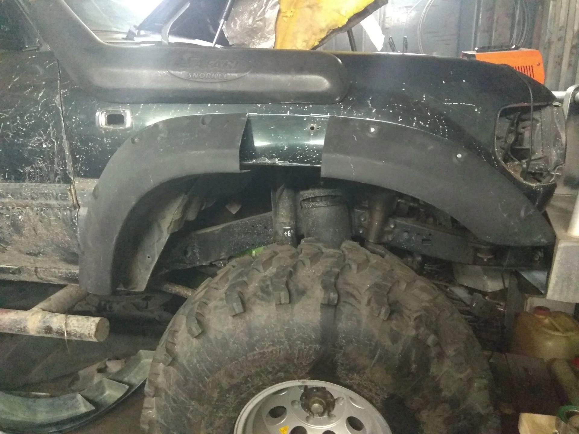

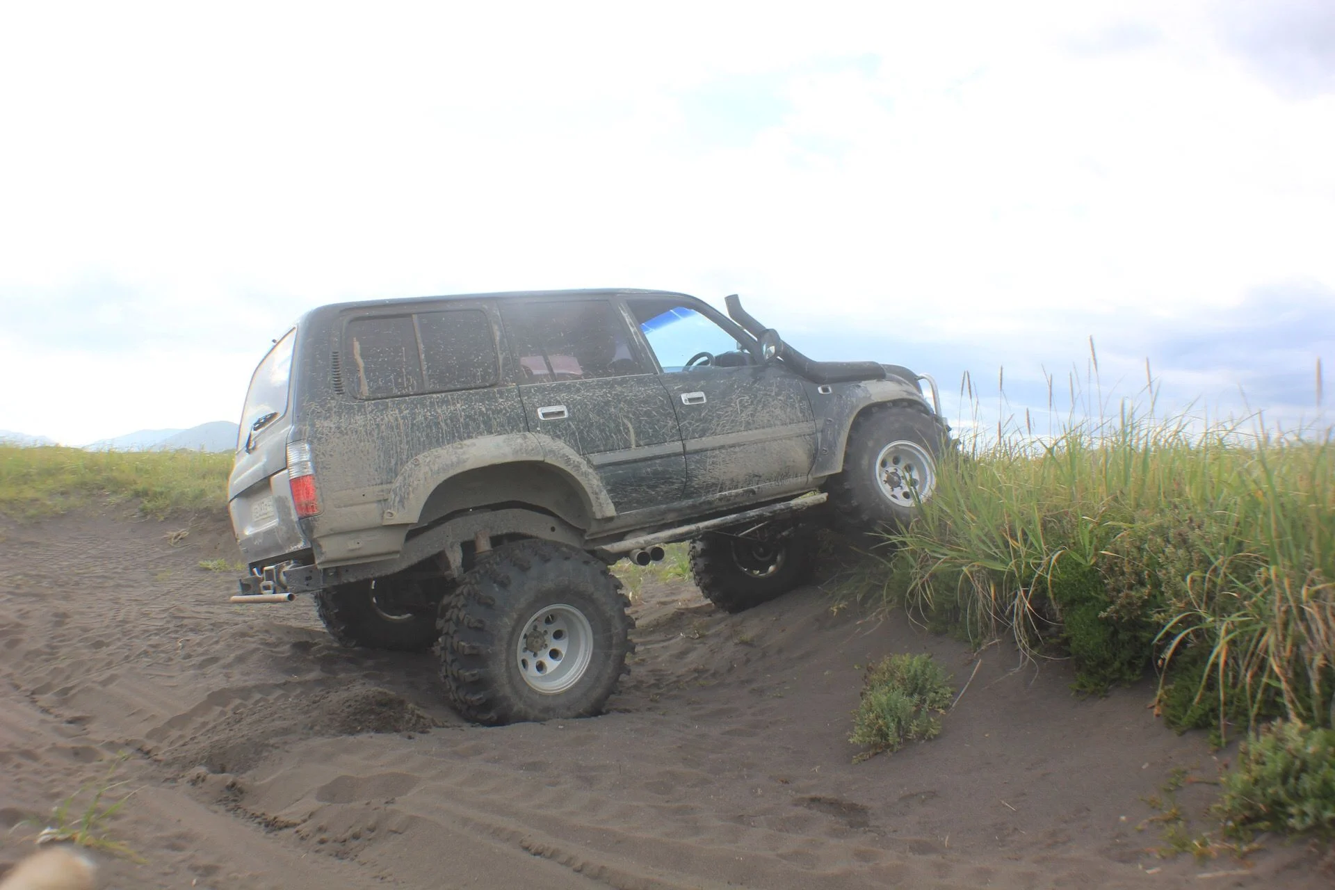

Front axle moved forward by 4 centimeters, rear axle moved back by 5 centimeters.
Front arch trimmed back by 10 centimeters, front by 8 centimeters.
Rear arches trimmed back by 9 centimeters
