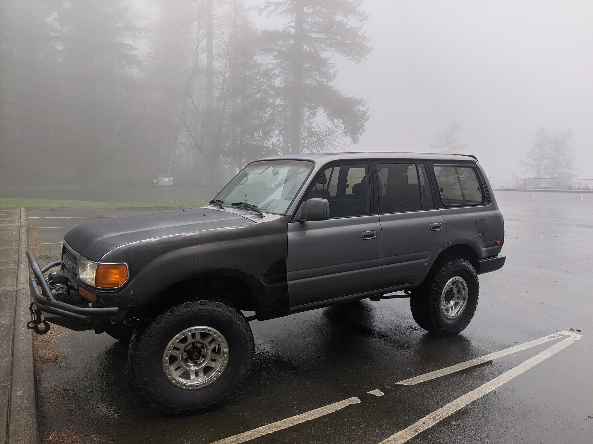

Distractions abound in my world, but I did finally get around to actually putting the beadlocks and KO2s on the 80. Immediate improvement in basically everything that matters to me. It no longer sounds and feels like I'm driving on a gravel road while on smooth pavement, which is a plus. It even tracks straighter. As far as the Vision wheels go, these take an acorn style lug nut, but the flanges are extremely thick so they needed an extended thread lugnut to fit on the 80. I had acorns already, but they would only grab a couple threads and I didn't trust them.
Aesthetically, they're a bit bright and shiny for my tastes, but the 0 offset version wasn't available in black. The overall style reminds me a little of the 1st gen 4runner alloys, and I kinda like it. They're 0 offset, just like the factory alloys, but the width is calculated inner bead to outer bead as if it were a standard wheel, and now the tire is actually mounted OUTSIDE the outer bead so it effectively gives them a bit of negative offset (aka, less backspacing). They're a 17x8.5 0 offset, but in practice it's more like 17x9.25 -10 offset (or 4.25 backspacing if you prefer) - roughly.
So far the beadlock torque seems pretty stable. Between work and other crap, they sat for about a month between when I first mounted the tires to wheels and when I actually mounted the wheels on the truck. In that time, they lost a little bit of torque, but I suspect that was just the rubber conforming to the clamping forces. I re-torqued at that time and I've checked it quite a few times since and it hasn't changed again. I'm tempted to use some threadlocker, but I haven't made up my mind whether that's a good idea or not. I've long held the opinion that critical threads shouldn't go together dry - anti-seize or threadlocker, one or the other. It's important to use the correct formula for the metallurgy though. Aluminum is less noble than steel, so something zinc based gives the galvanic action something to consume rather than the aluminum. Chemistry, anyway...

Those are a good looking wheel. Dont use any loctite, use anti seize.
Yeah, that's really the direction I was leaning. I put them together dry according to the instructions, but I really don't like leaving stuff that way. No one really gives you a useful warranty on beadlocks anyway, so they lost their right to tell me what to do. I had pretty much convinced myself that the aircraft rated stuff is probably the right way to go since it's specifically formulated to discourage galvanic corrosion in aluminum. Maybe I'm being overly paranoid about that, but the truck has already dipped its toes in the ocean since they were installed. I suppose if one replaces the cadmium coated fasteners every year as recommended, the coating probably takes care of it, but I'm going to assume that I'm pretty likely to skip that here and there.

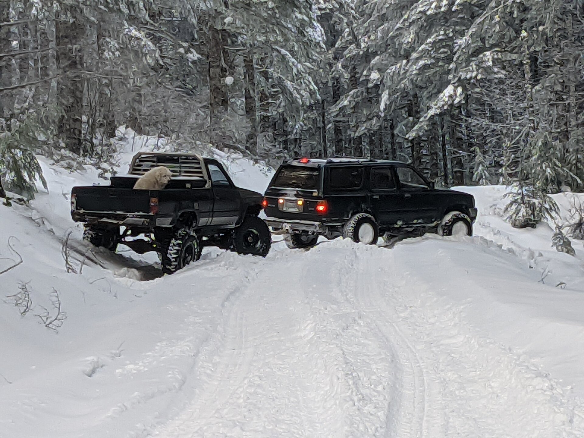

A bit farther up the mountain, we caught up with these kids who had the nose of their 4runner about 3 feet down that bank. My other Hilux buddy ran his truck up and yarded them out. I was trying to make up my mind where to hang a snatch block to pull them with the winch, but he just ran up, tied off short and did it... I think that's still the front axle I set up for him on a different rig back in the day. The kids had another stuck rig about a hundred yards beyond this one, but it was a one ton and it was ALL THE WAY off the road... decided he was on his own. Meanwhile, the 4runner kids went back to hammering on it trying to get up that hill and slipping back and forth ditch to ditch. We decided it wasn't worth trying to make the old fire tower at that point and turned around. Didn't want to spend the rest of the day pulling people out. His pup looks pretty miserable in that pic, but every time we stopped he was in heaven just romping through snow drifts, so I think he was just bored.

Looking at these same wheels - are you happy with them?
Yeah, honestly they've been great. I would go ahead and get the spacers I mentioned upthread, even if you might not need them for the tires you're planning to run - better to have them and not need them than have to scramble all over again to find out where to order them the next time you buy tires. Also, I needed ET style lug nuts because they're a thick rim and the lugs on my 96 were too short for standard conical nuts. YMMV on that.
I guess I'm just around a year in and I've put lots of miles on them on the road and some off. No issues. They're well made and they have worked well. I'd buy another set if I needed them.
