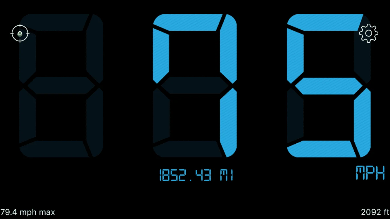

Well, apparently 44's fuel delivery issues are an example of "slow change"... this morning, I drove up a grade that has long been challenging, when both tanks are full and 44 is loaded for a trip... I could seldom reach 60 mph... And only with a tail wind.
This morning, both tanks are full and 44 is loaded and she cruised at 75 mph... and she was "running against the wind" and made the hills look like they were standing still!! :cool:
Mark told me that her 2F should now run like an SBC... More like a Hemi, if you ask me!! :D
