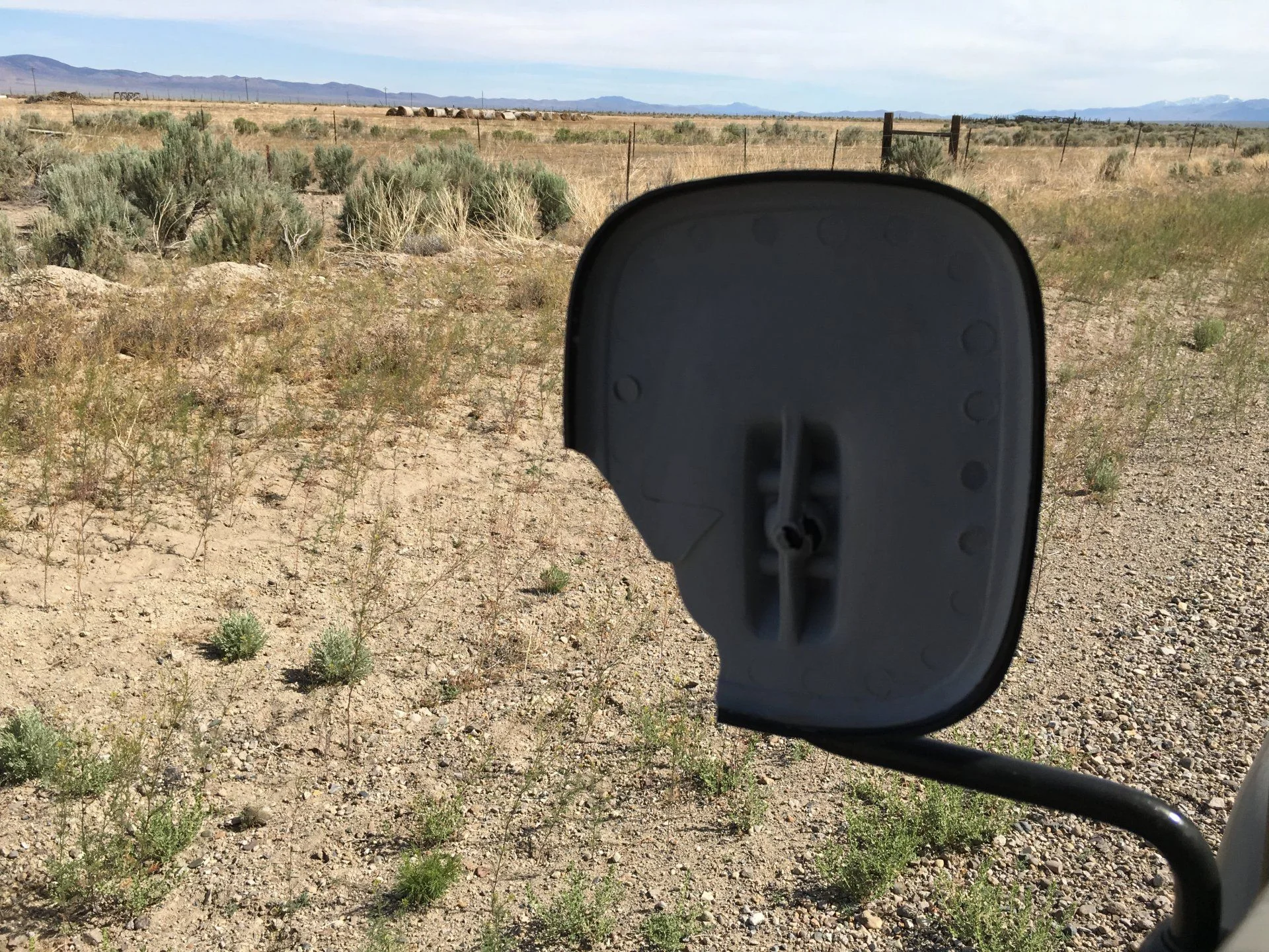

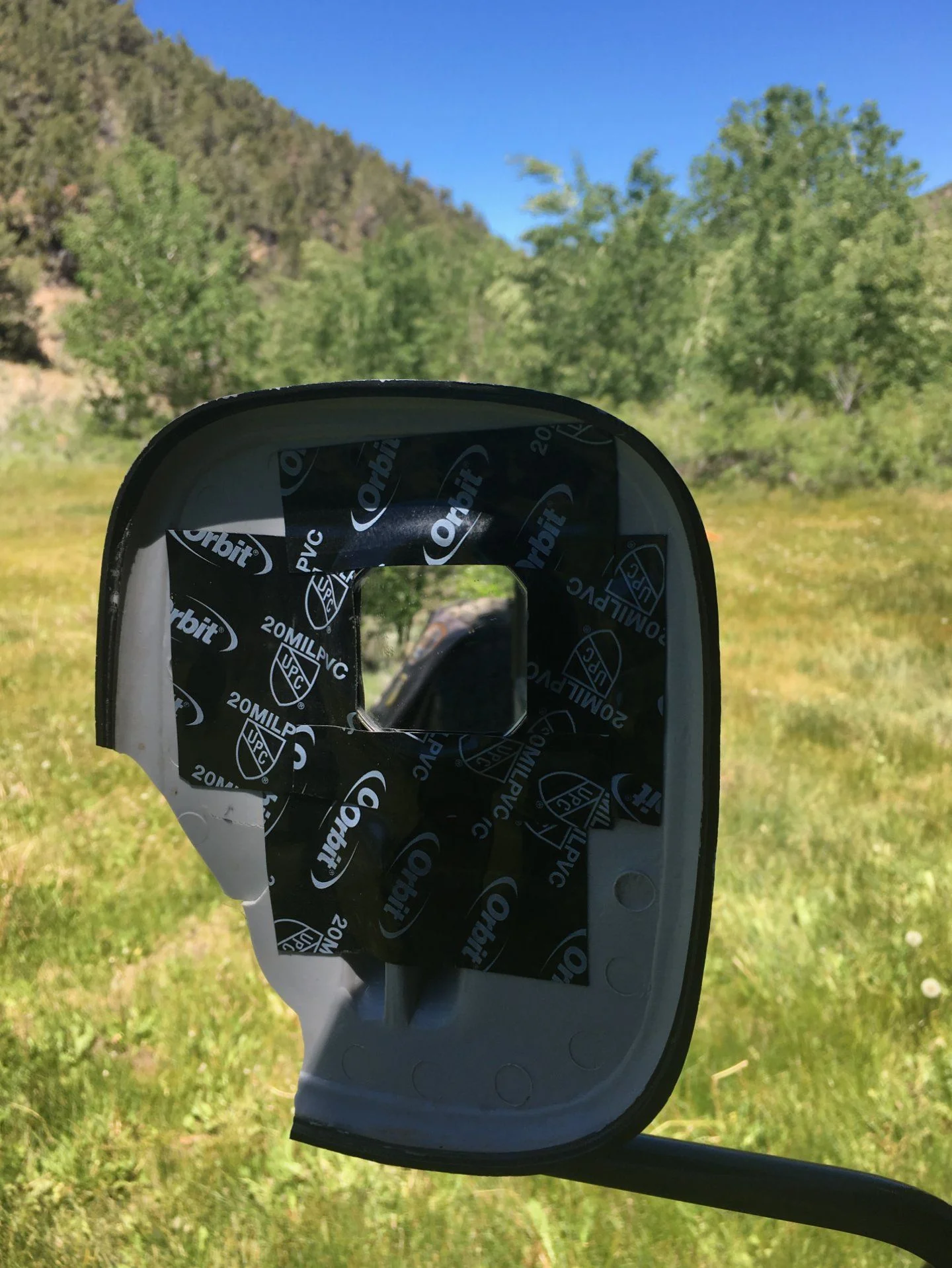

Here's the remainder of my mirror.
Here's my new mirror.
I can't drive without side mirrors...
So, I pulled the mirror off of a telescoping mechanics mirror and put silicone on its back and taped it on, with some air conditioning condenesation line tape... it sticks good.
That little mirror allowed me to know everytime somebody tried to run over us, on the trip home.
