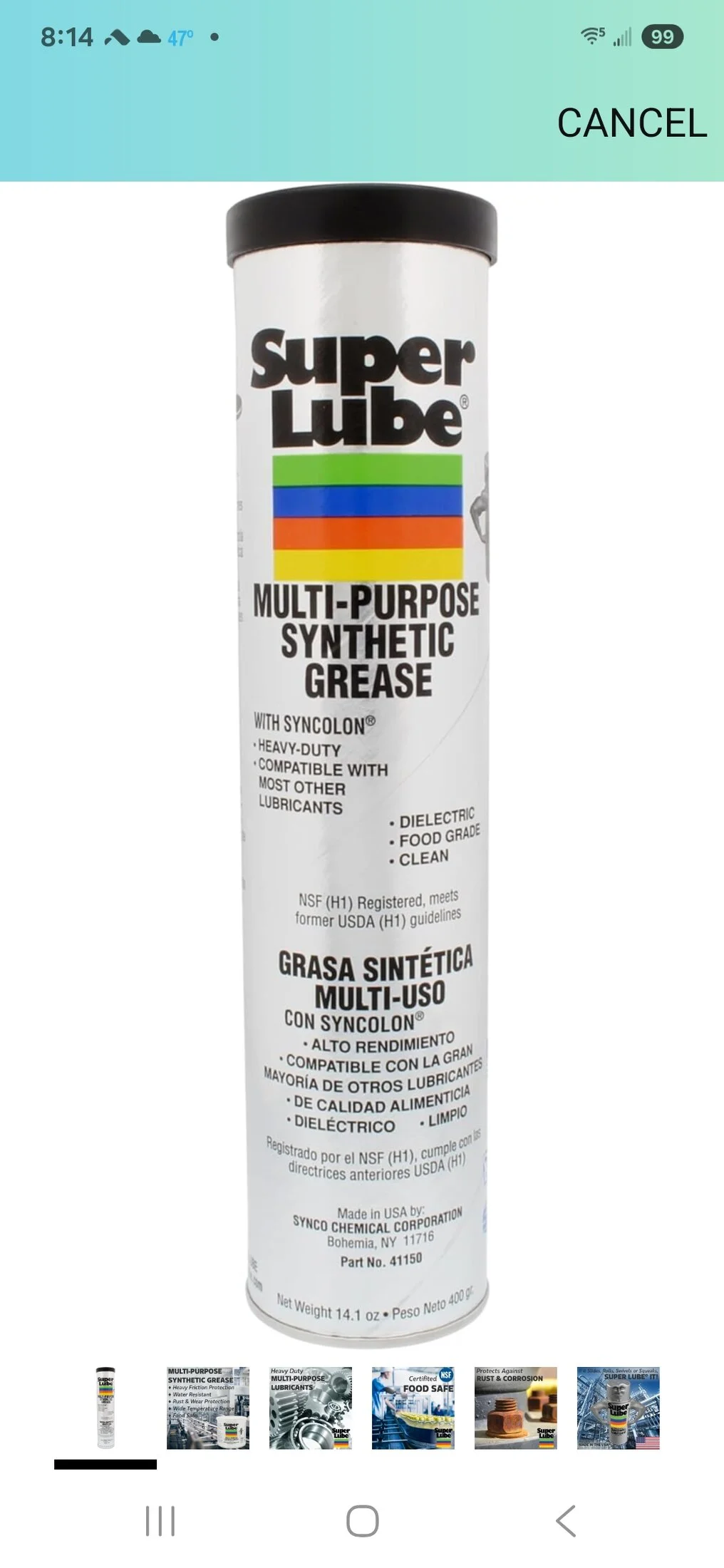

Pat it appears to be reacting to the lube itself.
That's not good. I never paid attention to what grease I was using. I JUST put in (and greased) new bushings in Jessicas HZJ-73. Doh! my 61 and 55 have them too. Not really wanting to pull the bushings to clean them and swap in moly grease, but may have to.
I use this on poly bushings now after having this issue on multiple trucks.
What's cooking? 69 page thread, help me out :D
I think someone tagged you looking for some insight on OME spring bushing grease. What grease should be used with these bushings?
