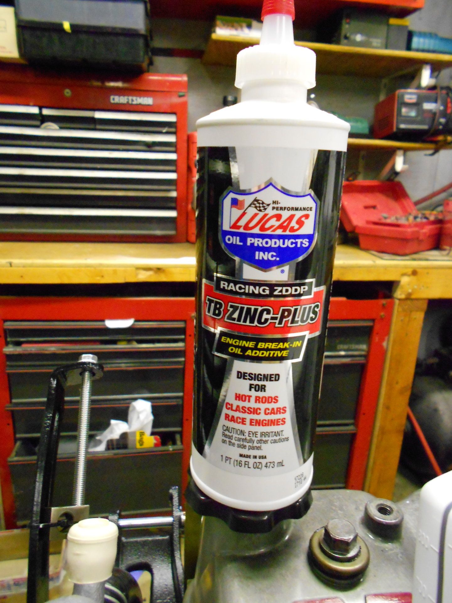

I recently received a 1981 2F back from My machine shop , The Master Machinist Spec'd this product ZDDP ,
( Zinc & phosphorous ) for the Cam & Lifter break in , I Wonder if the LUCAS Company is using Graphite in there products because a few i have used are a very dark grey ?
Have U ever heard of this product , and if so what is your opinion , Do U plan on using it on your engine coming back from your machine shop soon ...
I am using lucas hotrod and classic oil. It should have the proper amount of zddp in it. Too much zddp is bad.
