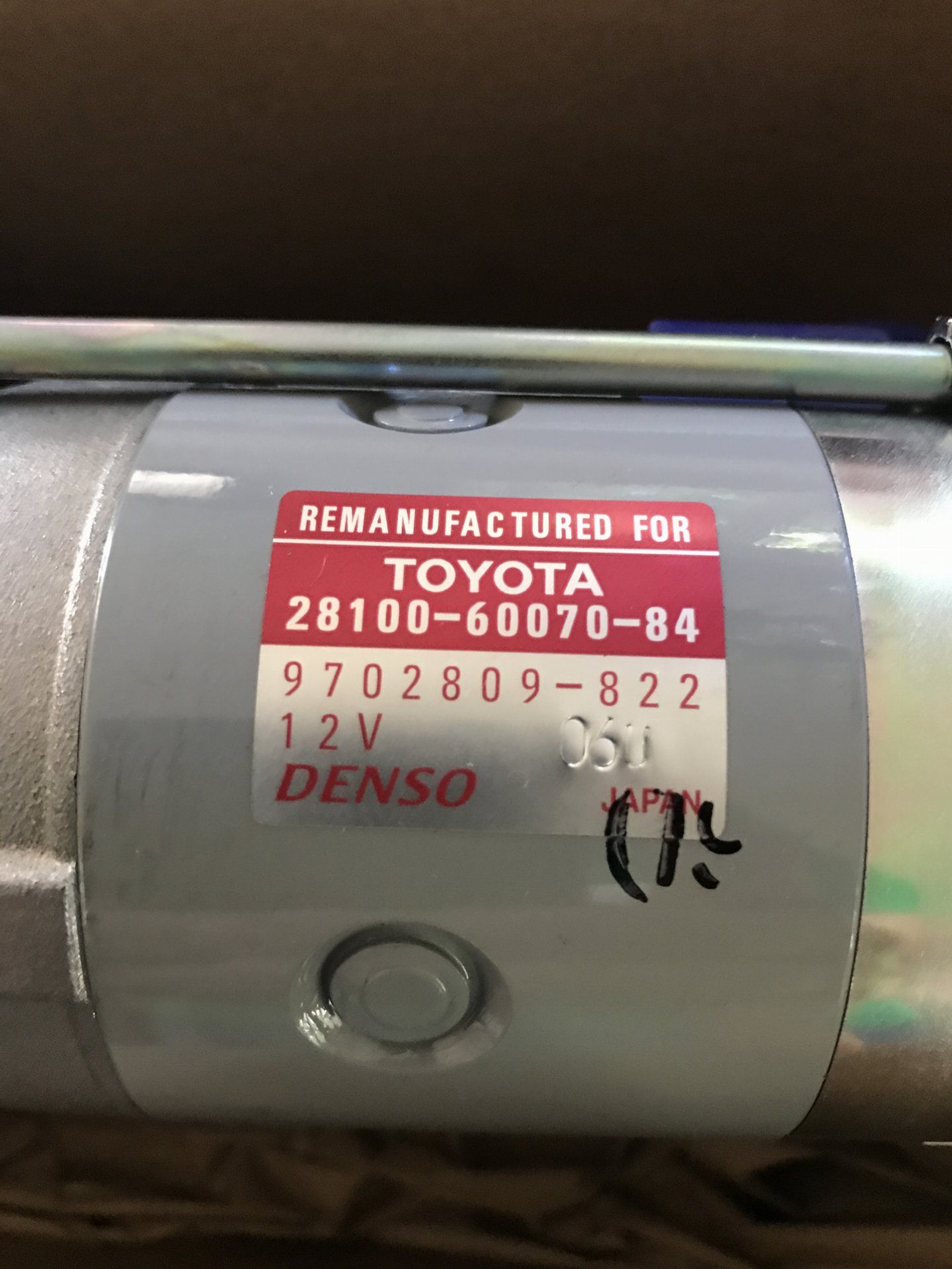

Hang in there rusty. Do you think a different starter would help turn the engine over? Your starter looks different, what’s the skinny on it?
The FJ60 gear reduction reman is 28100-60070-84. The published list price is $113.82 exchange, mudder $85.37 exchange. Of course to avoid the core charge($30.00) you would need a gear reduction core.
Cannot turn over the engine with a 2' breaker bar on crankshaft nut. The spark plugs are out and the transmission turns over easily. Something in the engine is seized up. Starter is a later gear reduction unit. When I first started the engine the starter spun it without any problems.

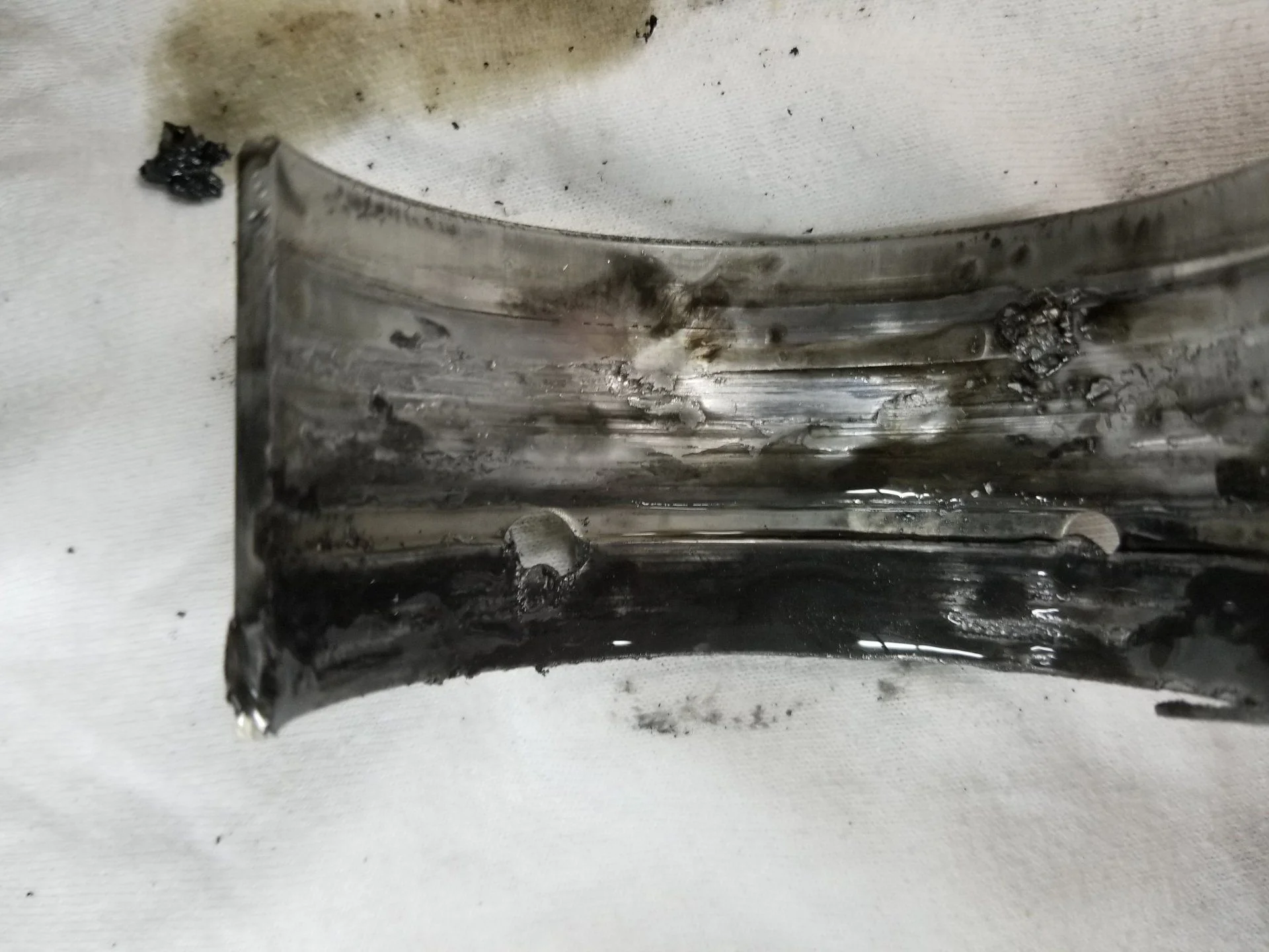

The rods and mains are finger tight now. I did rotate the crank while using a pick on the bearing. Had no luck in getting the bearings off. Going to pop the engine out in the morning. Thinking I will just remove the crank and look for the reason of no oil or is it something else.
Popped the engine out this morning. Found this after using hammer and punch to remove to bearing. No oil.

Been investigating why no oil. Done a bit more measuring of the oil pump to distributor engagement. There is 7/32" which just a little short of the 1/4" minimum. Next to the oil pump.
