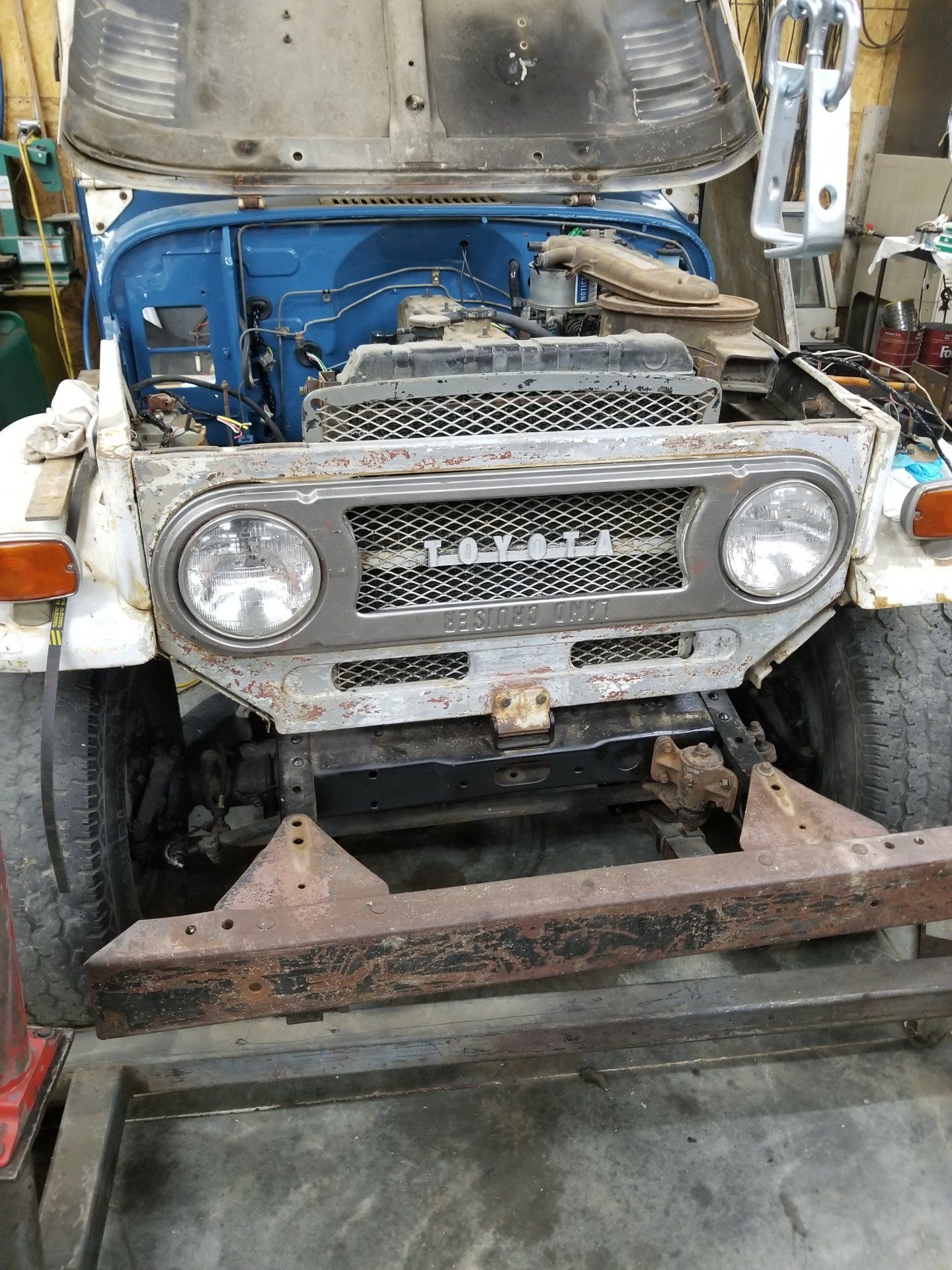

Need I say more.
Well I sold that bezel to @kevos37 and it arrived like this. Guess it was karma paying me back for an upside down bezel.
