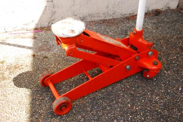

Rebuilt my older Import floor Jack...
full
Don't think your jack can't work like new again.
15-20 year old Harbour Freight Floor jack rebuild
Including list of Part numbers to replace all seals and O-rings. If your jack is different, you can likely still get the parts you need from the same suplier.
