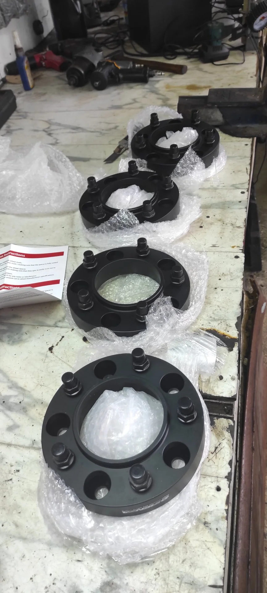

It’s a 2 piece adapter, that would look like this but Bora brand.
The specs for the 1.5 inches two pieces adapters would be:
First piece would be .91 of 1 inch spacer that sits against the hub and 5 lugs. The second piece is .59 of 1 inch adapter which has the 6 bolt pattern.
I don’t know if the first piece would clear the bolts as they need to sit flush and can’t have any protrusion.
These things seem to be held together by flat socket head cap screws?
There is absolutely no way I'd trust that to hold up under the weight of one of these vehicles, even on-road.
Big ole nope from me.

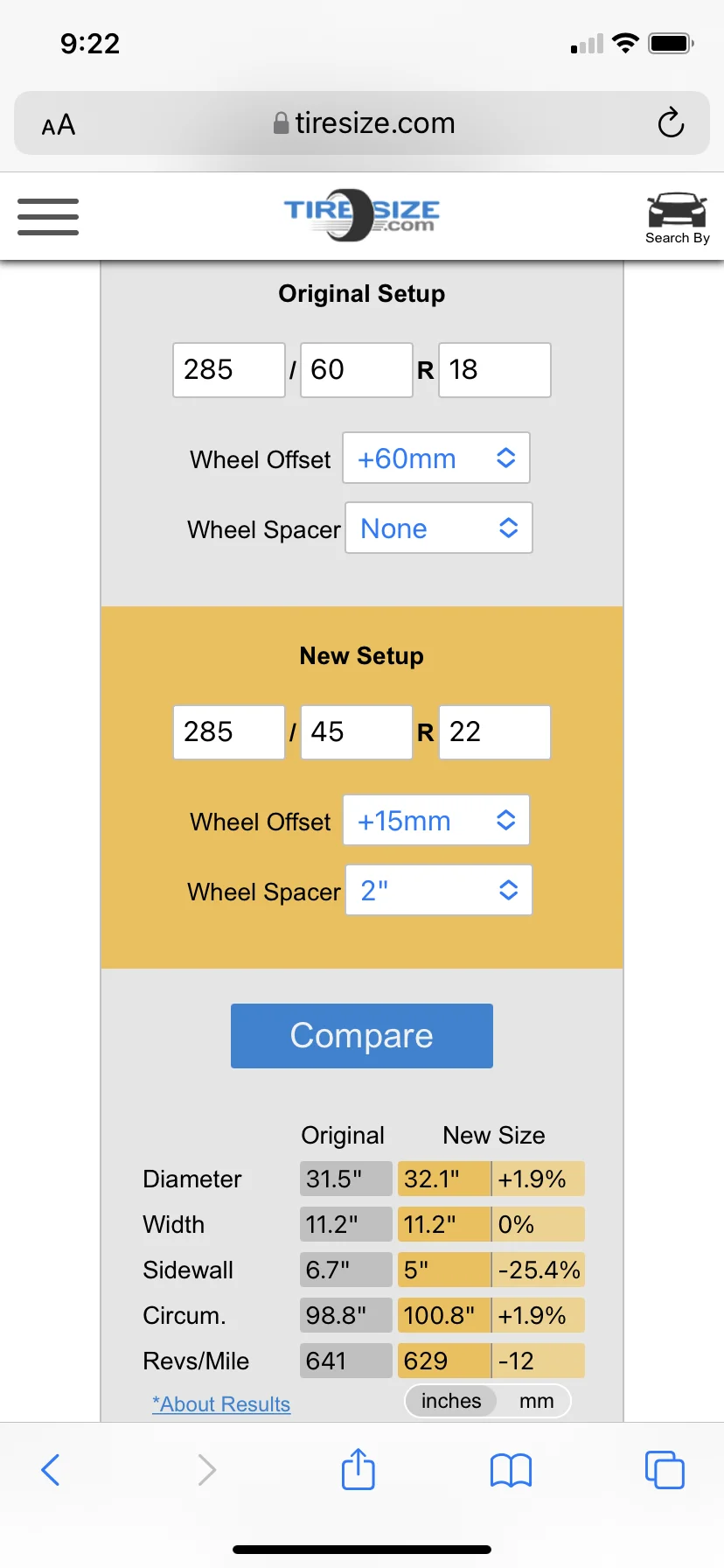

The tires are going to be 285/45r22.
The wheels offset is +15. So by my calculations 2inch spacers = 2 X 25.4 = 50.8 - 15 = 35.8 offset.
I’ll be having the Eibach Pro Stage Lift Kit installed later this month as well. It’s a 2 inch front and 1 inch back lift.
Using the tiresize.com calculater, these were the results:
I think it might rub in the front but I will be taking off the mud flaps as well.

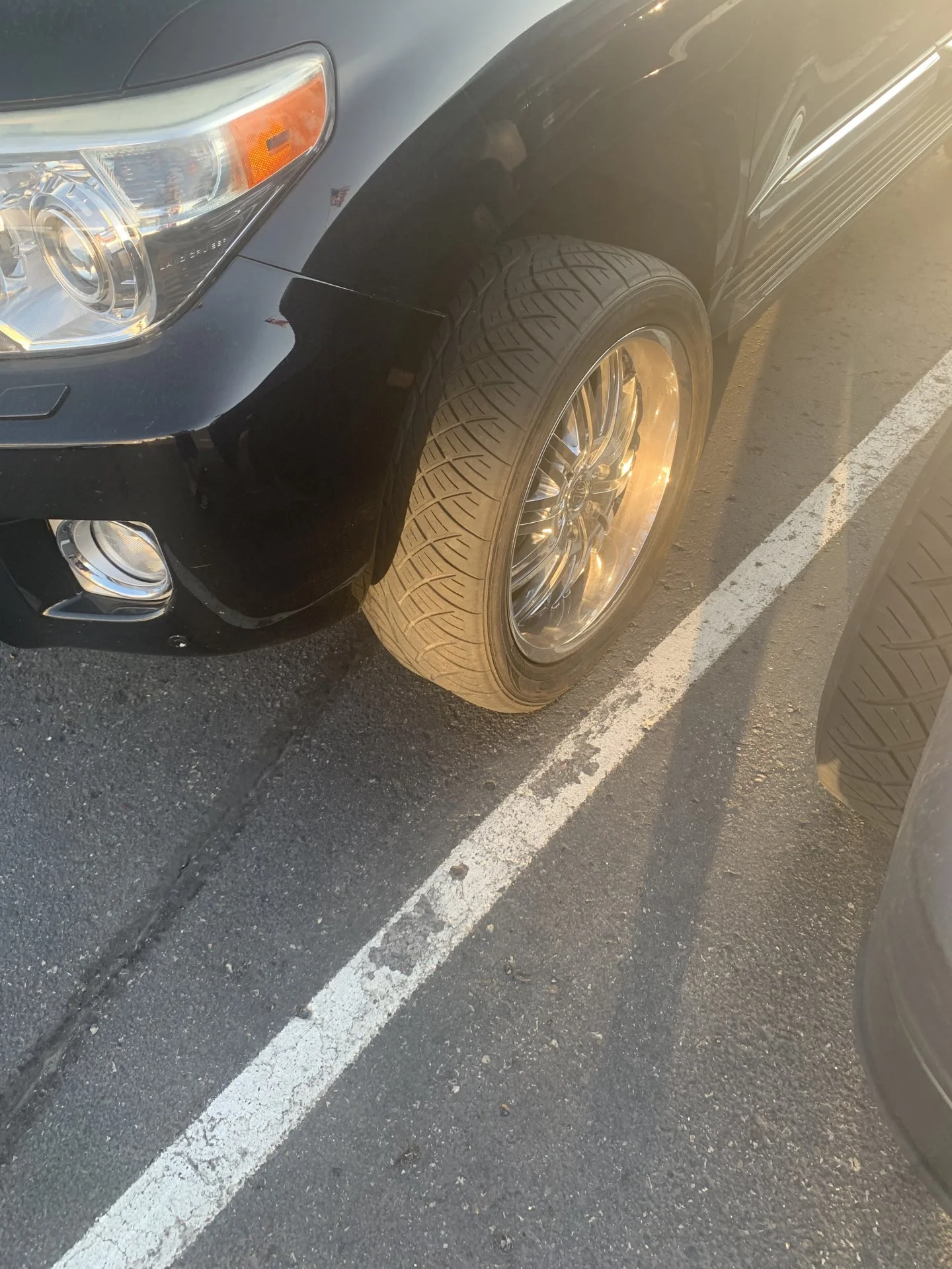

Stock 08-15 wheels being +60, your +15s will move the wheels out 45mm. Add another 50mm to that for the adapter, and you are 95mm further out than stock..
I could have my math wrong on this.. never have been the best at keeping track of +/- offset and such. But I do know a 2" spacer even on stock wheels is a big shift. If your wheels are adding another 45 to that... yes, you will rub, and I don't know if removing the mud flaps will fix it. Plus your scrub radius will be -very- out of ideal. You might find a lot of torque steer and the truck darts around under hard braking.
@bloc math is correct. The new offset of the +15mm wheel and 2” spacer will be -35mm (-95mm from stock).
