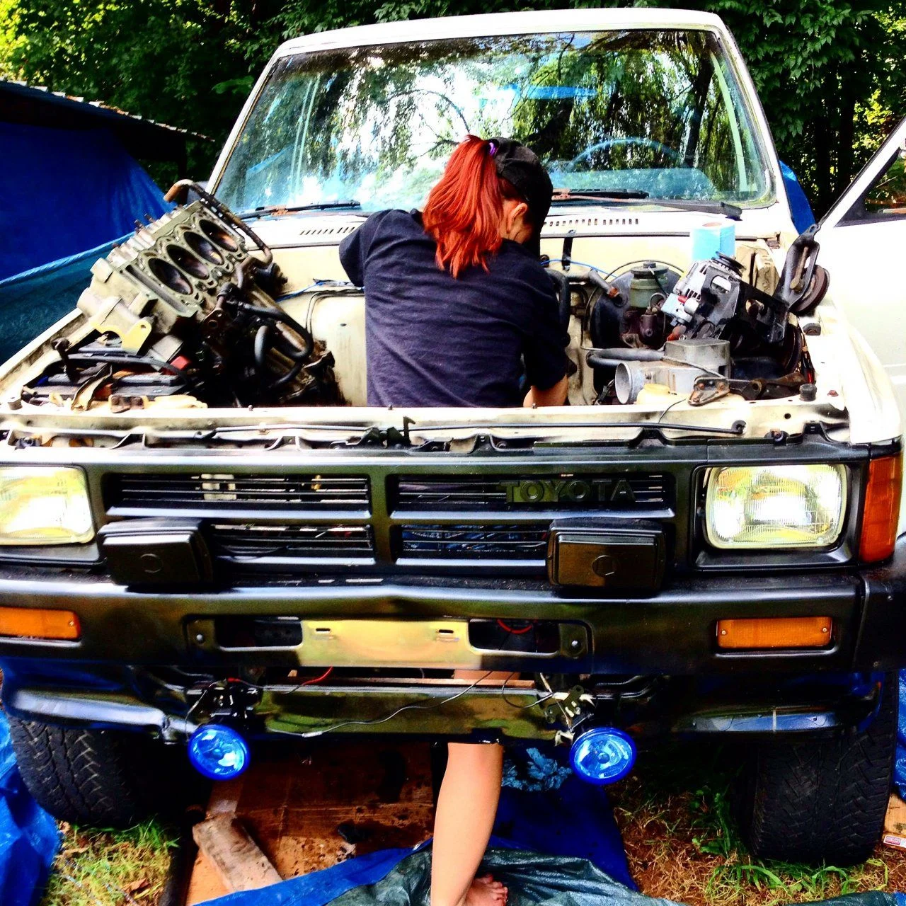

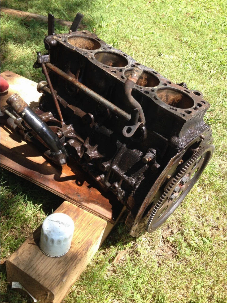

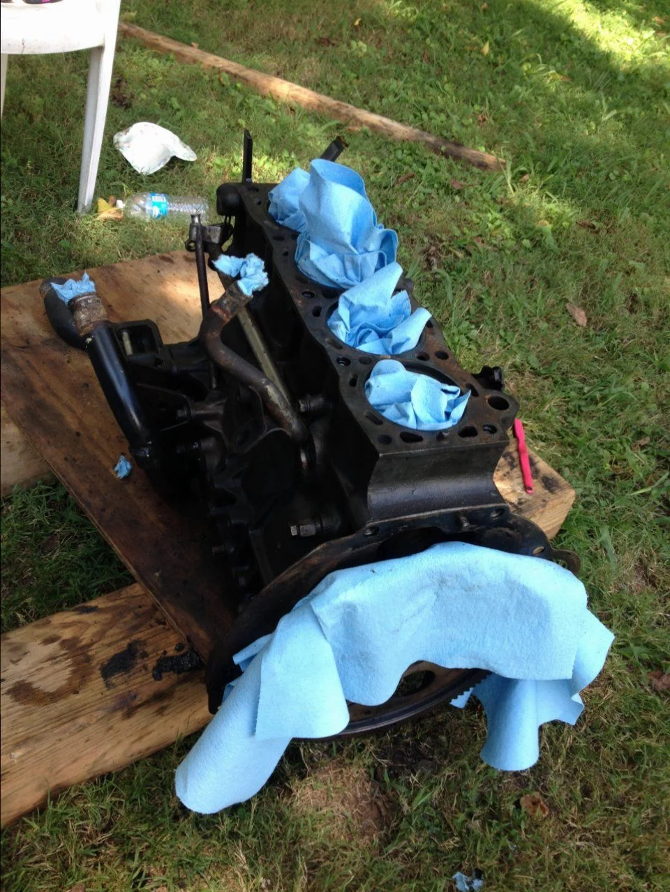

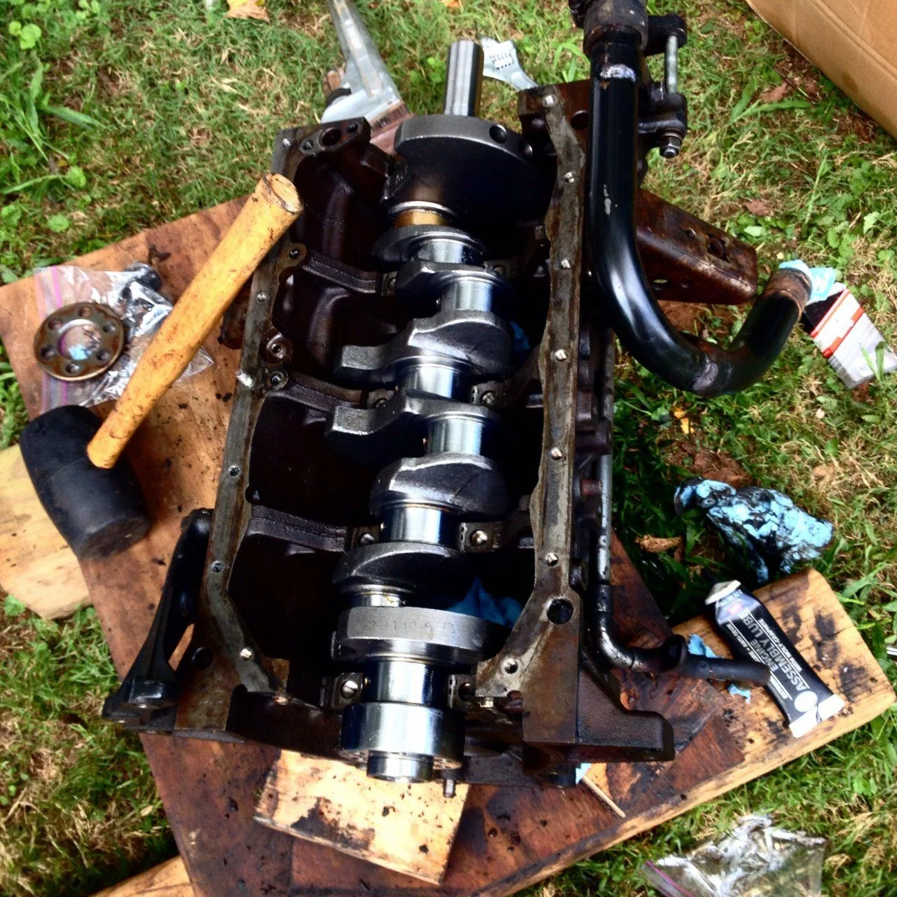

Alright friends this is now a build thread! Motor went so I tore it down all the way to the block. New crank and rod and main bearings just came in. I'm adding a crawler cam, pacesetter headers and exhaust, upgraded pistons, and an air intake!
Big day in the build! Got the new crank installed and everything put back together! I am waiting on the cam and that's it! Also that's my woman helping me!
