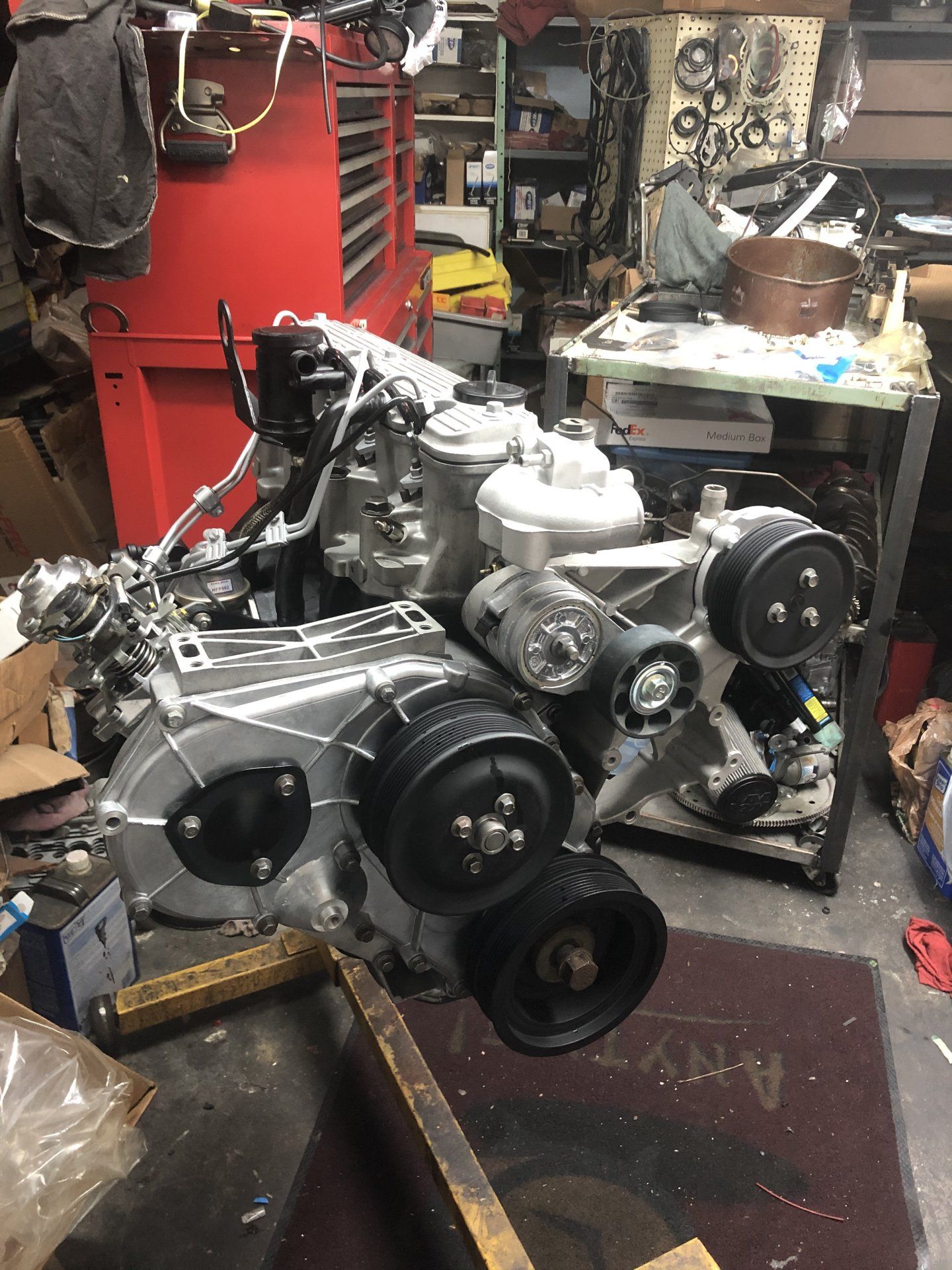

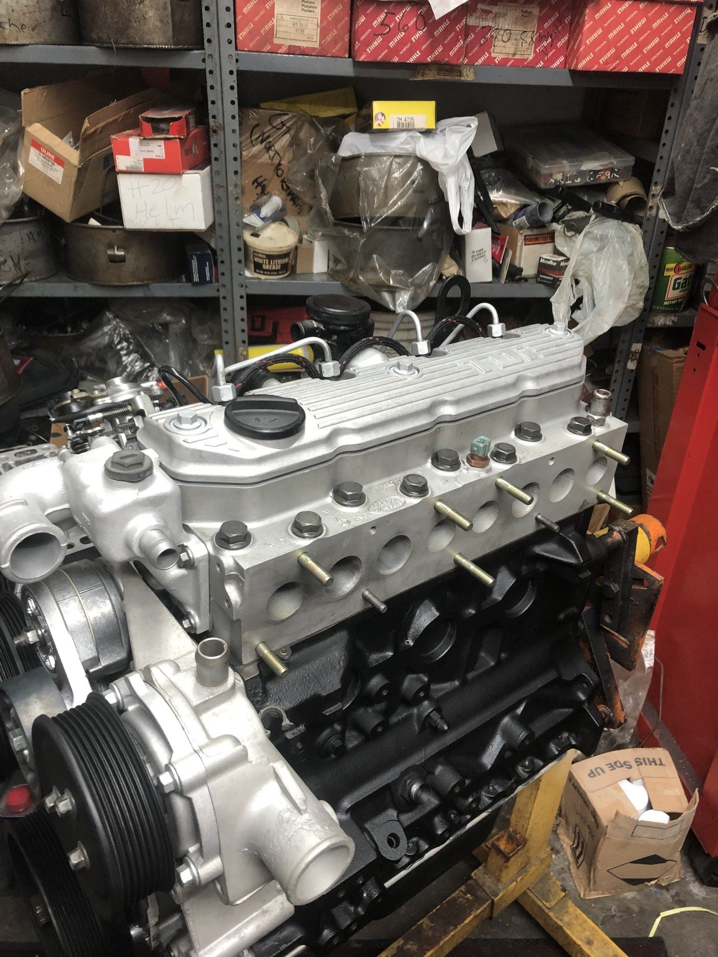

300TDI bored to 2.8 MWM specs. Brand new rebuild everything replaced all the way down to the core plugs.

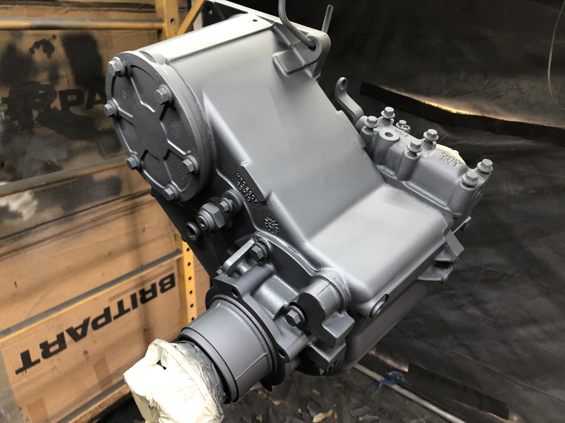

On its way to be mated to MT82 hybrid 6spd transmission and LT230 transfer case.

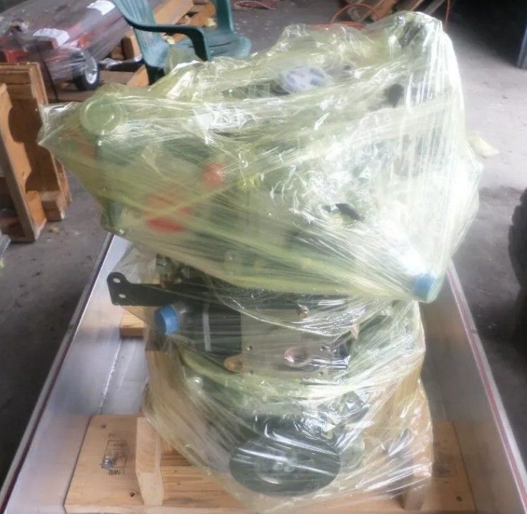

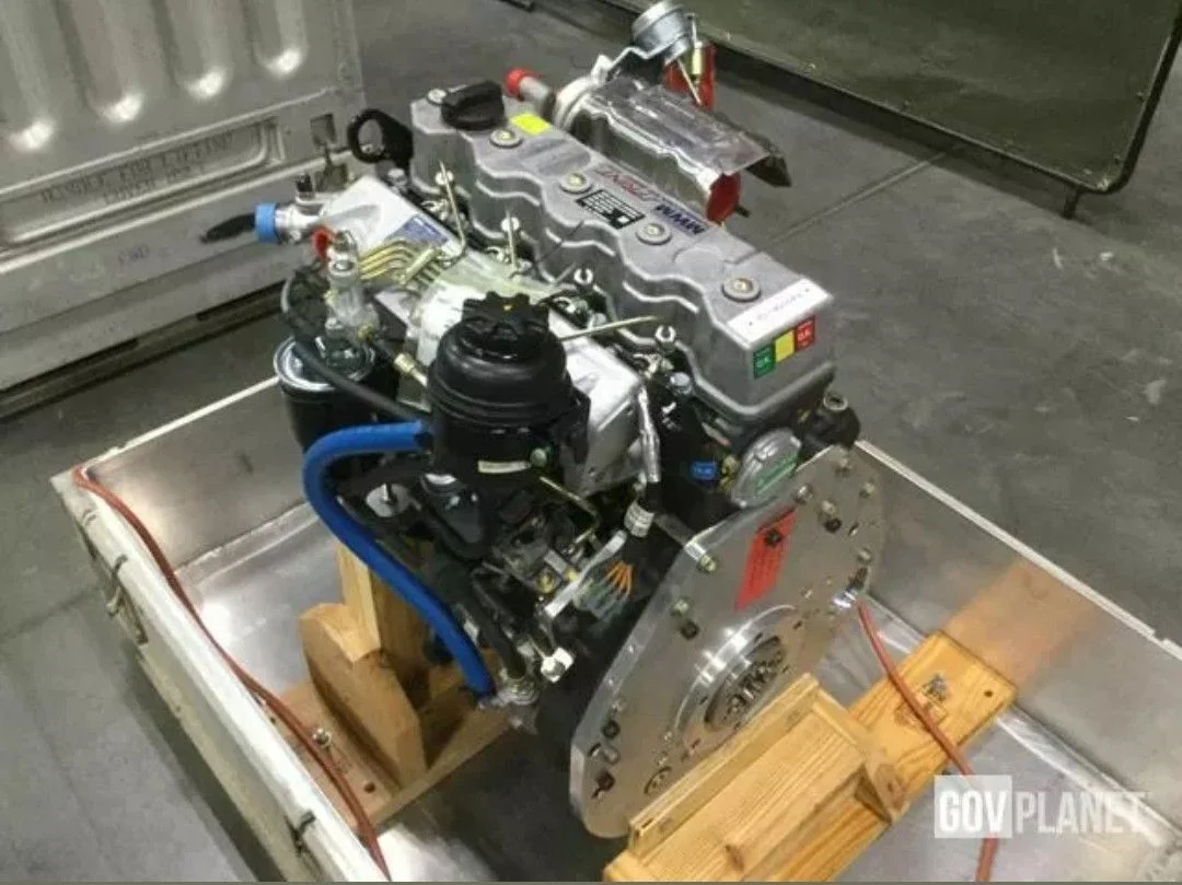

This is the motor thats listed on Ebay. MWM sprint 2.8 turbo diesel intercooled.
I have one as well going in my 93 yj jeep. As long as i can gather all the components.
I was told it will run without a computer.

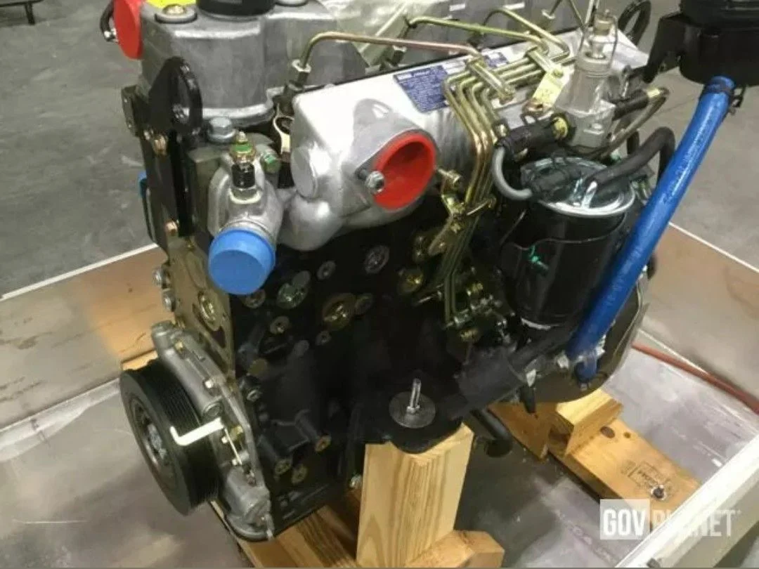

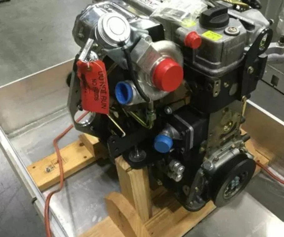

What type of engine is this in the pictures
This is the Land Rover 300 TDI bored out to the 2.8 MWM specifications. The 2.8 MWM started life as a 300 TDI. Ford bought Land Rover and made the 2.8. They called it the 2.8 Power Stroke for the Brazilian Market. Then Navistar took it over from Ford.
Im not sure how it compares to the 2.8 sprint. The valve cover lookS the same. Overall packaging looks different than what is shown below of a 2.8 sprint on eBay. But you can clearly make out the MWM logo in the valve cover.
As long as it is running mechanical injection no ECU is necessary.

Its bad ass. Has a hydrolic pump on front of engine goingvto run power steering, hydraulic brake booster and a hydraulic winch off of it. Has what i believe is a gear driven waterpump.
I've read people getting 400k miles out of these changing the oil and replacing water pump gears
