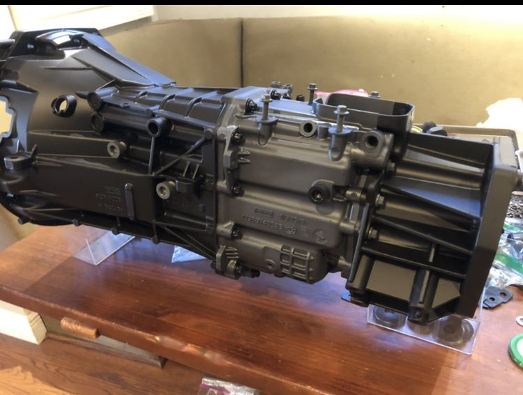

as for transmissions I focus on manual MT82 6spds (2007-2016 Defender not mustang) but you could mount one of the automatics used on the discovery gen 1 and gen 2 directly to the 2.8 No Ecu or TCU so shouldn’t pose a problem but never attempted. Parts are still readily available new OEM and genuine.

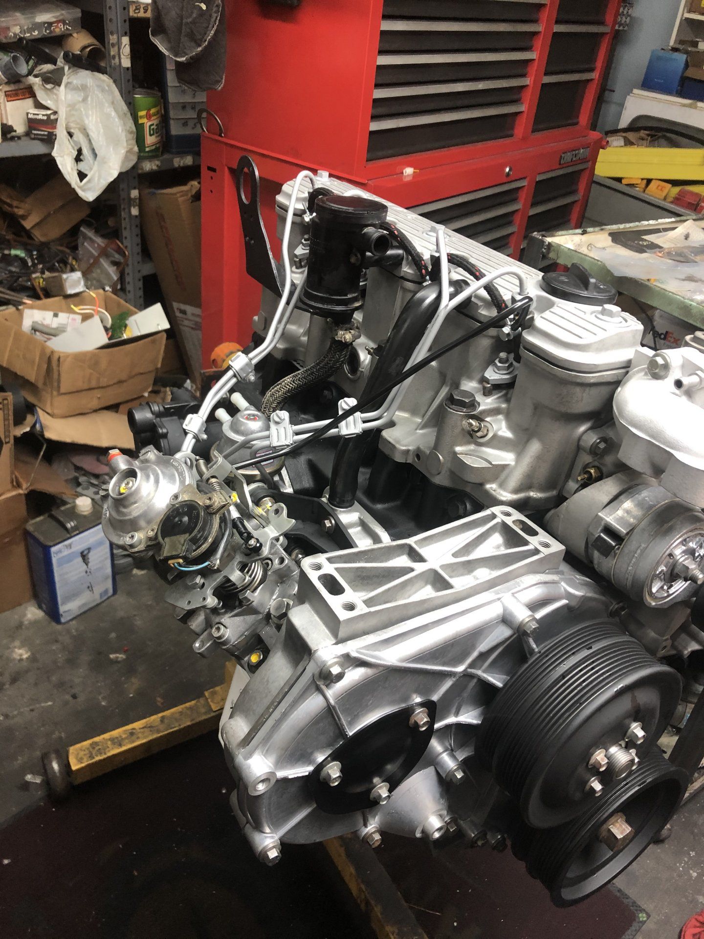

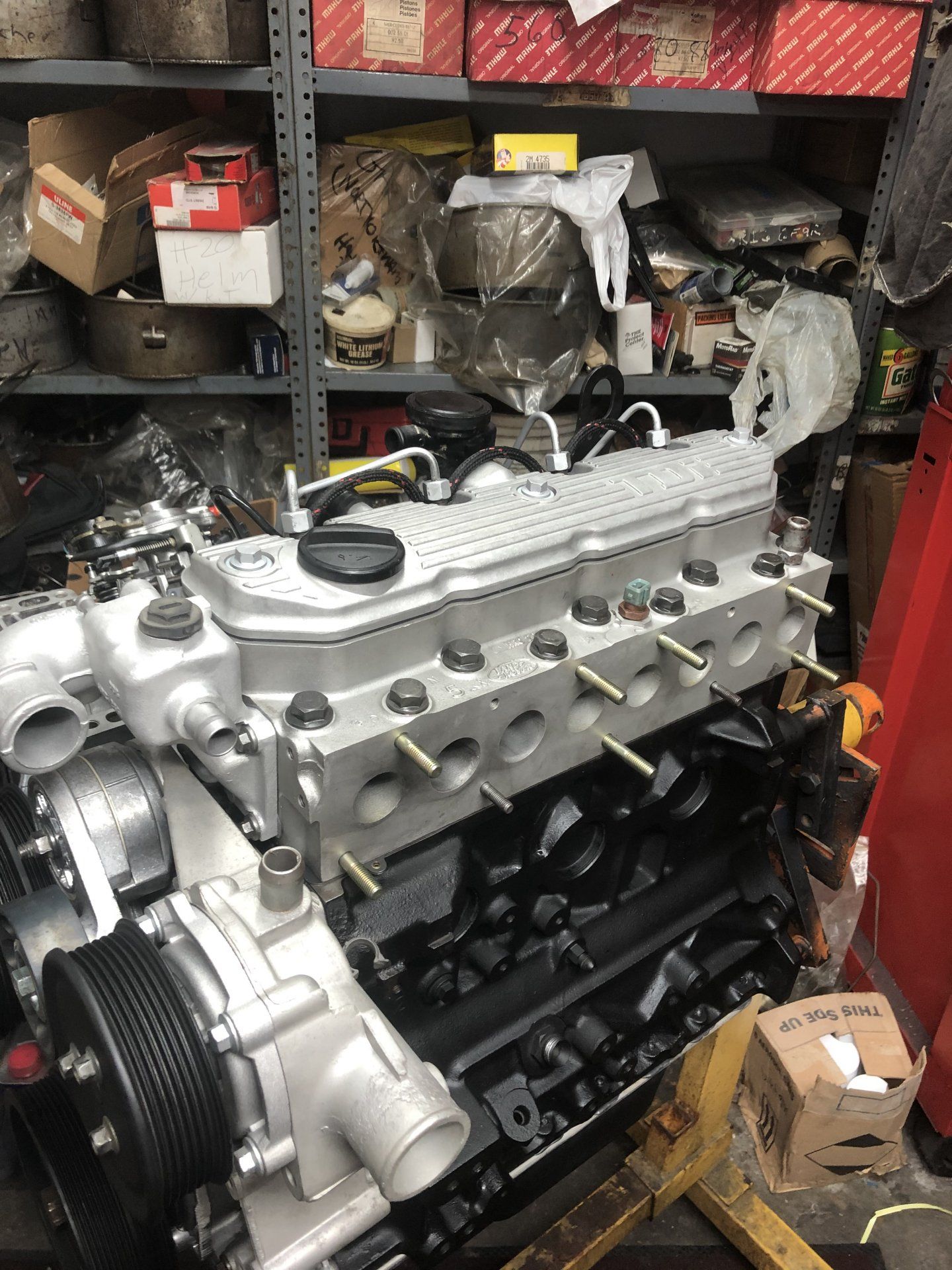

300TDI bored to 2.8 MWM specs. Brand new rebuild everything replaced all the way down to the core plugs.
On its way to be mated to MT82 hybrid 6spd transmission and LT230 transfer case.
