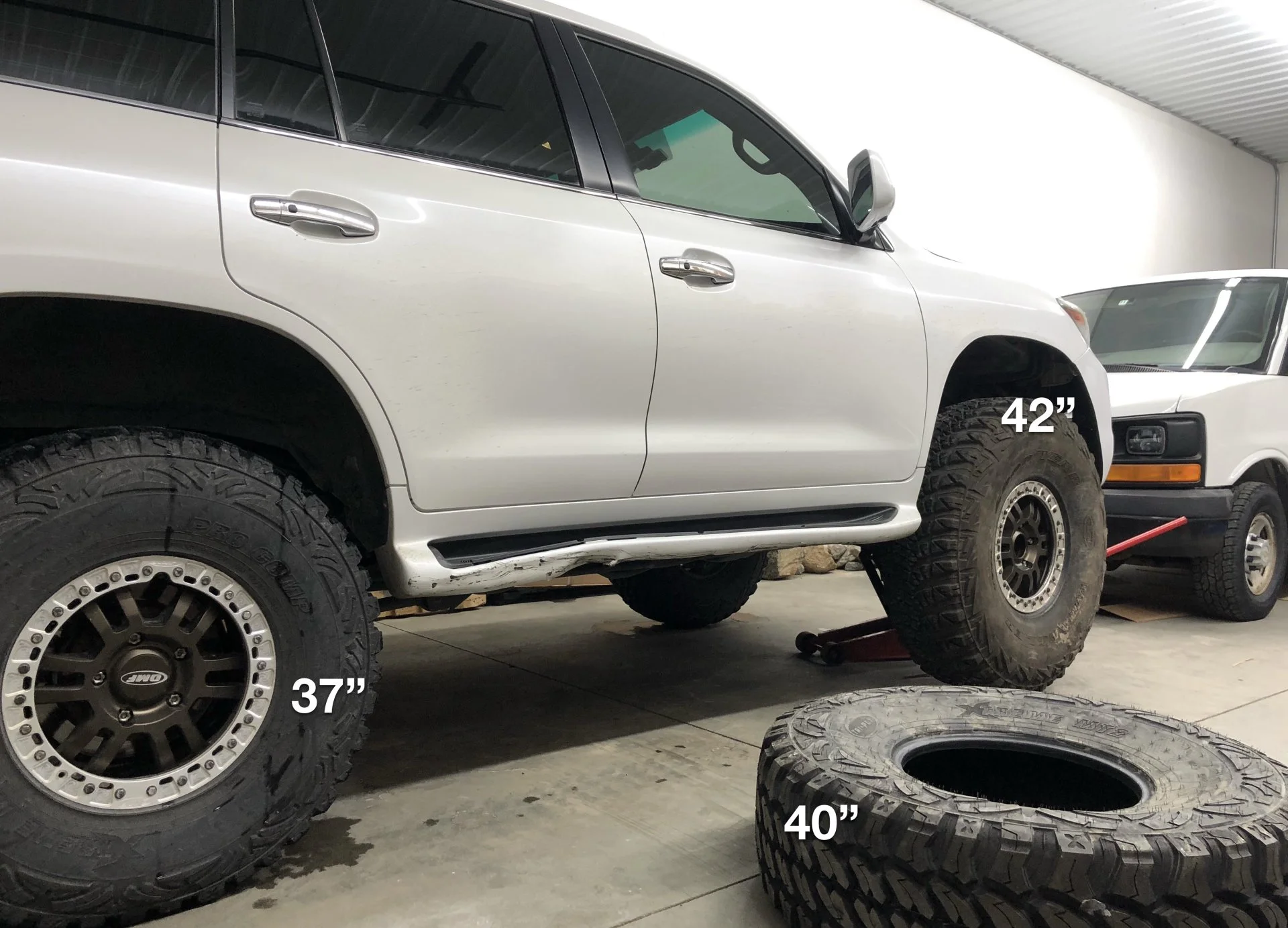

A friend of mine offered his spare 42” tire while it was off of his rim. So I dismounted my spare 37” and put this on my rim just for science…
I had some renewed enthusiasm to go bigger than the 37’s.

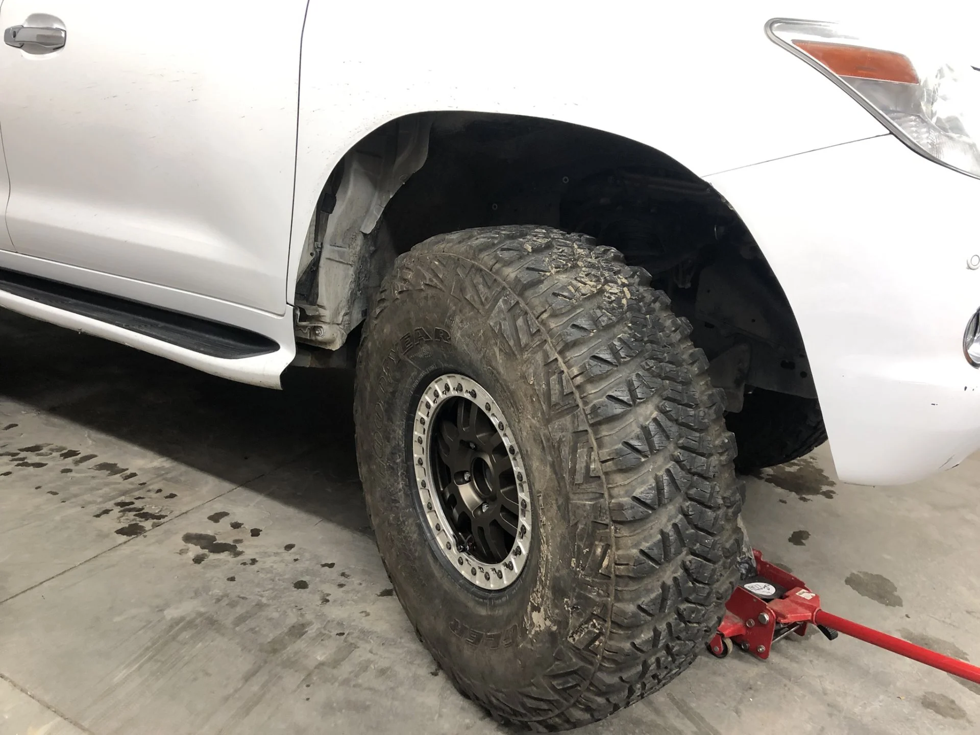

I knew the front would take some work but each newer Land Cruiser series has had larger fender openings making things a little easier…
Windshield washer reservoir would have to go and I started cutting.
Those are 👆🏼 photos with the shock & bumpstop removed to make sure of clearance.
Then I realized the tire was just too close to the frame to get full steering, so I swapped to the Tundra front end with SPC UCA’s…
Then I had my inner fender/firewall patched up…
And with the fender on I decided to simply cut more off of it…
A friend of mine also offered his spare 42” tire while it was off of his rim. So I dismounted my spare 37” and put this on my rim just for science…
