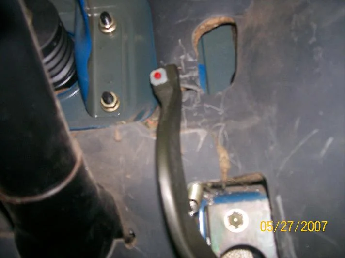

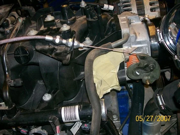

OK this will be the last update till she comes back from the Exhaust shop... The throttle is hooked up and using the trick from previous builds use the Lokar cable and a $3.00 pack from the HELP section at AutoZone # 75450 and you get the one clip you need to hook up the cable without modifying the pedal... Also here is the finished cable and the P.S cooler installed.:idea:

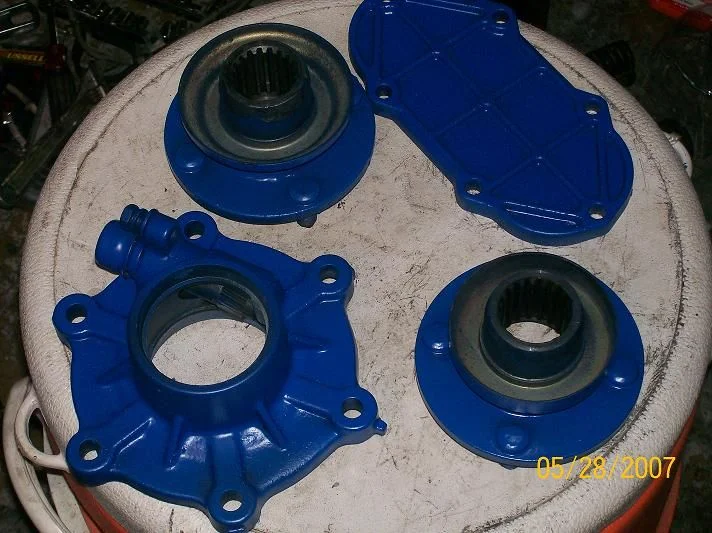

Incase you were wondering...
Yes the transfer case has Blue accents on it....

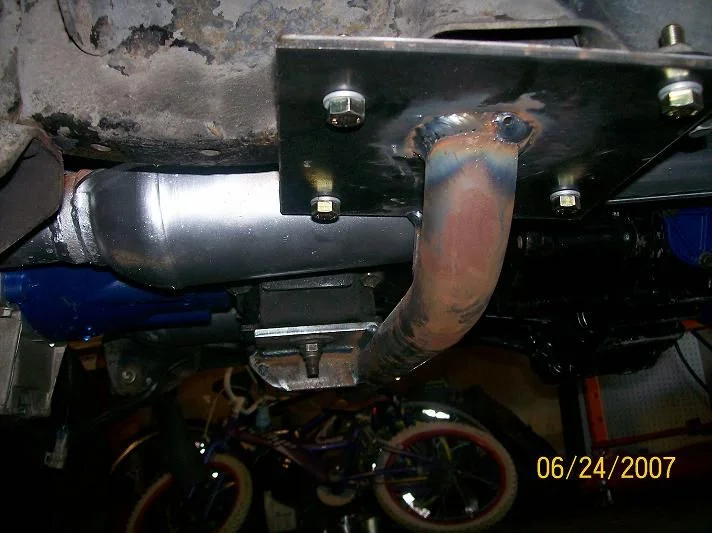

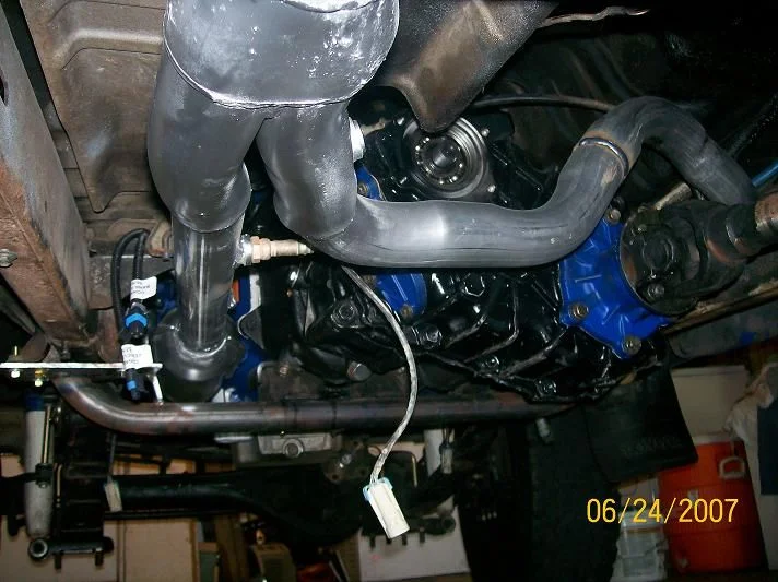

Well after being near death sick I am going to pick up the cruiser from the muffler shop. Mark @ AA muffer did an awesome job again. So I will post the pics of the exhaust and new cross member. That will leave me a few small items to tie up and do the driveline modification.:bounce:
