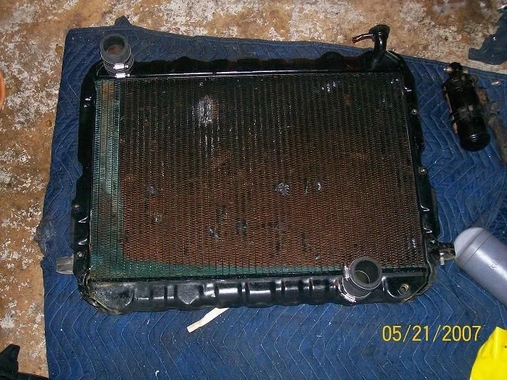

Great to hear that did you already send out the tranny? BTW I was looking at the radiator last night and it shouldn't be to hard to move the ports to the P.S side and make it look clean. Get the leg healed up and we'll be expecting to see some major progress. I bet if you spring for a good wrenching party you could get Philo's to turn a wrench again.:idea::beer:

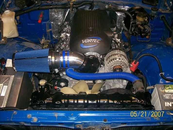

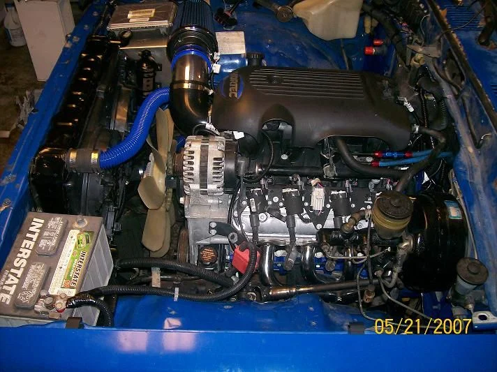

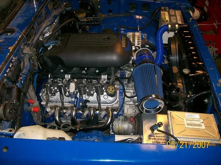

Update she's ready to go for exhaust

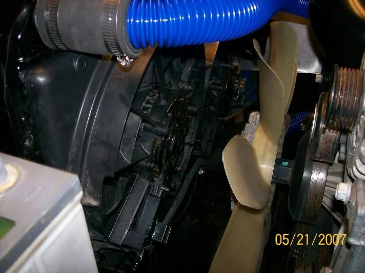

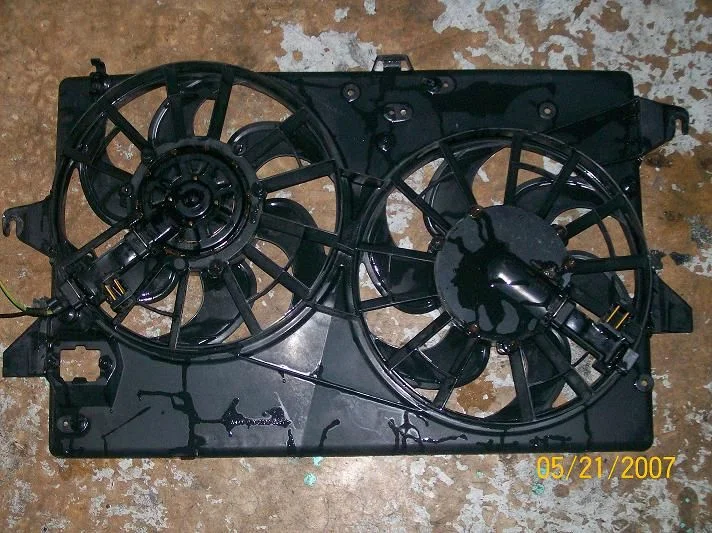

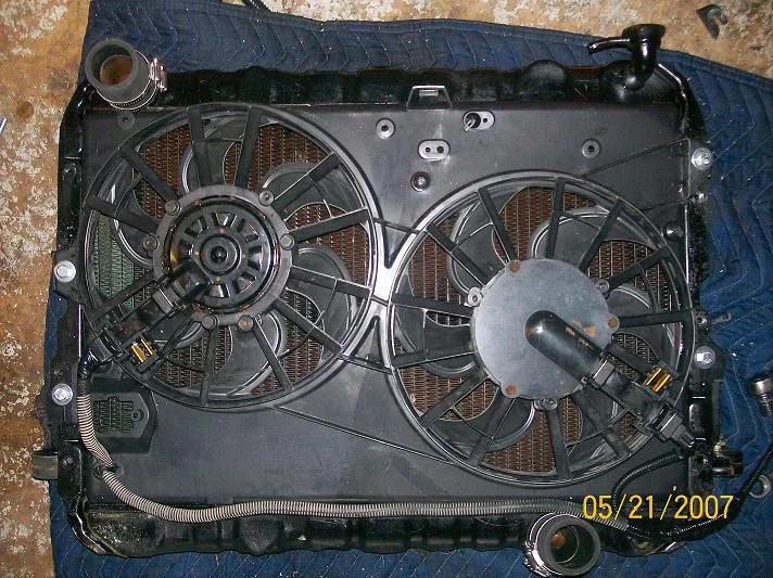

I haven't had a chance to post the progress but she's ready for exhaust. I need to run the heater hoses and close up the interior but this is where it is at. I got the contour fan mounted and wired into the harness, the tach is back from redline and the air cleaner assy is in. Hope you like it so far.
Very cool you are making great progress. Are you going to keep the mechanical fan with the electric fan? If yes, why? I have run my 350 with a Vovlo fan for a while now with no problems.
