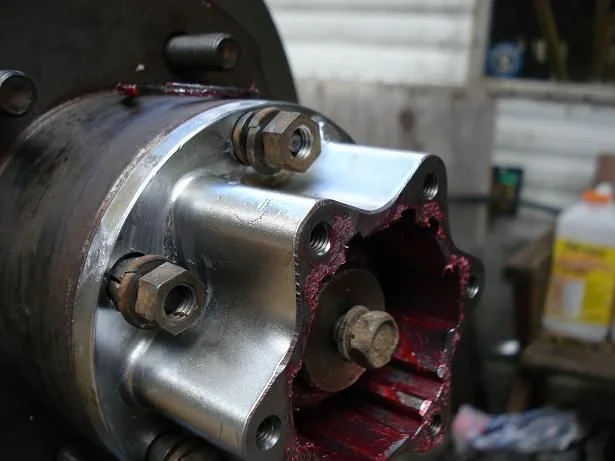

If your Runner has the ADD system with drive plates, then I think all you need is the locking hubs to do the swap.
The only hard part about the swap will be getting the cone washers out while removing the hubs/drive plate.
Here's a pic of the cone washers, they are under the lock washer, under the nut...
attachment.php
I'd say a 1-2 banana depending on if the cone washers were anti seized last time they went on.... If you want to rebuild the hubs before they go on... it's a nice way to spend an evening... :D
