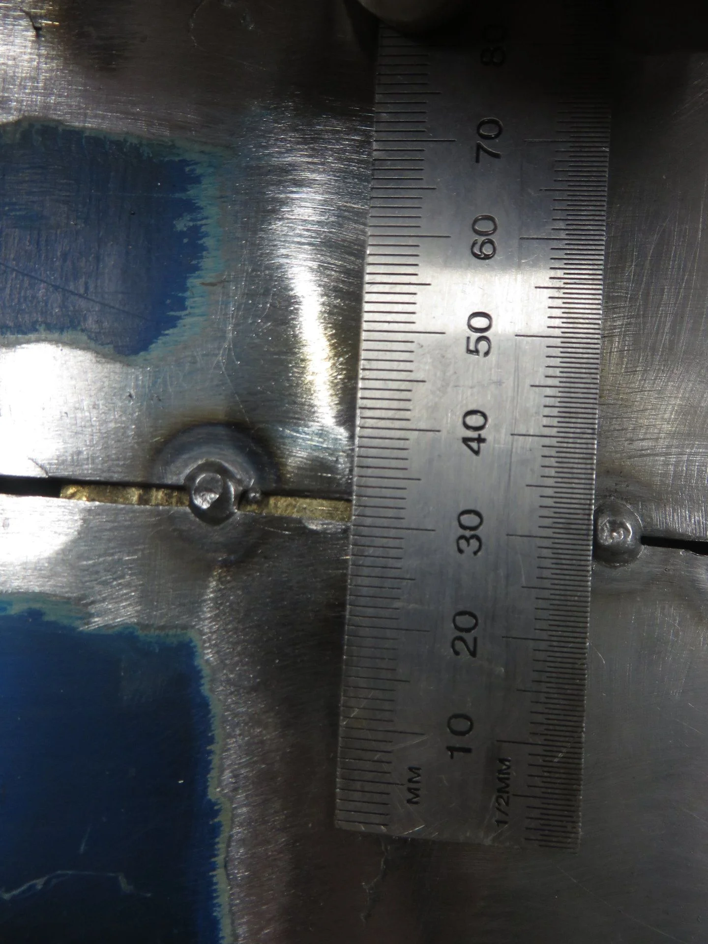

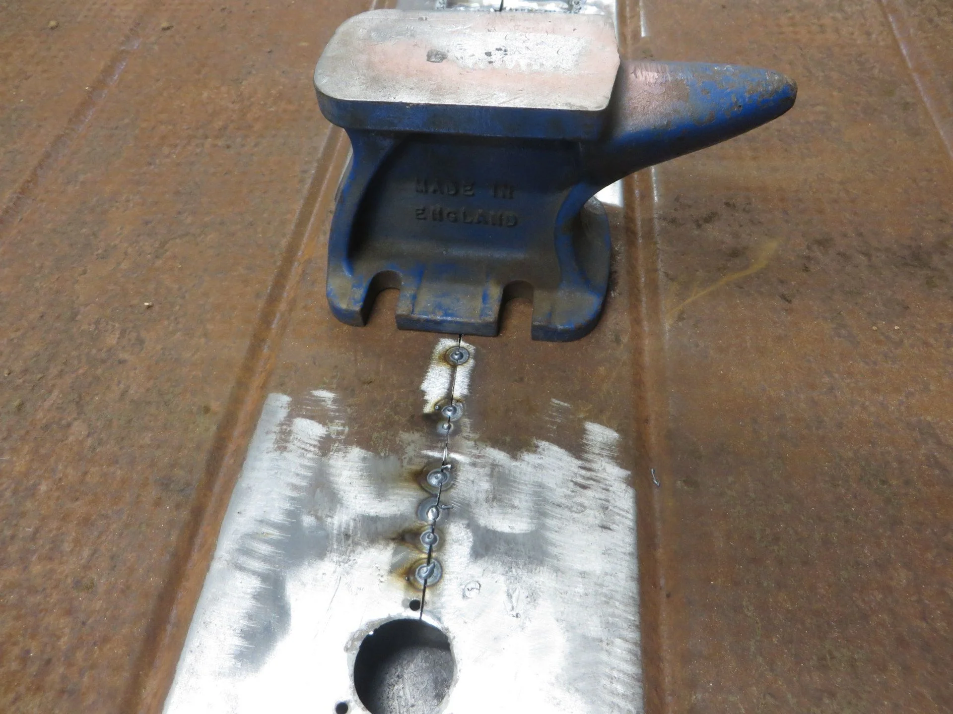

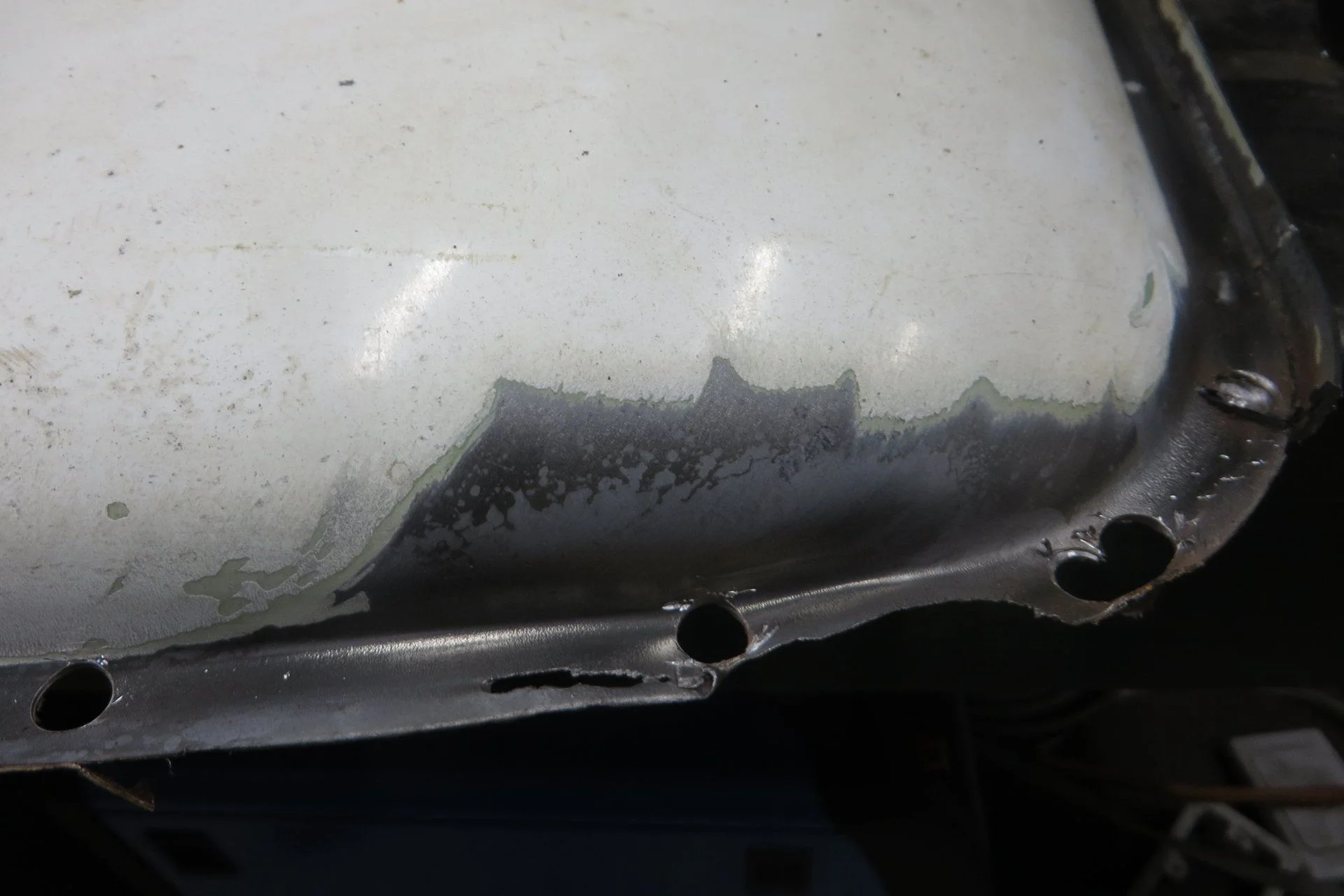

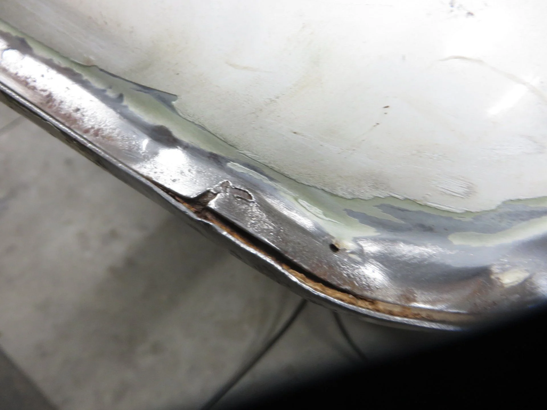

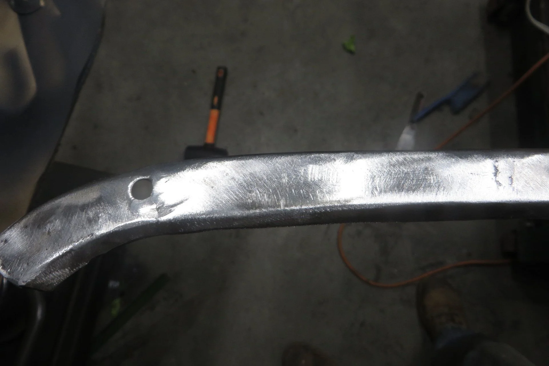

I then started to stitch it back together very slowly. The cut opened up to about 3 or 4 mm. It took me a good three or four nights of slooooowww stitching. Wait for the weld to completely cool stitch - repeat. Occasionally I would flip the roof over and weld on the inside of the cup and used a small anvil to try and stop of from warping.

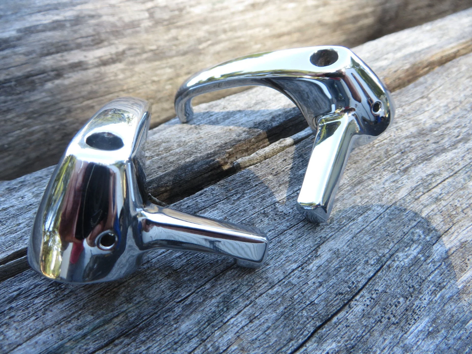

After re-chroming. Now those are some damn sexy handles. I know what you are thinking fellas..........don't screw around putting them back on the truck. Just wear'em as earrings!!
No ....
...find a nice truck to screw them on ... or build a nice 45 out of rotten one to screw them on.

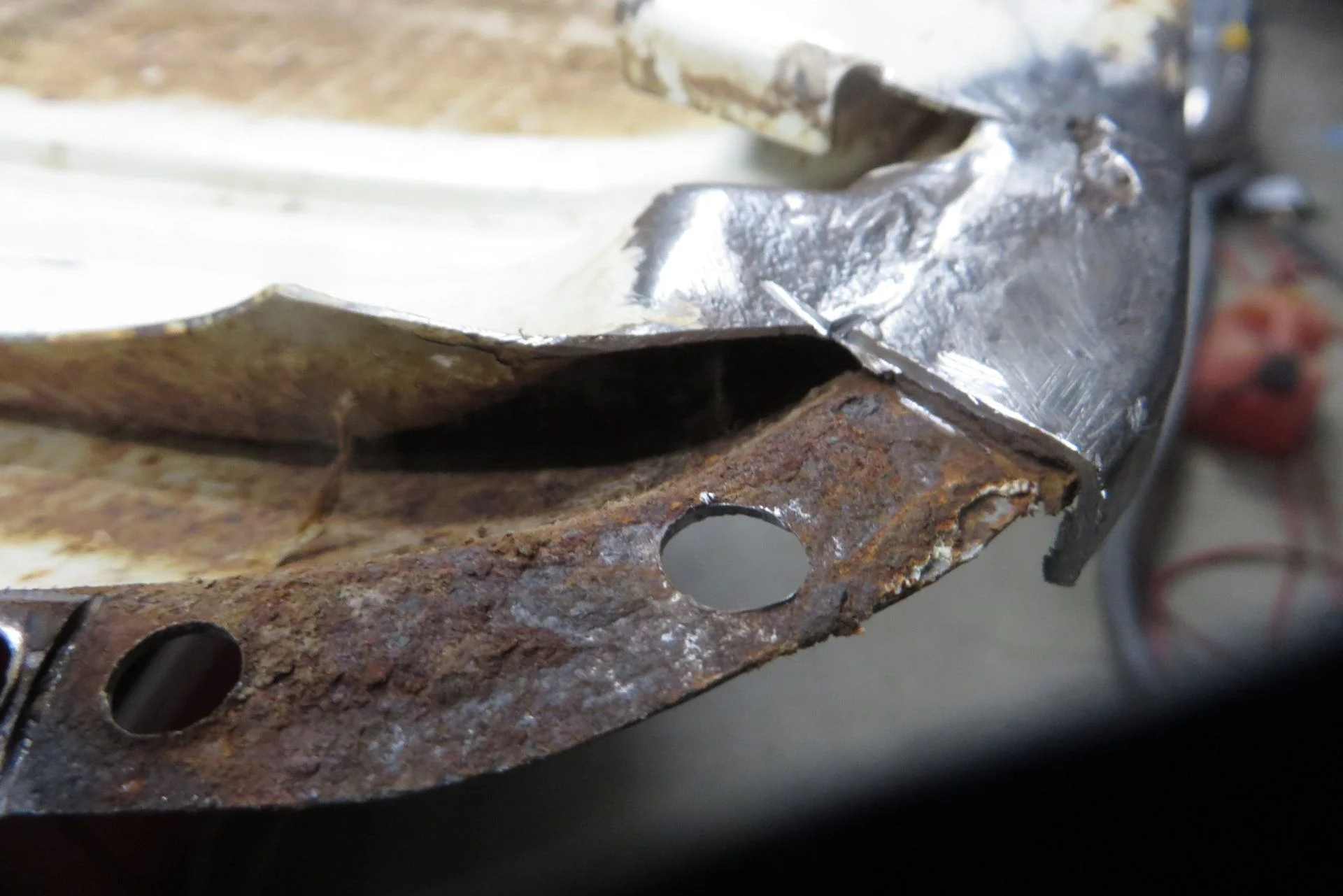

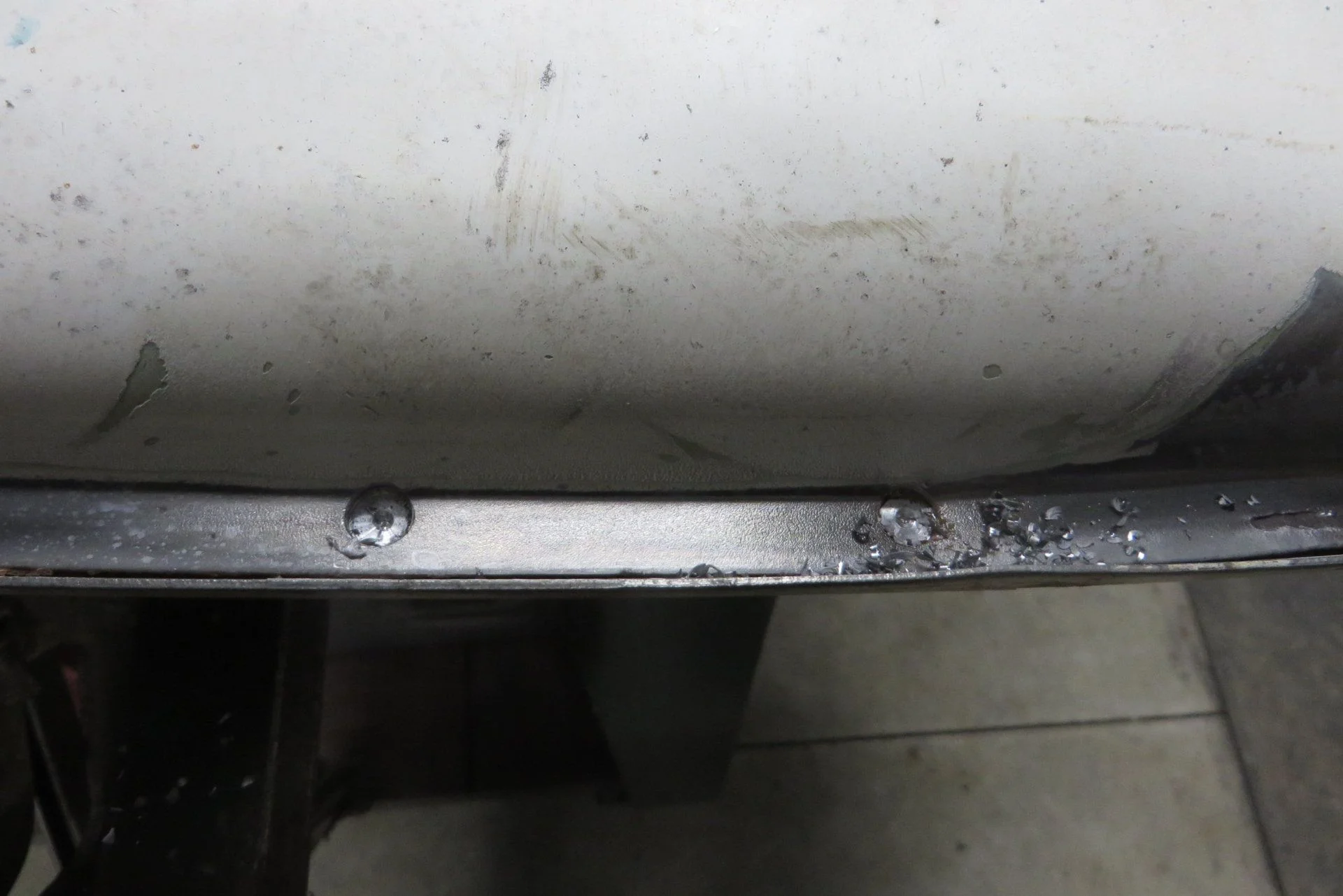

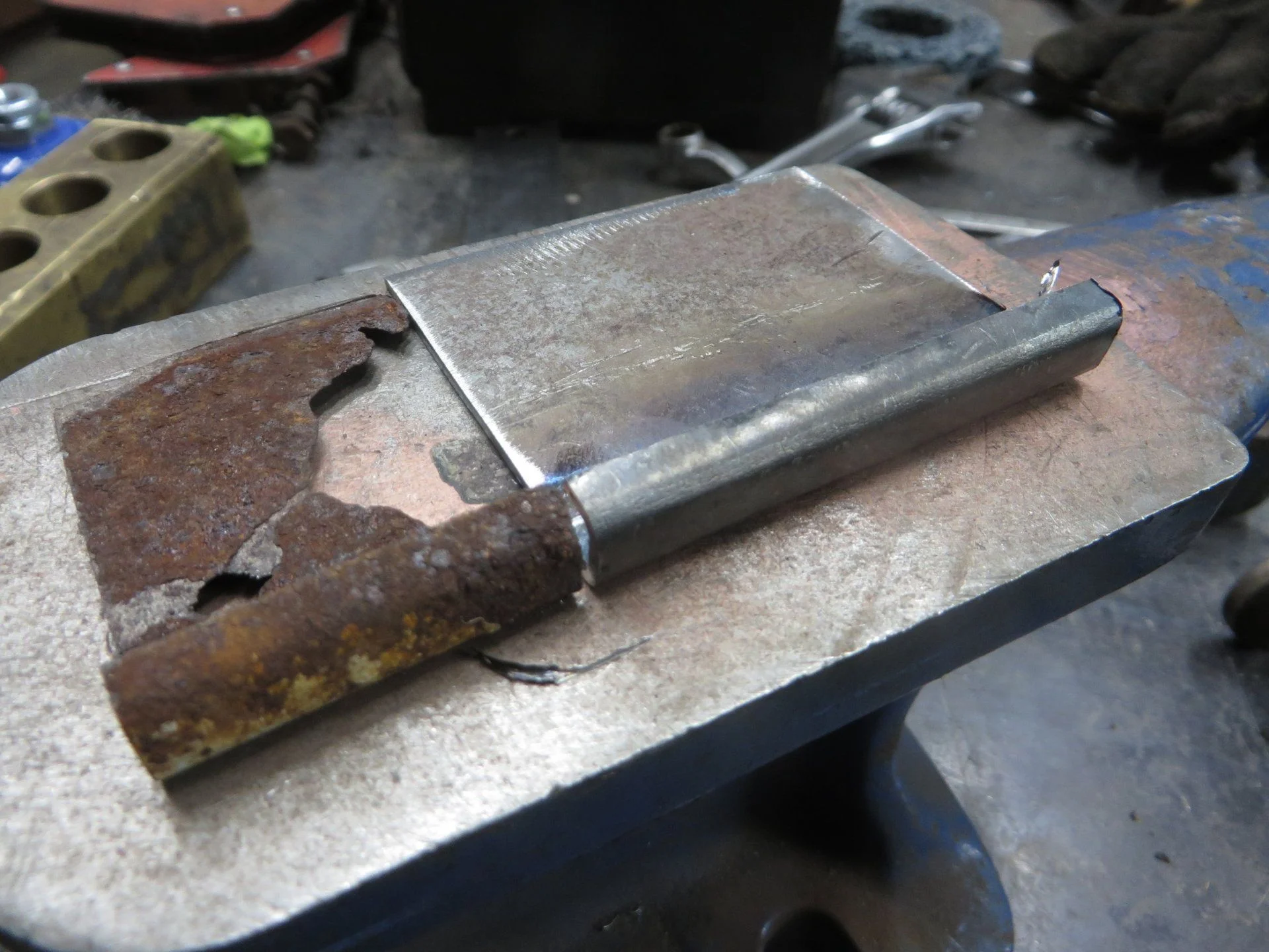

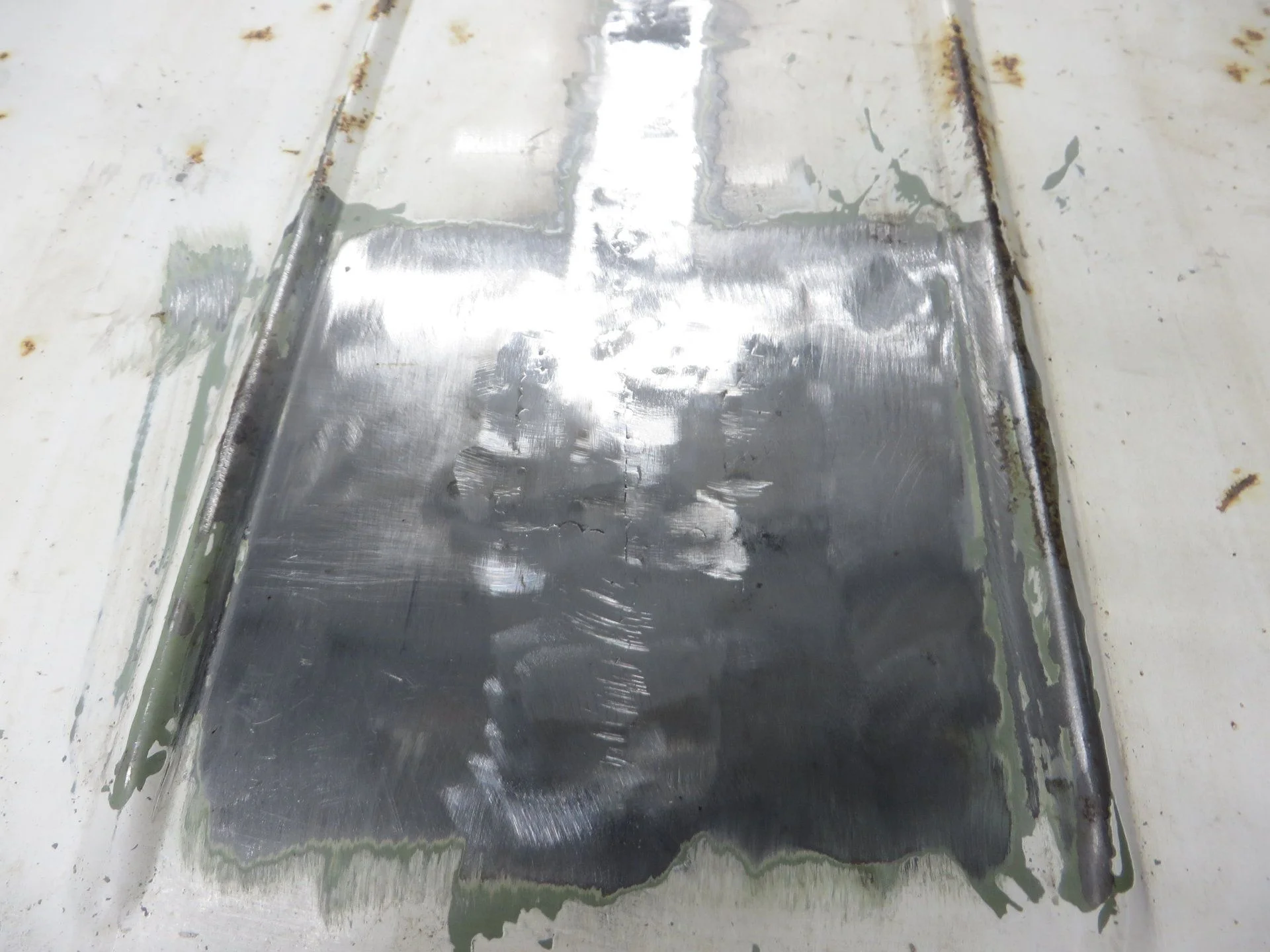

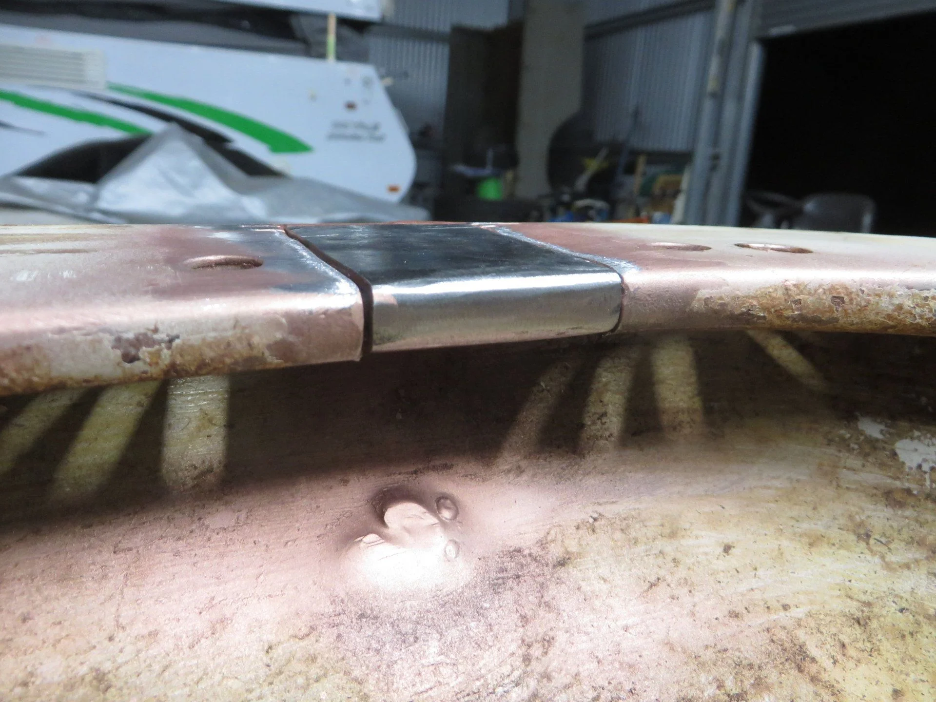

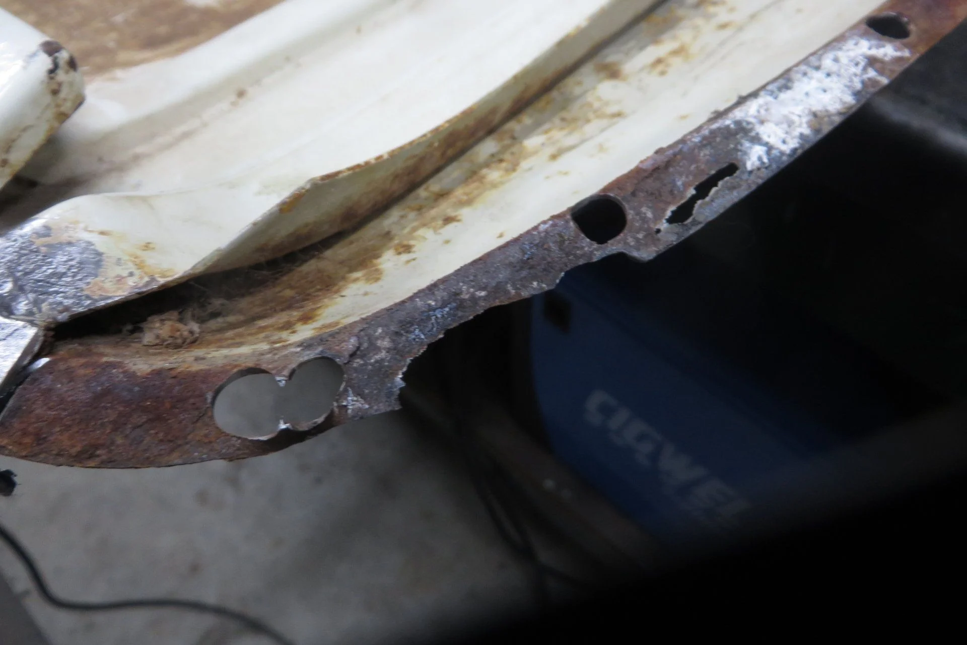

Work continues on the roof. I end up drilling out the 25 spot welds around the front drip rail. There was a fair bit of swelling between each of the spot welds which made me think there was a fair bit of rust lurking between the roof and gutter. Also trying to get the grinder into the gutter to clean up welds was proving difficult, so I took the plunge and pulled out the spot weld cutter.

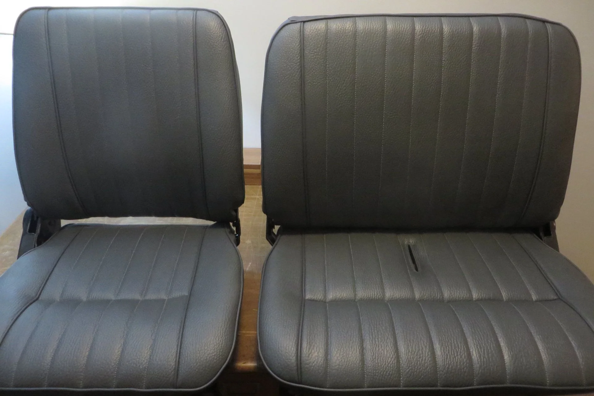

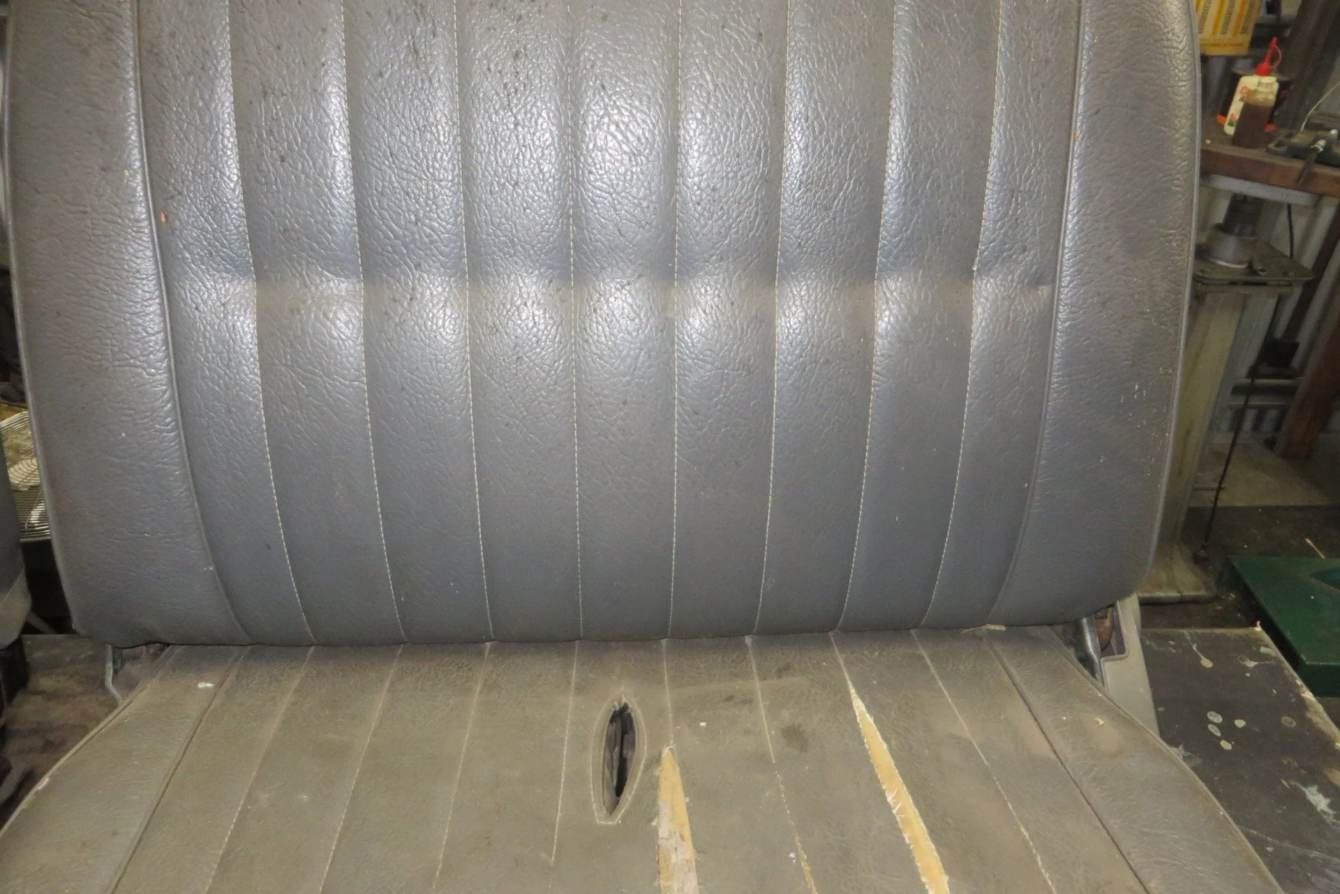

I like the vented passenger seat for any passengers that are a bit “gassy.” :p
Great stuff on the roof repair.:clap: I’m in that arena too as I have a very tired and rusty roof. Should be fun. Lots of pounding I’m sure.
That is very funny. They seats prior to recovering did smell a little like they had been used for testing a Russian Nerve Agent.
