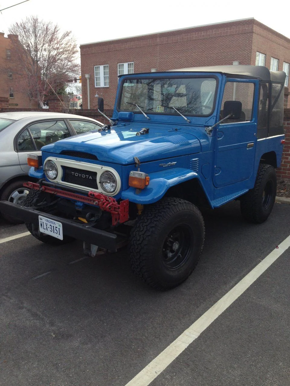

Hi, I have a 1976 40 in Alexandria (Old Town area). The motor locked up last week and won't turn either way. It had dumped oil and I assume it's toast. I had put that last motor in from a donor truck 5 years ago ('78 2F block with a rebuilt '74 F.5 head). Unfortunately I no longer have a place or time to do the work myself. I would hate to sell it, but don't think I can put more than a few grand into it right now.
