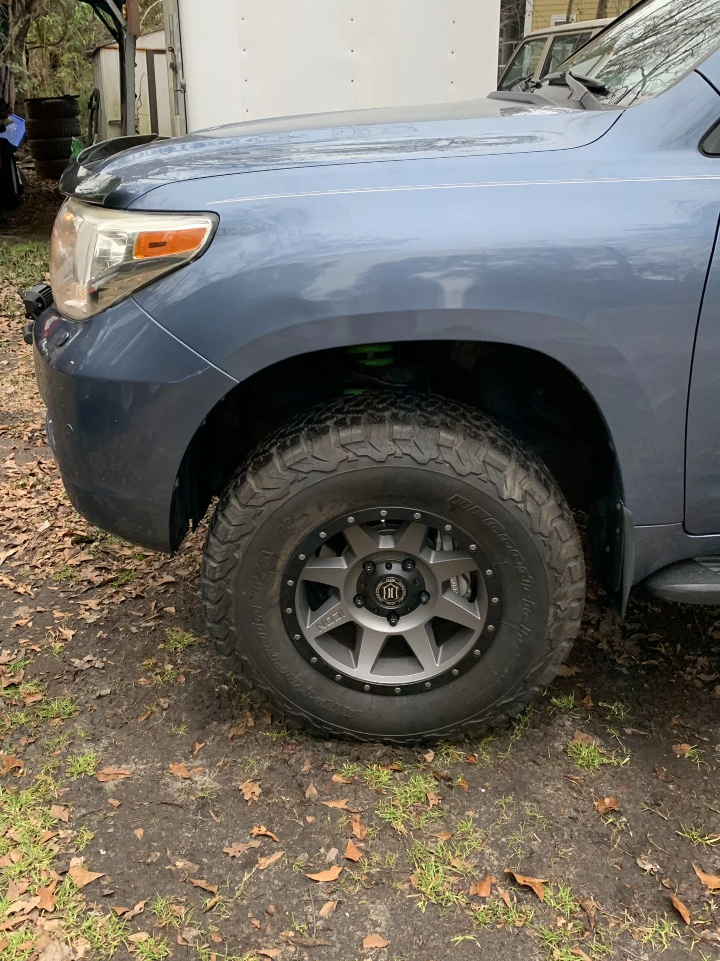

I did the 17 x 8.5 Icon’s with 25mm offset. Had to trim the mud flap a little bit but no big deal. 34 10.50 BFG all terrains. I did a 2” Iron Man lift but I didn’t need to lift it for the tires to clear. The tires were fine before the lift went on.
