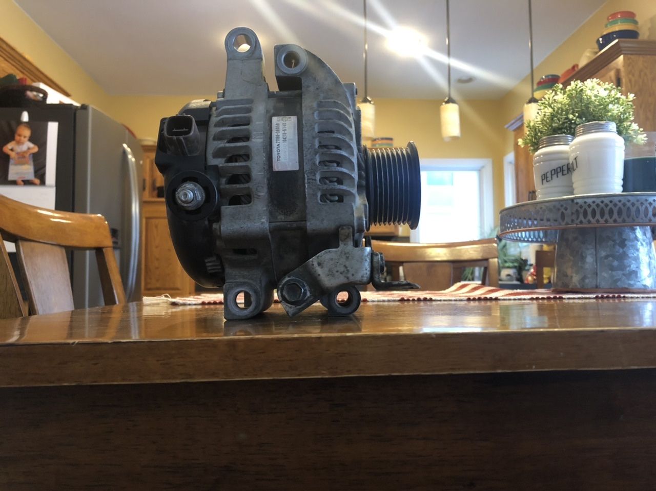

Here is a link to my thread on this experience. It turns into a starter thread but the altternator is on my kitchen table in post #9.
I struggled. A better mechanic would have struggled less I'm sure. The FSM procedure doesn't seem possible but maybe there is some way to rotate stuff on a certain sequence to get the alternator out through the side.

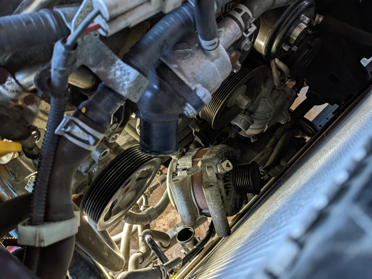

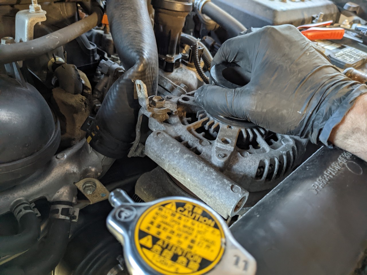

Well I got it out. No way will the alternator ever go out over the frame rail. I pulled the radiator to “make things easy”. Fan mounting nuts had been jacked up from prior work done at dealer so I spent about an hour and a half filling the nuts flat so I could get a wrench on them. After the radiator was out the rest was “easy” and only took me 4 hours to get the PS pump and alt out. Even with the PS pump and radiator out, getting the alt out is a bear.
Edit: adding pic of extracted alternator. Just 3 bolts and a nut...

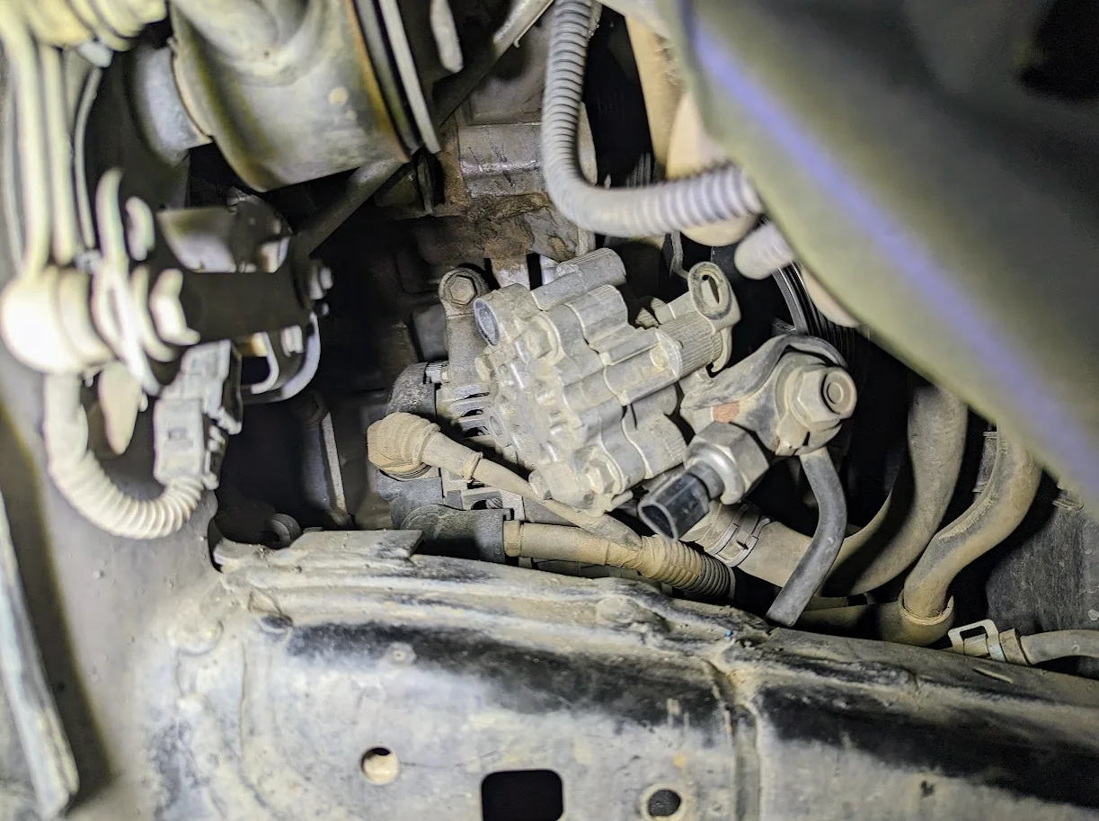

shot with PS pump out and PS hogh pressure line and pressure sensor pulled out of the way:

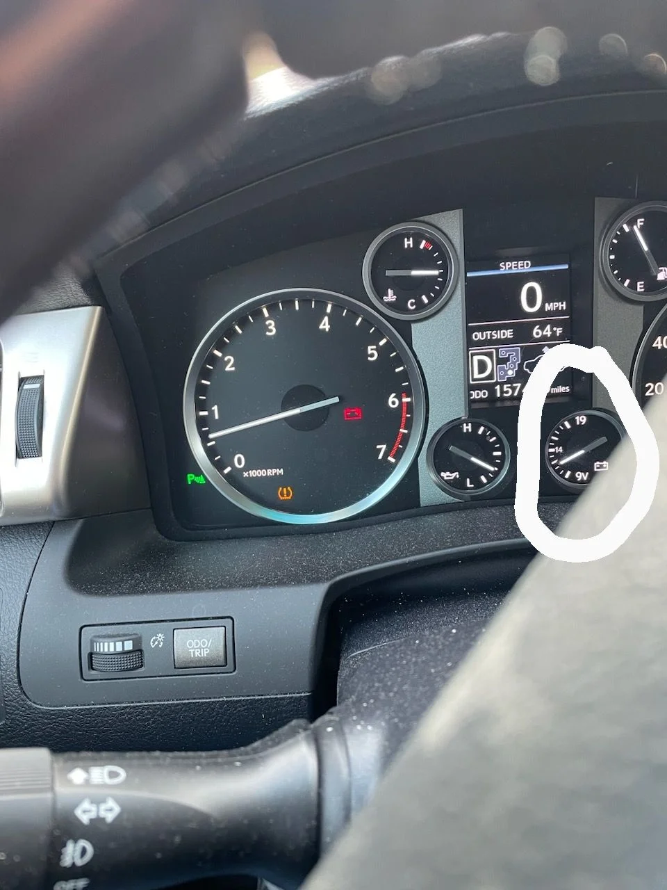

Just wanted to give folks some more insight into an alternator replacement on the 200. I had the battery dash light pop up on me the other day. Checked voltage on the battery while running and was only getting 11.6v or so. The alternator needed to be replaced.
If you're a search nut like myself before diving into projects, the only couple posts I found were saying it had to be pulled from underneath. Saying both lower radiator hose and the power steering lines had to be removed. @CruiserFan88 mentioned the pressure hose on the power steering pump being $300 if damaged.
In all the Tundra videos online, they're able to simply pull the alternator through the passenger wheel well when the power steering pump is unbolted and swung out of the way. The smaller frames on our 200 series just don't allow for that.
Not wanting to damage any high pressure power steering hoses I opted to try to pull the alternator up through the top of the motor. Even if I had to pull the radiator. And really, it wasn't all too bad. The fan, shroud and both radiator hoses need to be removed and then you pretty much have all the access you need.
No more battery dash light once it was all back together. It was a solid 5.5-6 hour job for me last night. Although, I broke away for taco Tuesday with the family and wasted about an hour on the 2 lower alternator bolts. Without any breaks and being more familiar with the job, I could probably tackle it in 3-4 hours.
Thanks to all those that posted before me on this subject. Hope this adds to the conversation and gives others another angle to try.

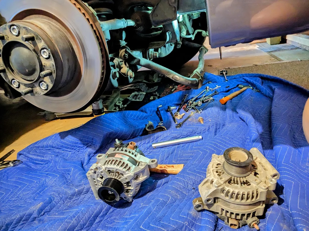

New alternator is in.
Voltmeter shows it charging at 14volts.
Battery light gone.
Here is roughly the steps I took.
1. Remove passenger side wheel / tire. Take out two plastic clips and rotate the wheel liner up out of your way.
2. Remove Bottom Shields/Fan/Shroud/Radiator Hoses and Serpentine Belt. I also dropped the sway bar (4 17mm Bolts) to give more access from below.
3. Loosen the transmission cooler hard lines by taking the bolt out of the front bracket (On Alternator). And the bolt on the backside bracket close to transmission. *This step is necessary to give yourself room to get the bottom 2 Alternator bolts out.
4. Remove bottom two alternator bolts. Even with loose transmission lines this step is still a PITA. I attacked this from below.
5. I wound up removing the power steering pump. (2) 14mm bolts come out through the front of the PS pulley. Then a prybar through the wheel well to get it out of its bracket. I used a coat hanger to hold it up out of the way once it's free.
6. Once the PS pump is clear, it's a straight shot from the wheel well to the remaining bolt and nut holding the alternator in place.
7. Lastly I Disconnected the plug and 12mm nut holding down the power terminal then fished the alternator up through the front of the engine bay on the Driver's side.
This took basically a whole day for me granted I'm not a professional. I'm sure there are others who could do it faster with less steps.

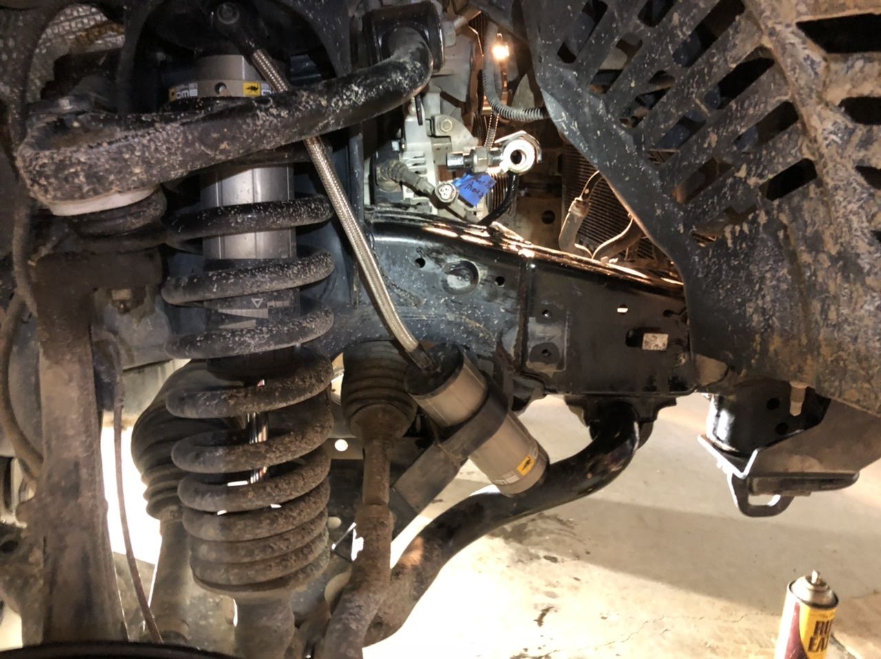

Are you going at it from the passenger side wheel well?
Working it from that side, but everything I've read suggests it's not possible to extract it from there like the Tundra. Wonder how close it is and whether loosening a couple body mounts could do it? I don't have the right tools to try that path.
One more pesky bolt and I'll find out soon.
Yea I think a body mount + jack would do it. Would probably work for starter replacement too
Officially halfway. Got the new alternator from Lexus first thing in the morning. Was able to pull the old unit out through the bottom by removing the anti-sway, and several brackets allowing the various lines to flex out of the way. Didn't have to touch the radiator.
