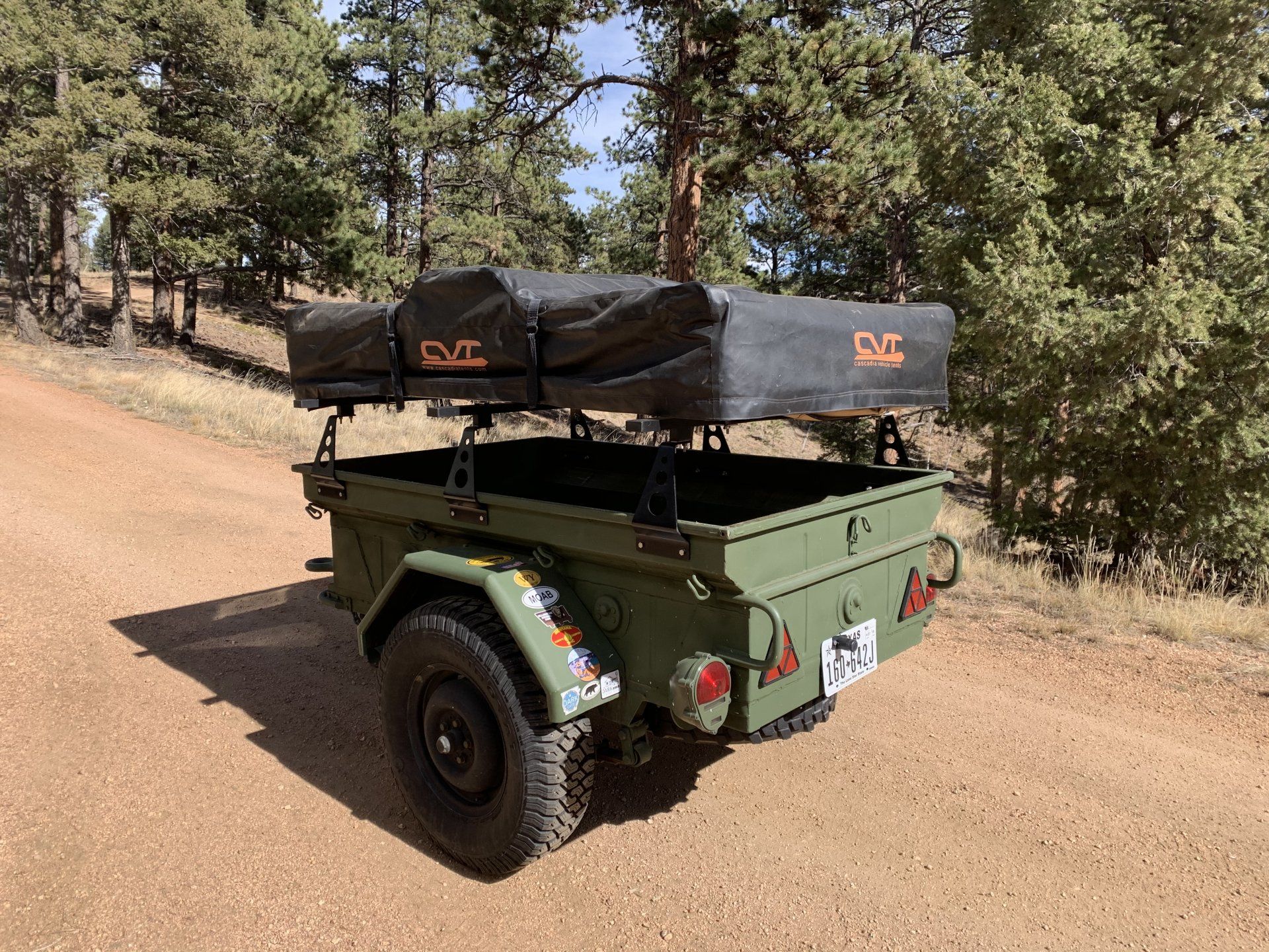

Installed the No-Weld Rack Towers from Compact Camping Concepts today and trimmed my old aluminum crossbars to fit. I would highly recommend these. They are relatively inexpensive, very sturdy, and mount perfectly to a 416 or 101 trailer.

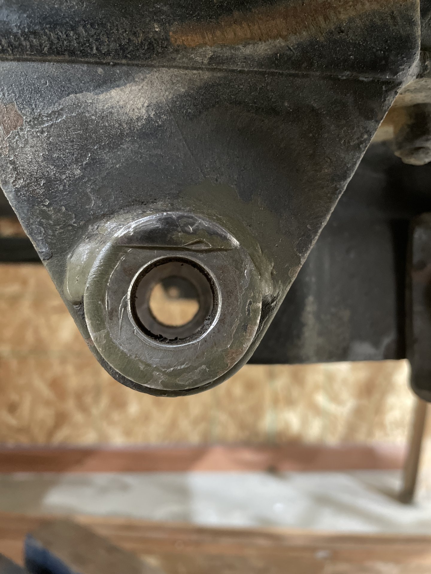

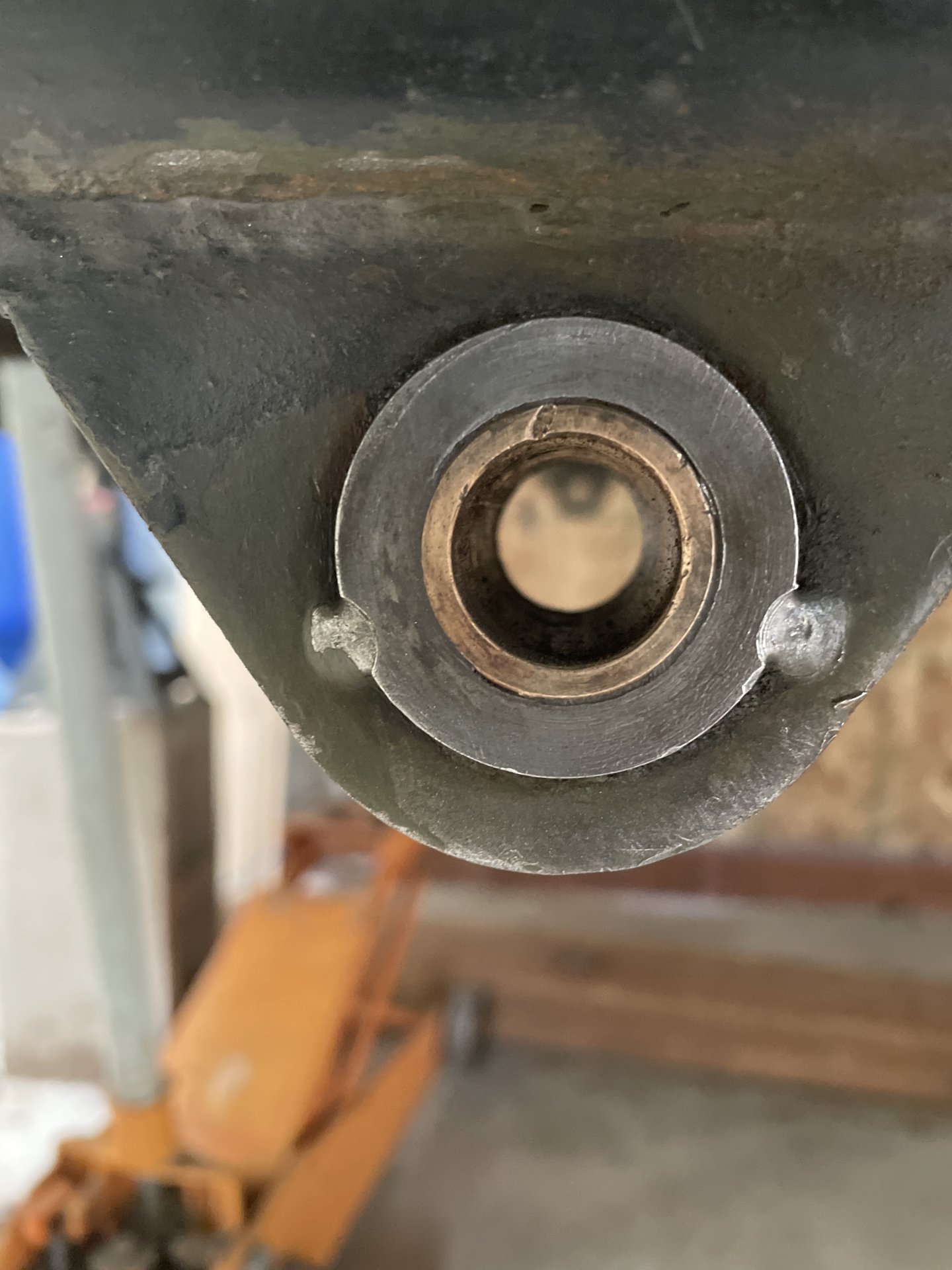

I want to do this right, and want to replace the spring bushings, but I’m not sure there are/ever were any bushings on my 1969 US M101A1. There isn’t much/any space between the inner brass sleeve for the pins. I realize there are some differences in the CDN version, but maybe someone can enlighten me?

Found the technical manual for the trailer on SteelSoldiers. Looks like there are no “urethane style” bushings, just the brass sleeves.
