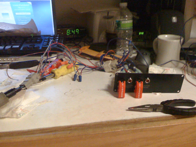

Wired up the locker today:bounce::bounce: Haven't got it installed yet but I built the harness out of a 92 FJ80 harness, using a couple of connectors and a bunch of wires. Installed the new switch and cover and the actuator works flawlessly:grinpimp: Here are pictures of the two diagrams I used, one from Inchworm, the second from 12VoltGuy. The Inchworm diagram has the colors for the factory locker harness I used and the 12VoltGuy diagram has the connection locations on the 12VoltGuy DPDT switches:

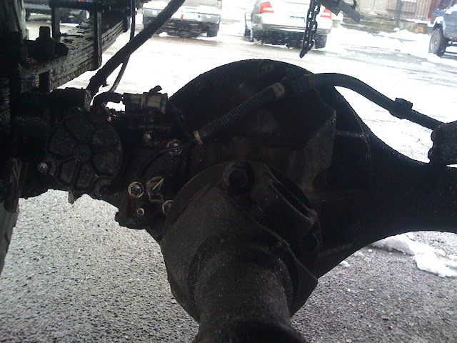

Here are a couple pics of the actuator installed on the diff. Has a broken bolt on the main actuator cover, but it seems to be solid. It'll have to get fixed later Installed the new indicator switch and cover as well.
Picture of the harness I made as well as the switch panel with everything hooked up and functional:
Looking awesome so far!! Have to finalize the length of the middle harness to lead up to under the dash, then I'll get the whole thing installed!! Should be later this week, got three more finals to finish:bounce::bounce::grinpimp:

Installed the e-locker yesterday. I am not sure if anyone has ever retrofitted an e-locker into a 60 FF housing before, but god damn the clearances are close. There is no more than 1/4" clearance between the actuator motor and the u-bolt and I had to sacrifice my PS rear shock as it was in the way, but other than that, everything went swimmingly. I extended my temporary harness by 10 feet to go between the axle and dash, but that was about 5ft too long. I wanted to make sure the harness wasn't too short but didn't want to go measure as it was cold out. Oh well, everything works, just need to finish fitting the switch panel into the dash. Maybe I'll get that done this week:hhmm:

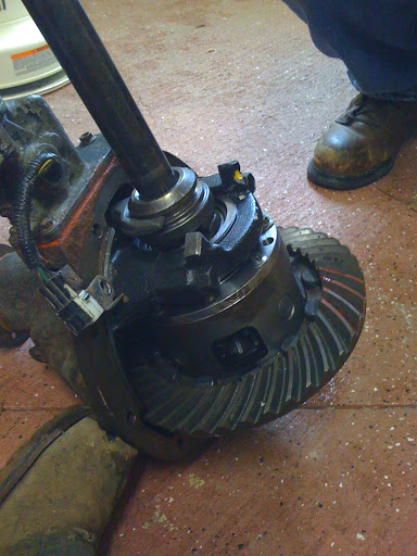

Anyway, here are some pictures of the e-locker install. First is the locker with my long spline shaft slid in.

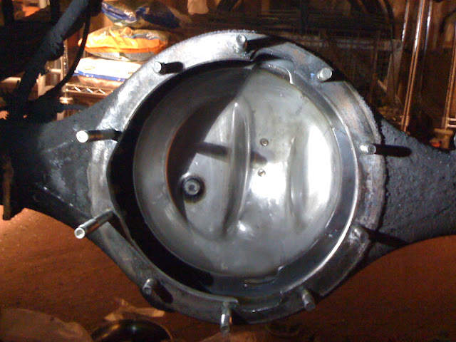

Housing ground out on left side for locking collar. Longer studs installed next to ring gear slots and next to ground section for the actuator.
Diff installed with harness. I zip tied the harness to the e-brake cable. Works well thus far! Kinda hard to see in this picture but the actuator motor is right next to the u-bolt as mentioned before. Immediately below that is the shock mount cut and bent out of the way. Left that small project unfinished.
