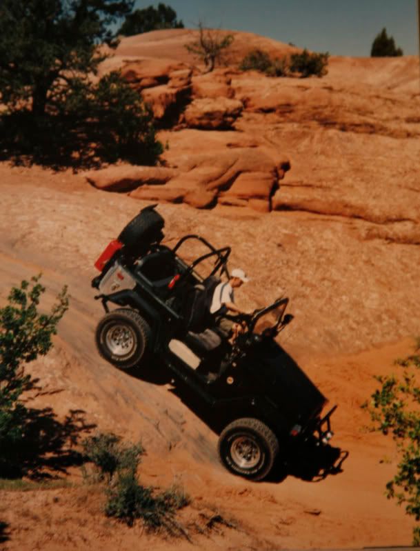

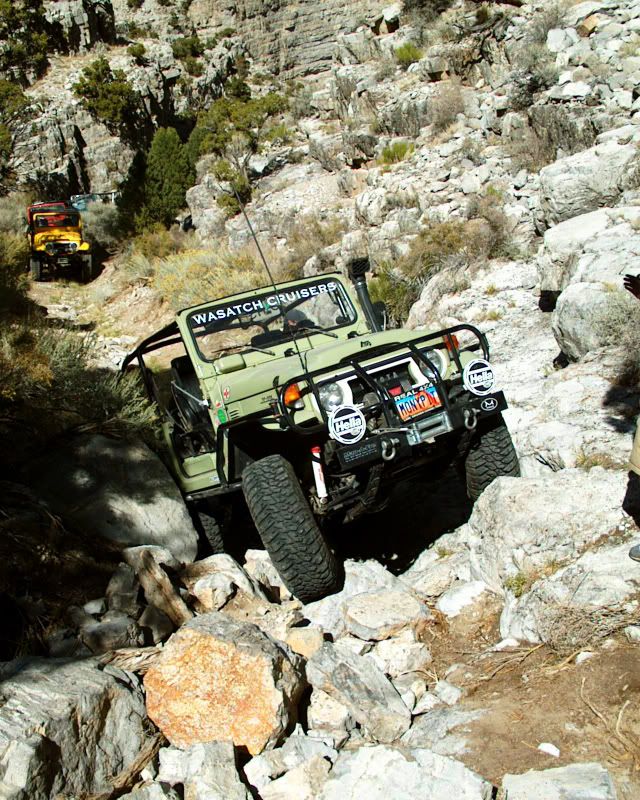

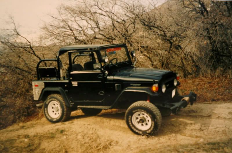

Ok, I'm starting at the top. I purchased my 1976 FJ40 (I'm referring to it as mine for the sake of this thread, but as I've already said, it was sold over 5 years ago now) .....so I purchased my 40 in 1995 and it was basically stock with some white steel wheels and 31's. At the time it had a rebuilt 2F and stock drivetrain. Here's a photo a few weeks after I bought it.

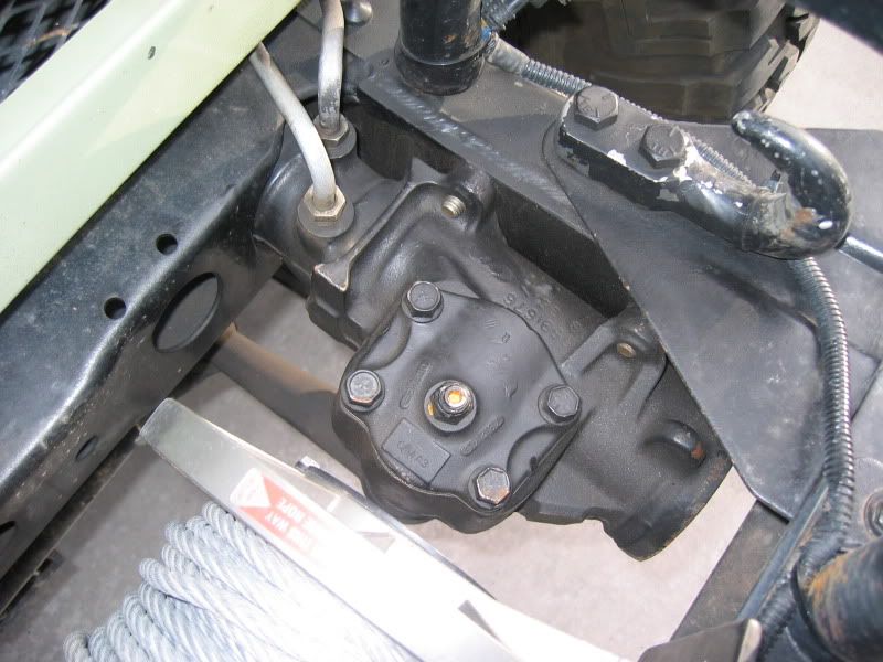

I learned a lot at the first Cruise Moab. The biggest thing I came away with was the stock steering was not great on Moab slickrock. Power steering had risen to the top of the mod list. Along with larger tires, gears and at least one locker as soon as money would allow.
Somewhere in here I blew the motor and in the process of having it rebuilt I found out that the PO who I bought it from had reused the old pistons when they rebuilt the motor.:mad: Brilliant. Rebuilding the motor used up any mod money I had, but I saved up again and finally got the Power Steering (the now standard Saginaw conversion). I did my research on lockers and found the ARB to be the best option since the truck was still my daily driver. Since I'd be into the diffs anyway, I decided to go with 4.88s. And about that same time I made the jump to 35" tires. I remember at the time, people questioned whether or not you could actually wheel with 35's and OME springs. I guess I had a hair more lift with the shackle reversal and 2" extended shackles but I had the truck that way for quite a while. The rear locker opened up a whole new world to me. I ended up wheeling for a couple years with this drivetrain setup and it worked great for what I was capable doing. I started running 4+ trails and having a blast. Truck was still my daily driver.

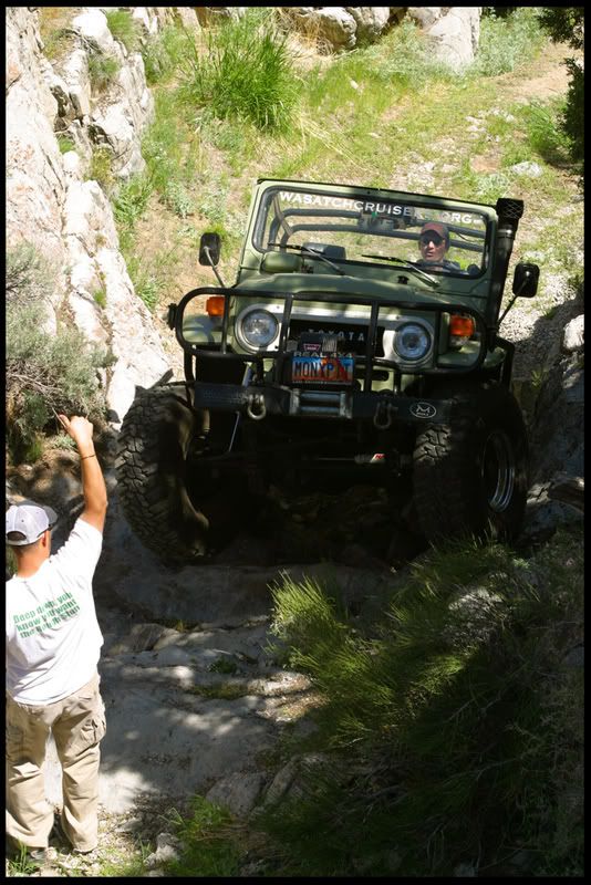

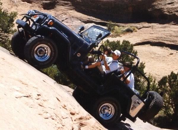

Along came Cruise Moab again. Time to test out the new gears a locker. Oh, and I'd added Safari Snorkel by now, mainly because it looked cool.
New setup with 35's, 4.88 gears and rear locker on Metal Masher during CM '98 (I think).

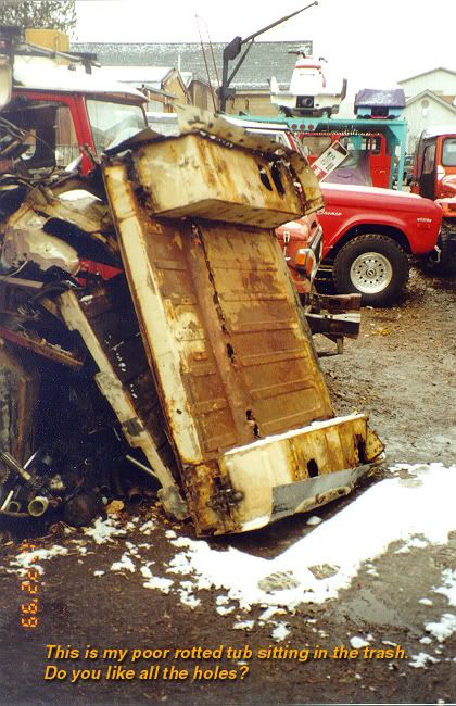

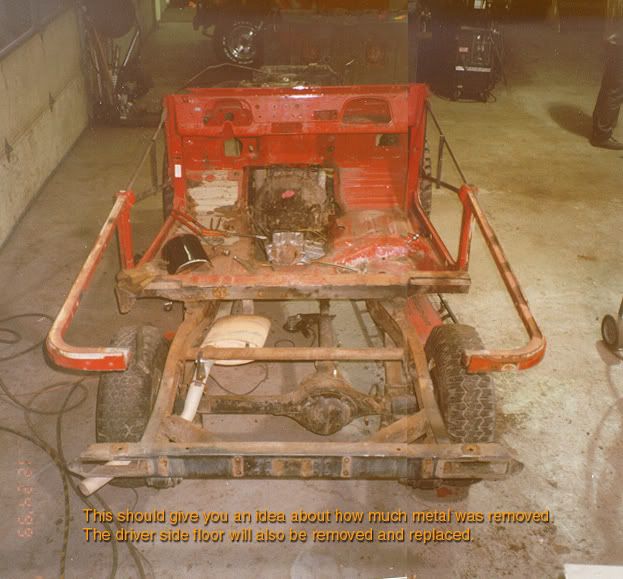

By this time, the body on the truck that I thought was very clean when I bought it had proven to only be a bondo job and it was rusting badly and really falling apart. I had spent lots of time and money by this point at a local shop called Cruiser Outfitters when they were still a full service Land Cruiser repair and fab shop. I took the truck into them to have the tub reskinned and maybe a few other things done. As we tore into the body as we pulled everything apart, we realized that the original tub was in aweful shape and would take more work than it was worth. It was cut off and went into the scrap pile.
My old tub sitting in the trash.

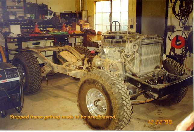

My truck stripped down completely with the chassis sitting bare.
So we found a donor truck that had solid tub rails and door frames to start with and did a full reskin on that tub, including the front floors. Here's that tub after all the skins had been removed and waiting for new sheetmetal. The floor and wheel wells were formed from a peice of 14ga. and the outer skins were a peice of 16 ga. The rear channel was also replaced.

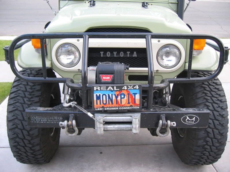

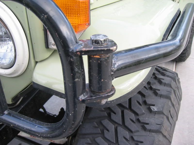

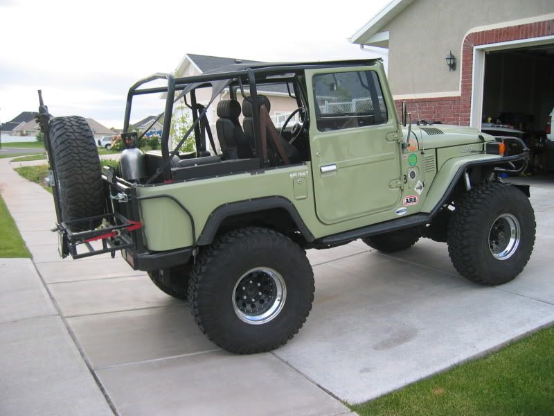

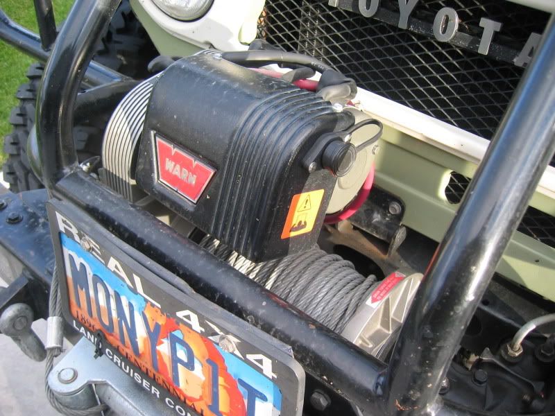

I had everything sandblasted and the tub was linexed inside and underneath along with the underside of the front fenders. At the same time I figured it was worth making a few other changes. I had a family style rollcage built by Cruiser Outfitters. I still think this is one of the best looking cages around for FJ40's and it's too bad these aren't made any longer. I added some front fender protection and some extra bracing for my rear tire carrier that doubled as rear corner protection. I bought a brand new Warn 8274-50 for a steal. I think I paid $800 for it, that's almost half of what they are now. I also traded my stock transfercase and transmission for a freshly rebuilt SM420 and 3-sp transfer case. This took my crawl ratio to something like 82:1 which was going to be awesome.
Sorry I don't have more pics of the reskin and fab work during this stage. Cruiser Outfitters really did an outstanding job. Actually I have pics but they are all prints and I don't feel like scanning them all.

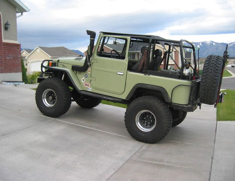

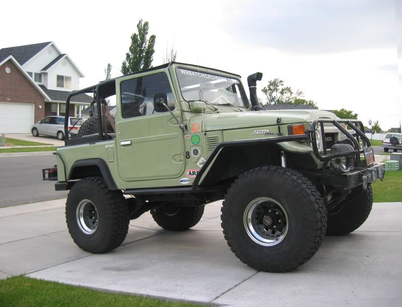

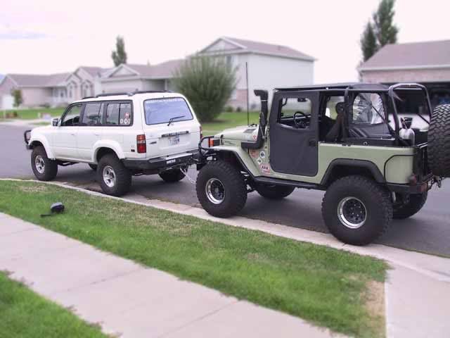

This gets us close to the point the most people are familiar with it.

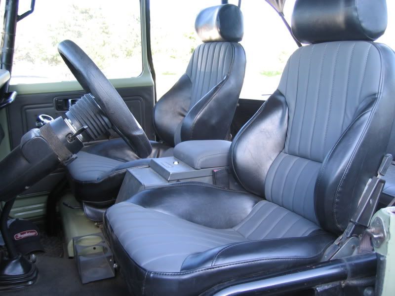

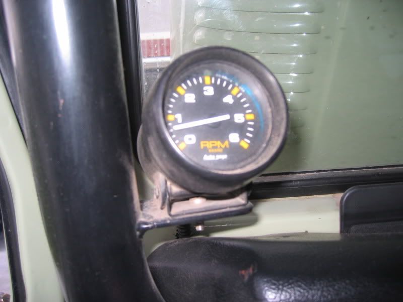

Other tidbits were added during this extensive build up at Cruiser Outfitters. I had them build a seat cradle as part of the roll cage and put in some Procar Rallye Bucket seats. I swapped out the stock turn signals for some 70 series ones. Added a tachometer......

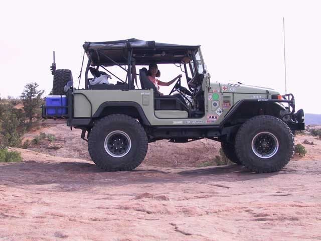

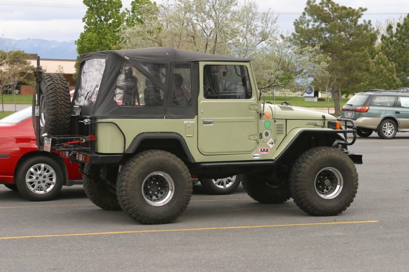

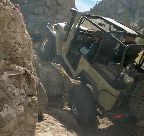

I wheeled it this way still with OMEs and 35's for a couple years then upgraded the suspension again. I went with 5" Alcan springs and 37" MTRs. This setup was absolutely perfect for me. I could still very comfortably daily drive the truck and I was able to wheel it very hard and it was totally reliable. In all the years I owned the truck I never had a breakdown on the trail except for shearing the bolts on the PS box at the end of the Rubicon.

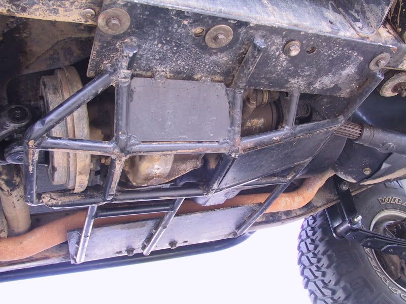

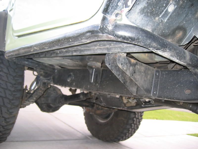

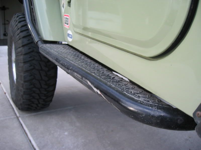

Custom sliders

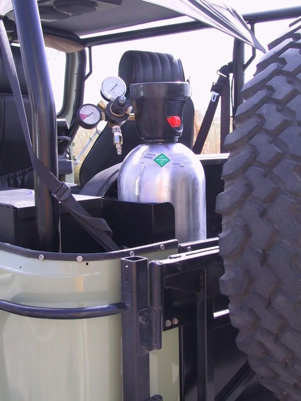

CO2 tank OBA

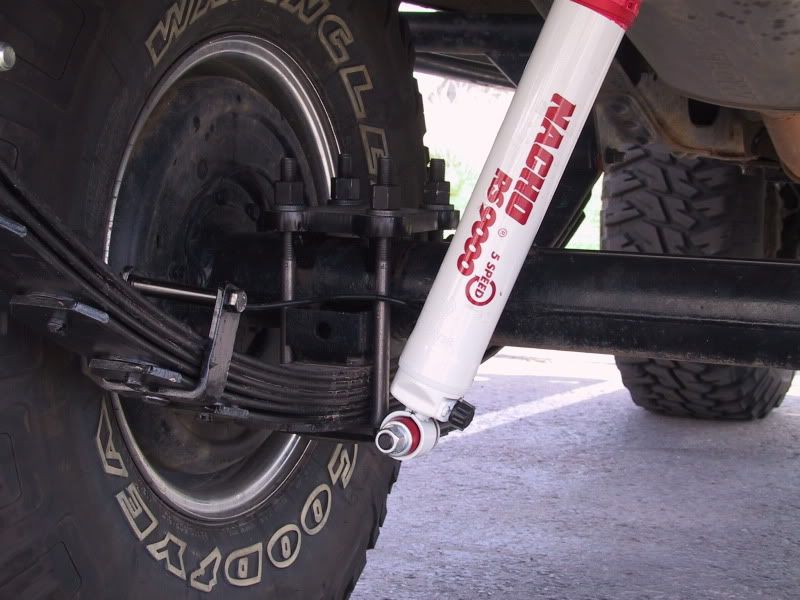

Rancho RS9000 shocks
Custom skidplate

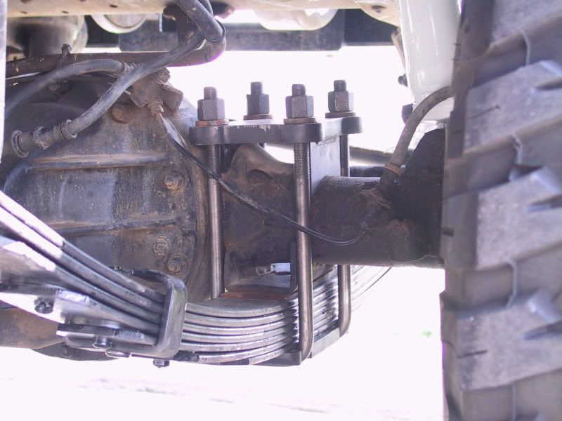

Ubolt flip kit.

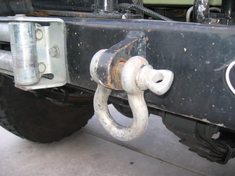

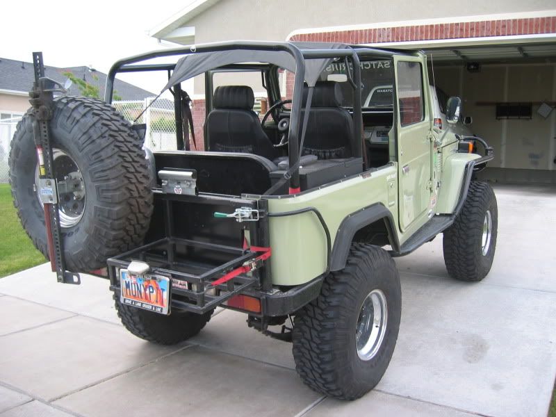

Custom rear bumper/tire carrier.

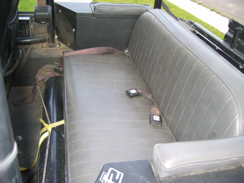

Conferr rear bench seat.

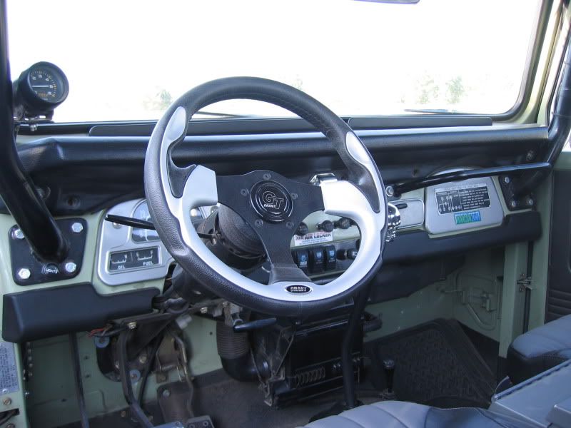

Grant steering wheel

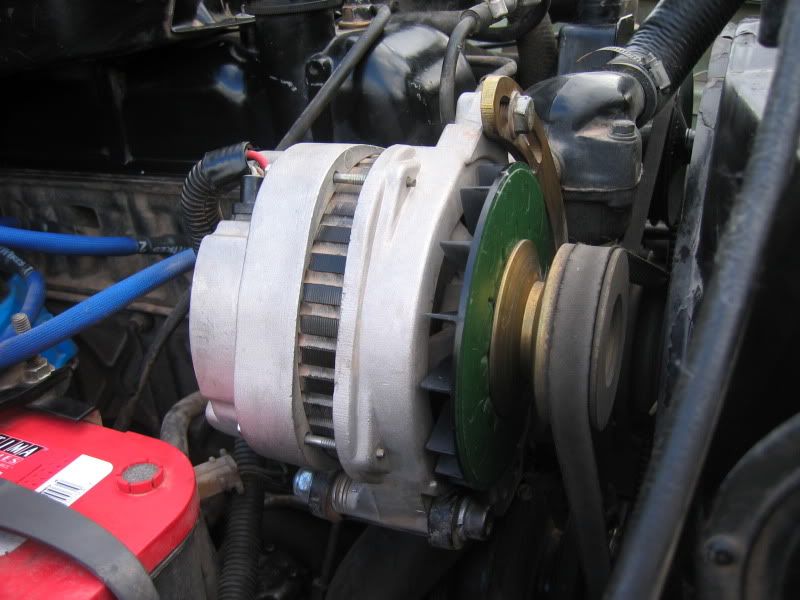

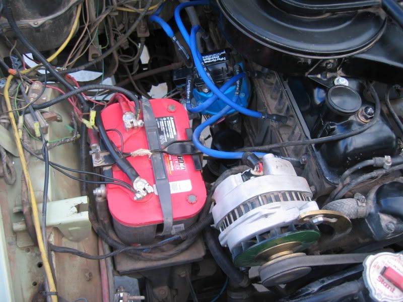

Mean Green alternator
Single Optima Redtop

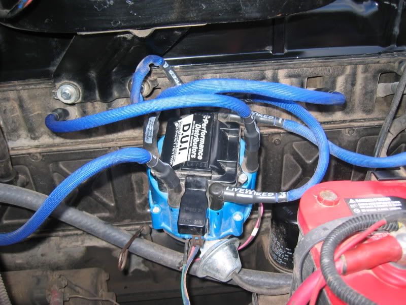

DUI dizzy and plugwires

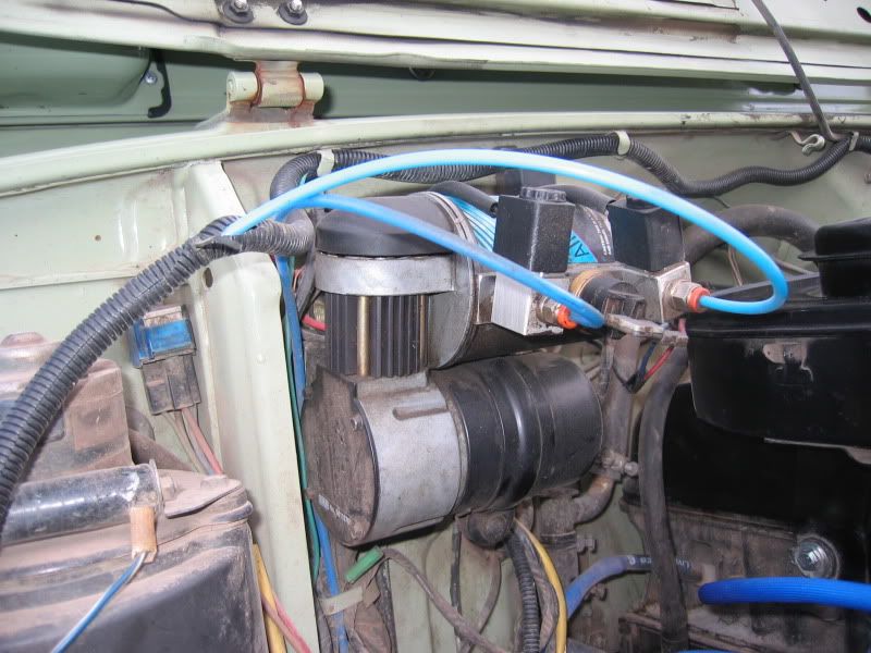

ARB compressor mounted at the firewall on passenger side.

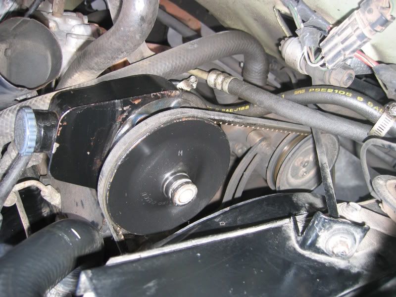

Power steering pump on custom bracket that allowed me to still run the factory smog pump for emissions
Tach mounted to rollcage

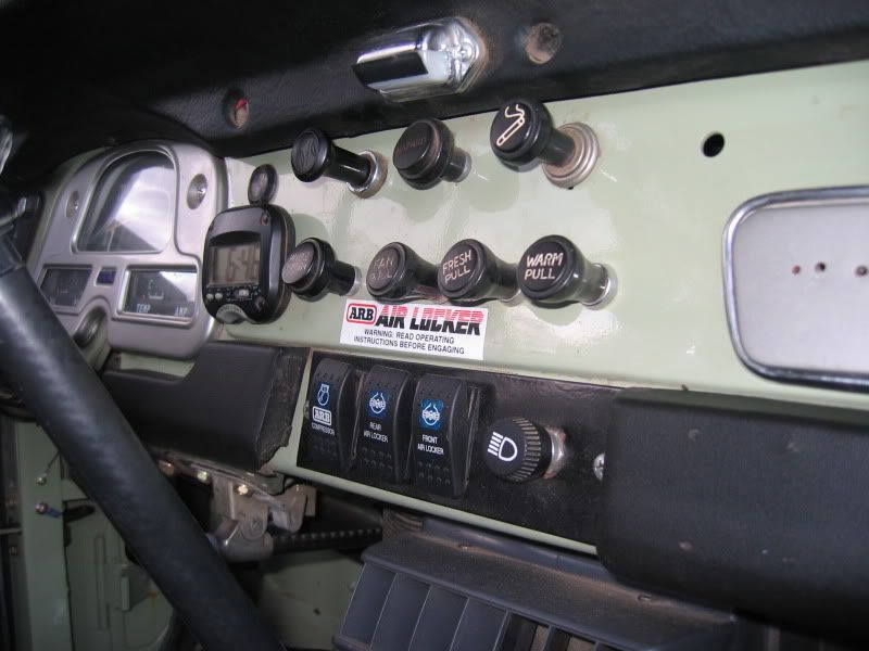

Switches for lockers and lights in the stock radio location
Grant Steering wheel
Custom covered Procar seats

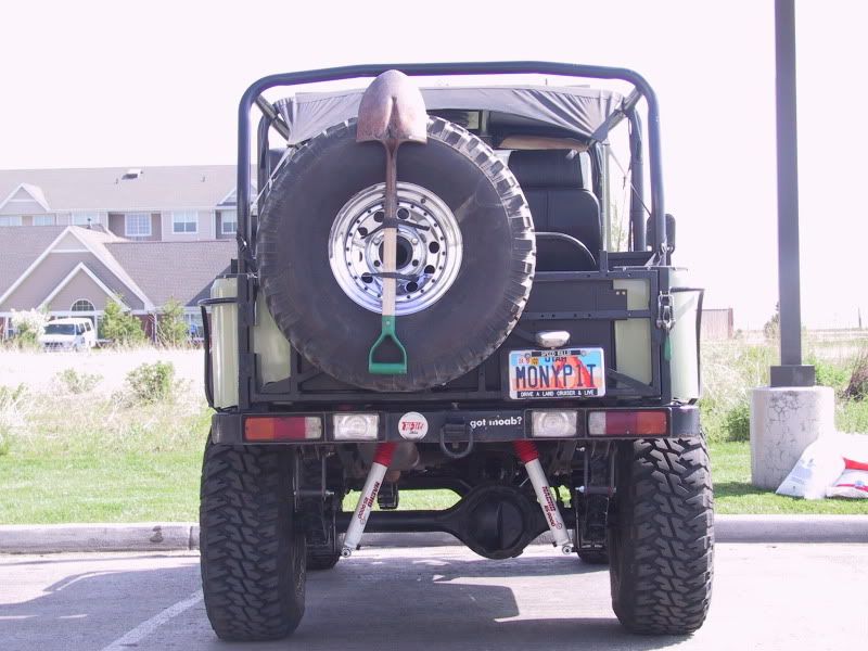

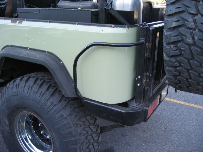

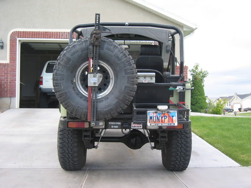

Rear bumper Phase 1 with integrated reverse lights

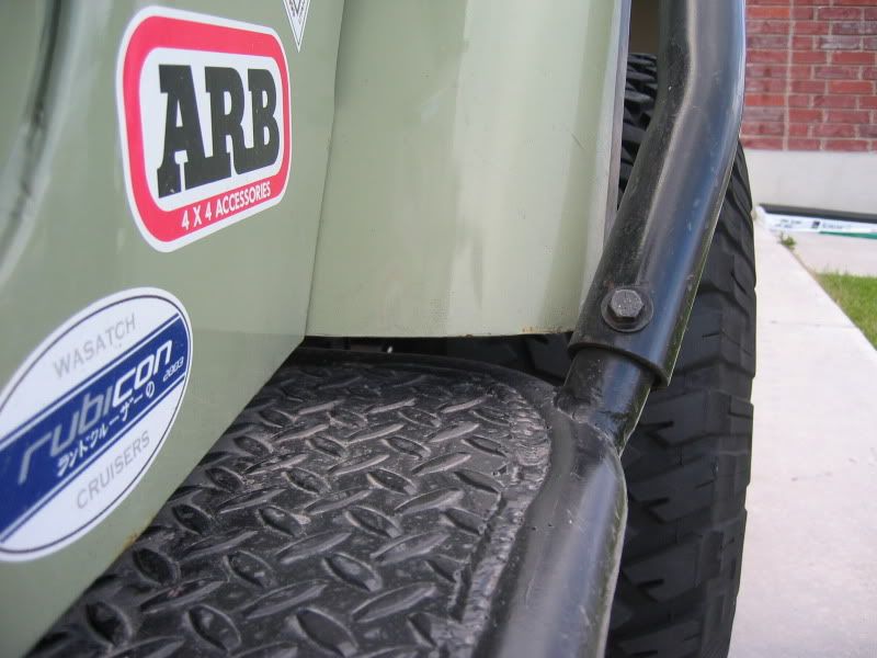

These bars were originally meant purely to support the tire carrier (solid bar stock) but they ended up being the best rear corner protection.

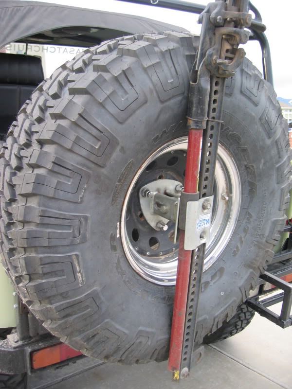

Kaymar hilift bracket (sorry pic is sideways)

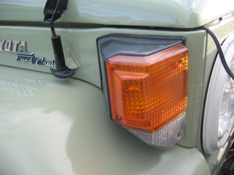

70 series turn signals

Yes I drilled the cowl to mount the mirrors.

Hey do you have any photos or can you describe how you mounted the rear seat?
The seat has a flange on each side that rests on the top of the wheel wells. There are two holes in each flange, and it's bolted through the top of the wheel wells.
