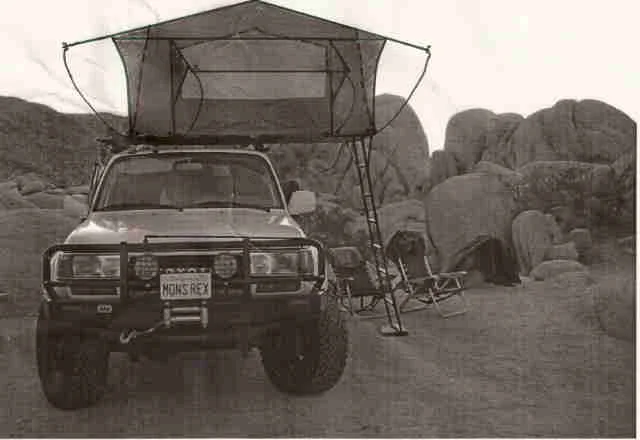

Ok, we all know by now that the rain fly on the mombasa tents are not worth much of anything. As others have stated many times over this tent is a great buy and of really good quality other than the rain fly and the ladder.
So I have decided to take on the project of making my own updated rain fly. My father in law is in the textile industry and has some really nice industrial sewing machines so I figured I would try and see if I can find any Betsy Ross is in me.
I have ordered some Poly coated Nylon Oxford samples from Seattle Fabric to determine the appropriate weight and color to go with. Once I have decided I will post up what exactly I when with. So I have taken a picture found on MUD of the Mombasa and have mocked up my first draft design. the dotted/dashed lines are that of the original tent. The rest is penciled in over the picture. I have taken my ideas from several different tents, but mostly used the Hannibal tents rainfly as my lead.
I will be making my template out of cardboard before I start cutting so that I know exactly the patterns I will need to cut for each section.
I have received a set of 8 steel spring poles for the project that will allow the rain fly to stand out on its own over the sides as well as the two large windows.
I will keep this post updated as my project comes along.

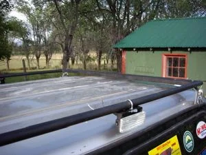

Nate what roof rack are you running? if your concerned about the hight of the tent off the roof when closed you may consider running a different rack? I welded up a simple cross bar with tube sides for my rack using the quck clamps ive had forever. I had to remove the factory rack (junk anyways) and now the tent sits just off the roof. ill prob be getting rid of the rack when the tent comes down to the trailer which is the next big project.
I'm using Yakima feet and crossbars, so it does sit pretty low, but let me know when you want to get rid of your current rack, looks slick, I could be interested.

No I'm building the fly separate from the tent. If you look at the attached image you will get the idea of what my rain fly will look like. The only exception is that my side window awnings will be part of the rainfly not part of the tent.

I agree, and have an idea on how to do that, but I'm not sure it will fold up and deploy like that yet, which is my goal, I want as little messing around as possible. With my design, there will be a few poles to quickly put up, but that will be done from the ground without any climbing on the truck.
