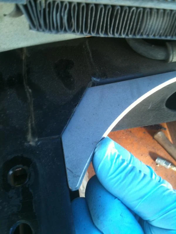

Spent a few hours detailing SR hangers, decided to add bolts to bottom frame rail. Generally not used on 60 but found they really stiffened up the attachment of SR hangers. Hopefully will add rigidity to assist welds and stop the all to common weld cracking on the SR hangers. Adjusting alignment to front cross member and frame rails. Not tough, just time consuming if you want to get it dead on. Was hoping to start welding, but work work got in the way. Weld on Saturday :) Enjoy Pics
More pics of Fridays Events
Just for clarification. The bolts will be removed after welding, at least the 4 at the flange then I will reattach the bumper bracket and do final hardware install. I think I will go ahead a get hardened washers, locks and nuts and get rid of the crush nuts. I prefer washers on both side of bolting members anyway. Also all the bolts are grade 8. I will be surprised if I get any weld stress cracking on the SR hangers this way;)
Saturday is Welding Day
Well finally got to run some beads.:clap: Attached SR the frame rails and attached various gussets to front cross member.:wrench:
