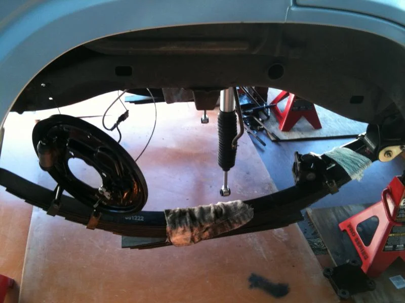

Got My Rear End Going:)
Could not spend much time today had honey do's on my priority list:) Did get some of the grungy work done though:D Got drums and shoes off and cleaned the living crap out everything. Glad I got new shoes these are almost non-existent! No leaks though:bounce: My project manager said I can have Sunday to work on the waggy:clap::wrench: Should be able to get it out and all back together so I can run it.

FF Axle Installed
Got the FF axle cleaned, detailed and painted. Installed the bare axle, got the brake backing plates installed as well as the rebuilt 4.10 3rd member with it's aussie locker. So much easier to work with diffs and axles without the need to worry about "C" clips:D I'm sorry i did not listen to you guys that run FF sooner:mad: There is more than just safety going for this axle, it's a breeze to work on and with:clap::wrench: Ordered the SST from Toyota to tighten the adjusting bearing nut and got all the brake lines reattached and cleaned the @#*t out of everything AGAIN:grinpimp: Have to travel for work next couple of days so had to push today and think it went well.:beer: When I get back have to clean and detail the hubs and start the install of all the bearings and gaskets. Hopefully can get waggy back up and running this weekend:beer::cheers:
