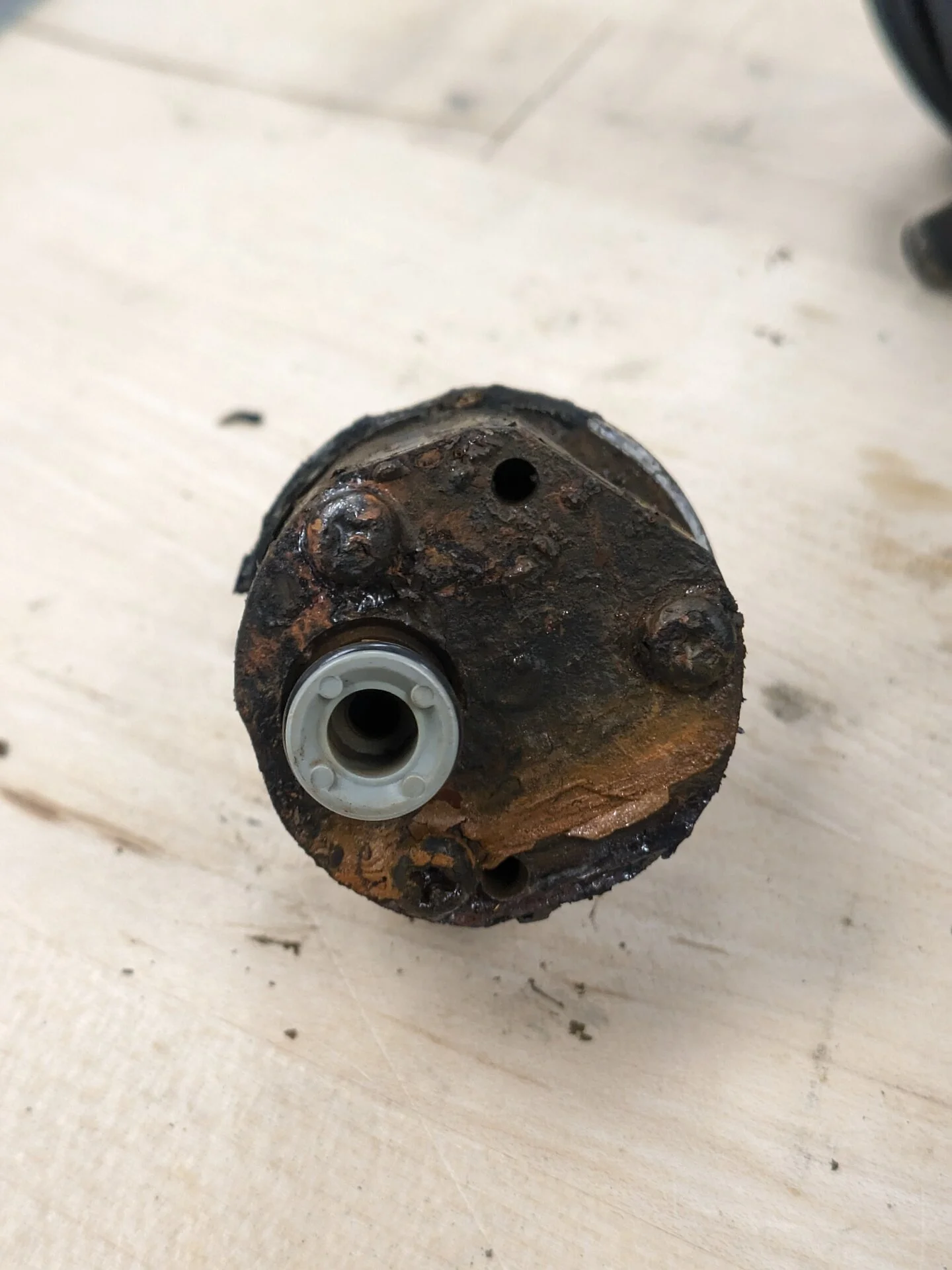

I've got a puzzler. 2013 LC200, 12g LRA tank installed, hoses routed per guide (thoroughly read through the various posts after my first charcoal canister replacement though I blamed that one on fuel overfill), only thing missing from the updated setup is the high flow filter (on order)

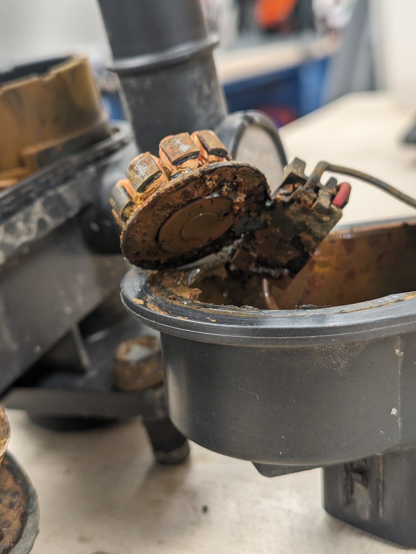

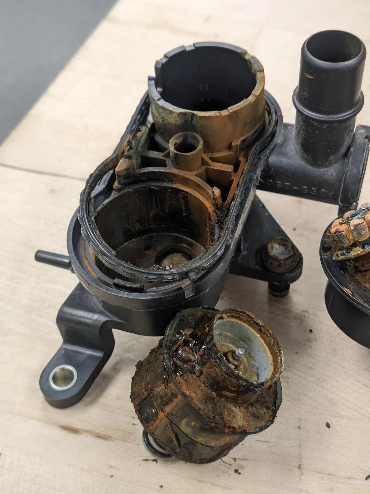

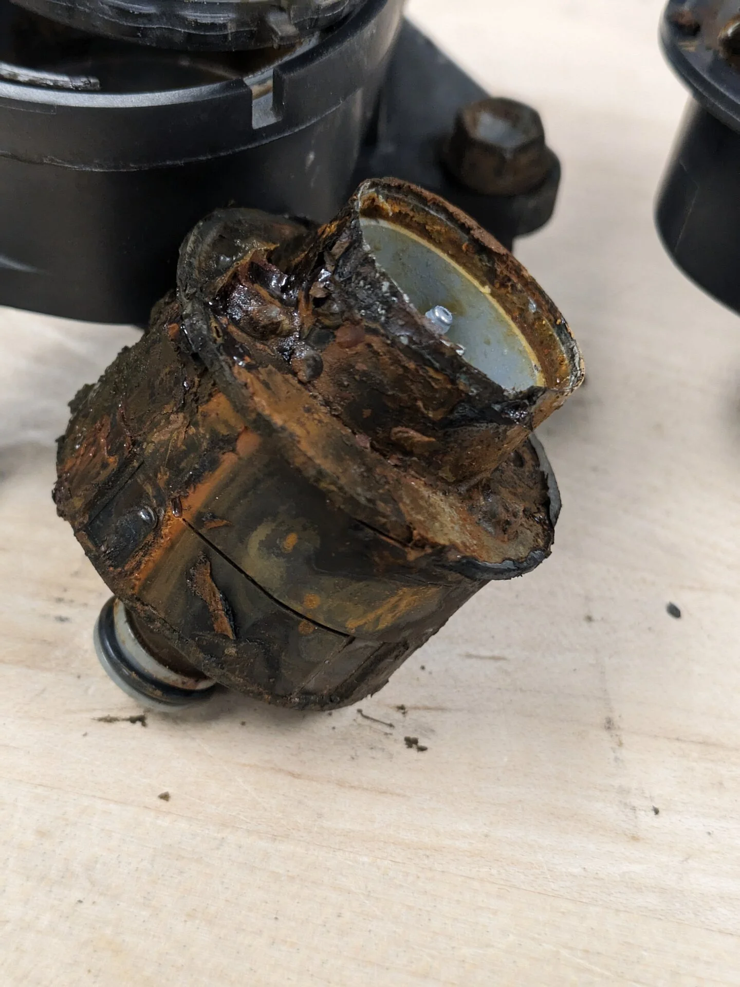

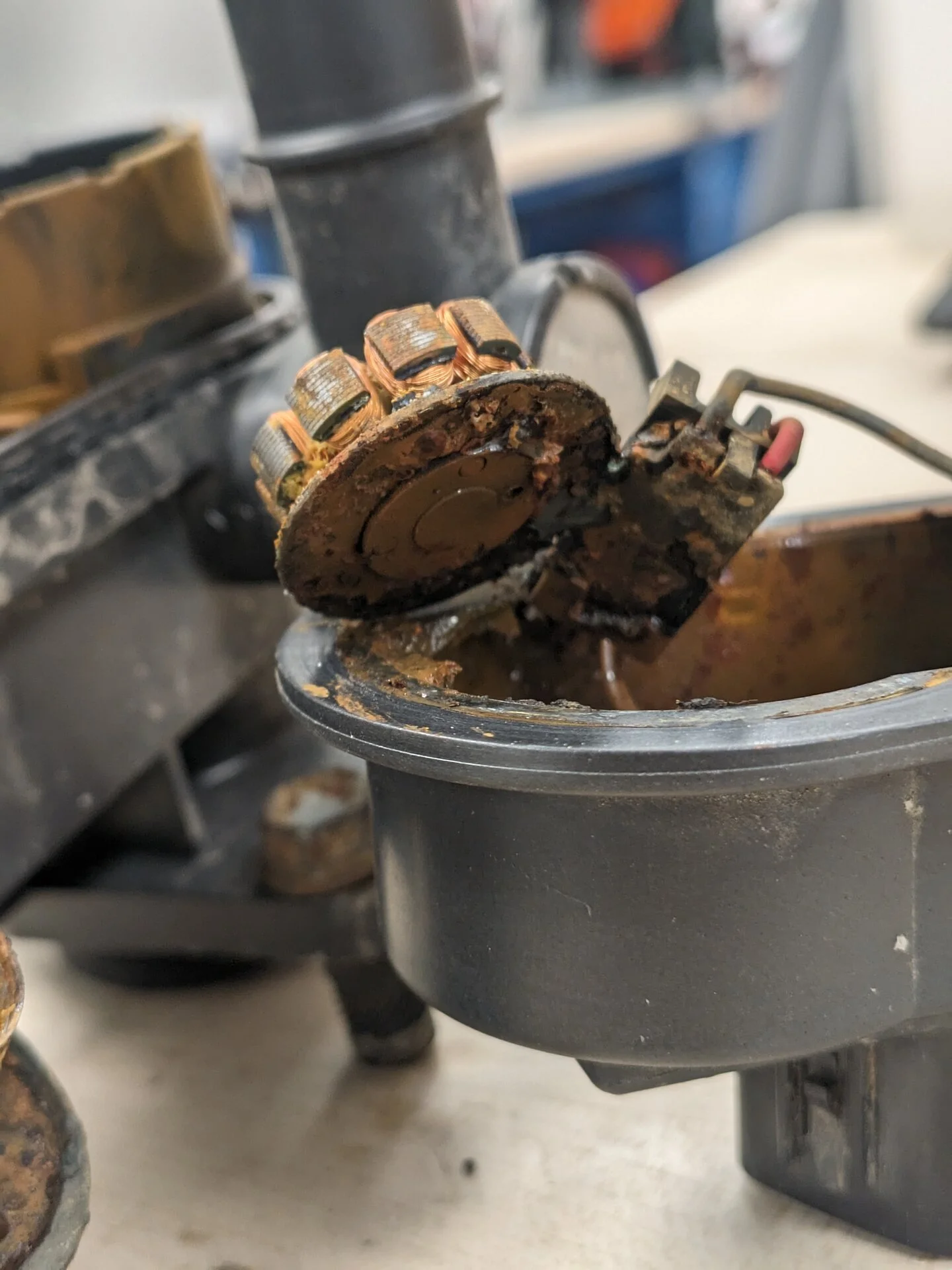

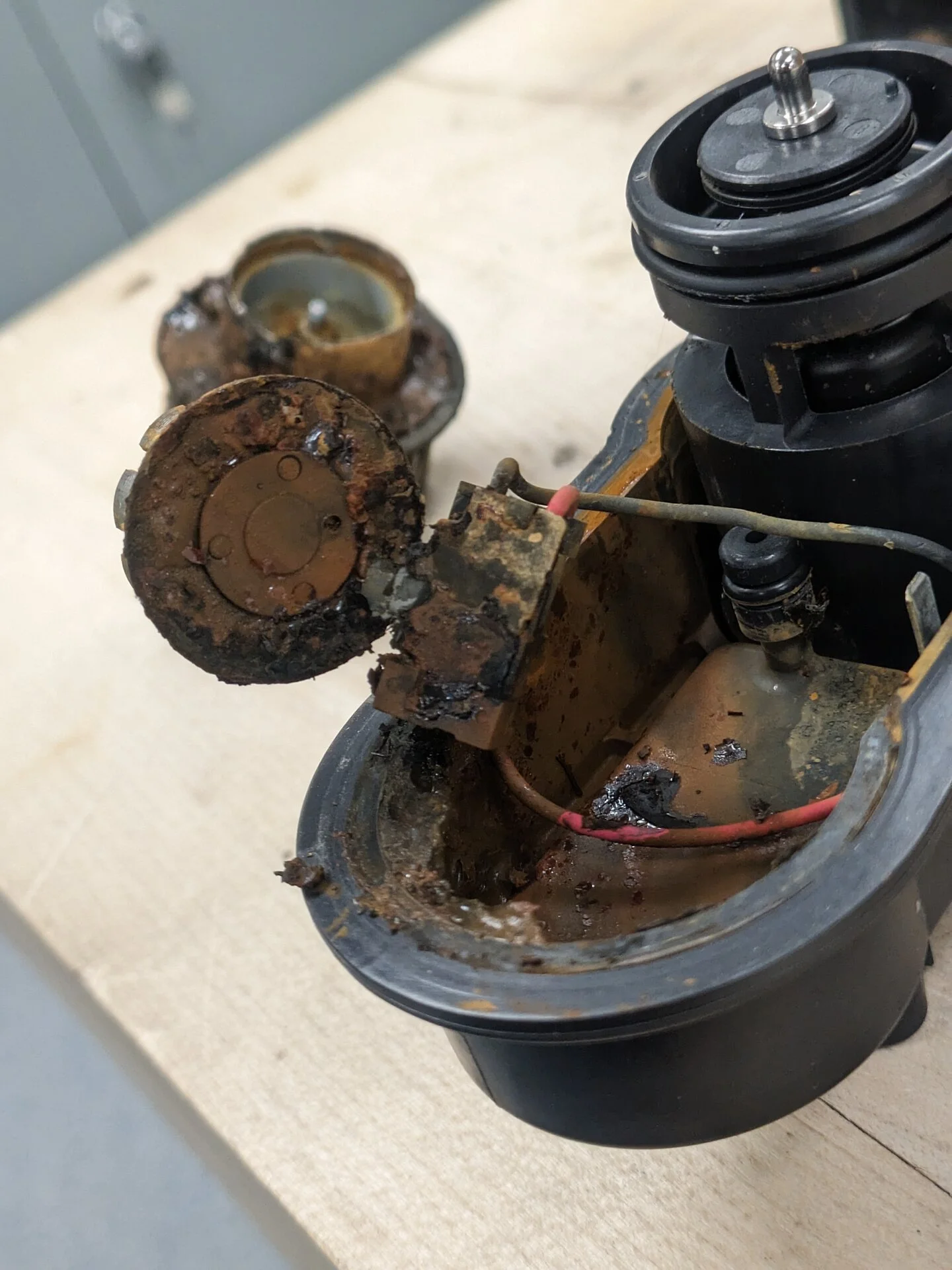

This charcoal canister is a year old, started throwing codes, pulled it to inspect, no liquid in the canister, screen from the pump to the canister looks fine besides a couple chunks but no staining from fuel saturation. Ran the techstream test to tun the pump, sounded like garbage. Bench tested the pump to see if it's low voltage or something, still sounded like garbage.
Inside the pump itself, it's disgusting.
We haven't taken the truck on any trails this year, just driving around in upstate NY. I'm struggling with how much liquid could possibly get through the filters.
We've been super careful about overfilling, I've cleaned the filter reasonably frequently (it does get absolutely disgusting), all fender liners are installed and look in decent shape.
I saw someone high looped their filter and routed the actual element a little lower, but didn't see it that was successful in the threads.... but any ideas would be welcome while I still have everything disassembled and am waiting on the new canister assembly.
Last time I change the canister I swapped the OEM filter with a new one, new lines, new everything past the canister. I unfortunately can't do this every year, it's getting pricy....
