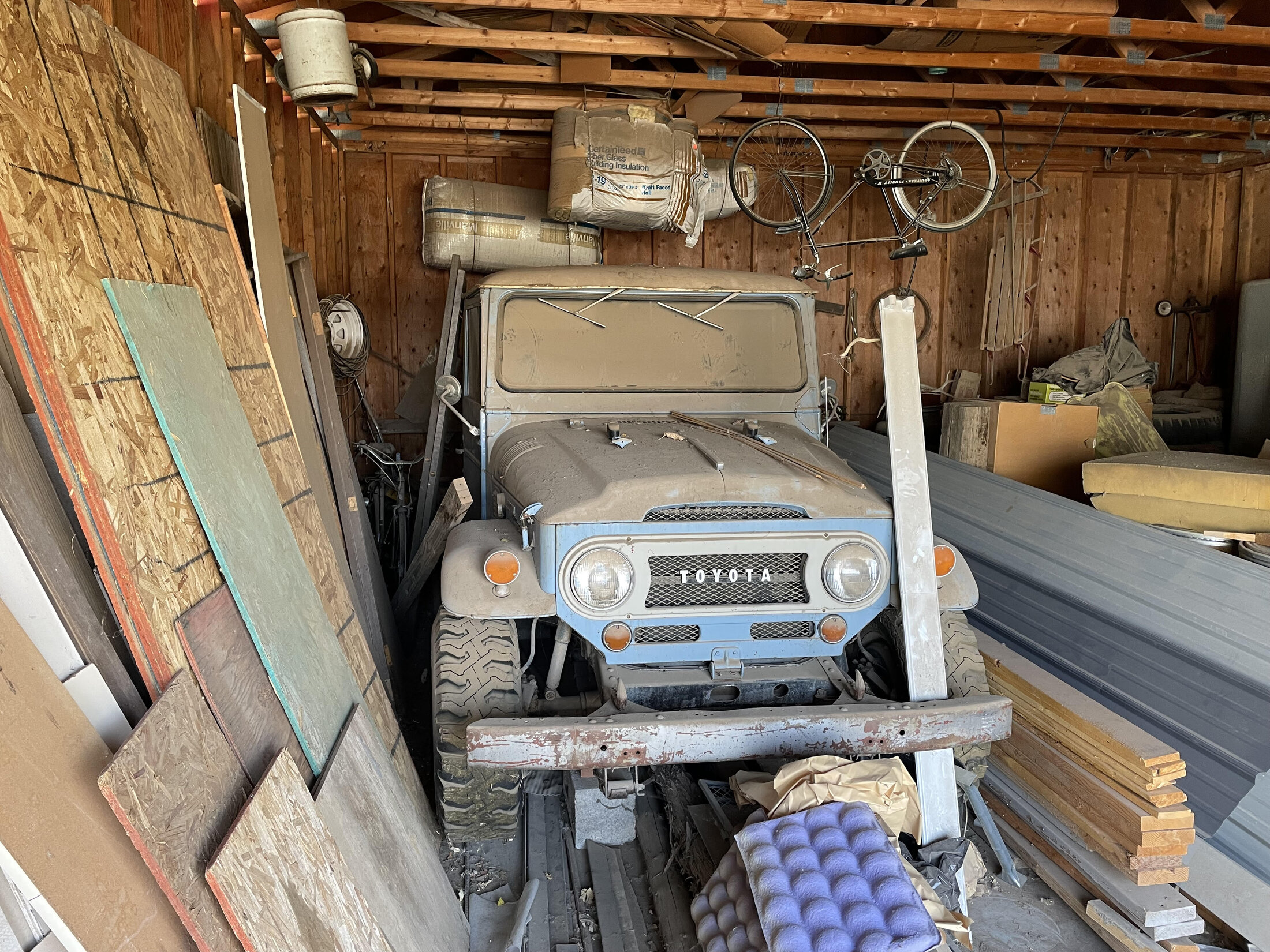

Anyway, here are some pics (@AZMoonshadow I'm in Tucson as well - let me know if you have a line on parts/service/meet-ups, etc.)

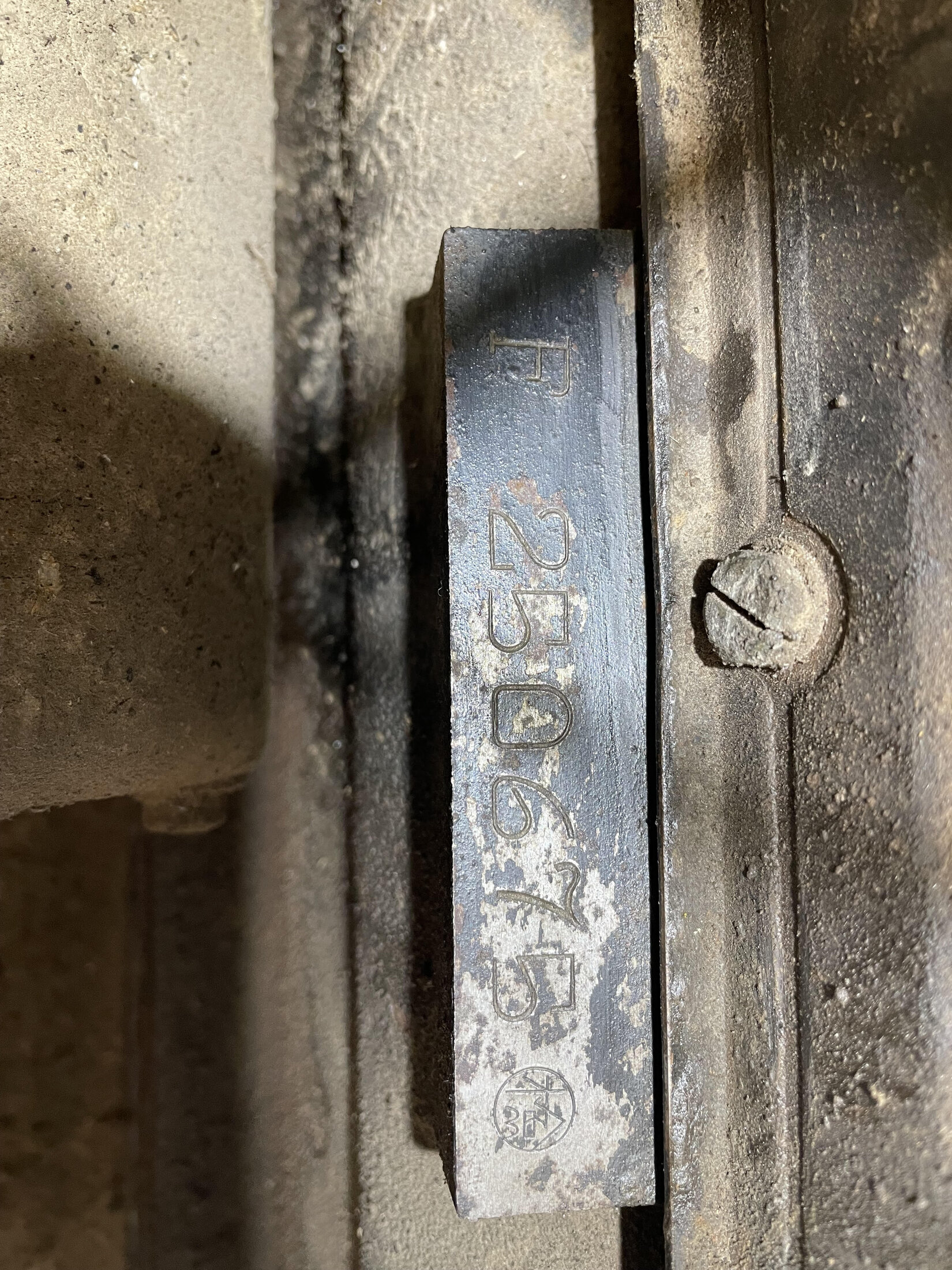

My 2 68 blocks are F 253861, casting date 12/67. This is my original engine installed now. I picked up a second 1968 engine in 2018, F 250851, casting date 11/67. Yours is even earlier, so January 1968 is probably the correct build month.
Your block casting date is located on the drivers side of the block, near the front freeze plug. There will be 5 digits, first is the year, next two the month and last two are the day. The picture is the 253861 block. This was a February 68 build with the engine cast in December 1967.
What I’ve found, on and off discussions on Mud, and with other early FJ40 owners, original engines were generally cast several months before they assembled the truck. Engines without a serial number are replacement blocks with just an F or 2F stamp.
