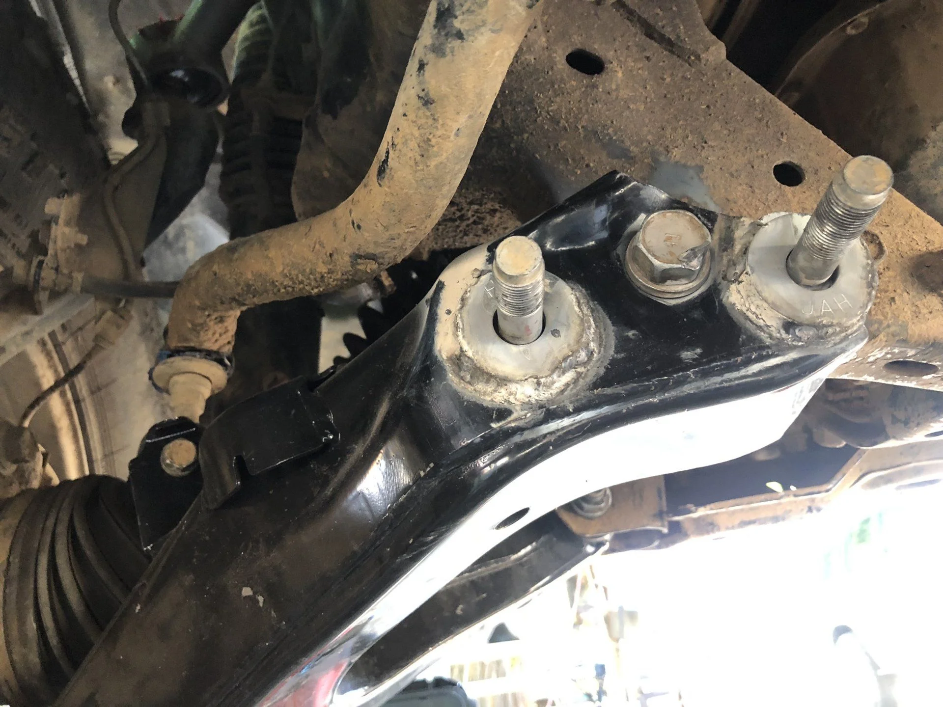

You do need to remove the torsion bars to install. It's a ~1 hr job here in our shop fwiw.
That's exactly what I wanted to know! Less cleaning involved then.
Thank you for that info!
I was able to loosen the torsion bar, unbolt the bracket on the lower arm and just move it aside. I didn't have to completely pull the bar out, or take off the front bracket. So it all just bolted back up easily and then I tightened the adjuster back to the dirty thread spot. If you look at the bolt, you can see where it was tightened up to by the clean threads. That will be very close at least.

...There are other A-arm solutions on the market, but these act as a cradle to catch the arm once broken, as opposed to strengthen it in the first place. "
Just caught this line in the article posted above. Would this be referring to the brackets we're talking about here? Or are these brackets (mine are Tough Dog brand, for example) actually reinforcing the arm?
I'm glad I got the reinforced bracket when I did my lift. At first, I was skeptical because it does not seem like a lot of people installed on their rig. But the sales guy at MetalTech strongly recommended, I'm glad I listen to him, cause I wheel my rig fairly often.

Maybe I should actually remove my welded/repaired arm and reinforce my arms since I started this thread? o_O Definition of the Village Idiot!
I’m still on mine too haha. Fixed with fender washers.
I think it’s worth discussing that Kelly and I BOTH had this failure on MOOG arms, so.....don’t buy them. This is a common failure point on Aussie IFS 100s as well even on stock arms. Buy the brackets.
Have this kit, did not want to drill into my control arms. They just sit in the garage.....but hmm, this thread is convincing me little by little.
