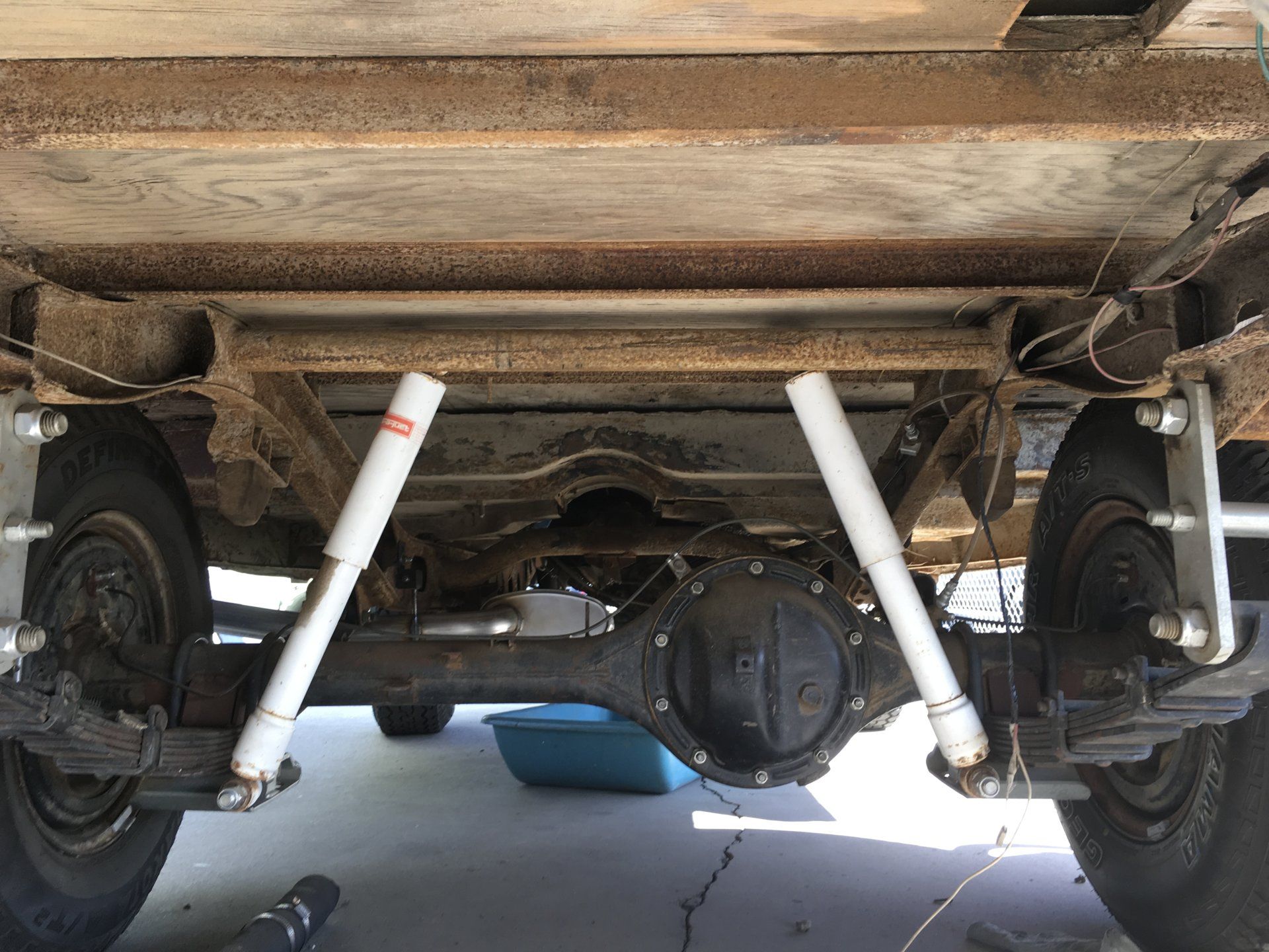

Today the real fun started. I dropped the interior tank from under the bed (yes, I said INTERIOR) and found a second rats nest where the filler neck ran up inside the interior...along with a rat’s nest of quick and dirty wiring.
Cut the puny 1/4x20 hardware that held the mounting straps to the floor and tidied up the wiring.
Just the two wires for the sender hanging down now, waiting to be attached to the replacement tank. The plan is to splice two stock senders together to get the range of motion to read the depth of the fuel cell, thereby retaining the stock guage, which was working, kind of sort of.

Can I ask what you were using the stapler for under the truck?
Sure. The entire underbelly of the motorhome is plywood. The stapler is an old-fashioned telephone cord stapler. I used it to tack her aftermarket wires out of the way while I'm installing the auxiliary tank. Then we will discuss how and where the wires will be run for final install.
That makes sense. I have one of those staplers for the range. I’ve never heard of a stapler being used to work on a truck before! :)
