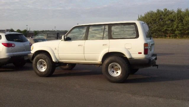

Here's a quick cell phone pic...
Thats awesome SH, looks ready to go play on the old comp course out a Rausch.

Mileage with the 37's was 20.5-21.5 with the stock turbo. Since installing the 20G, I've gotten 18.8 and 19.8. Admittedly, I'm flooring it a whole lot more... the truck really moves under boost, I'm hoping to get a video this weekend.

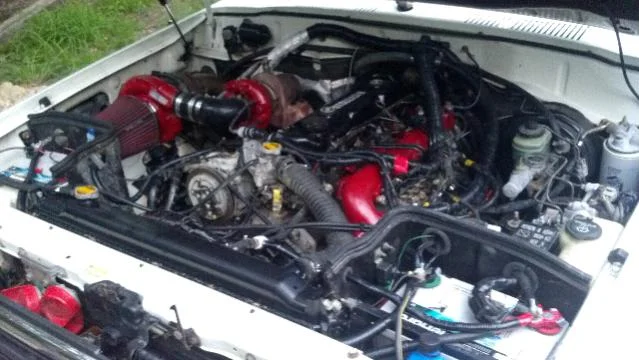

My buddy gave me a Holset HX35,so I decided to go compound. This is what I expected from a turbo upgrade!! Boost is up to 30-35lbs, egts are way down, and that Holset sound is just music to my ears.

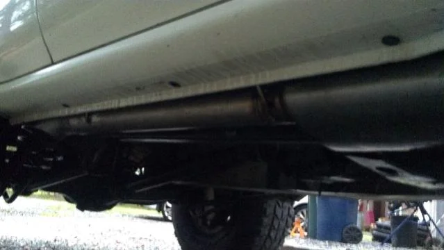

My daughter decided to help with the upgrade. I put a short side dump 3.5" exhaust on at the same time. Amazingly, it's quieter than before! I guess I can thank the second turbo for that :)

BTW, I followed Dougal's "Boost Compensator Mod" thread over on 4BTswaps and WOW did that wake this motor up. Might do a little more tweaking, but adding off-boost fuel made a world of difference and greatly decreased my spool times.

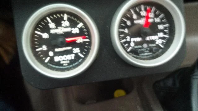

Nice gauge choice. I have the same (but metric pyro) to go in my work car. It's not easy finding a boost gauge that reads over 30.

Nice work on those twins, looks clean under there. I really like the power an HX35 delivers on a 4BT above 2000 RPM. I'd guess your small twin setup brings the below 2000 range back into check very well? Assuming I can compare Cummins to Fuso power.

Thank you, I really like the new "II" series of the autometer lines... The led backlit feature is great and easy to read.
