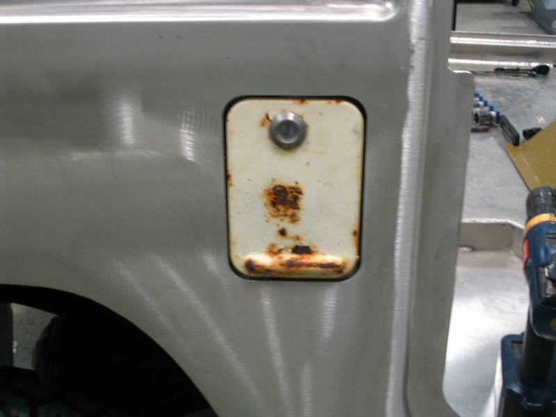

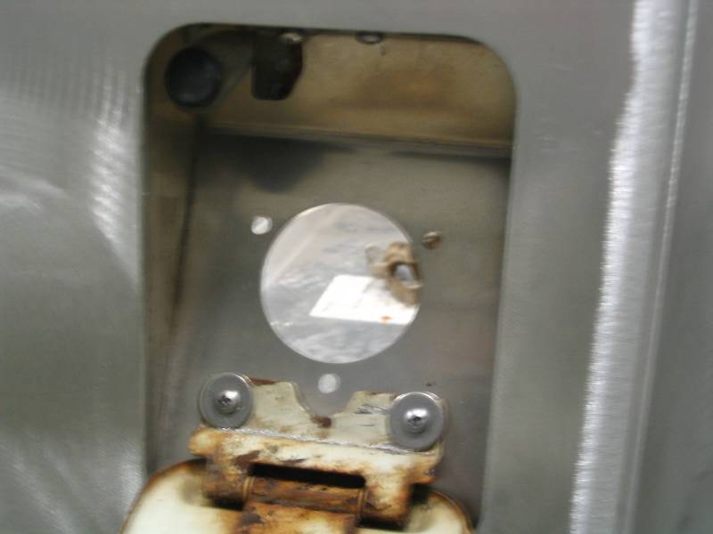

gas door... works great... have to put 2 washer under each side for it to have clearence to work...

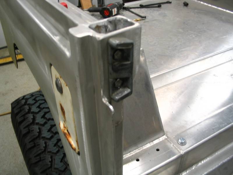

Doors took a while to get right... (or good enought) the lines I think are different than the stock tub... seems to be a bigger gap in the back.. not sure why they made it that way but it seems like that is how both doors fit... I had to loosen up the hinges from the inside and we had to pound them up.. think they moved maybe a 1/4 inch or so... would like to get the drivers side still up 1/8 to 1/16 or so.. but it is really close...
door latches... those holes are not pre drilled as all the body ones... which was nice, you can put them where they need to be...

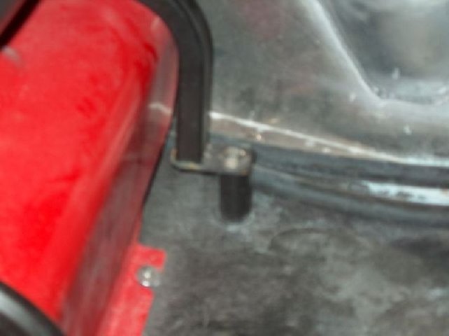

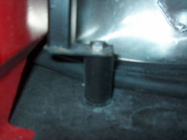

ok here is where I need some help.... I dont remember how the front seat got back in..... can you look at the pics and if anyone can post up a few pic of what I am missing...
mainly I am confused on the passenger side. Am I missing a bracket here??? or does this go a different way......... The bracket closest to the tranny cover does not go to the floor?? :confused:

You are not missing a bracket. This is another feature of the aluminum tub; the original steel tub had a raised section where that seat bracket attached and the aluminum tub is flat in that spot. It does not have the correct floor by the tunnel so that the seat frame support can attach to it. You will need to make a spacer to take up the difference.

Here are a couple pics of the extension for the seat bracket. Is really hokey, I will be extending the original bracket. I love how the tub turned out is such a nice product but why skimp on the seat bracket. I understand what you went through with the sealent. Had it on my hands and everything else for weeks. Good luck man and nice build, Dan.seat bracket.webp

Just wanted to make clear that the extension I showed is what is sent out from cruiser solutions with the aluminum tub. Dan.
now that you say it!!!!!!!! there is one of those that came with the kit!!!!
