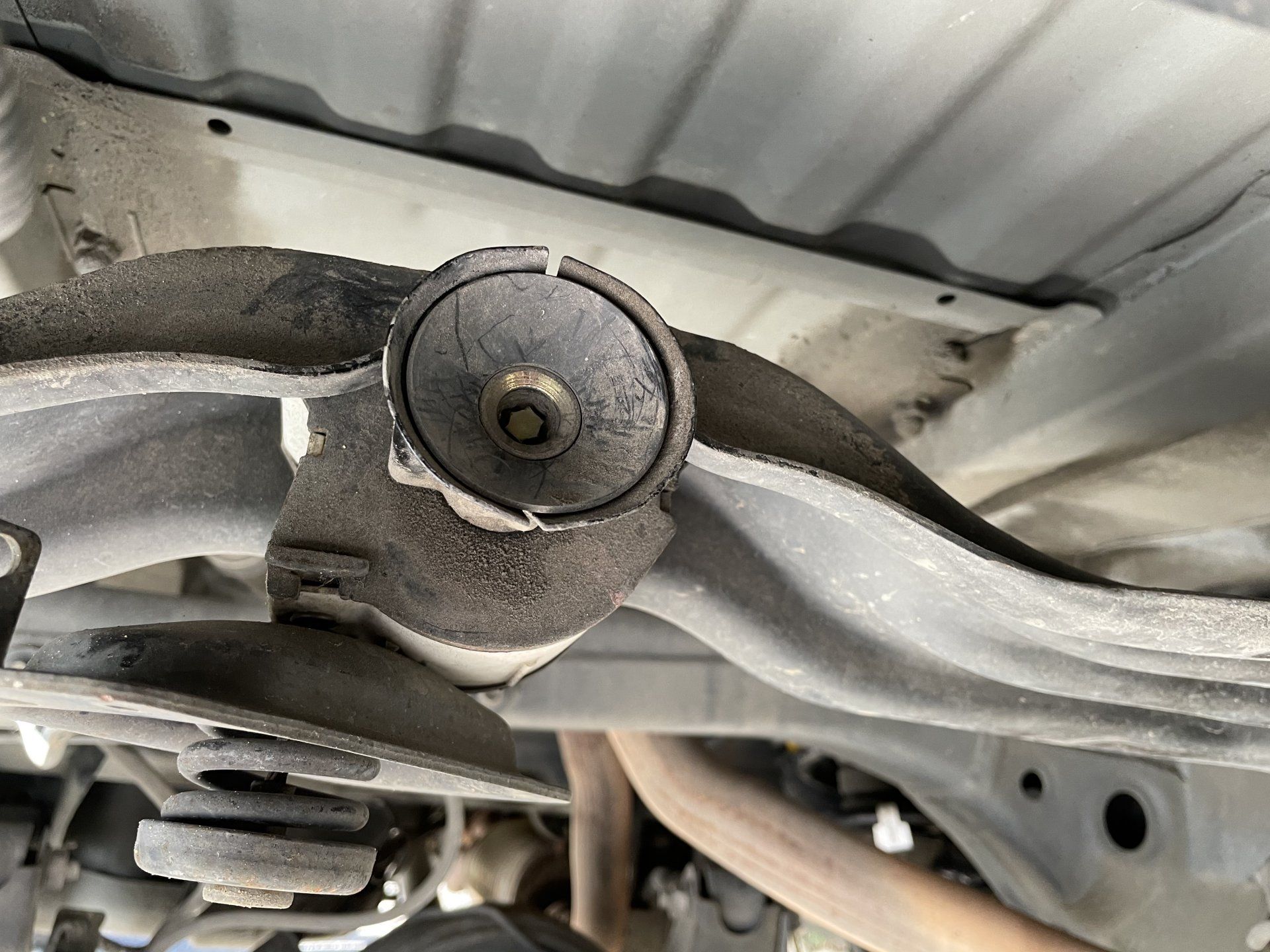

I recently purchased a Series 100 and discovered its missing the emergency toolkit. Most importantly the toolkit contains the crank to lower the spare tire. Does anyone know where I could get one?
It appears the crank is keyed to the fitting and so a simple wrench or screw driver can't be used to lower the tire. I've attached a snapshot of the crank receiver.

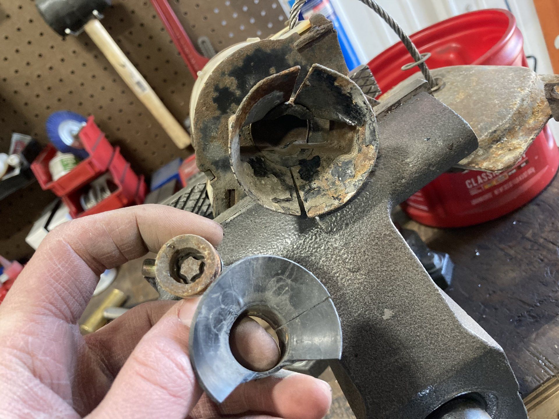

Or remove the lock as I and others did. This thread will help if that’s the route you go... No lock nut key for spare? No problem

Just remove the anti-theft key from the winch. Then you can use the 'hook' on the Jack/Let-Down tool to lower the spare tire when needed.
The anti-theft feature is a joke. Any decent thief will cut the winch cable and be gone with your wheel/tire is under a minute (IF THEY ARE SLOW), so why make it difficult on yourself. Lots of threads on how to 'revert' the winch back to the same simple/reliable one used before.

That key part just pulls out, bet it would strip first time trying to use it if you had the key, has no leverage compared to the regular jack tool.
