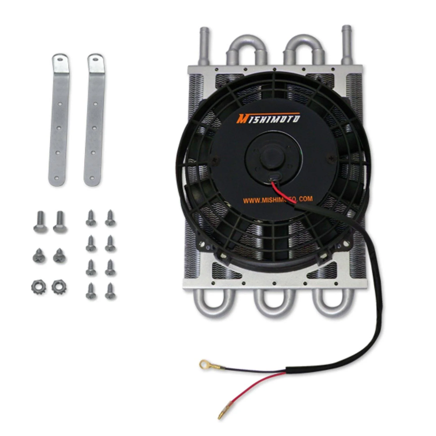

I can't find where anybody has tried this cooler. Given the Arizona climate, I'm thinking that a fan cooler is a good way to go.
Anybody tried this one? Thoughts?
Behind that fan is a regular ole tube fin cooler. They're not as efficient as a stacked plate cooler. If you got a nice stacked plate cooler, you wouldn't need that fan.
A fan would need to be thermostatically controlled. Otherwise it would cool it too much.

Thanks guys. I see that the B&M 70268 is the stacked plate type.

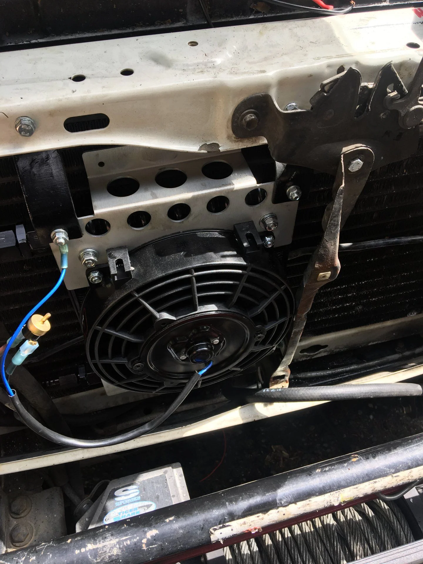

Haha, here’s my two cents. Keep in mind I’m in AZ and I needed to keep the trans cool when it was 118 out. I had a 70268 on my old 4Runner and it worked well. So I put one on my 62. With it inline with the factory cooler, I routinely saw trans temps around town of 260+. The temp sensor was on the outflow trans line going to the radiator. Pan temps were 220-230ish. So I installed the Derale tube fin style with fan. The fan was wired in to the rear heater switch so I could turn it off going thru rivers and such. After installing it, my temps dropped by 30+ degrees, and I generally saw pan temps of no higher than 190 using an infrared heat gun.
I like the temp sensor on the outflow line for one reason- I like to know how hot the converter is getting. Using the infrared heat gun on the pan to know that the trans had a steady supply of much cooler useable fluid was a bonus. So in my case, the “lousy tube fin style” cooler and fan was a drastic improvement over the 70268.

I think I have a slam dunk solution that covers all bases. I'll install the B&M 70268...and install an 8" fan on it. I've got the room physically and electrically.

I installed the B&M 70297 with a fan behind the grill....
I have it wired with a manual switch....
This past year I swith to -6AN fittings on all the tranny lines...
EDIT: Yikes !!! just notice the price on these...
I paid 180.00 back in 2010...
I used a plate style Derale Atomic cooler from Summit Racing with a fan and 180 degree thermostat. Seems to work well. I never monitored temps prior to it's installation so unfortunately I don't have before and after numbers but it does keep things under control when pushing my heavy '62 as hard as it will go.
