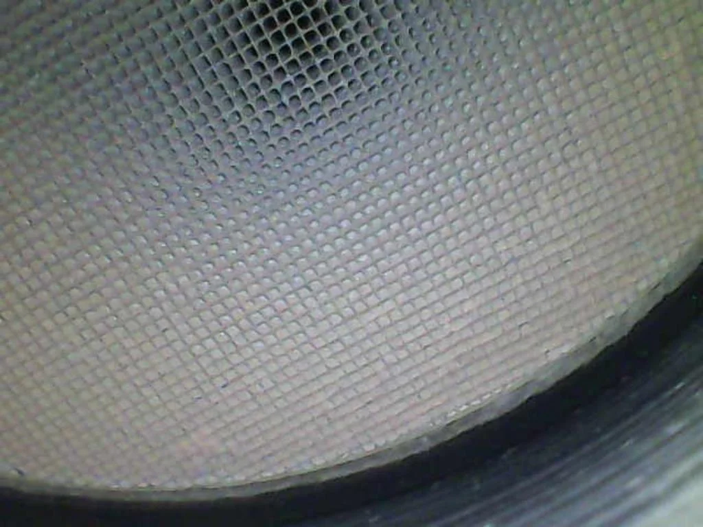

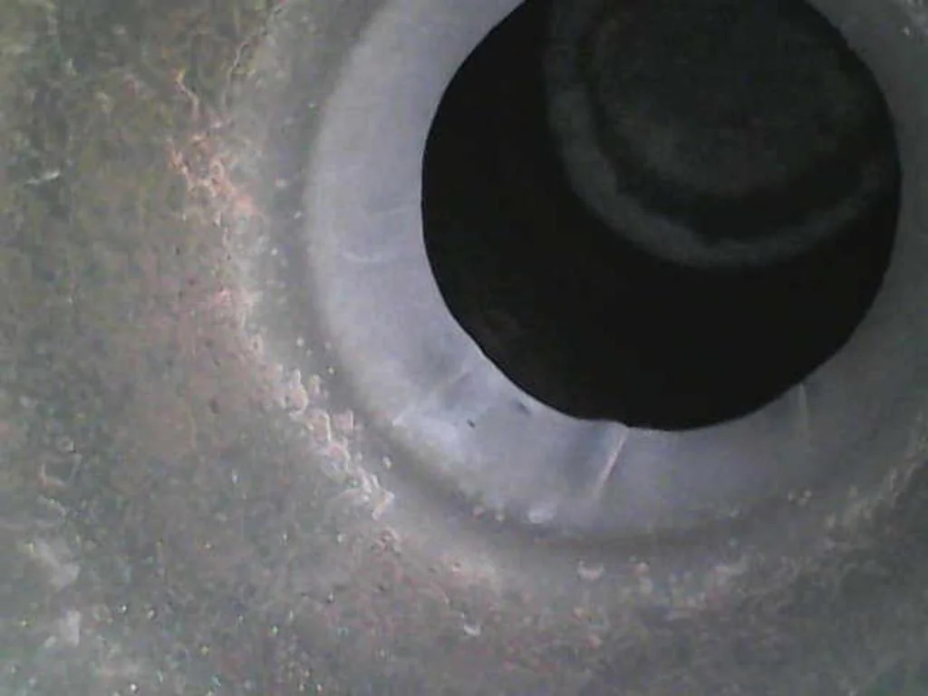

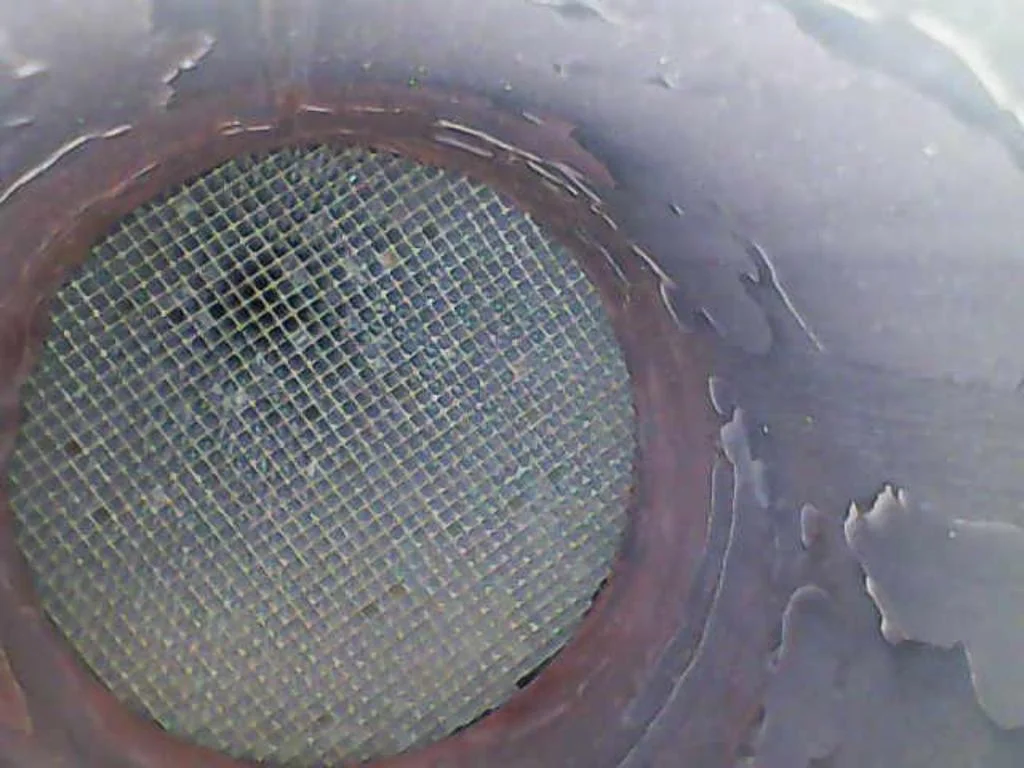

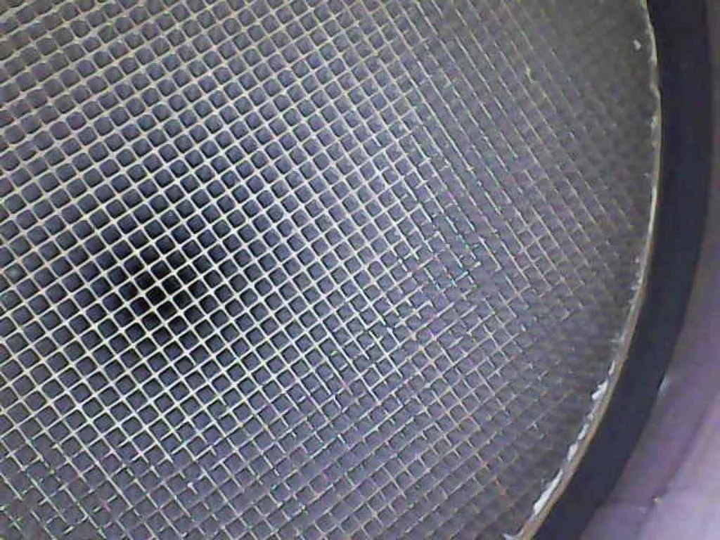

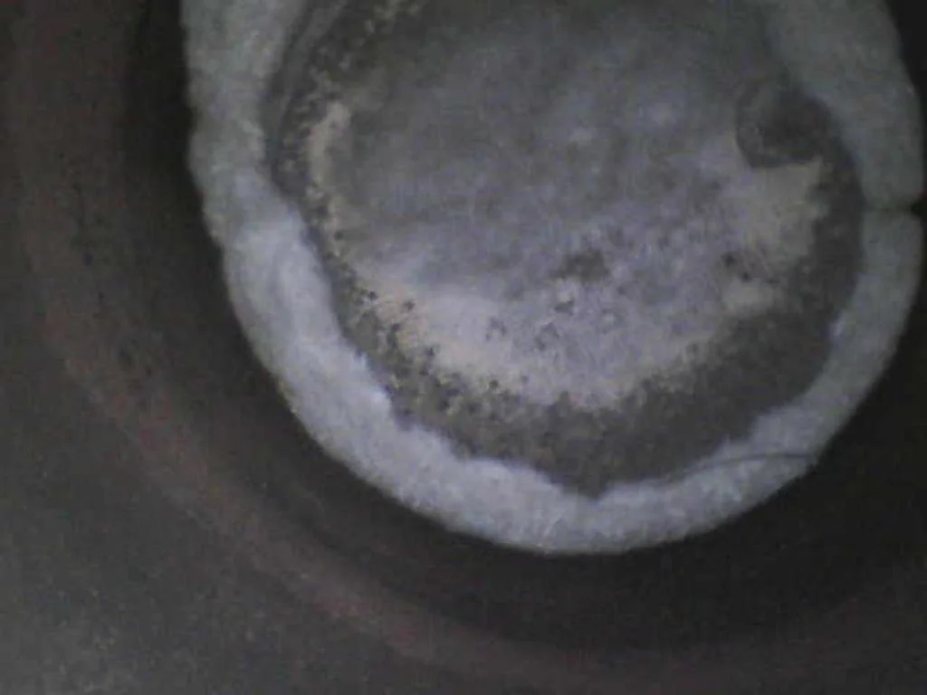

I have just done a heap of work on an 05 UZJ100 4.7lt. Water pump , Timing Belt Kit, Crank Angle Sensor, Heads machined & valve seats recut. Motor purrs like a kitten until you drive it. Just touching the throttle it is fine, but as soon as you add any acceleration, the thing bogs down & won't rev at all. If you persist, the revs start to increase & the motor rattles like it's about to jump out. It appeared to me to be a built up of exhaust gas causing back pressure. So I pulled the Catalytic Converters off. Without them, the motor revved freely in the driveway, but a little too noisy to drive around. With the aid of an endoscope I could see that the first Cat was definitely very dirty & needed cleaning, however the second one had the initial screen missing completely & the system completely blocked off. Interestingly that side was showing cylinder misfires for that whole bank 1, 3, 5, 7. Waiting for new Headers & Cats & hope that fixes the problem.
If noting else shows up, this could be worth your checking as well
