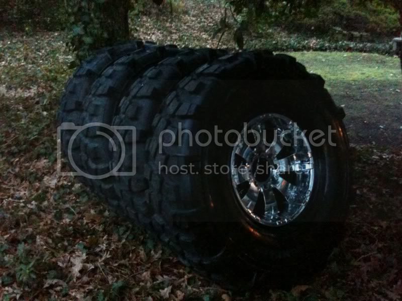

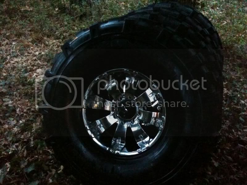

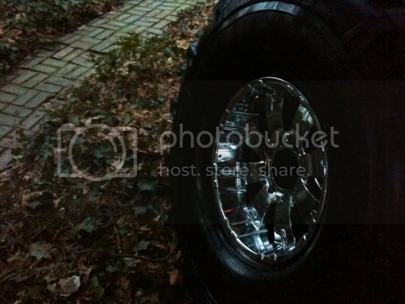

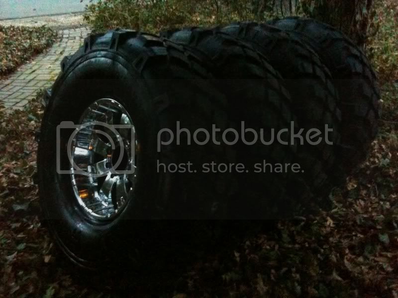

Glad we were able to get those on for you Josh.... took some major muscle though :grinpimp:
Yeah, Thanks again to all you guys, you have no idea ... These things look pretty niiice ... The truck is under the knife now. I've been working all week on it, and should be done tomorrow ...
