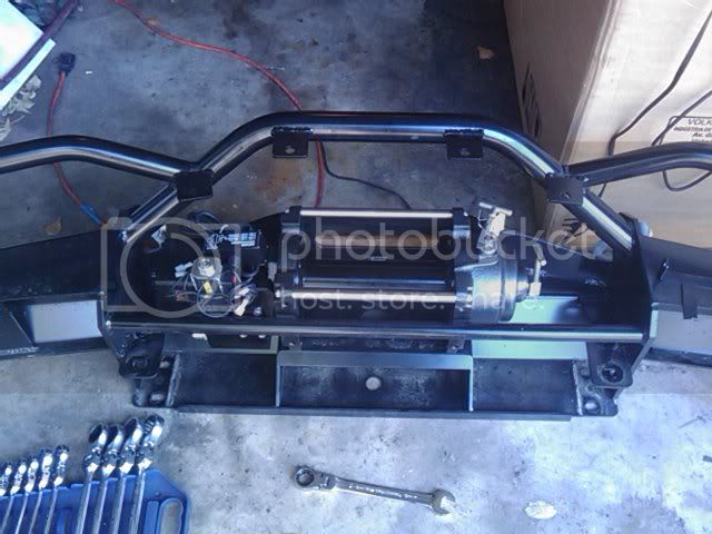

I just noticed that my Slee Shortbus is a little different than the OP has. Towards the back of the winch I have a horizontal bar running across the top edge of the vertical plates... Hopefully I won't have clearance issues as it looks like it might clear.
It seems that I have a newer redesigned Slee Shortbus bumper, good news is that the HI12000 still fits! I did have to rotate a solenoid and "notch" my valence for solenoid clearance... I still have to route the hydraulic lines, a bit of an issue since I used the crossmember holes for a power steering cooler. So will have to figure something out.
That looks like a good addition by Slee and I'm glad to see the winch still fits for you!
Keep us updated on the progress! :cheers:
I ended up clocking the gear box ....Everything fit fine but it was close.
I followed Lantank's lead and did the same (2nd image in the first post). However, I had to install spacers under the feet of the winch to allow clearance for the solenoid pack.
On the bright side, if the solenoids die, they will be easier to get to in the position you have them in (top) as opposed to mine (bottom).
