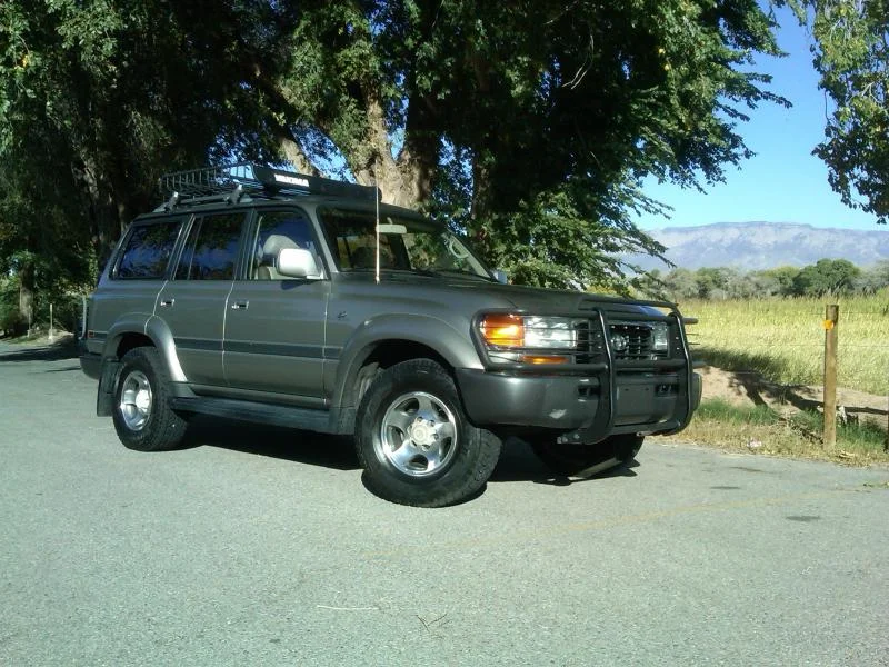

Here is my FZJ80 three weeks ago (the proverbial "before" picture):

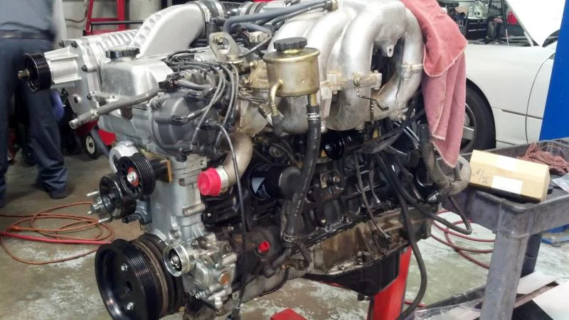

The engine is coming together nicely. There is some serious OEM bling on this reman long block (not OEM source).
Including a nice supercharger. Look forward to the days of 91 octane fill-ups only.
Hopefully going to drop the engine in on Friday. Doing a nice PHH bypass too while the engine is out.

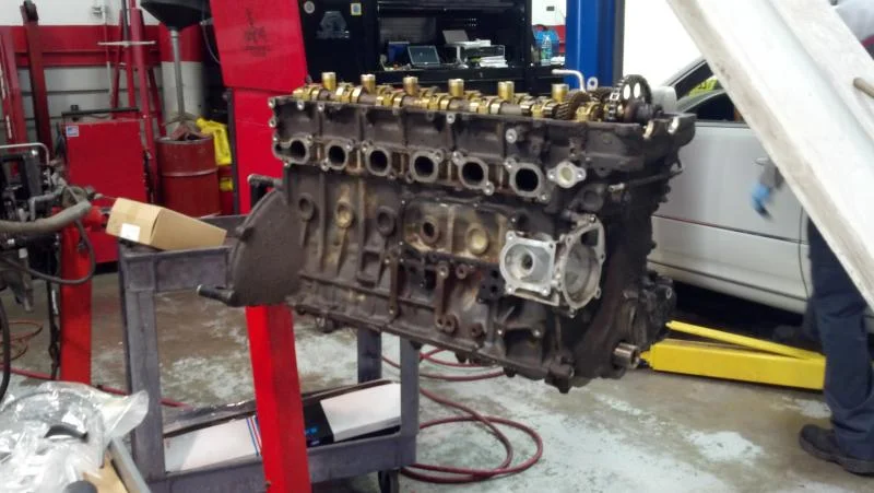

Old on the way out....new (reman) on the way in.....
