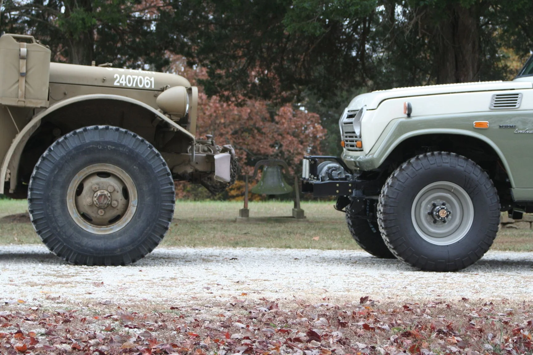

In my view the 9.00R16 are a bit too big on a J4

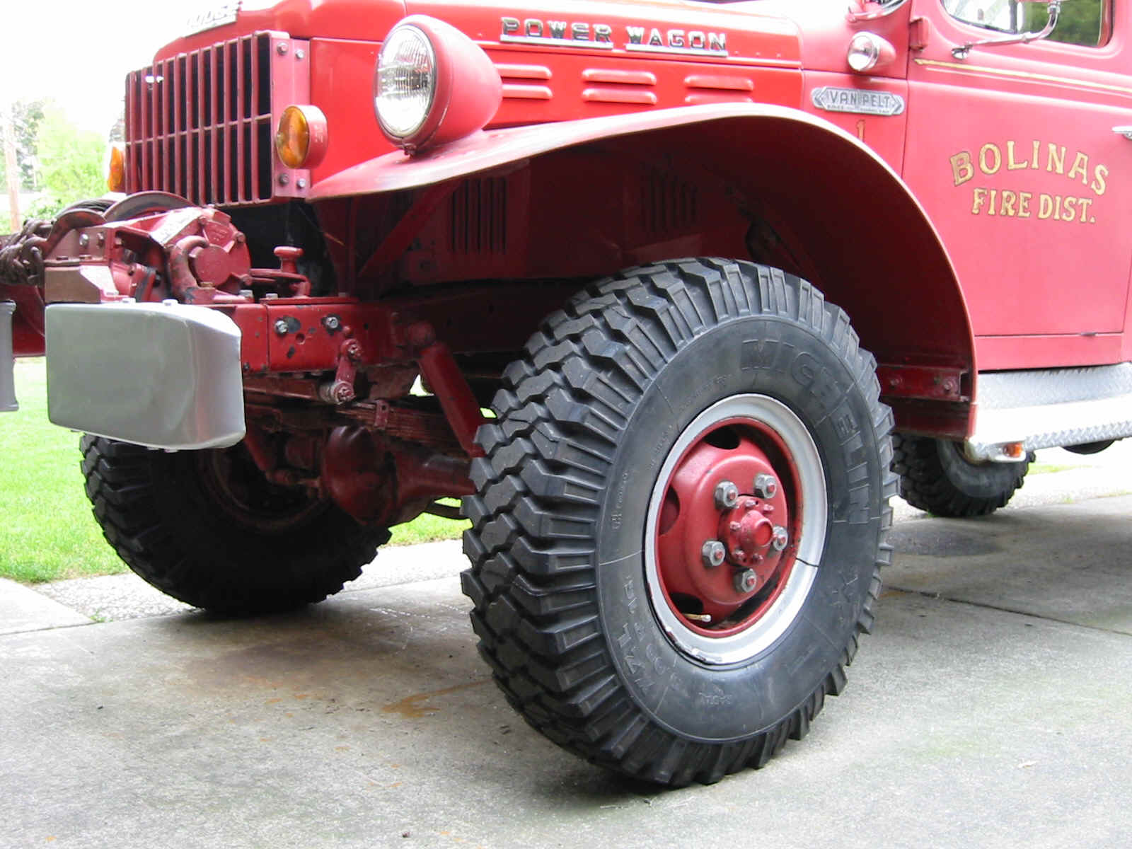

Well dressed on a Power Wagon.....
Michelin 1100r16 XL tires ( scroll down a bit)

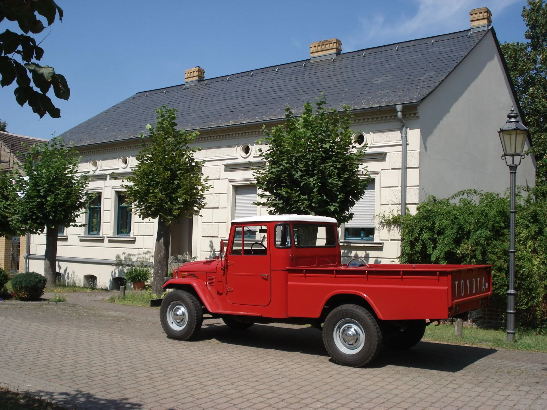

.... a J4 is well dressed with 7.50/16
Cheers
My understanding of the Michelin 255/100R16 was that only used tires were available in the US from military take-offs, and that the new production was only being sent to Afghanistan and others. The British were/are using the smaller ones on their Wolf Defenders.
Great tires, but................buying an expensive set of rare used tires without a source for replacements, and having to spend to ship them, seems iffy. If they were available new at competitive prices and at regular outlets for an extended time period would change my mind.
My well dressed J45 with 7.50/16 Dunlop designer shoes.

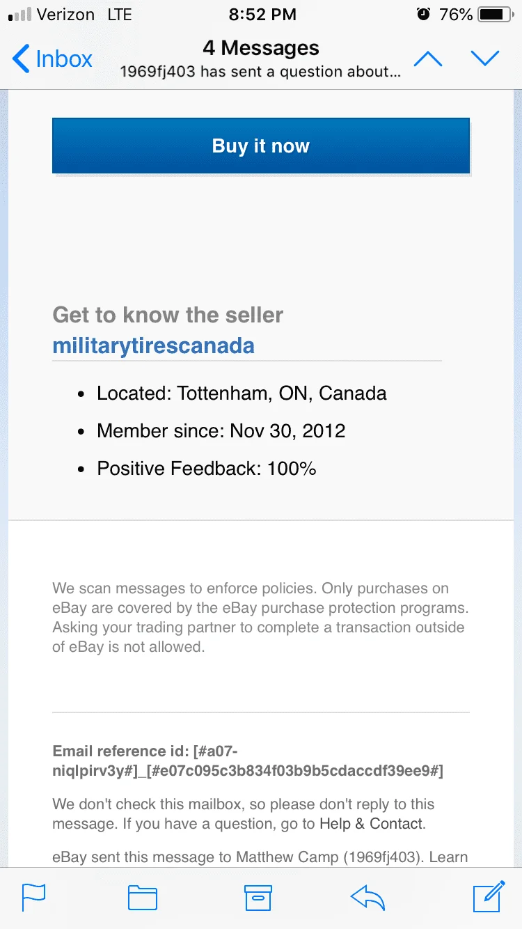

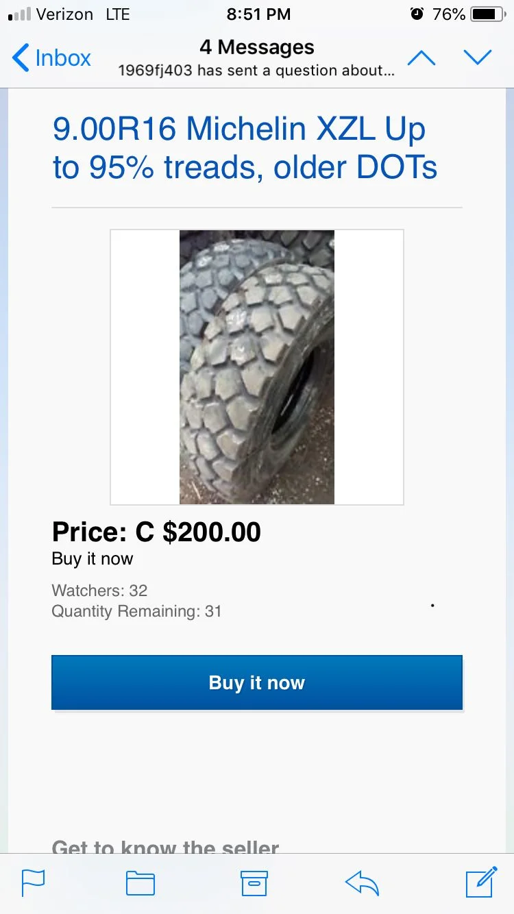

This may not be much help, but a few months ago I found an eBay add for a place in Ontario, Canada that was selling decent used military takeoffs.
View attachment 1763406 View attachment 1763407
Thanks.....abit too far and the transport cost wouldn't be economical :)

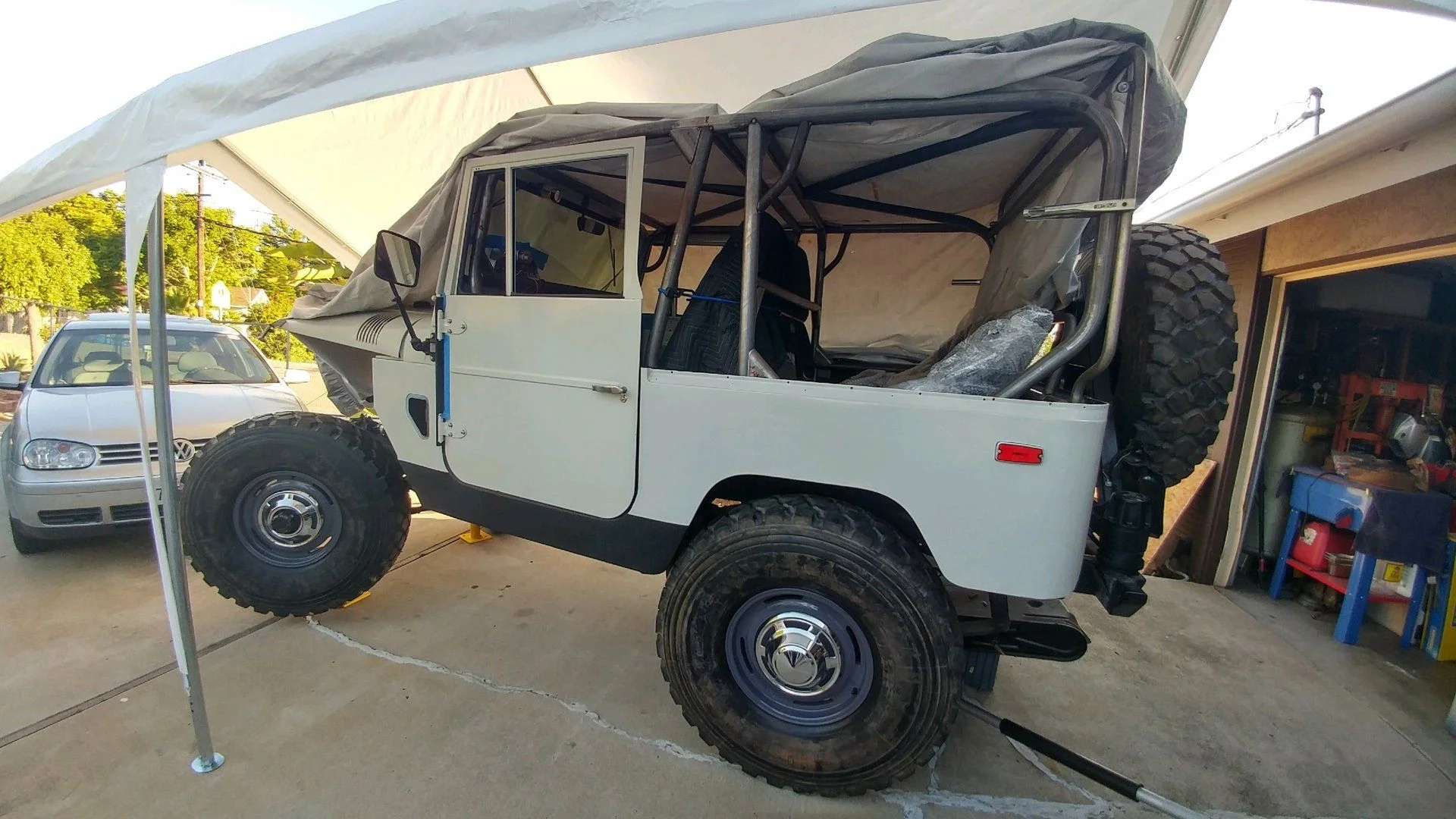

Figured I’d post on this thread as well. Has anyone attempted making the the 9.00r16 fit inside the rear well without cutting the exterior well? Looks like a super close fit. One side fits and the other is sup close - guessing it rolled at one point as the rear shock mount / cross member is bent.
