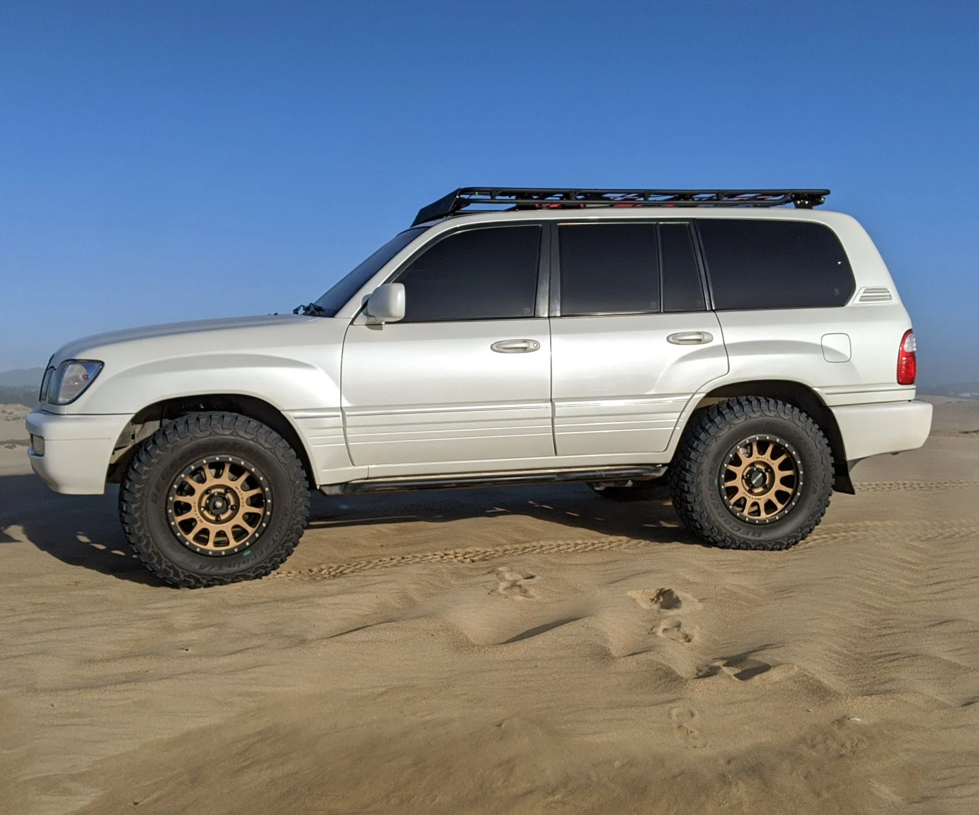

With zero offset, you will certainly limit suspension travel in the front by an inch or more. The front tire does not tuck in the fender on compression. Does it matter? Most of the time on low speed rocky trails it won't matter, as the 100 is such a front wheel lifter anyway (3 wheeler).

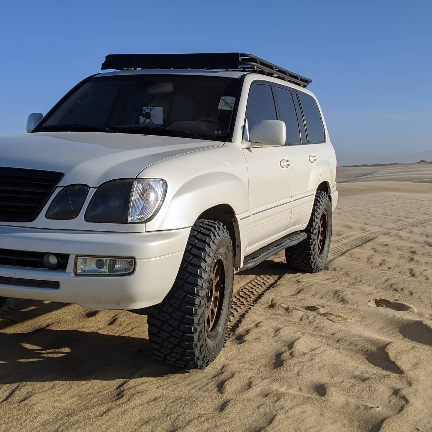

Here is @Brandon Ryder on 35's, 60mm offset, 285 width.... and he is not even on the bumpstops. Imagine bringing the wheel out 60mm and using a wider tire.

I agree 35's on a 100 are a tight fit, ya gotta remove the fender liner, smash the pinch weld, relocate the windshield washer fluid, get bigger bump stops etc.. For the trails I'm running like the Rubicon the tradeoffs are worth it and the wheel/tire combo being out so far saved me from almost guaranteed body damage! Just my 2 cents
