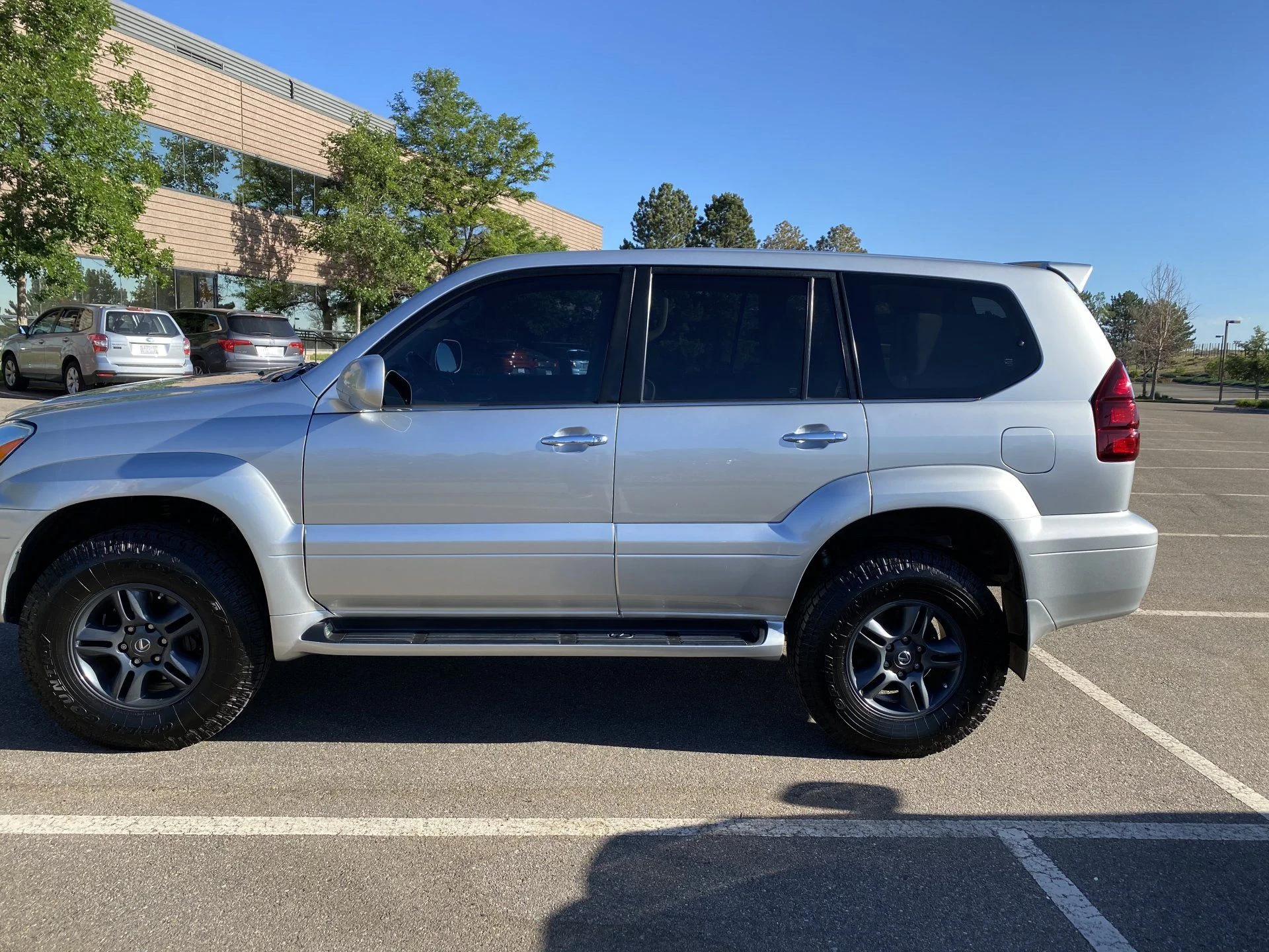

Do you have any side photos with the SSO kit? Did you use all the spacers? And lastly which coils did you use? Just debating whether or not the added lift from the SSO will be too much with OME 885/895s.
SSO kit with no spacers. 885/895 and 1/4 top hat spacer in front:
Without the top hat spacers
Tires are 255/80/17

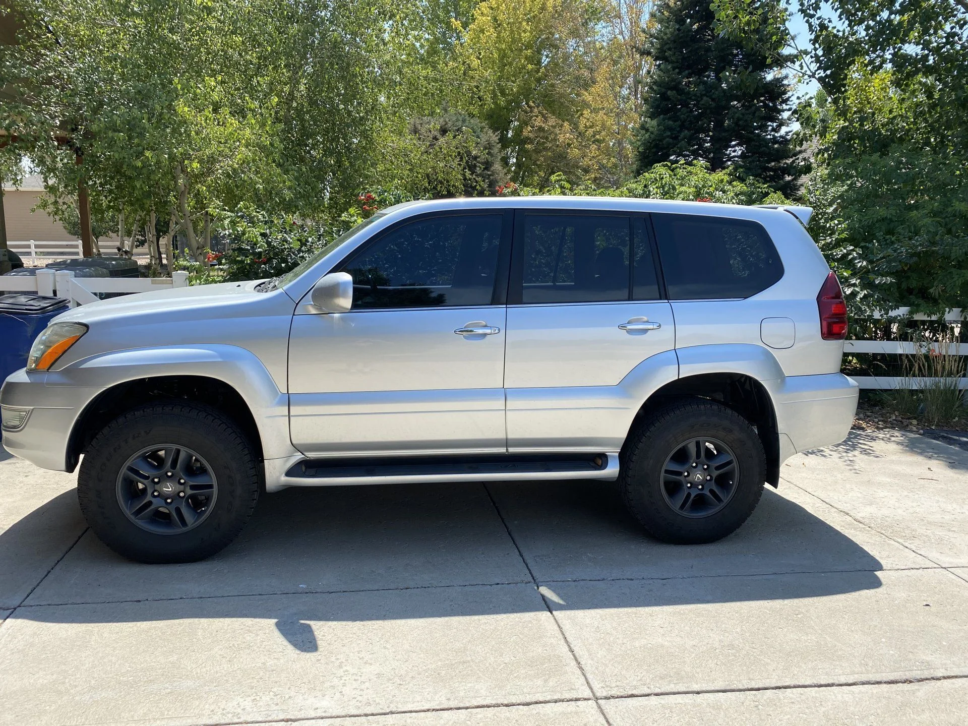

Thanks for the insight. I ended up putting OME 895 (2.5-3”) coils on the SSO pucks with junkyard OEM top isolators. Yeah I didn’t want to chance it with the hockey pucks. Felt like the SSO kit was worth the extra money. Happy with the setup so far, definitely handles better than maxed out airbags. I put one spacer on the driver side and none on the passenger. Didn’t take measurements but I’m happy with the height and stance.
Not the best photo to see the height, but in case anyone else is wondering, here is how it sits with OME 885/895 on the SSO with a single spacer on driver side.
