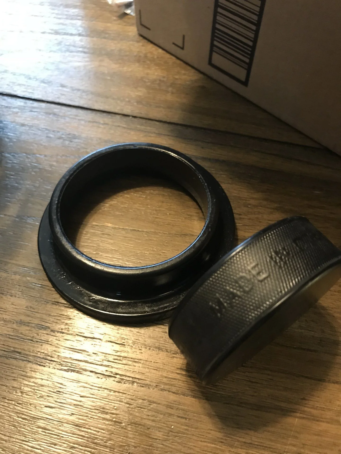

Seeing the Arnott kit and some of the older kits without the bottom locator, I am going to use the hockey puck method and drill a hole for my 1/2 bolt and call it a day. I am on the fence about making a sleeve for that bolt as there doesn't seem to be much stress on that part (since its not included in some kits).

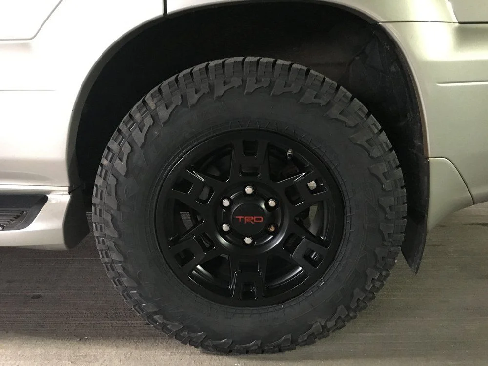

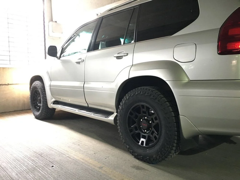

I've got the 81081 in mine. Used MetalTech bottom mounts and the cone isolators. (BTW I saw you already ordered, but did you check eBay first? I saved about $20 a piece on mine buying from a guy on eBay). In terms of ride height, here is the best photo I have right now. I'll try to get a better photo on level ground at some point. No weight in the back or anything. It seems to ride pretty much same height as the airbags on the "Normal" setting. Ride quality is great with the FJ springs and it really doesn't feel any different than the bags did.
Thanks for the photo. I looked at ebay, but the shipping on most of them and the fact i need them this weekend left me with ordering from amazon since I have prime. I am under $250 for everything right now. I will probably have about $5 in hardware. When you installed your kit, did you have to remove the sway bar or shocks? Also I like the way yours sits as well.
I think i found a picture with the 4Runner springs and it sits lower in the rear.

Ill update on the Hockey puck method as well. I have thinking about this method and will be making a sleeve for the hole because my luck, the damn thing would squeak like crazy if i didn't.

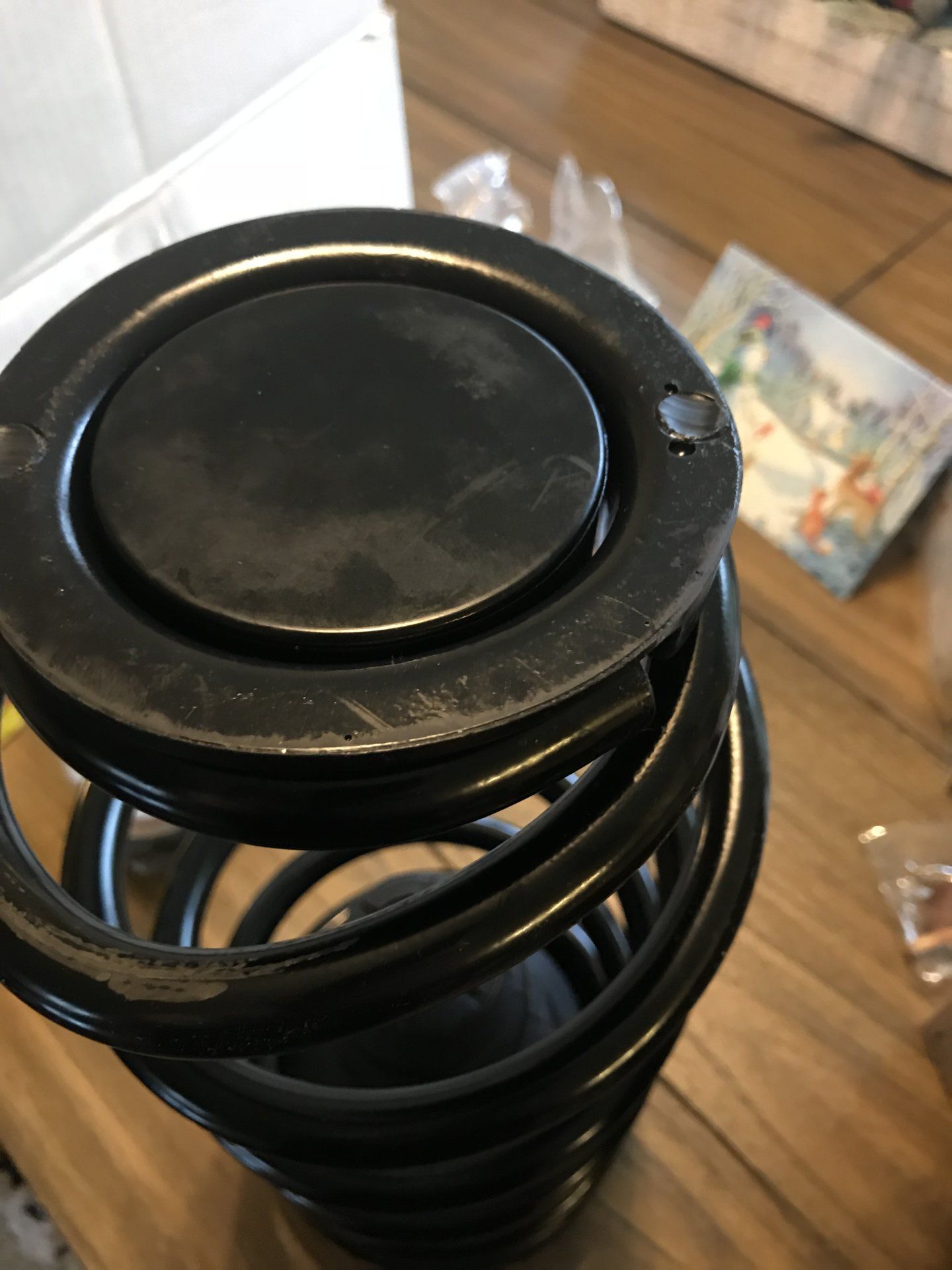

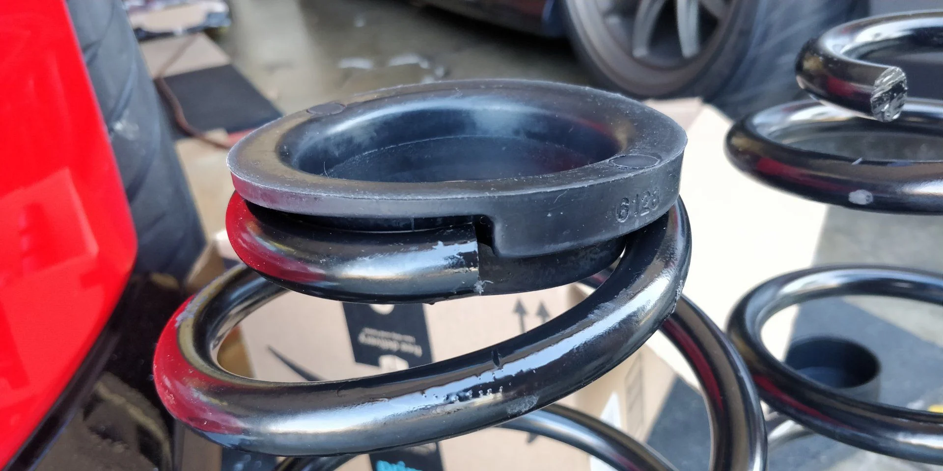

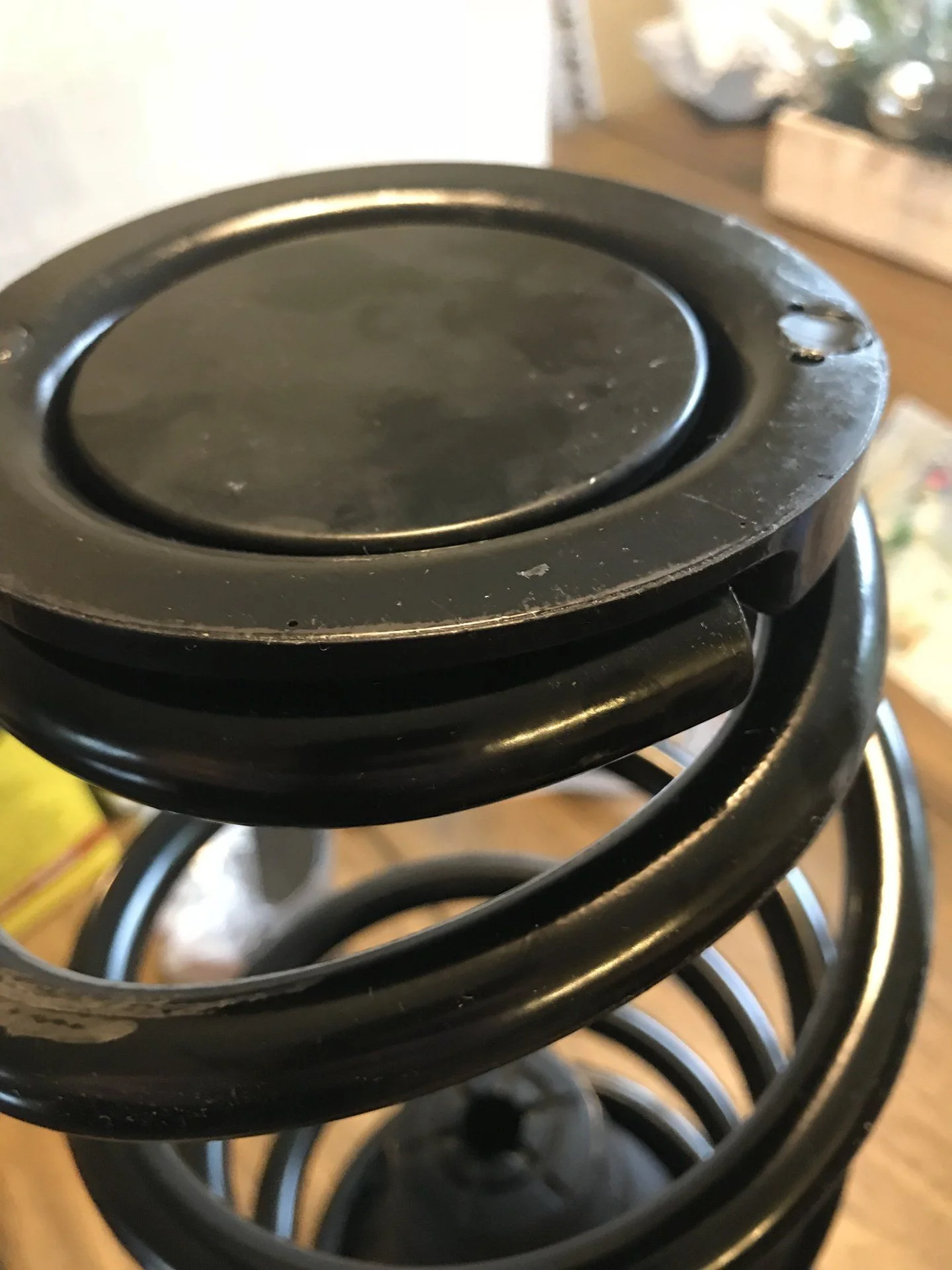

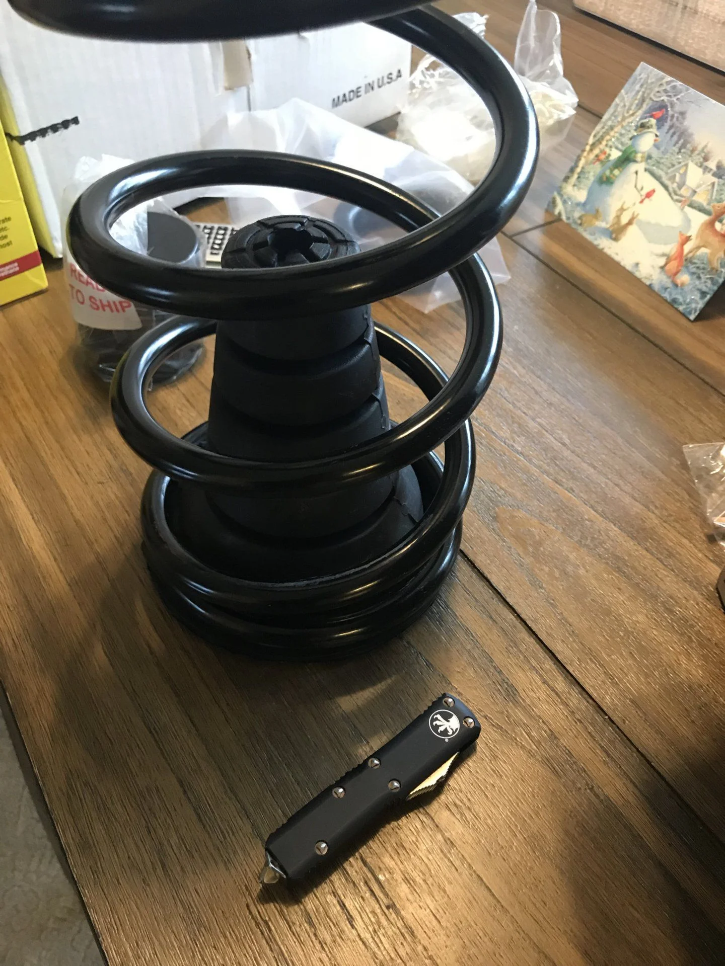

Just doing some test fitting on my DIY coil spring conversion. Also doesn’t look like I’ll have to cut the springs any either.
Energy Suspension 15.6103G RAMPED Coil SPRNG Isolator Set
Moog 81081 Springs
2 hockey pucks
Genuine OEM Toyota 48302-35040 Spring Seat Sub-Assembly
Here are some pictures of test fitting the pieces for tomorrow’s conversion.

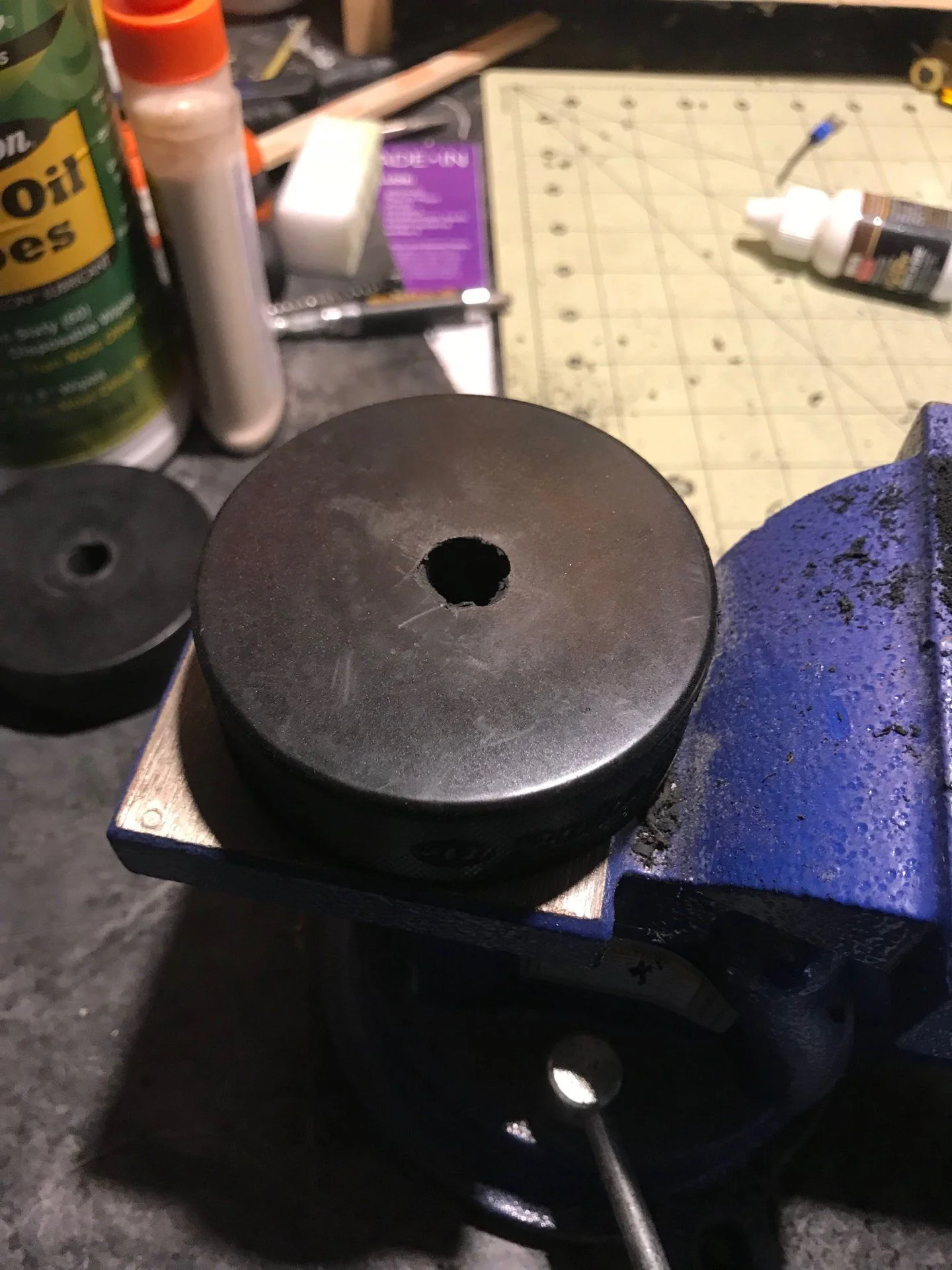

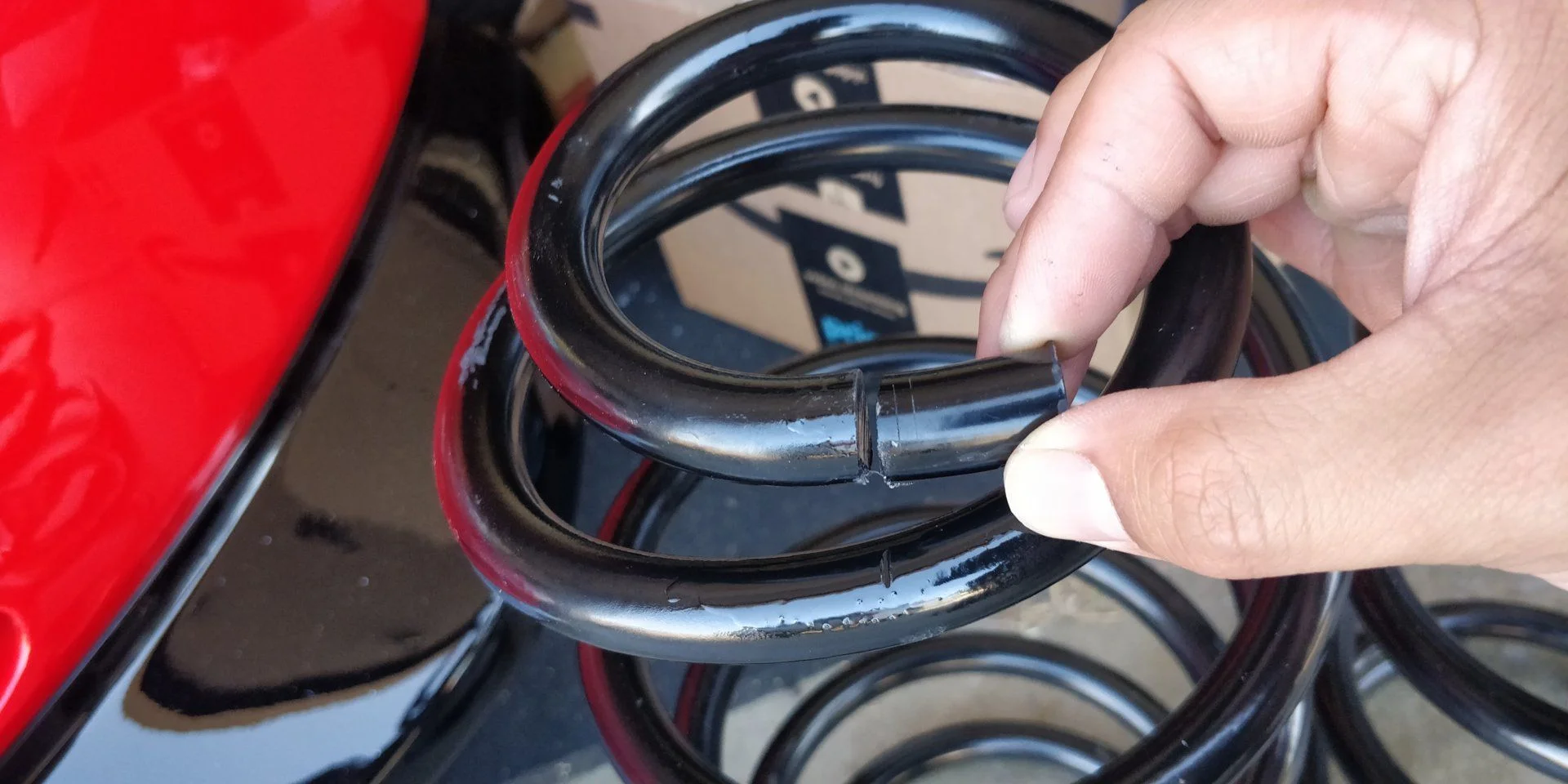

So just an update, I got everything installed with the Moog 81081 Springs.
Drilled a hole in the middle of the Hockey Pucks and was able to install. I think I used 1.5" 1/2" bolt and nylon locking nut and a washer on each side of the hockey puck. Looking at other kits, you could probably stack 2 on top of each other and use a 2.5" 1/2" bolt for added height of the lower isolater.
So far rides great, went out last week and rode some trails, got a little articulation and the springs remained in place. Love the ride height and will get a measurement sometime this week. I also went ahead and replaced my rear shocks with 4 runner shocks because my shocks were rusted pretty bad.
Also i cut the factory bump stops at the red line on the attached photo. I have read many people having issues hitting the OE bump stop and having issues with it. I don't mind cutting because the upper Toyota isolators act as a progressive bump stop.
