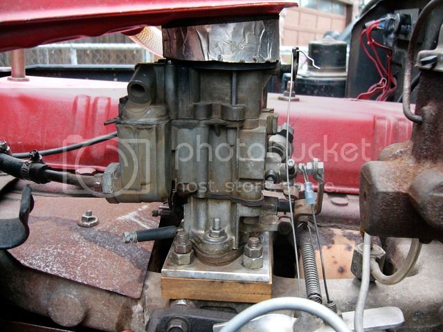

On my 1st 67 the PO had made a wood carb spacer for it. Ill dig up a pic lol.
Yah i was pretty green to cruisers when i bought it so i didnt even notice lol!!! It ran surprisingly good. I ditched that s***e carb and had a proper one put on ran even better after... I feel worse for the PO as he paid 9k for it just from pictures lol. I took it off his hands for 4k had it for 10 years then sold it for $4800 after it had been sitting for 4 years. I really dont miss that 40 at all
nice manifold insulator also!
