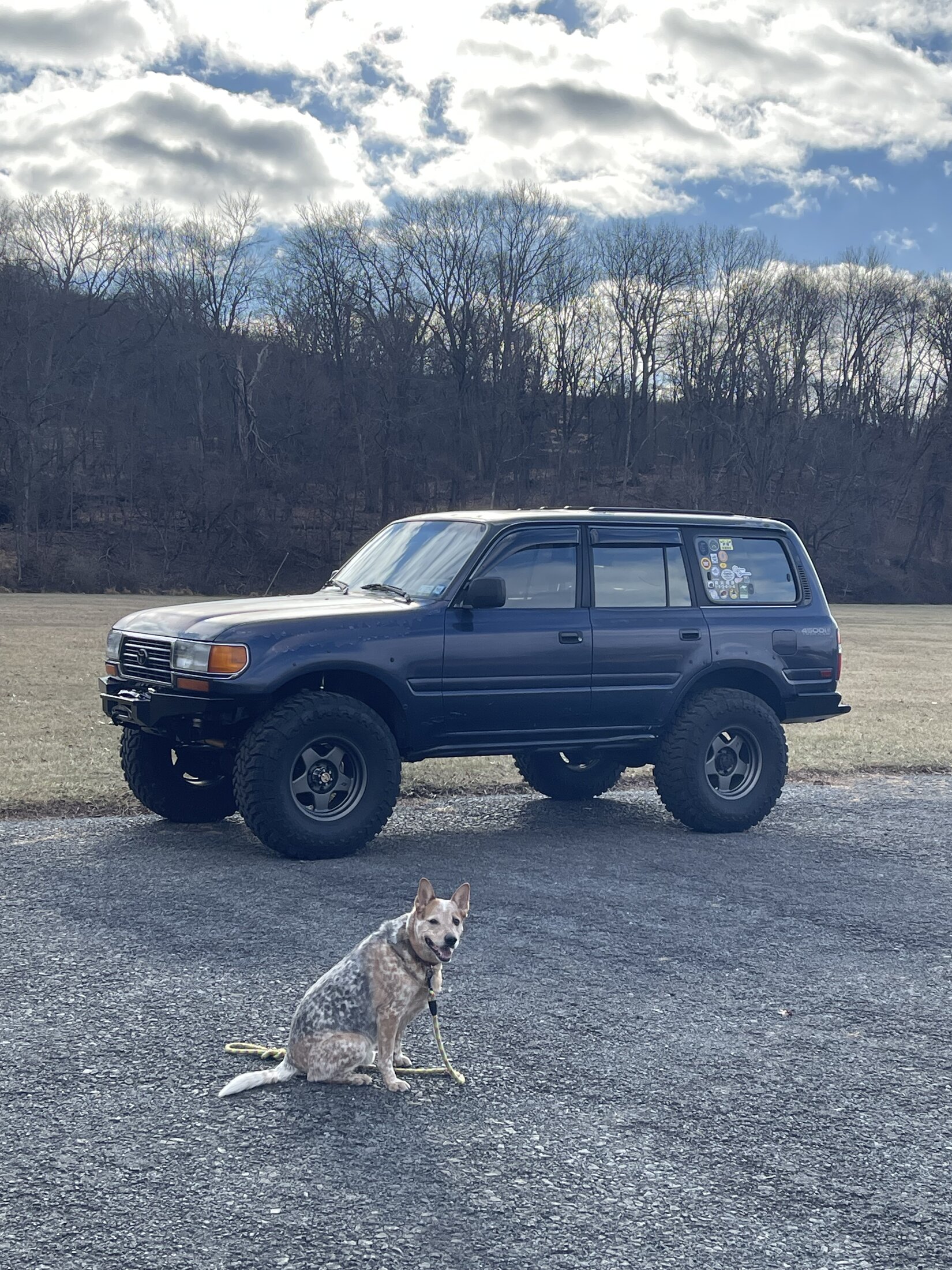

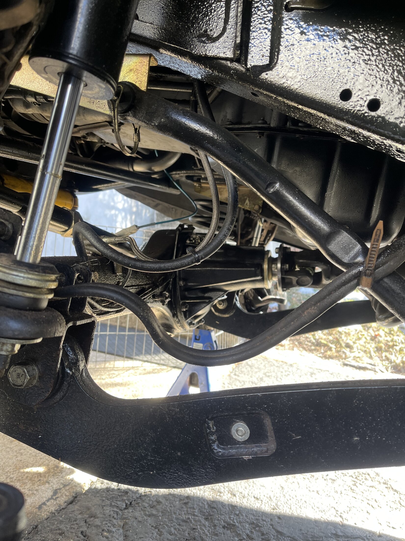

Took the dingo out for some frisbee yesterday and then mustered up the motivation to pull my front diff and send it back to marlin crawler for warranty repair. Was a brisk 25 degrees this morning with snow flurries. Had the diff out, packaged and dropped off at FedEx in 3 hours.

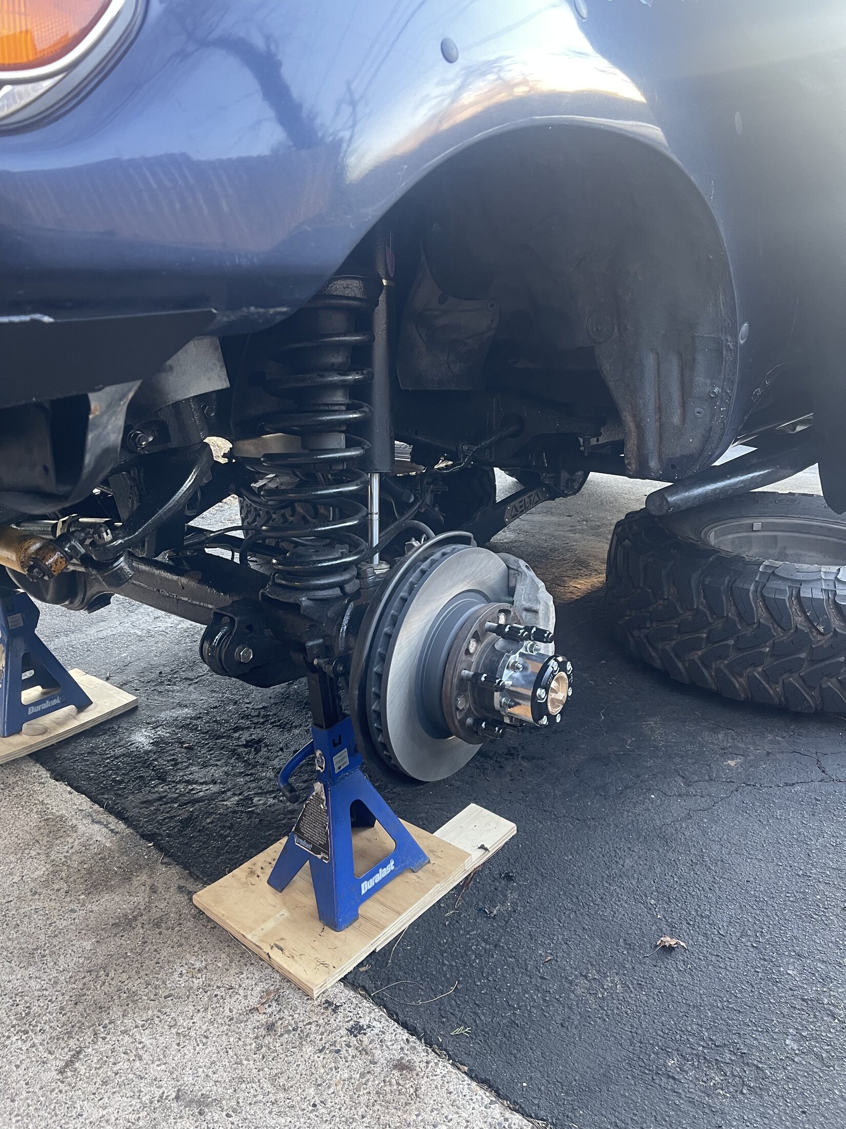

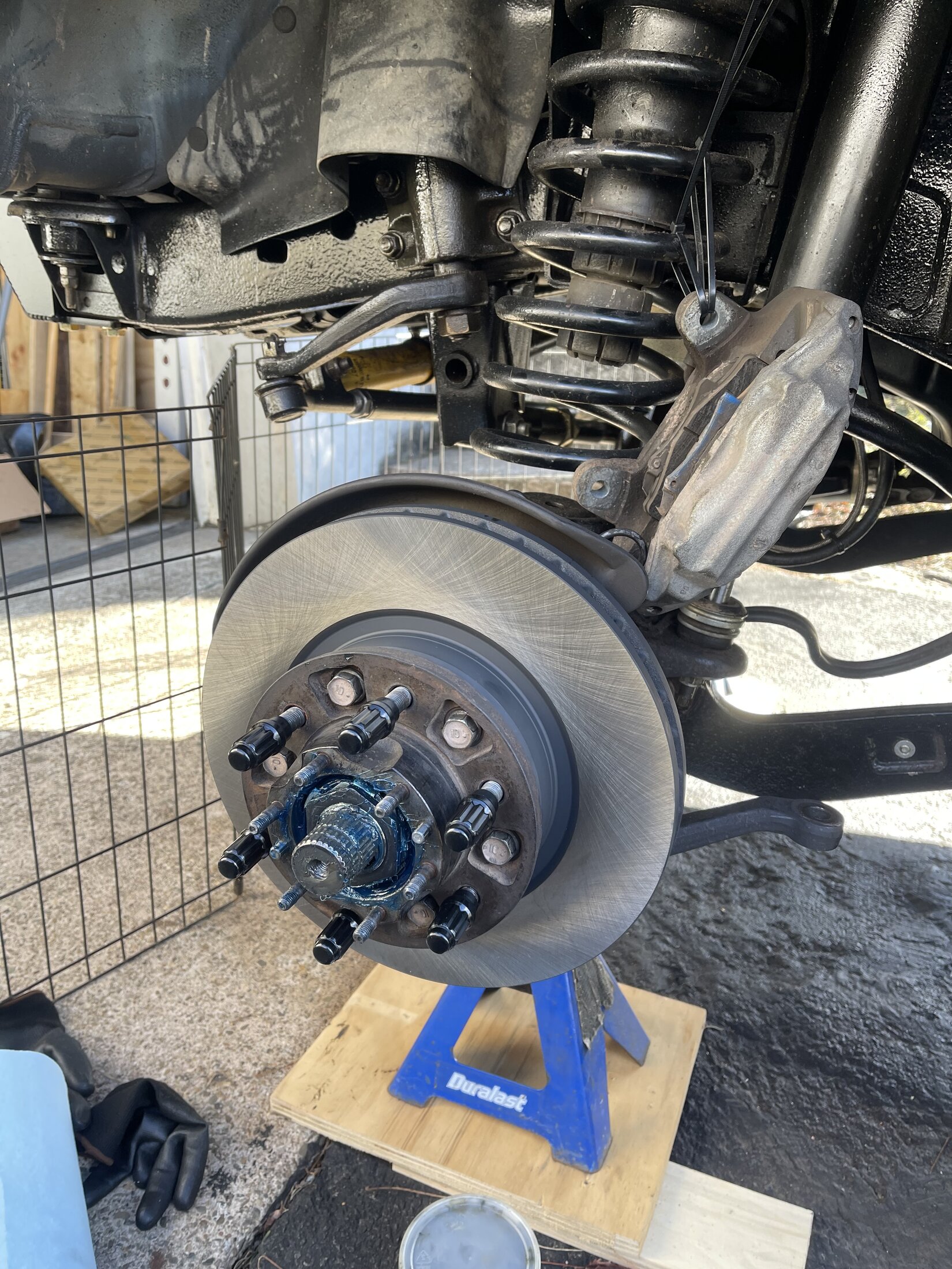

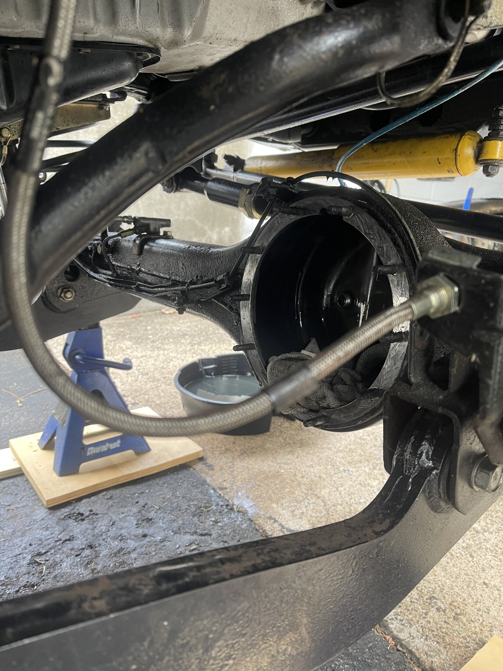

Got the new rotors mounted to the hubs. Was going to repack the bearings but driver side showed grooves from the grease being washed out by the moly birf grease. I noticed birf grease coming out of the hub on my road trip and knew something was up. Luckily I had a set of bearings for the rear but turns out they are the same front and rear so I was able to replace the driver side wheel bearings and get the passenger side repacked. Put some plastic wrap around the front and back of the hubs and wrapped them up in plastic bags ready for install.

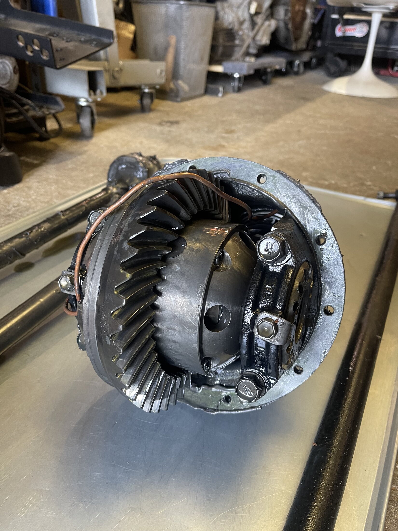

Front diff is back from Marlin Crawler. They said the copper line was plugged so they replaced it and routed it much better this time. Glad it wasn’t anything wrong with the internals of the air locker but still, what a pain. Something I could have done but they would not send me a new copper line, they had to warranty it. I did get a free knuckle seal/gasket kit though. Now to find the time to get Merl put back together.

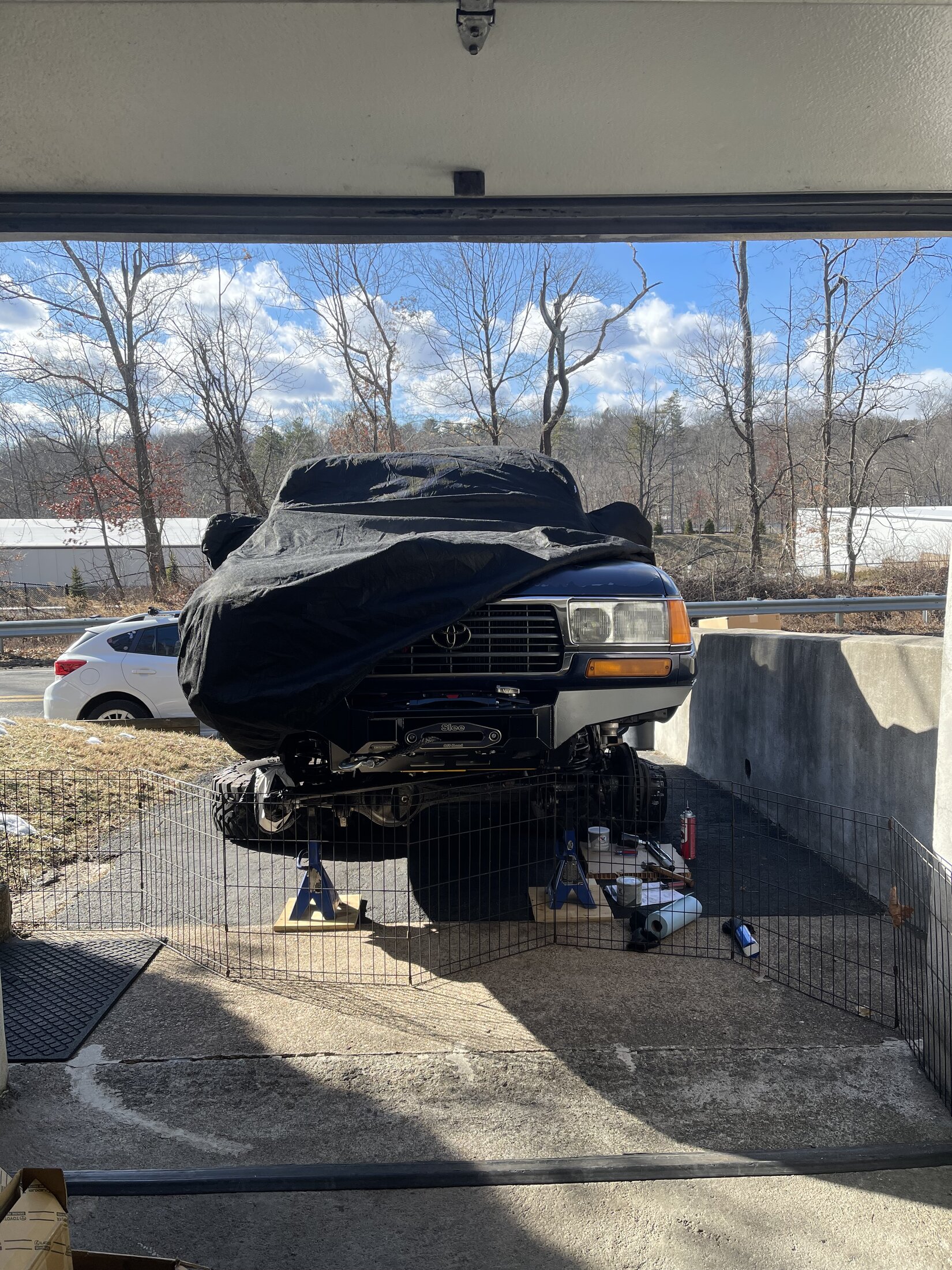

Got the front diff installed today along with the new rotors and pads. Going on 2 hours of sleep with a newborn, it took way longer than expected. Lifting the diff into the housing took it out of me lol I am so shot. Didn’t even have energy to test the locker, so another day but Merl is mobile again.

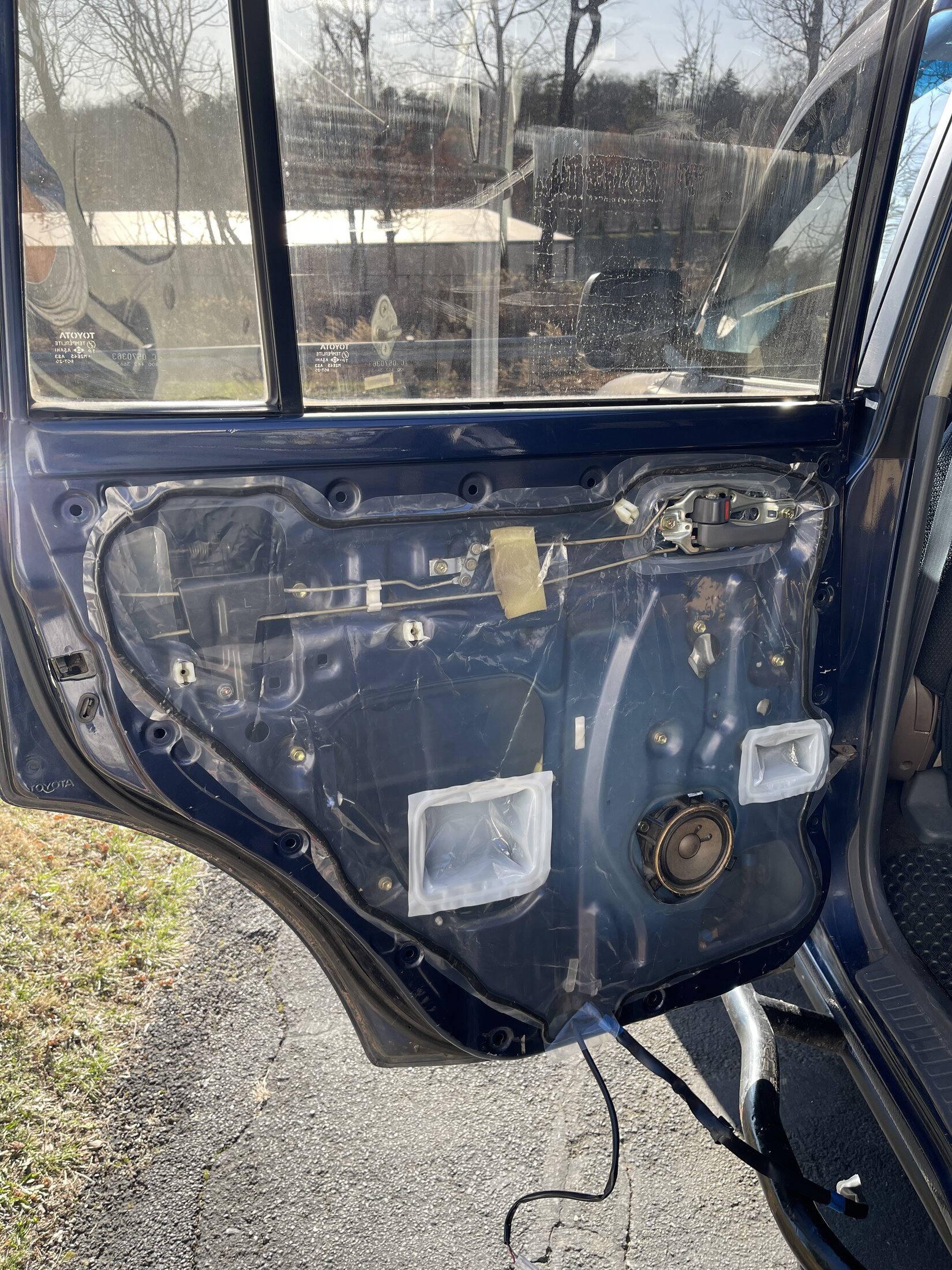

Replaced my driver side rear door lock actuator with a new aisin unit, cleaned and lubed the moving parts and installed a new vapor barrier with fresh butyl tape. Tested the lock before putting the door back together and it checked out so I put the door back together, closed it. Locked it and unlocked it and the door didn’t open… I forgot to hook up the arm and clip for the outside door handle. Son of a gun! Had to pull the whole door apart again, managed to razor blade the fresh butyl tape and avoided ripping the fresh vapor barrier. Got her all put back together and she works like a charm. Hopefully the passenger side goes smoother.

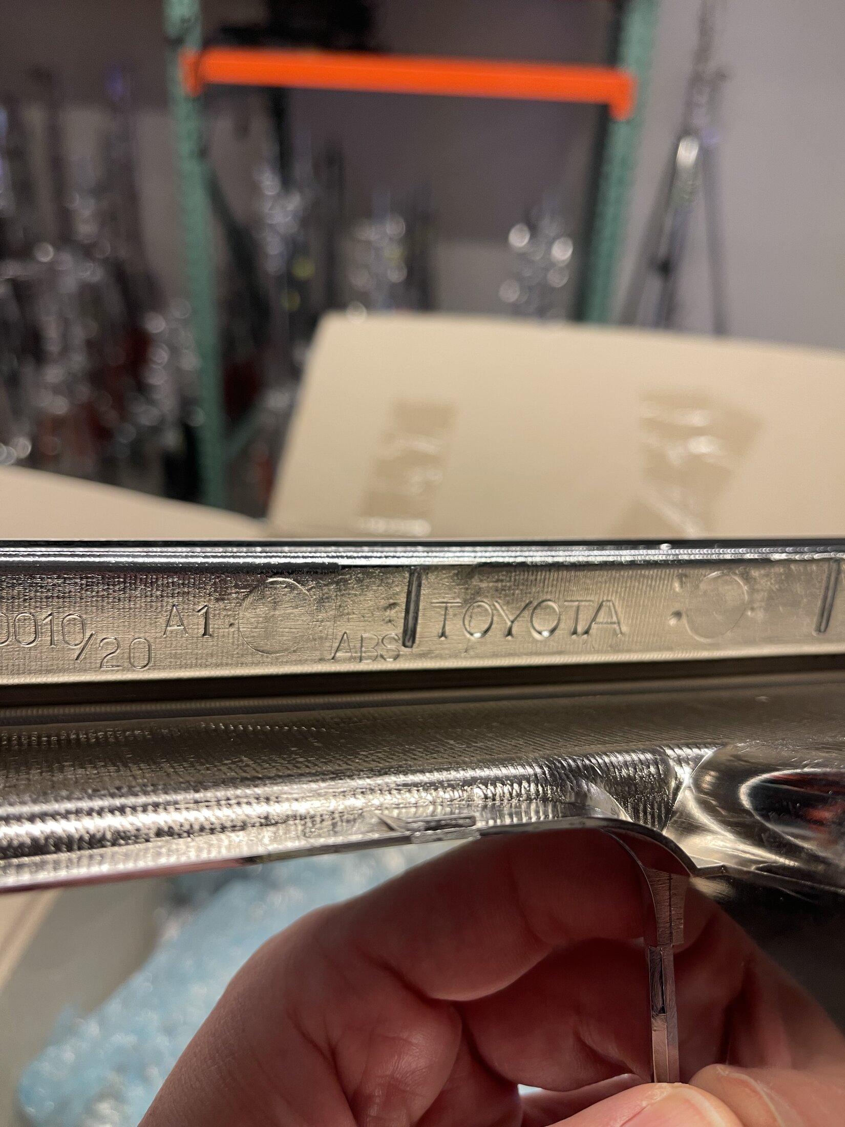

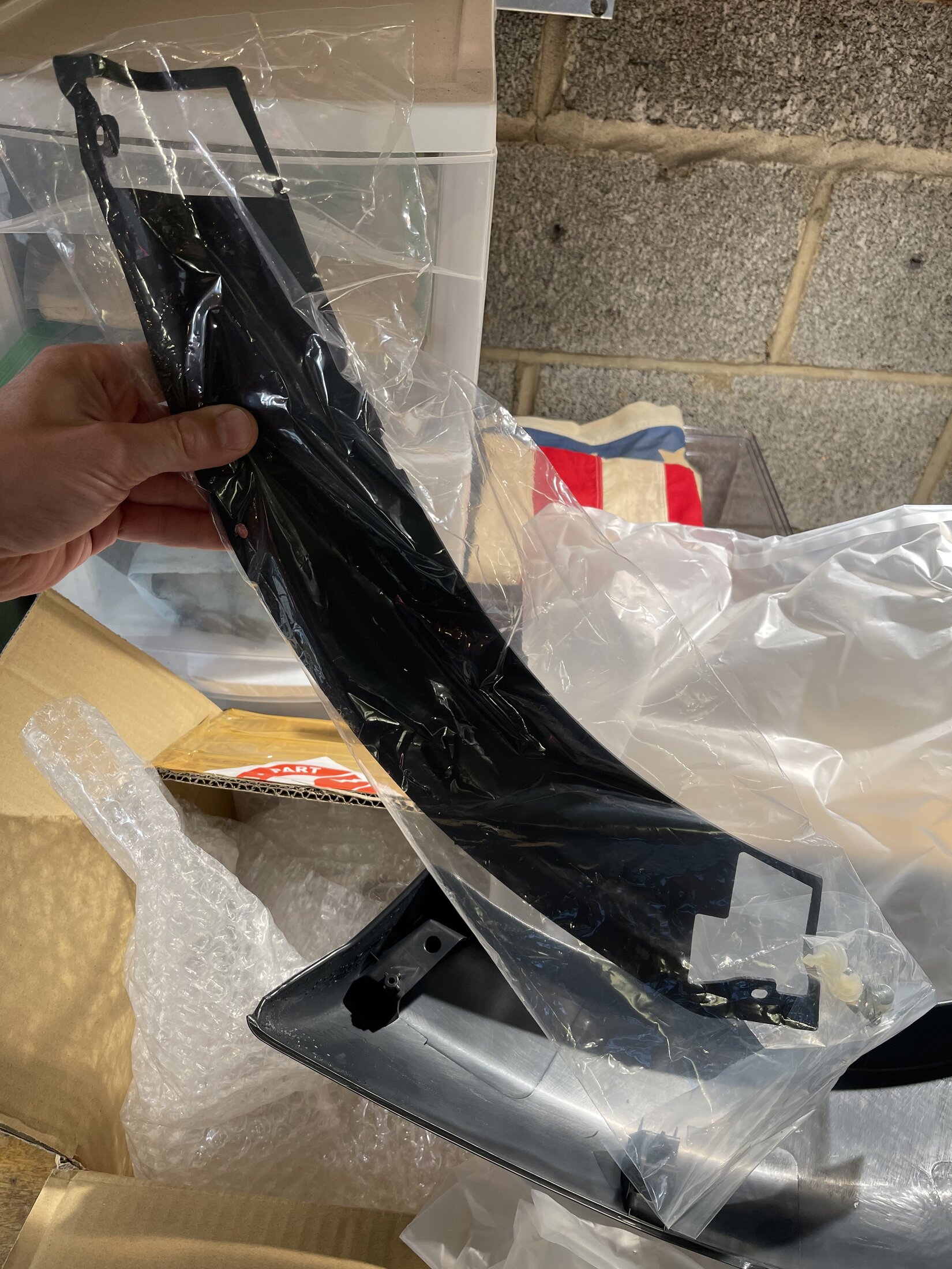

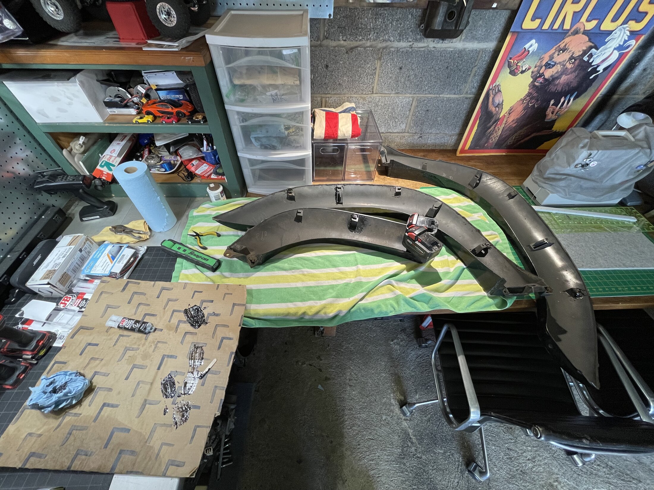

Picked up some nice black flares off a parts rig, I think black flares will looks nice on the blue. It was missing the driver door flare and I couldn’t seem to find a used one so I ordered a new flare and a bunch of hardware from partsouq to start my flare journey. I am still waiting on 3 of the rear door metal brackets that rivet onto the door, I ordered those from amayama. I got a can of 202 color match black to paint the new flare and a 2 part epoxy clear coat. Never tried clear coating anything so wish me luck. At least it’s the smallest flare on the truck. I have already JB weld repaired some of the broken clips on the flares. I noticed my driver front fender is not original and is from an earlier year so the holes do not match up, a few do so I think it’ll be fine. Getting all of the plastic plugs that the PO put in the fender holes will be a task in itself. But this should be a nice project.
