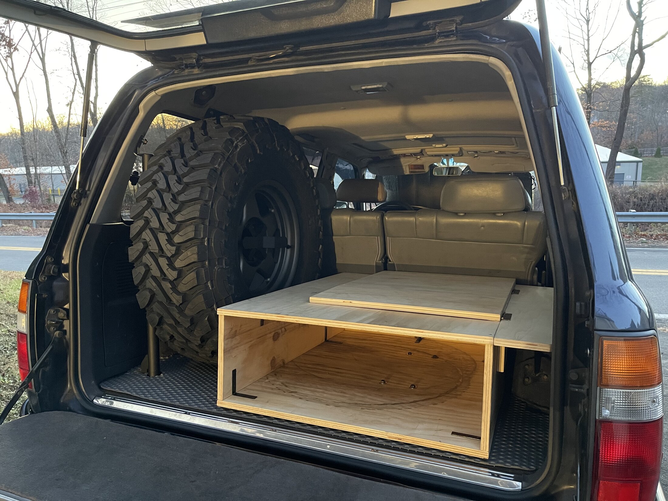

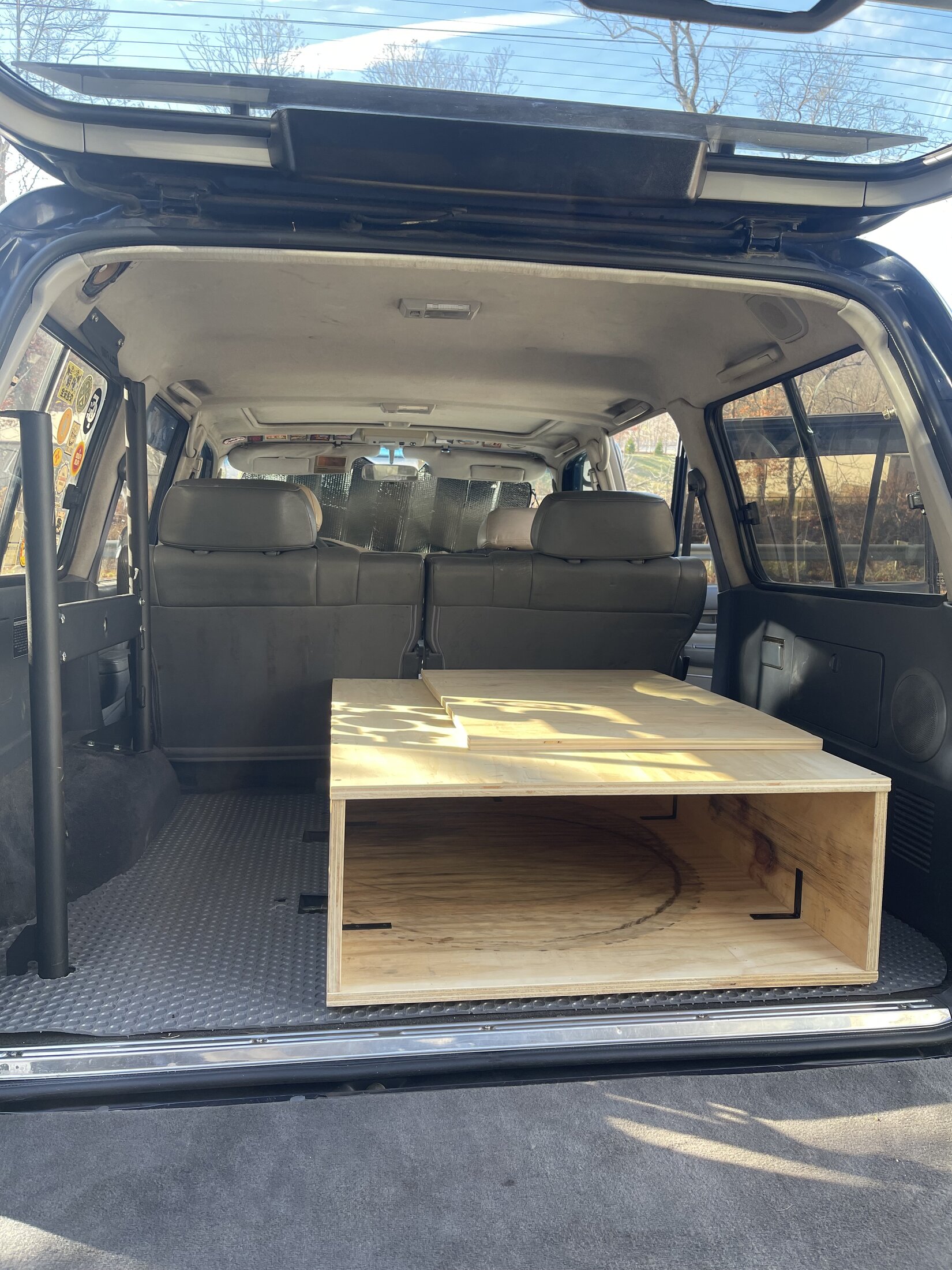

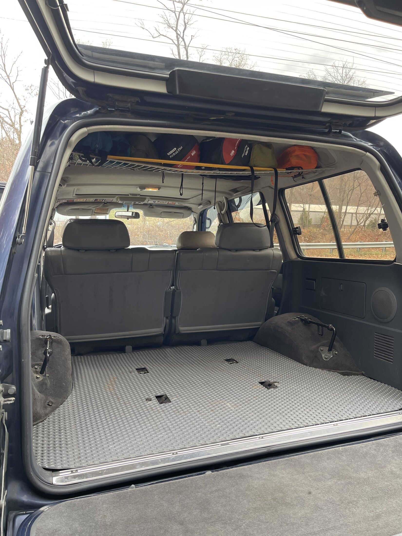

Rear seats went back in so I can strap a car seat in. I chopped up my sleeping platform to fit in the back. I’m not sold on it so will be getting a bel-fab interior tire carrier and making a low profile storage box next to it that doubles as a single sleeper. But this will do for now.
I like the idea of the Bel Fab mount, there should still be enough room for a smaller dual drawer system.
Also something to think about, when you are alone camping the rear seats fold forward correct? If so you could build a foldable platform for more sleeping area when not in use folds back on top of the drawers.
Yeah, should have plenty of space with the tire upright on the side, my sleeping platform used a piano hinge to flip over the extended part of the platform and used the factory rear seat hook straps to support that platform from the oh**** handles. So I’ll probably stick with that idea for the single sleeper. I want to get it as low as I can but will ultimately need to match the seat height when folded down.

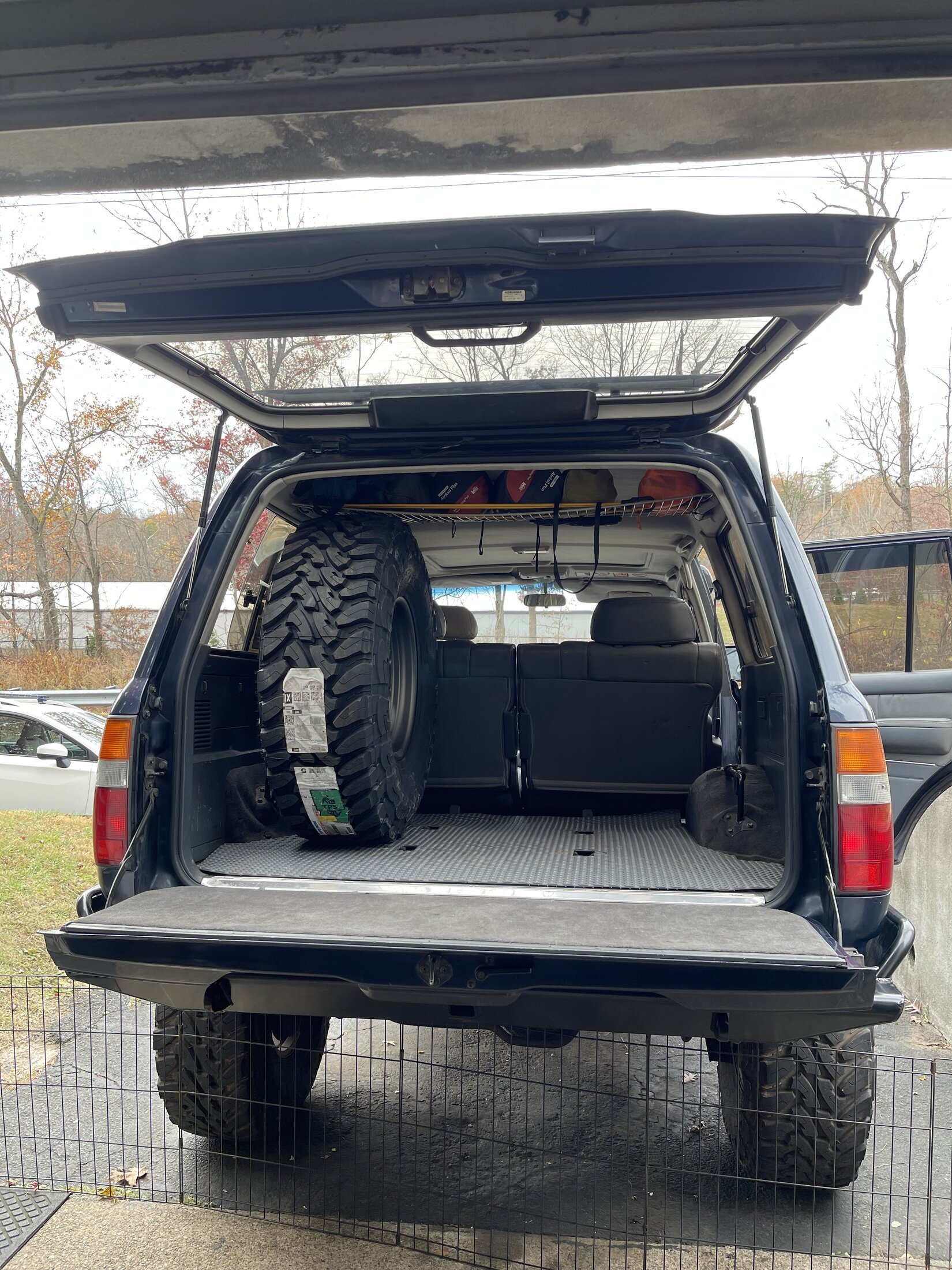

I am running my spare tire in trunk area and car seats in second row. In my experience there is not enough space inside with kid stuff and tire it gets real small real quick. I’m going to be doing a swing carrier to get tire out of the back. I would try it out first and see if it works out for you everyone has different opinions.

Yeah big tires take up trunk space quick. I committed myself no swing outs with the labs basic bumper. I had swing outs on my taco and after awhile I hated them. With the tire laying flat under the platform, it’s too tall for needing to throw the stroller or groceries in the back for the wife. I’ve always wanted to make it lower to gain head space. Hoping the Bel fab tire carrier will at least give me the chance to build a lower profile platform where I can still stash tools and camp gear in a drawer or two. More head height for the dog in the back also. I’m sure it’ll go through a few iterations and never be perfect but I’ll always have a project to work on lol

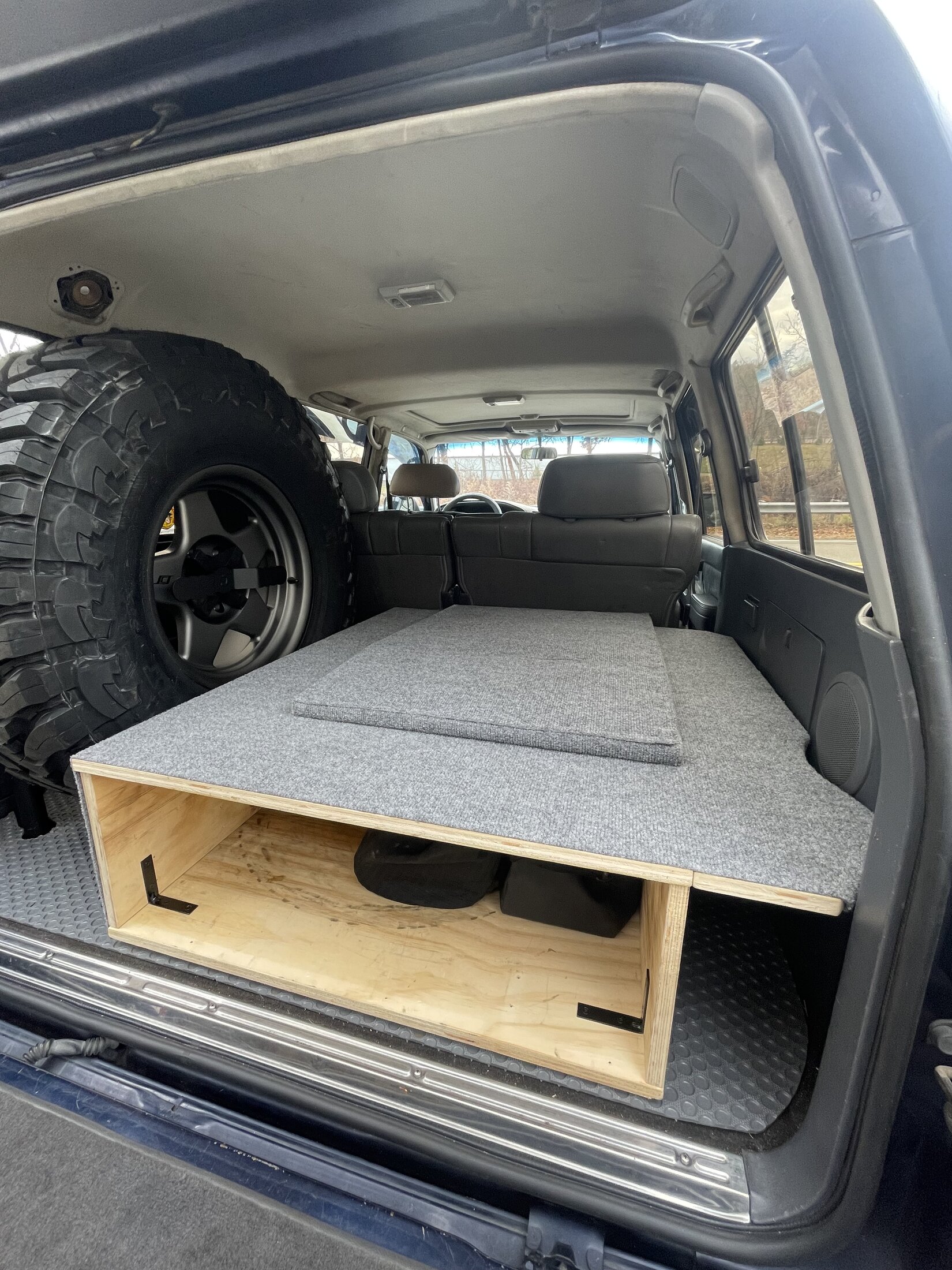

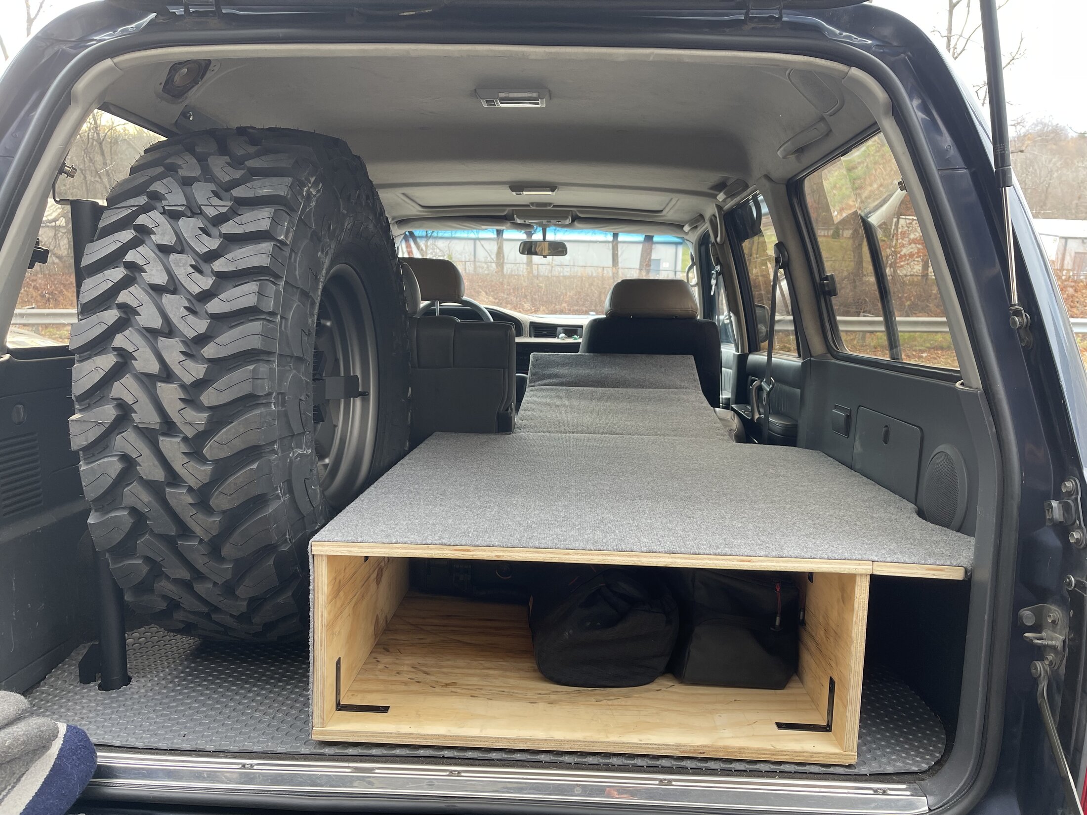

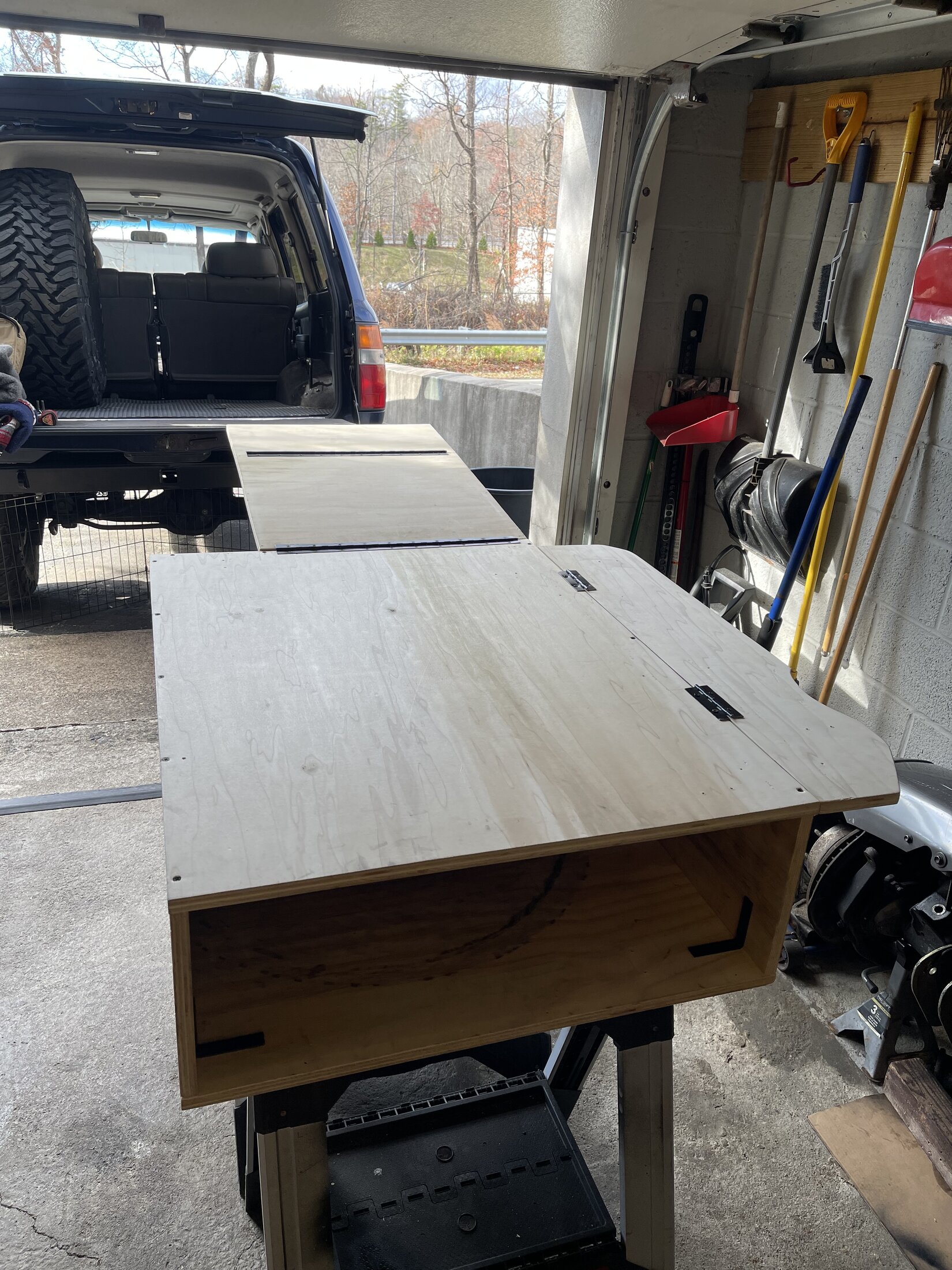

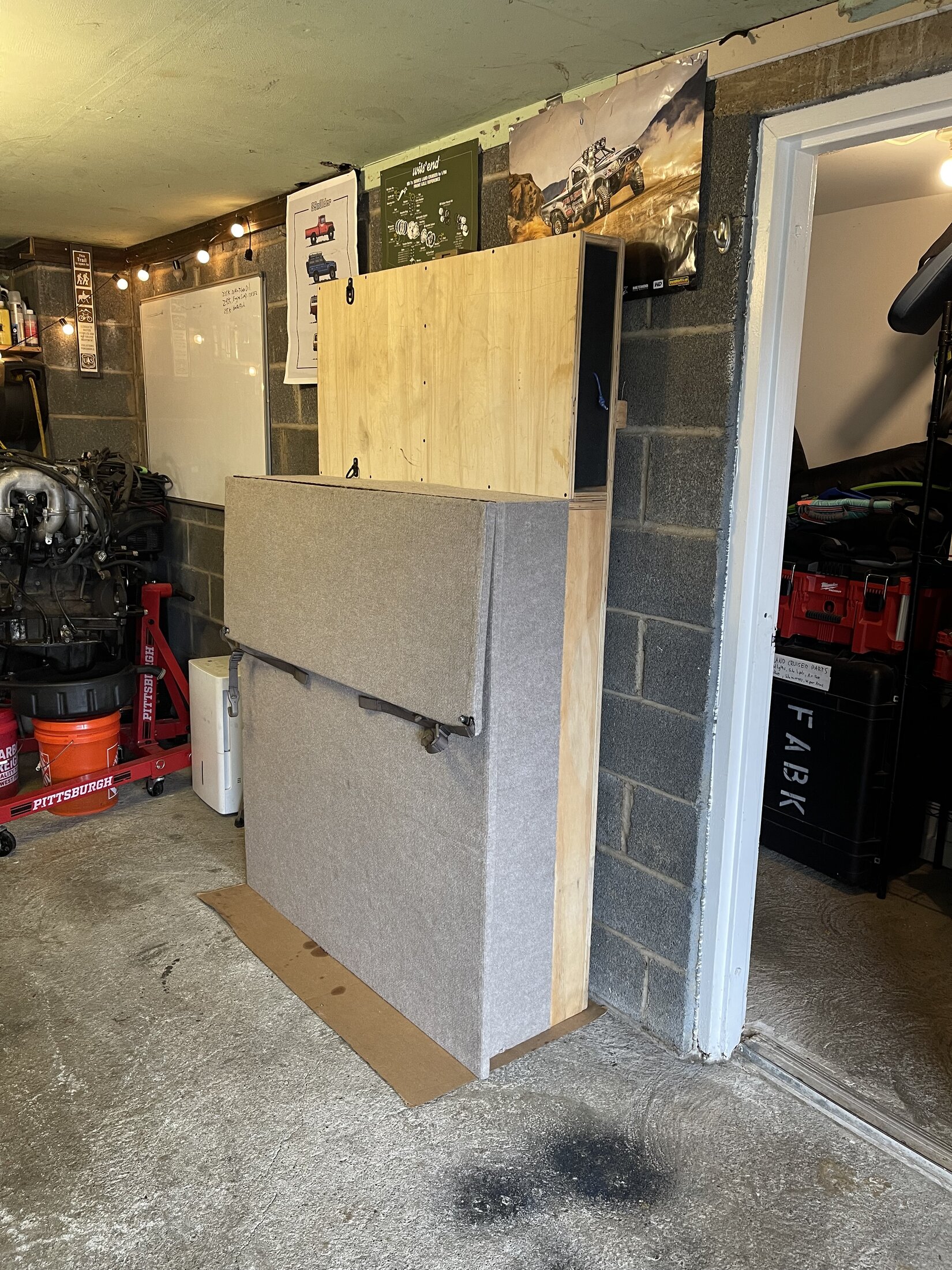

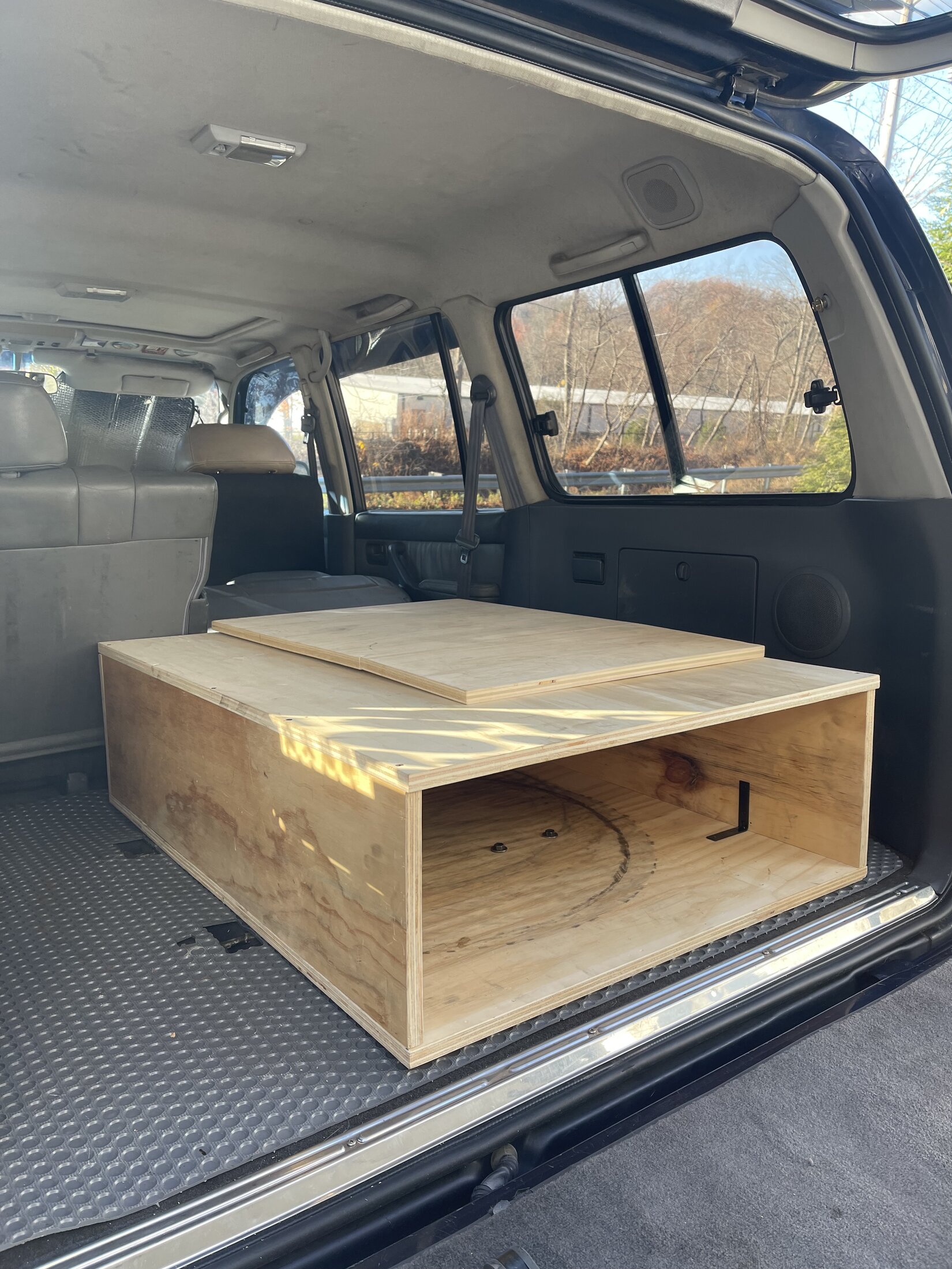

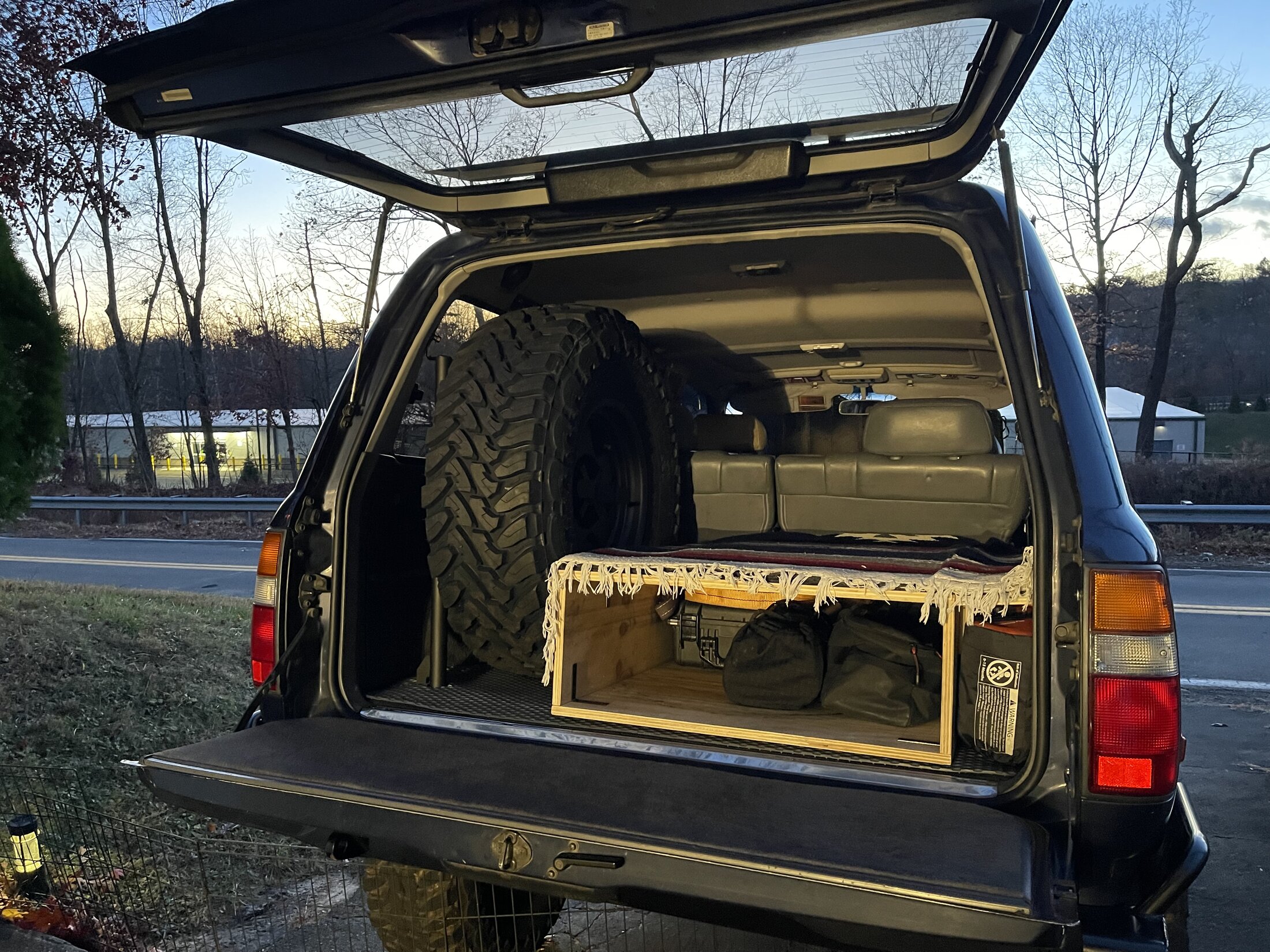

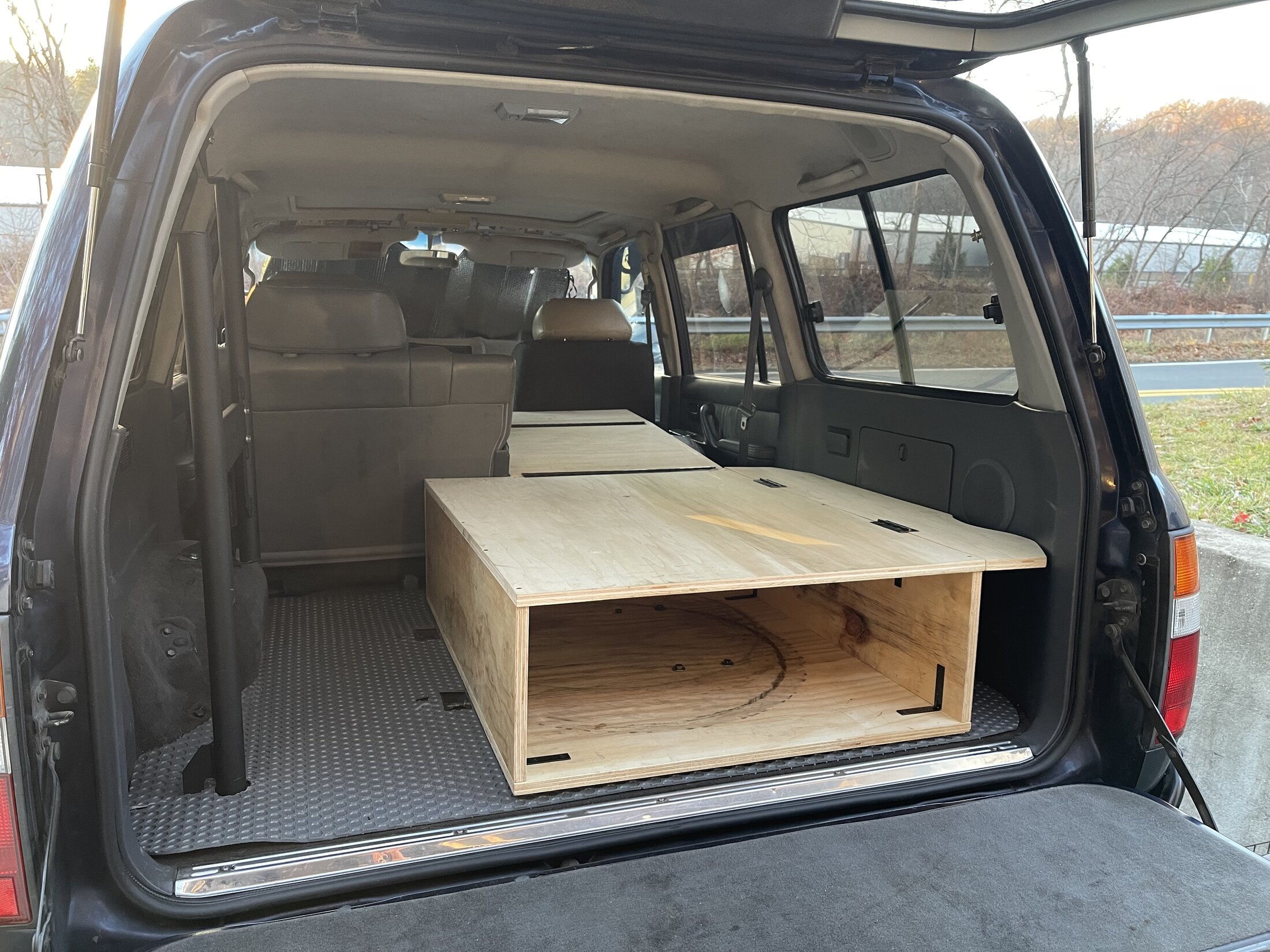

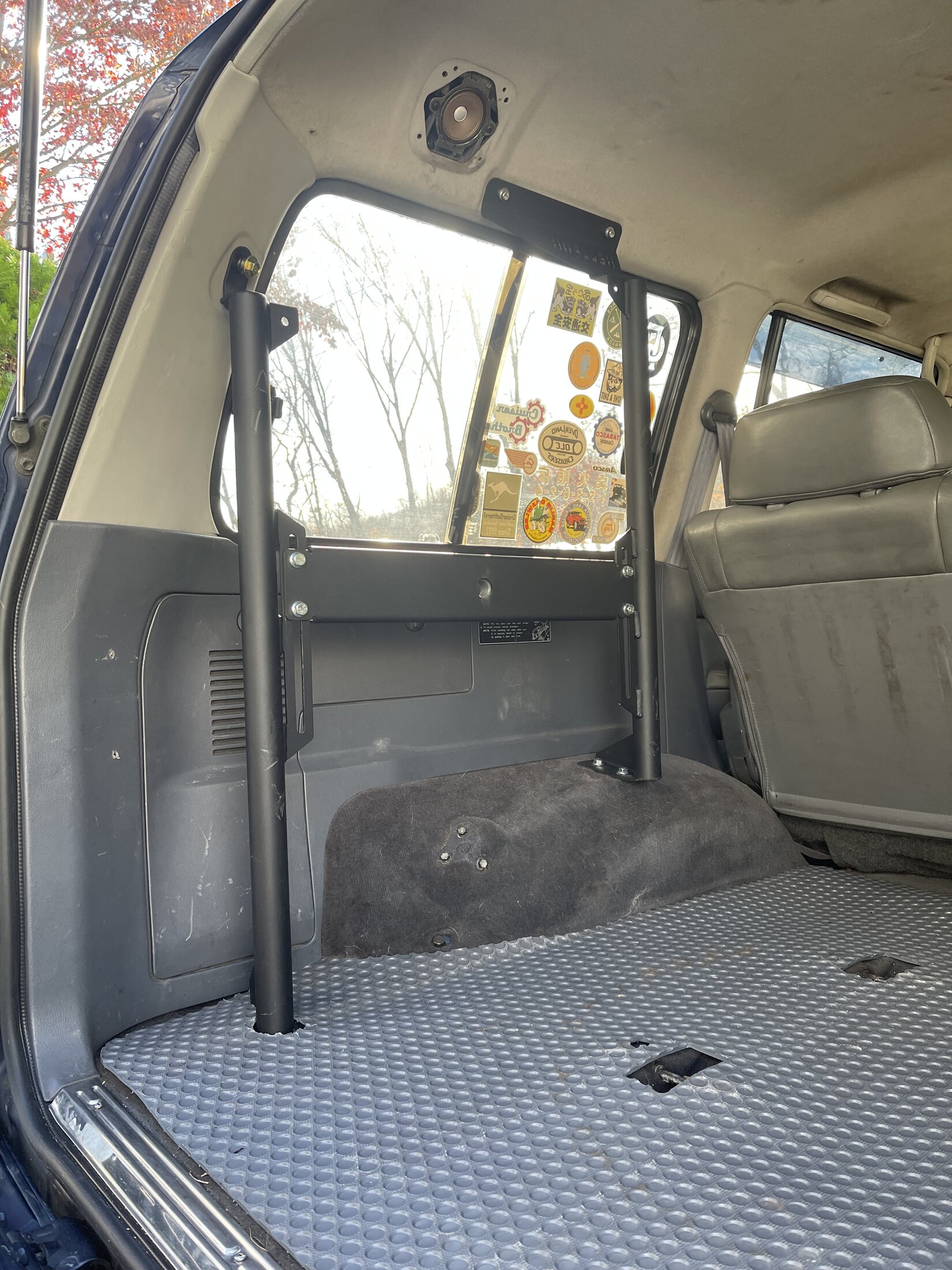

Got the bel-fab tire carrier installed and built a new storage box/sleeping platform that flips over the rear seat. Box ended up being 30x40x10. Got the platform securely bolted down with the 4 rear anchor bolts. The tire carrier doesn’t budge and the platform doesn’t budge. Haven’t decided on a drawer yet so just left it open. So far pretty stoked with this new set up.
Nice work!! Also changing stuff around….tire up to tire down.

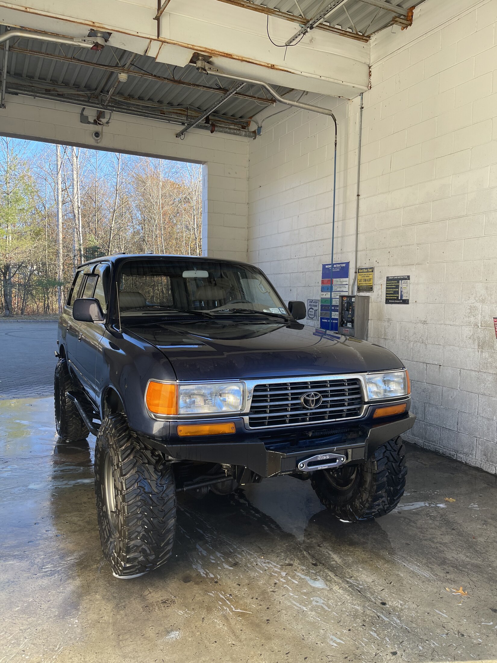

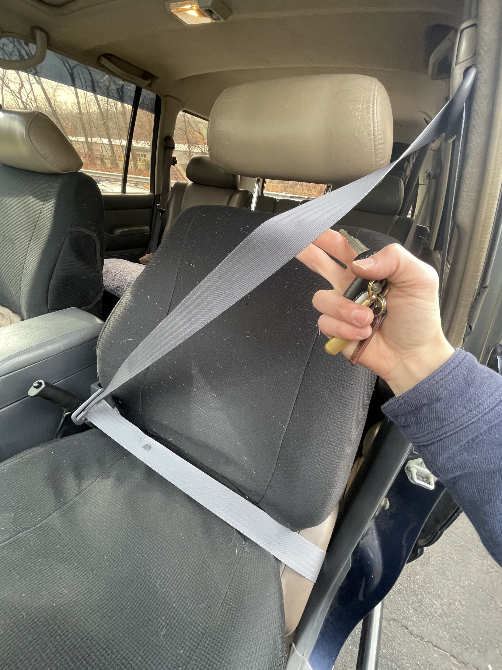

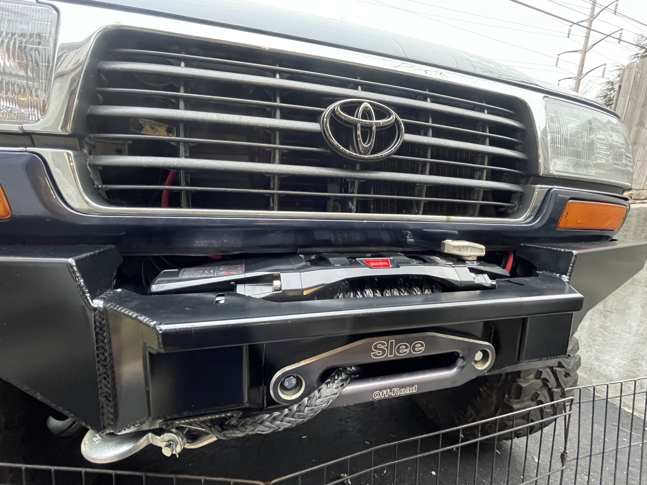

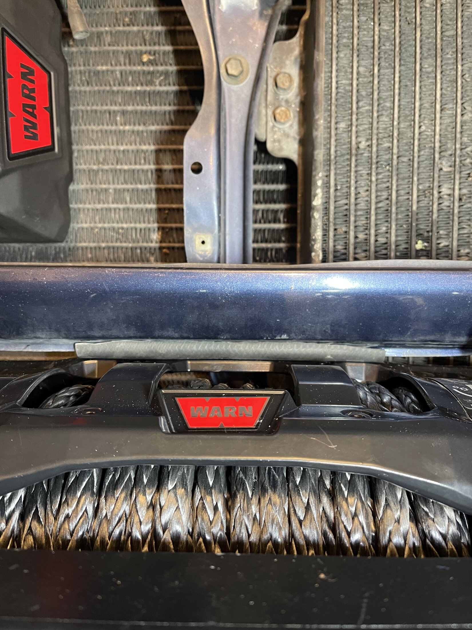

Picked up a warn evo 10s off of craigslist in Ohio driving to Michigan over thanksgiving. Got that installed and managed to get the control box relocated on some home made brackets behind the grill but I’ll probably end up moving it under the hood. The winch was a tight fit, left just the tiniest gap to slide some rubber hose between the valance and winch. Most pictures I’ve seen of the dissent extreme clearance, people have chopped up their valance and grill to fit the winch with the control box which is not ideal. Very happy with the outcome. Also installed a new driver seatbelt. If I was on even a slight incline the seatbelt would lock and my driveway is steep so it was a constant annoyance. Nice and smooth now.
